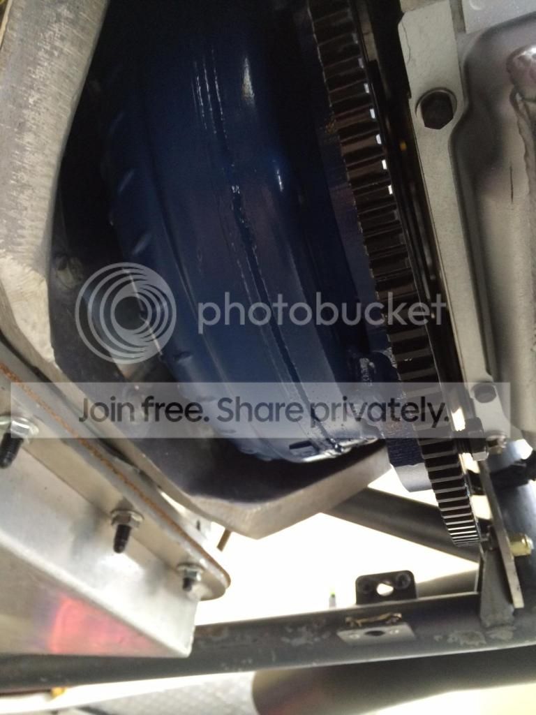

Converter guy got back to me, he had he week off for a local car festival
Seems the original converter manufacturer just built a standard TH400 converter. So I need to order the TCI LS flexplate which is actually ~8mm thicker and then he still has to cut the converter open to add 5-6mm in length.
I was originally using the stock GM flexplate, so I am abit relieved to be told "you have to use the TCI one" as it is thicker, and carries the SFI rating. I just didn't want to have to spend the extra ~$400 if the stock one was going to be OK.
My SFI rates LS flex plate was about $75. I used a .20" thick washer between the converter and plate to get the spacing correct. Not saying the ebay flex plate is of the same quality, but it carries the SFI rating and isn't $400. Seems to do fine on my 800-900hp turbo car anyway. I will say the bolts that came with my flywheel were junk. I ordered a set ARP flex plate bolts.
That's a good option - problem is I am located in Australia, so we have limited choices. As in the only choice is the TCI, or order from the US and wait 3+ weeks on shipping I was also looking at the Hughes option too.
Thankfully I already have a set of ARP bolts for the flexplate.

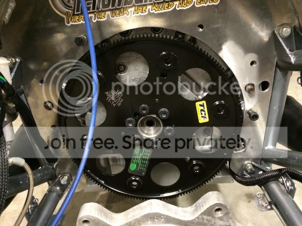

New flexplate in late this afternoon, calling converter guy with measurements tomorrow.

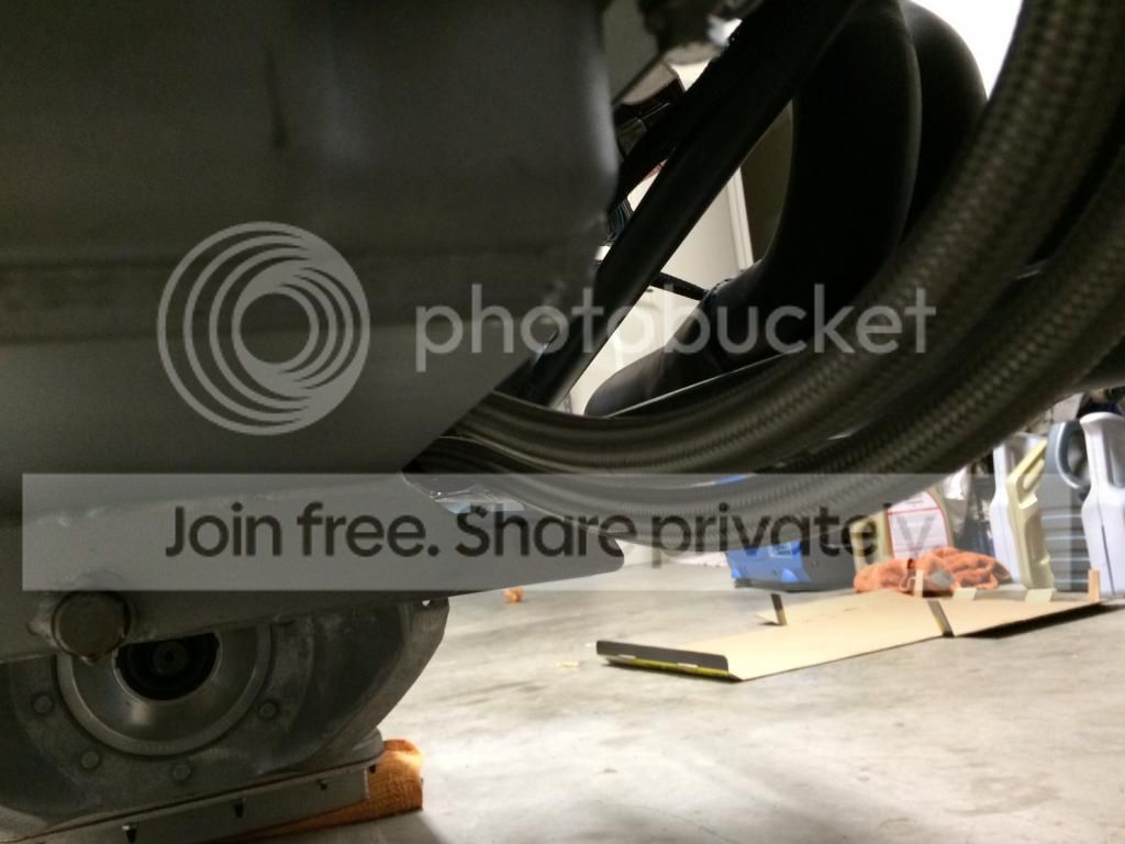

I'm in the process of finishing a very similar build (in Australia also) and we're puzzled on what to do with the sump, any chance you could post some pics of the sump in the car? Cheers

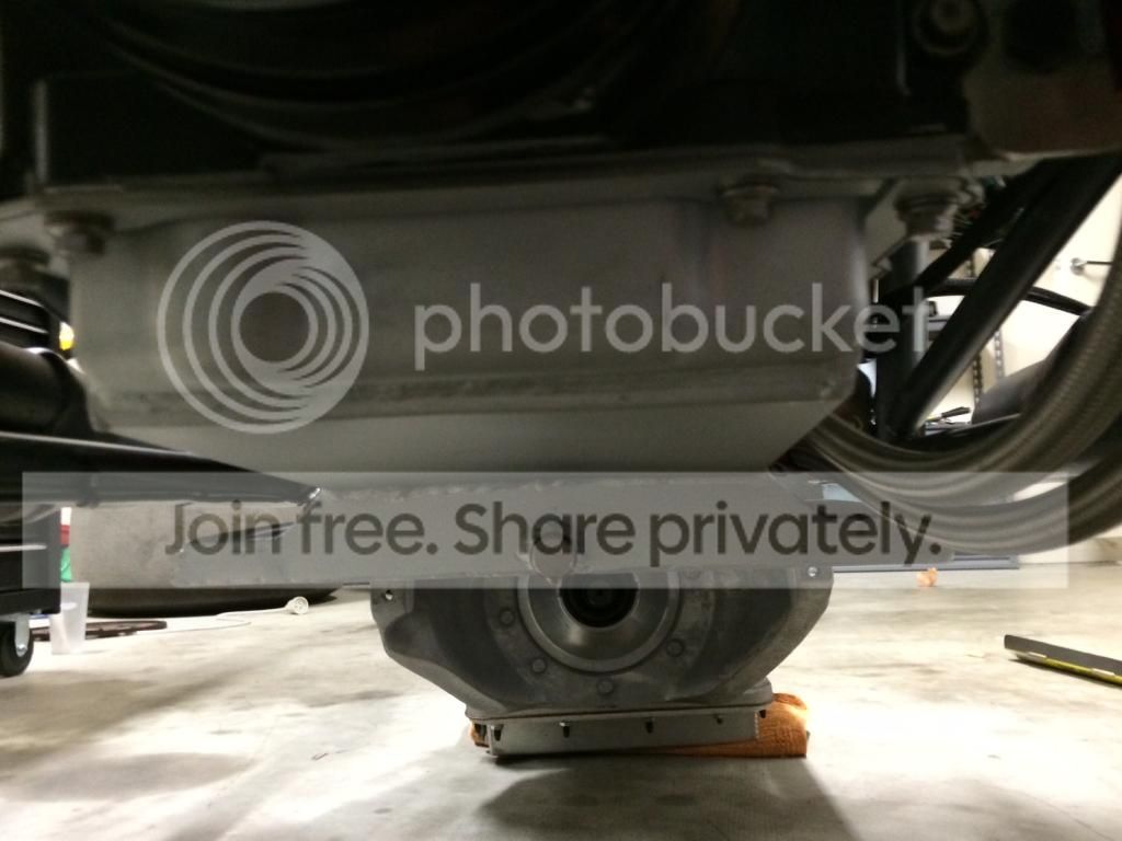

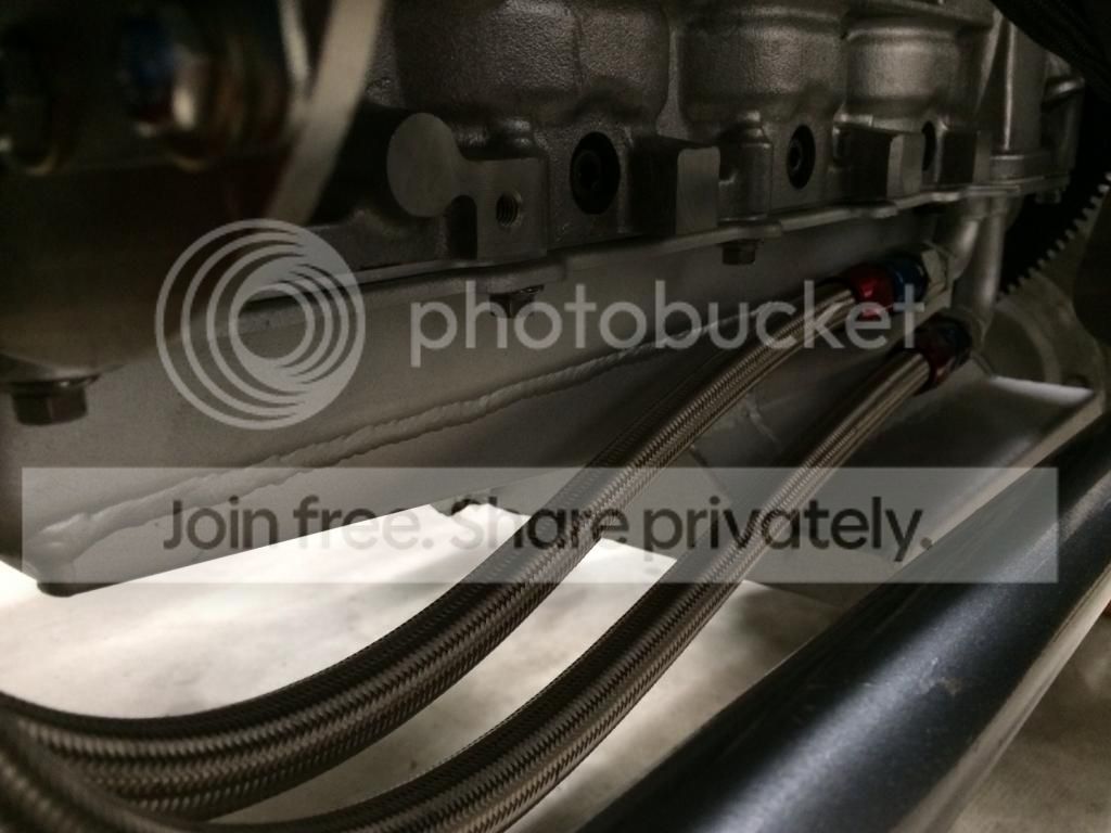

Sure thing mate here you go. Fill me in on the details of yours! Have you got a similar build thread etc anywhere?
Sump started off as a Moroso 20141 which has internal baffles and trap door's etc
http://www.jegs.com/i/Moroso/710/20141/10002/-1
Due to my chassis actually being setup for top alcohol, with a blown hemi the motor sits in an odd position to most altereds. I had a friend section the bottom of the sump, and at the same time add extra "wings" to make up for the reduced volume. Holds 6ltrs no worries now.

Got the torque converter back and all installed. Fitment is spot on, but seems something is up with the box as it just wont pump oil. Checked a number of things, but the box builder has asked it to be sent back (at his cost) for inspection.

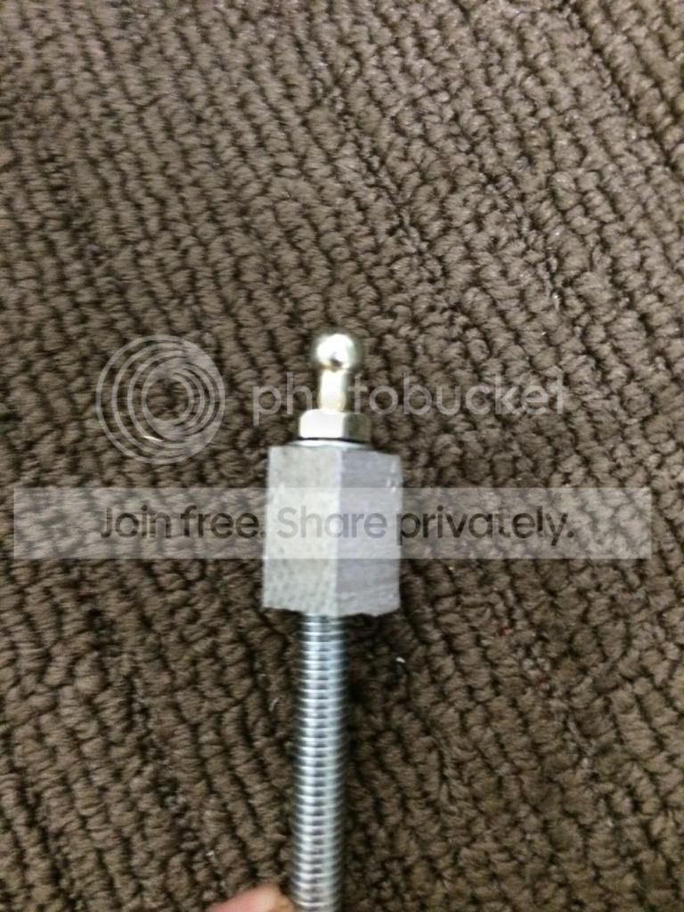

One of the last pieces of the puzzle, like alot of other things on the car, had to be custom made. 10-32 UNF to M6 thread coupler. Isn't pretty at the moment, but it does the job. This is from the quick disconnect ball on the throttle cable -> throttle body.

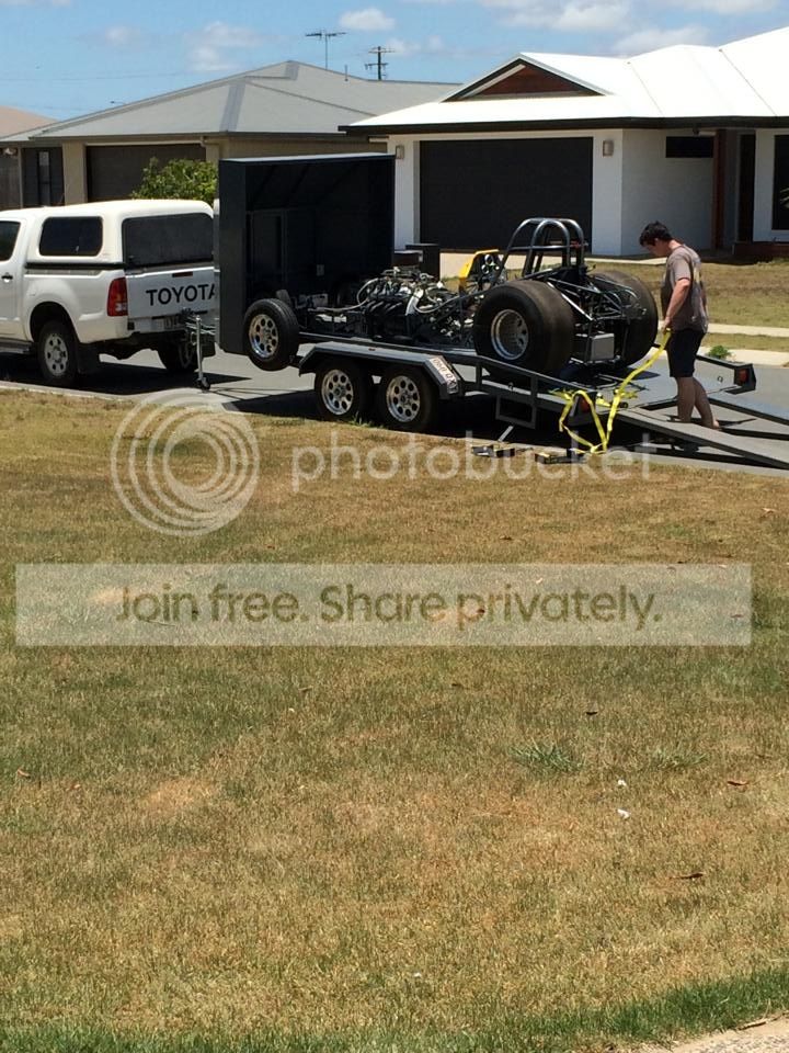

Car loaded up on my trailer, first time it had been on the trailer and due to how low the car is had to unhitch the trailer from the car. I'll invest in some wheel chocks to stop the trailer from rolling forwards when this happens.

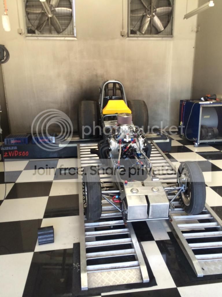

Strapped down on the dyno ready to run, we didn't really achieve any indicative power figures, the slicks are too wide for the dyno and were rubbing slightly on a tie down point, and they just continued to spin no matter how hard it was strapped down. The tuner claimed he had never had to strap anything down this tight before in his time doing this. 800nm torque was recorded, and about 350rwhp at 5600rpm. It will spin to 7000 and make the most power there. AFR's were spot on, which was really the exercise of the day, to make sure everything was healthy to run.

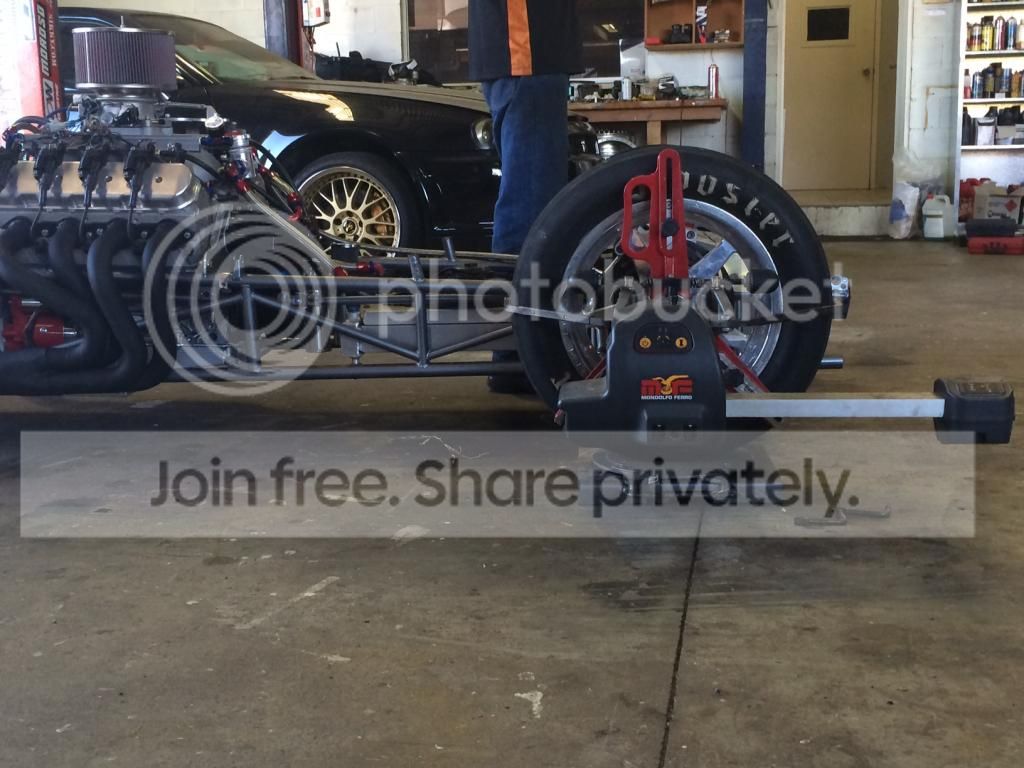

And then finally off to a friends import workshop for a wheel alignment, I joked with him it was the toughest car to make it's way into his shop, didn't go down so well. That's a GTR behind the car
