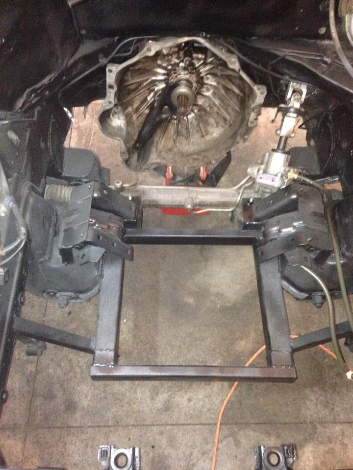

so here it is. I built a gen 3 v8 this fall, and got a great deal on a 5 speed transmission. so the logical thing was to find a donor vehicle to put this in. I like doing things out of the ordinary so I figured this would be perfect, I see theres a few others whove done similar swaps so this is where im at so far. I started with this.

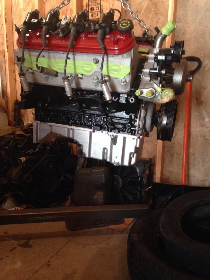

I had to dyno the engine she ran like a champ, no leaks or noises. pretty good for my first ever rebuild. I found this gem a 1993 benz 190e. ive always had a little sweet spot for a Mercedes, especially these. Im trying to sell this engine, but besides that its useless for me needs. the trans is a nv3500 I have a new clutch starter flywheel, and master. has a short thow also.

I have all the needed parts for this build, no I just have to do all the fitment, im still deciding on if I want gto mounts or if I should go custome, and im trying to find a place to fab up a drive shaft for me. other than that. its going to be a stand alone harness. I managed to keep all my power accessories on the body so I have windows radio, sunroof blower, and abs, no AC, but that's okay. Im open for any suggestions on my drive shaft situation. Im thinking ill just get a slip yoke welded onto the stock benz drive shaft for now, until budget can afford a turbo, and stronger drive line.

short throw in, needs to be lengthened a bit
upper hose is temporary also
temporary makeshift intake
accessories and fitment
start to custom exhaust
tight squeez
down pipes
custom y pipe
started wiring this beast, lengthen a few connectors and change a few
more wires and guages
nest of wires that need to be tucked
engine bay ready for initial fire up
cant forget the rest of the exhaust bolts up with a 3 bolt flange and three hangers
