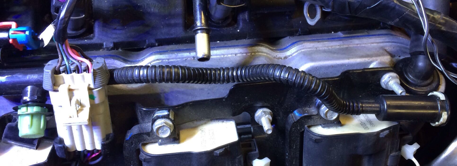

Hey guys...about 75% done on my 2002 LS into a c4.....
Please feel to answer any or all of these...
Questions:

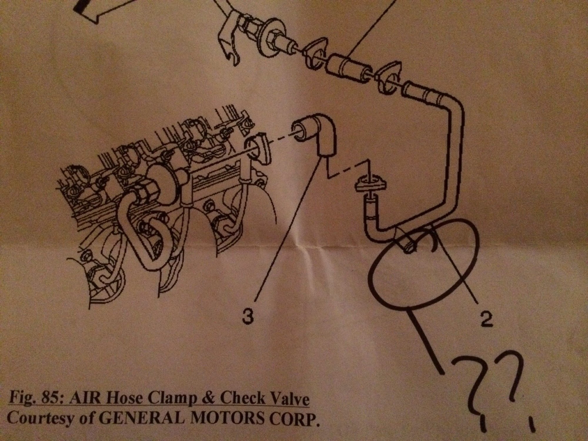

1.what does this air hose connect to?
2. What does the flexible bendy straw looking hose connect to in this picture?
3. Do I have an "engine coolant heater hose" and what does it look like?
4. Finally, the 4l60 I have is from a 2002 camaro. Do I need a "park/neutral position switch"? What does it connect to?
Thanks
Old Jun 25, 2014 | 11:25 AM
tfi racing's Avatar
Joined: Jun 2010
Posts: 751
Likes: 10
From: Cedar,BC
1.Air pump,you can delete all the plumbing unless you need it to pas smog in your area.
2.Looks like the evap line that goes back to the tank.
3.Not sure,do you mean the coolant hose that goes thru the throttle body?
4.Isn't it part of the shifter switch on the side of the transmission,you will need to retain the neutral safety switch that is part of the C4 harness to get the starter to crank.

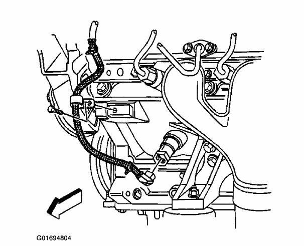

for # 3 I mean this
Old Jun 28, 2014 | 02:33 AM
tfi racing's Avatar
Joined: Jun 2010
Posts: 751
Likes: 10
From: Cedar,BC
Brrrr! A block heater, very common in the colder northern parts, I doubt you have one and likely won't ever need it in Virginia.
