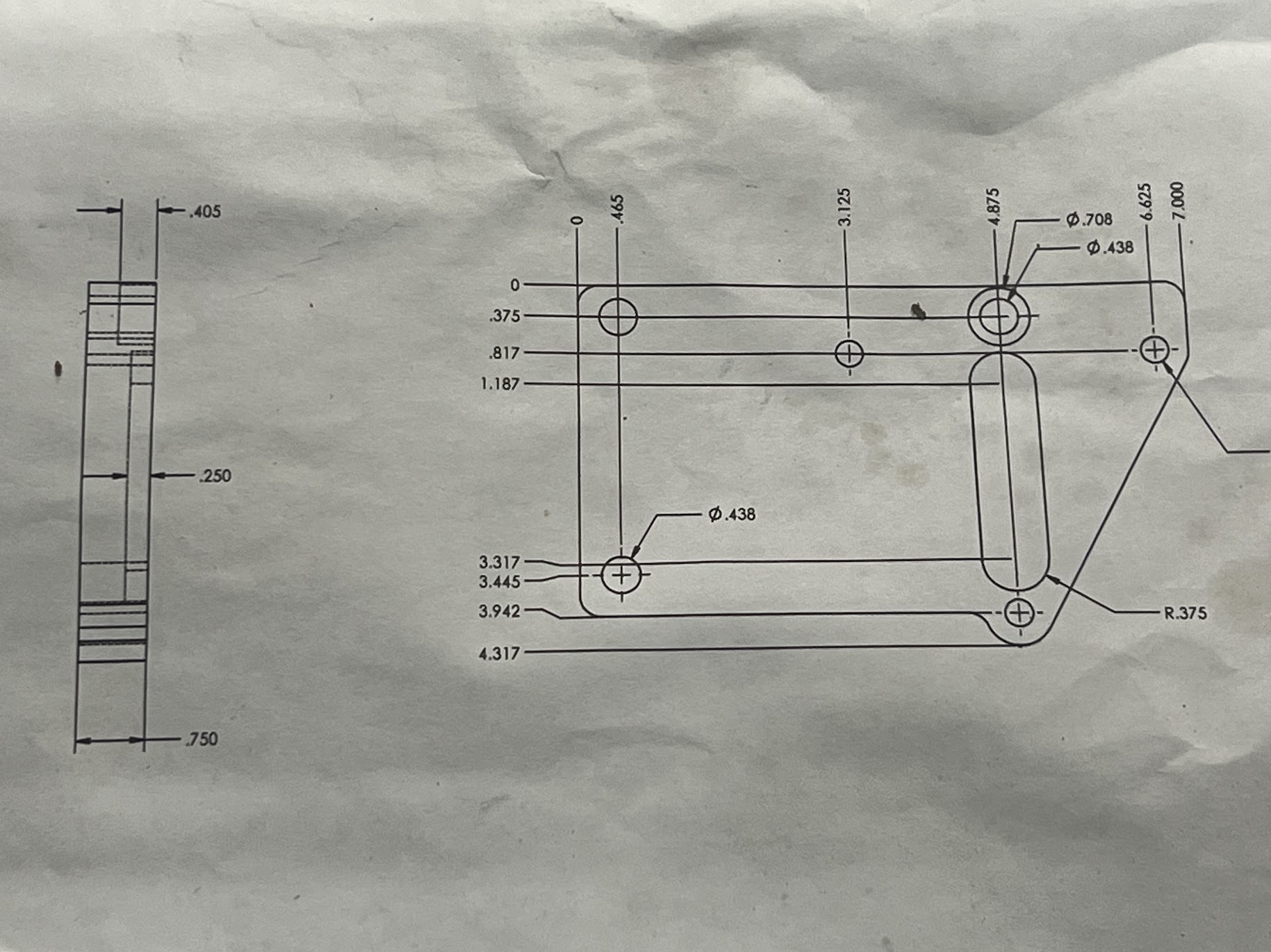

I retired and don't make them anymore......I will post a picture of the drawing later so maybe you can get a set made
Ken

Here you go......Material is Aluminum......1 Each R.H. & L.H. required
