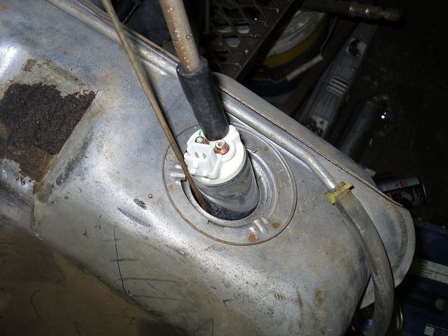

If anyone has any experience with the swap especially an idea for the fuel tank please let me know
I do...
This is my 72 A-body in tank pump install...

Initial mockup...it's tight, but it will accept a modern electric pump...

Dude you are my hero. Did you braze the fittings on the end of the original sender or weld them? Also are there any baffles in the tank or just like the factory?
My factory sender only had a 3/8" feed line out of the tank...and a 5/16" vent line...no return.
I added a 5/16" return. I welded it in...
I installed this -6 AN fitting to the feed line out of the tank...
I didn't trust my welding...so I used a little silicon rtv...
There are no baffles in the tank...but by the nature of how it sits vertically...and the pump sits so far down in...I see no need for them as long as you keep it over 1/4 tank full.
