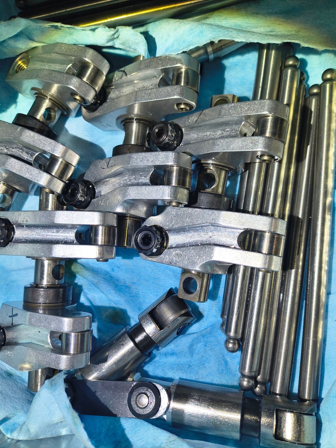

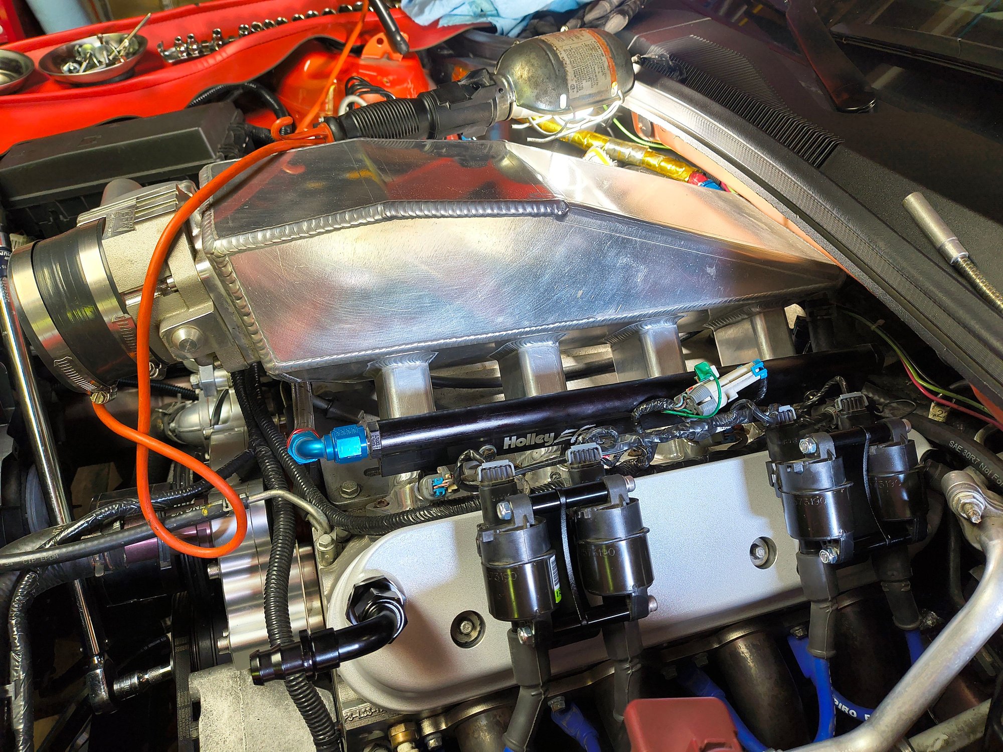

When I first had my 406 on the Dyno it made 545 rwhp. I had my old drag radials on the car for tuning. I replaced my drag radials and with the new drag radials on I put it back on the Dyno and it made 526 rwhp. The new tires were stickier and softer and wrinkled more during a pull . Both sets set at 25 psi.
My original cam was an old comp cam grind for a stroker.
247/255 624 /624 on 114LSA
The solid roller is a cam motion grind .
250/266 680/642 on 114LSA , .010 hot lash
The solid roller made around 20 rwhp peak than the Hydraulic and carried to 7400 before it started to fall off.

Thanks guys. We tried another degree of timing for Pro Stock John. It was just enough to get me over 550. It was worth almost 3 Hp! Where the hydraulic fell off I'm up 30-40 with the solid roller.
I'm planning on moving my shifts up to 7400.

LS3 heads, 821 casting with factory valves, cam motion spring kit, 3/8" pushrods, Yella Terra adjustable rockers.
The rockers created their own problems. I bought a set of tall Holley valve covers because I was told they would clear the rockers by a reputable builder. I clearanced the valve covers all I could on the sides and they still will not clear these adjustable rockers. They may clear the non adjustable ones. I don't care WHO tells you they will clear they will not clear the Adjustable LS3 rockers. I ended up buying the aluminum spacers from Yella Terra and got them to work but I have been fighting oil leaks .

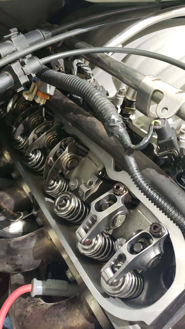

I had to cut the baffles out of the top of the Holley tall valve covers because the adjuster nuts were hitting where the baffle was actually attached to the valve cover. The side clearance was a lot worse be cause of the way the rocker heal sticks over the top rail of the head. You have to clearance the head on the side so the rocker don't rub it also

You can see where I had to make clearance on the side of the covers. I removed all I could and still didn't have enough clearance with the Holley Tall valve covers. I have the aluminum 1" spacers from Yella Terra and a stock height valve covers on now.

I think I would have been better off with a different set of rockers. I had to cut clearance for every rocker on the heads themselves because of the way they hang over so much. This is probably my first and last set of Yella Terra adjustable rockers.
