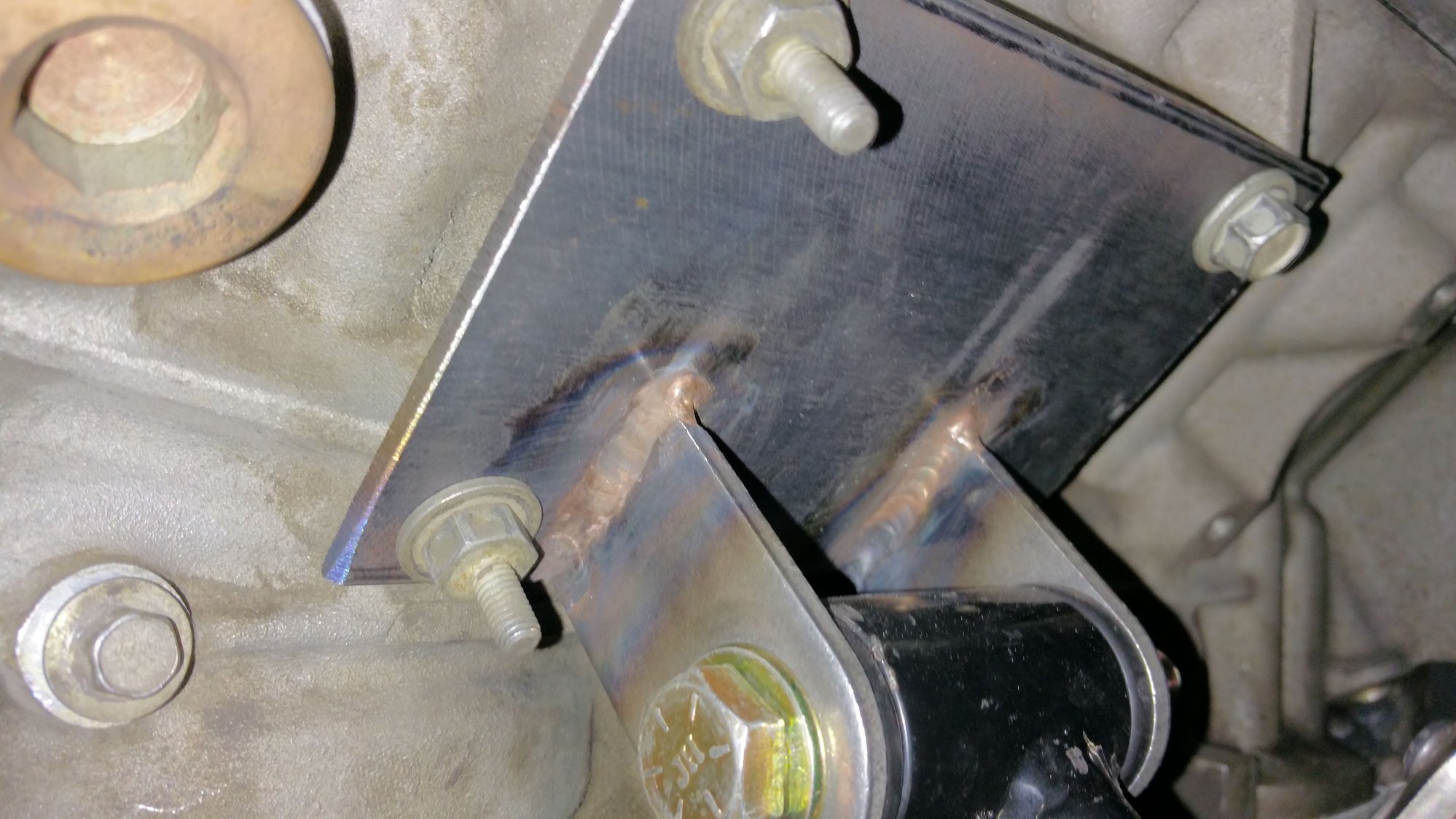

Unfortunately (or fortunately depending on how you look at it) I've been in 10 different states in the last month, so I haven't had time to post any updates. Anyway, in the past month, I've wrapped up the chassis wiring (only waiting on a turn signal switch), prepped and dropped in the engine, got engine mounts welded up, installed brake and clutch master cylinders, and cleaned up the garage lolz.

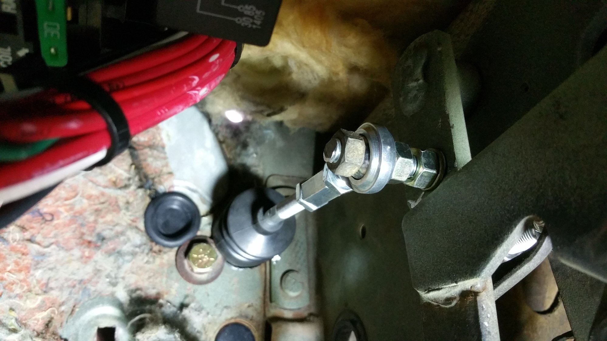

Here is the clutch linkage, the nuts are being replaced with nylock nuts.

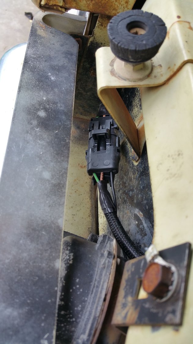

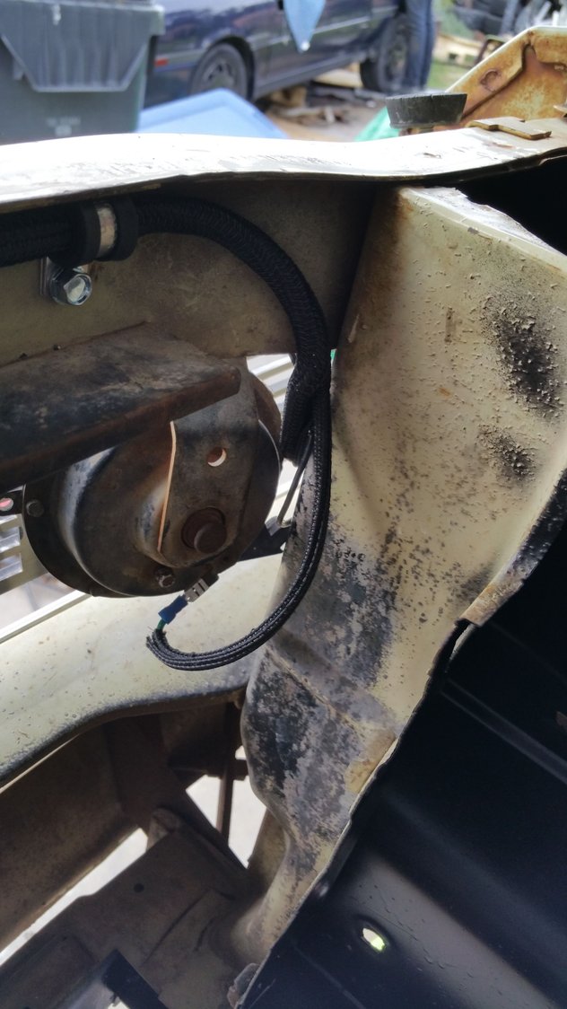

Headlight and horn wiring.

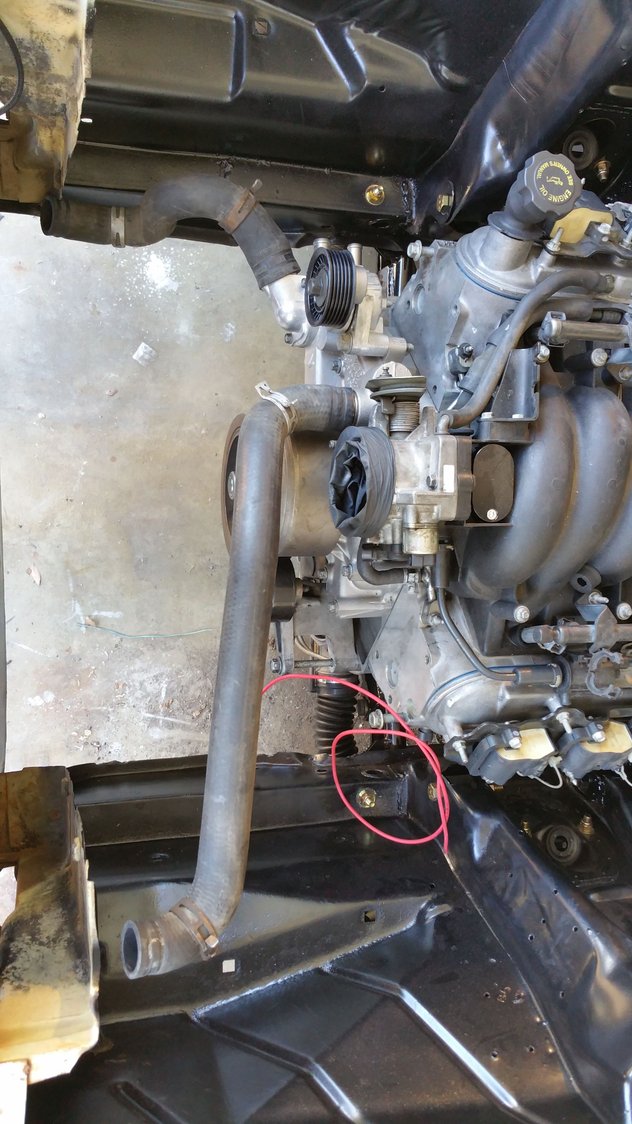

Factory LS hoses for a 2000 Camaro, they look pretty close!

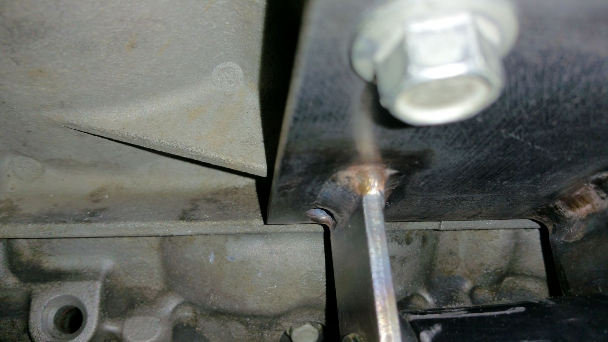

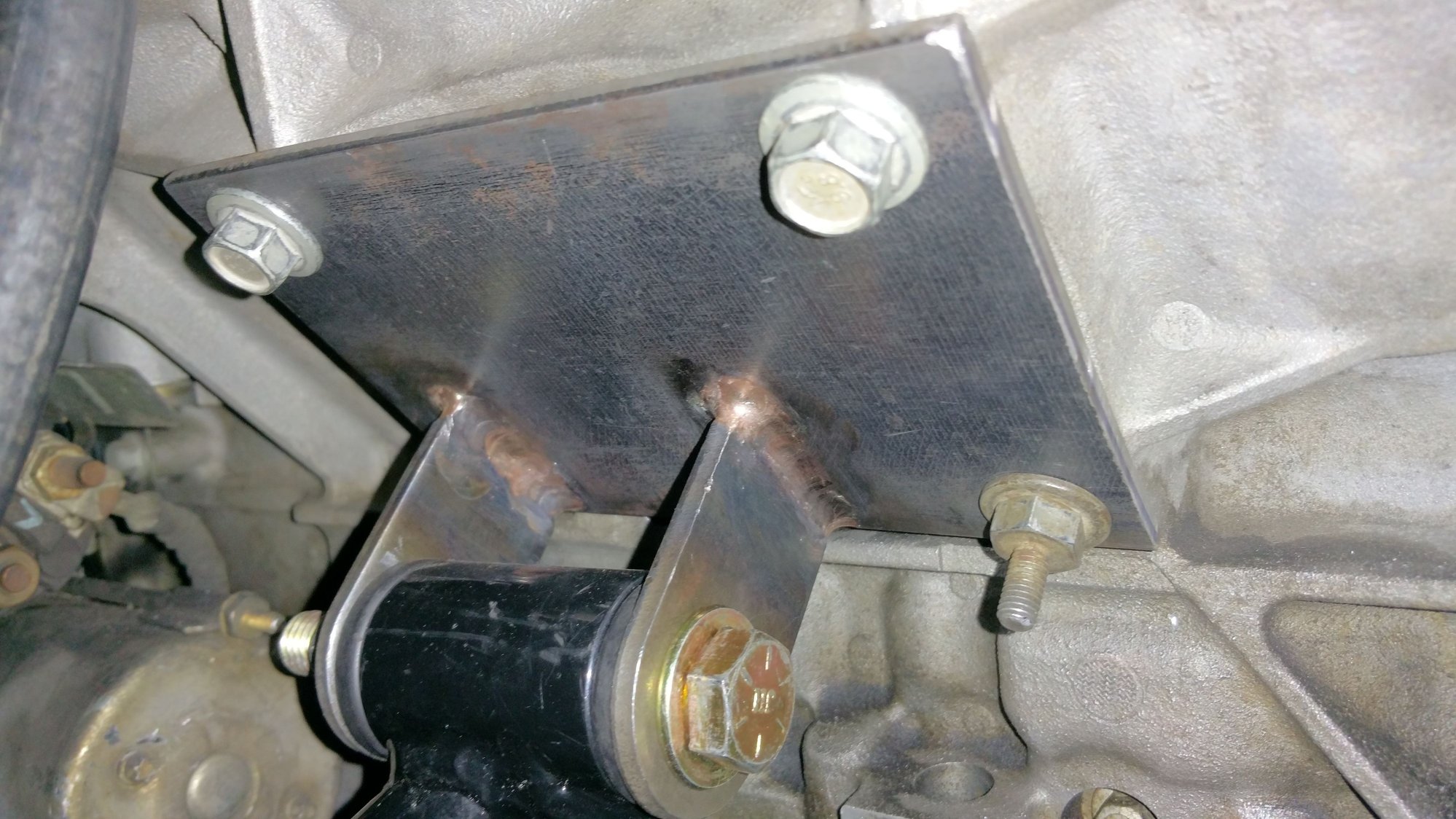

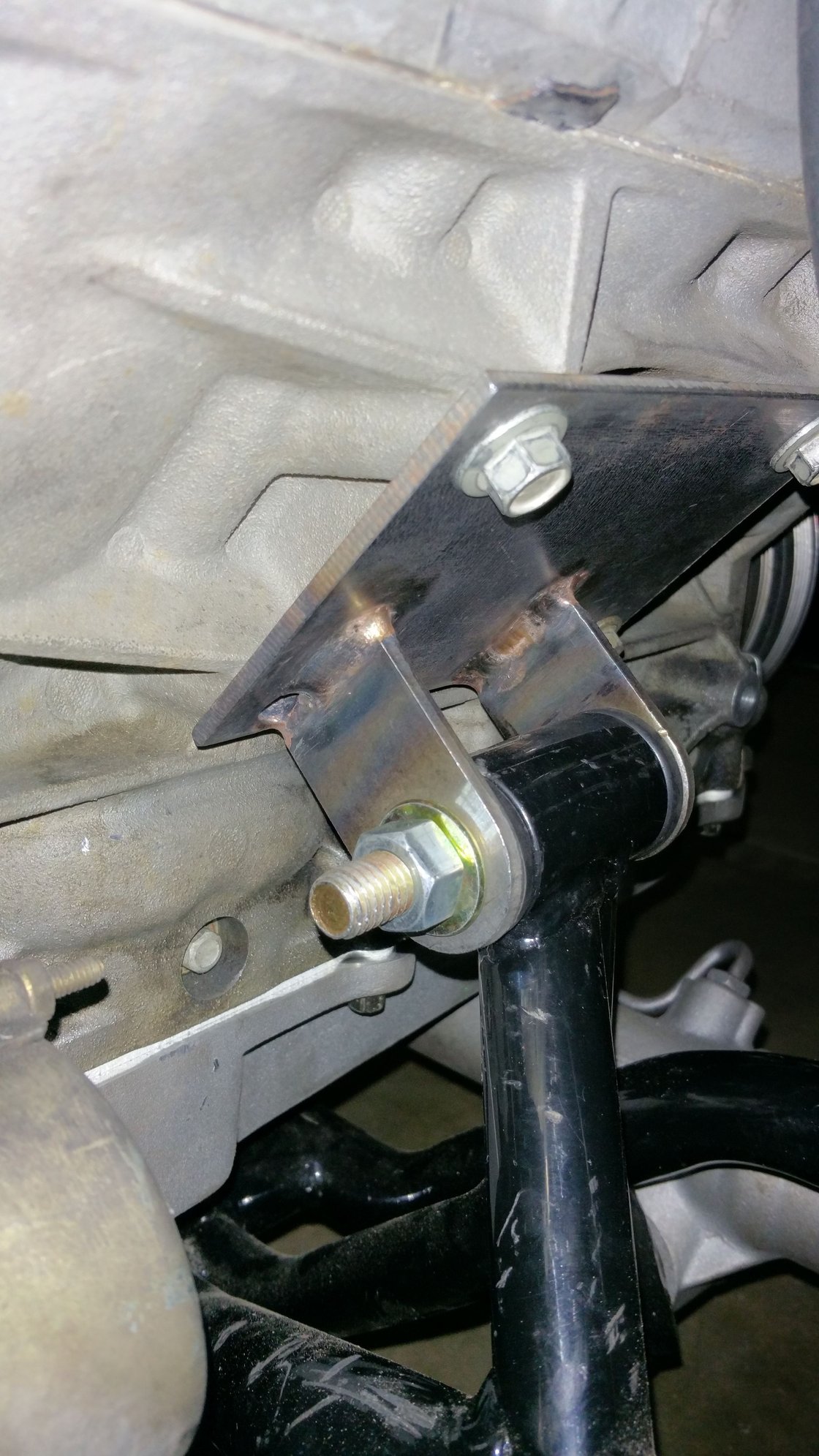

Driver's Side engine mount, props to Dave for stacking some dimes!
Passenger side mount, it blocks one of the bolt holes, so only three bolts for that side

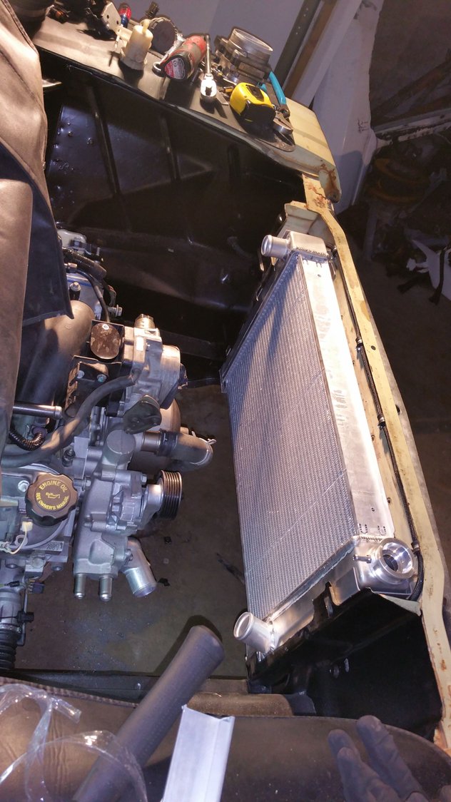

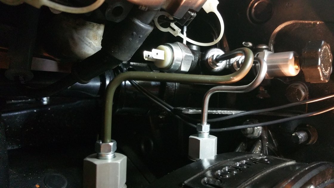

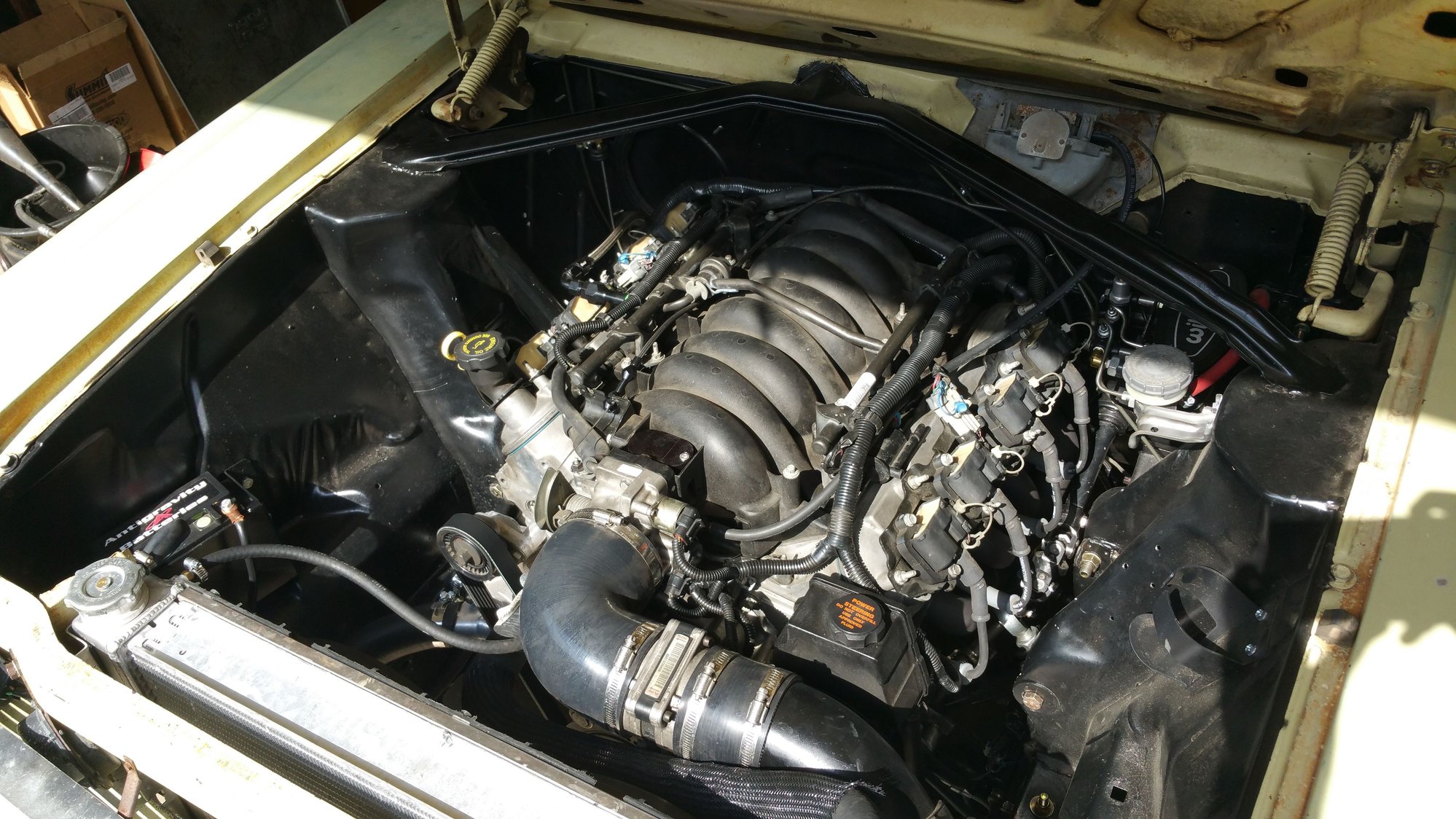

I have completed the wiring, finished most of the braking system (stupid wilwood designs ), got the radiator modified/mounted, dropped off the trans to have the mid shifter put in, and received most of my fuel system components! woohoo!

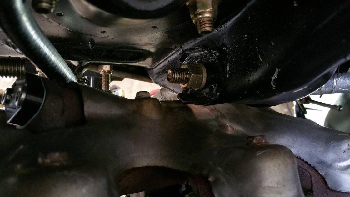

Only problem is the manifold setup (factory 2000 F-body) hit the shock towers, are there any out there that could alleviate this problem? I have to have manifolds back custom made, so I'm wondering if it is worth keeping the factory manifolds? Also, I apologize for the pictures being sideways, but the uploader keeps flipping them back sideways.
Here's the Radiator (before it got modified)
And the master cylinder set up.

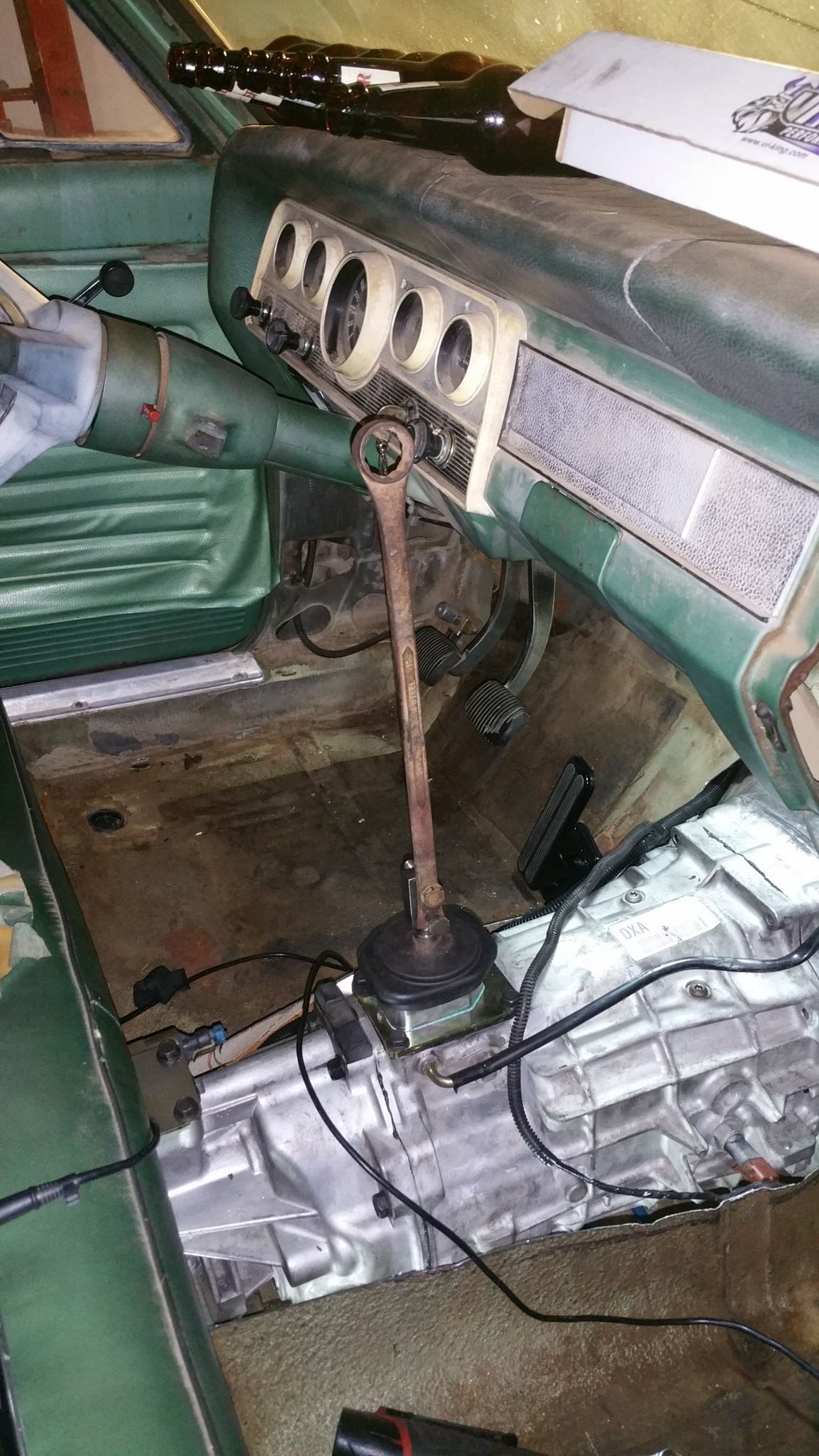

I created my own shifter, and the beer bottles were removed before the maiden flight.

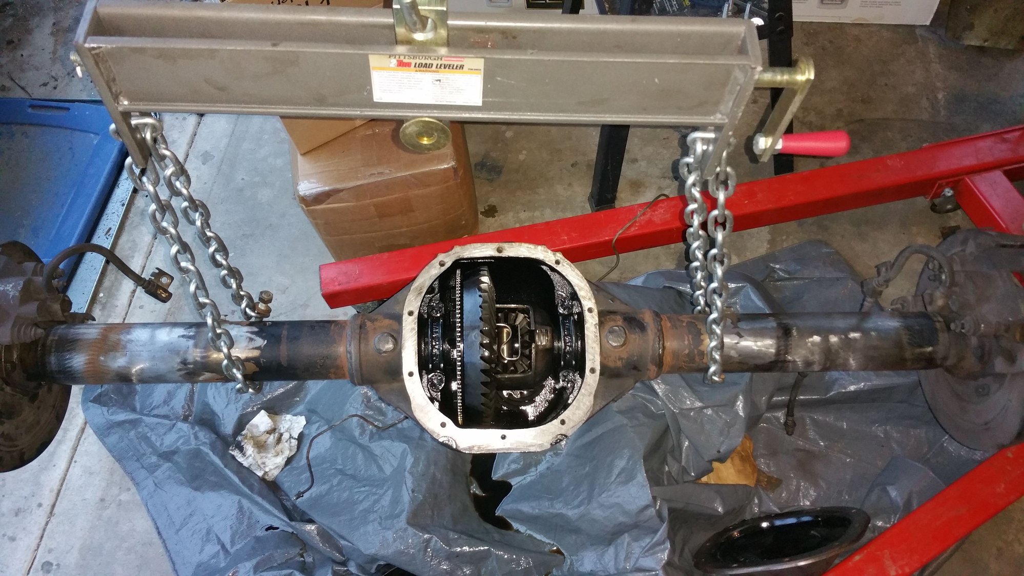

New rear axle, 3.73's instead of the 3.08's in it

Awesome build. Love the sleeper look. I suggest you gusset the motor mounts to keep them from twisting up.
I was thinking the same thing.

So, I know I haven't posted up here in a while, but I figured you guys would like to see some more progress! Anyway, thanks for the compliments, the exhaust actually helps the sleeper vibe because it's quiet at idle, whereas the open manifolds turned a lot of heads. I've been keeping a close eye on the engine mounts and I haven't seen any issues, I don't drag race the car so there are no hard launches, do they really need to be gusseted? Alright, enough with the words on with the pics!

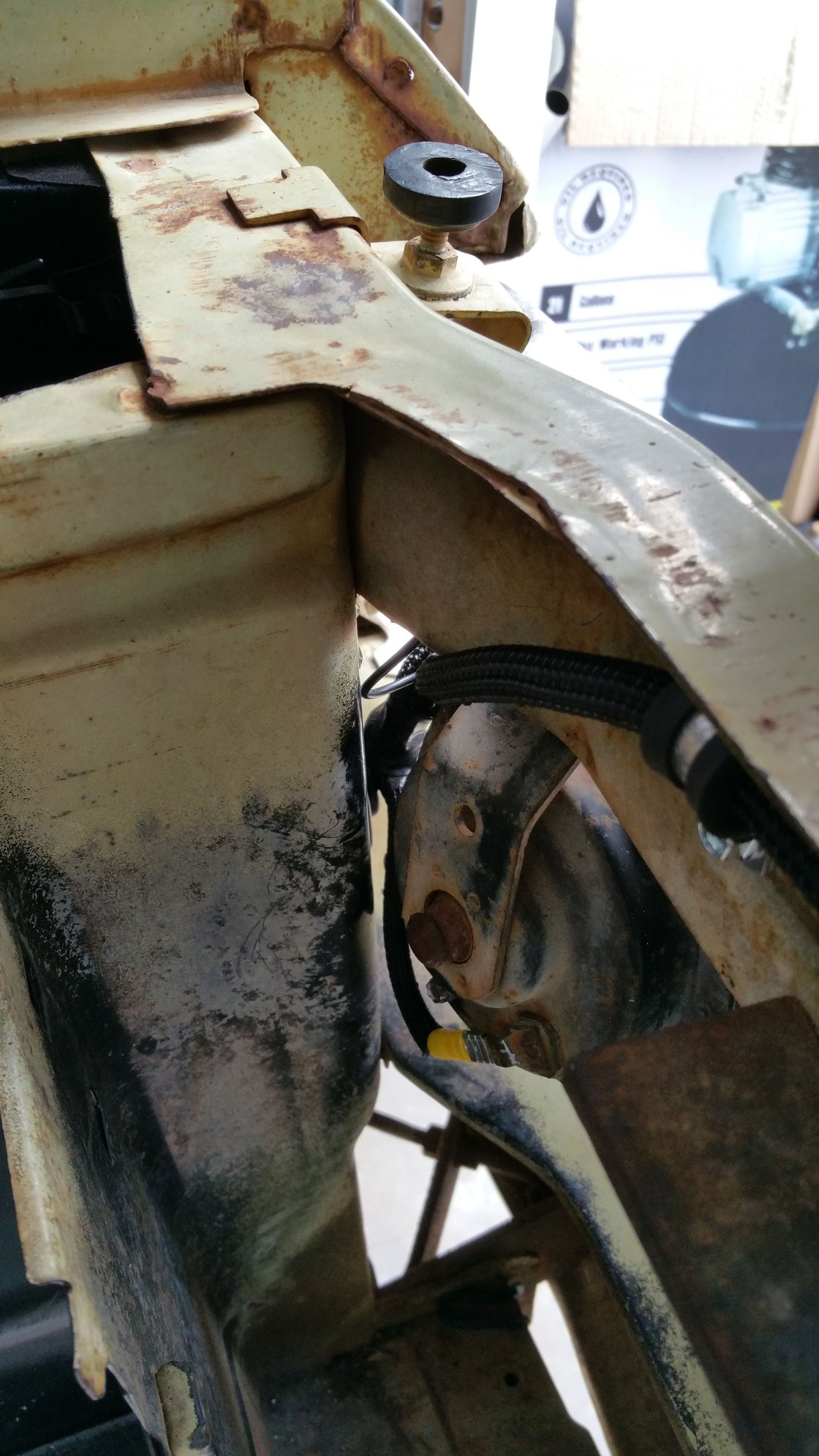

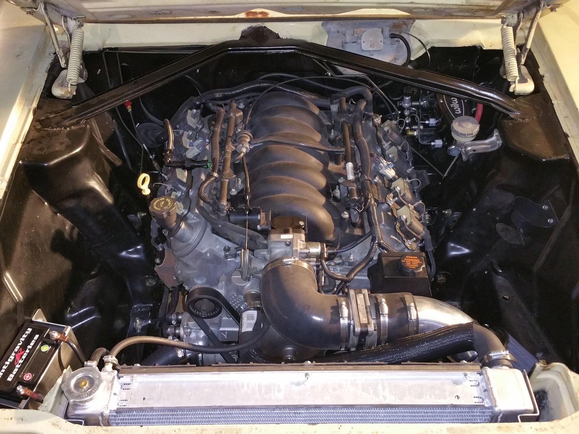

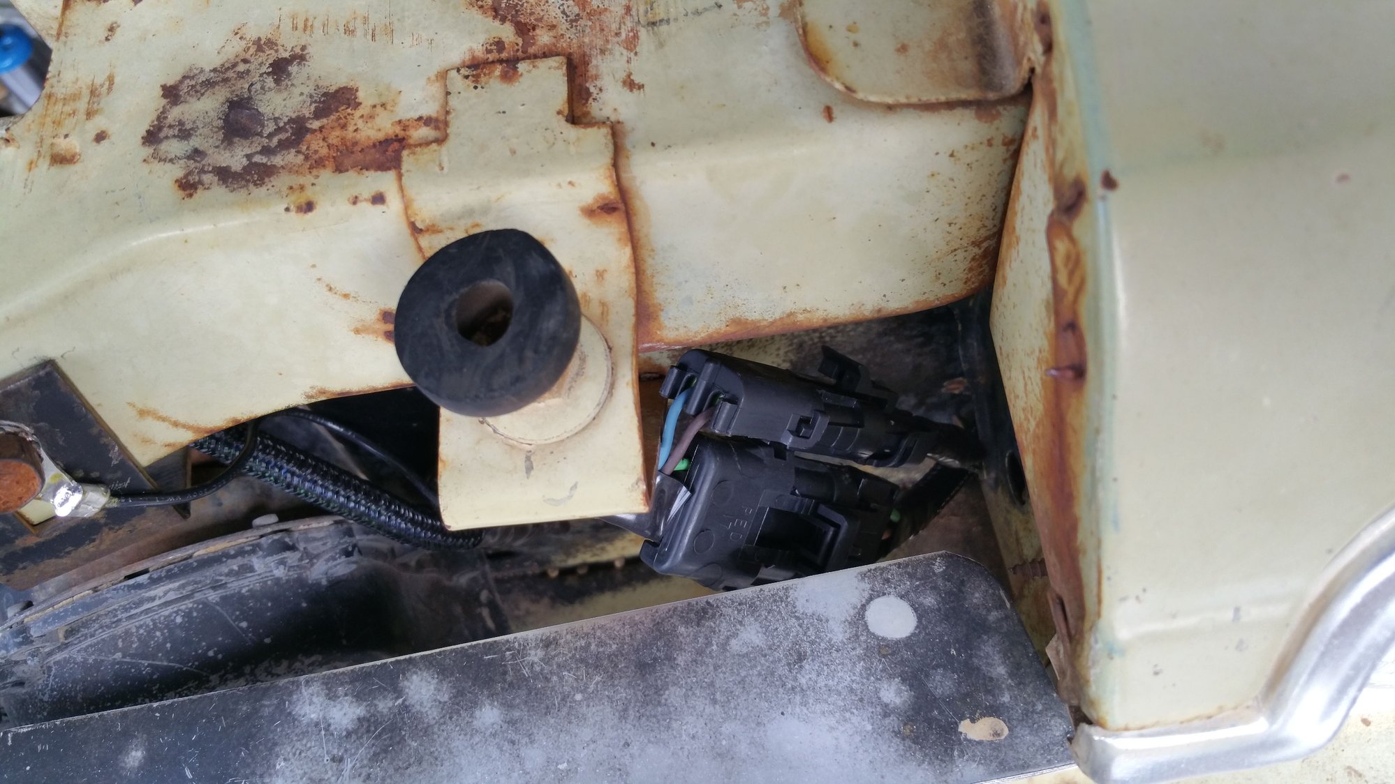

I recently made the intake go through the inner fender, and I've got the filter in the fender well. It dropped my intake air temps down 100F!
