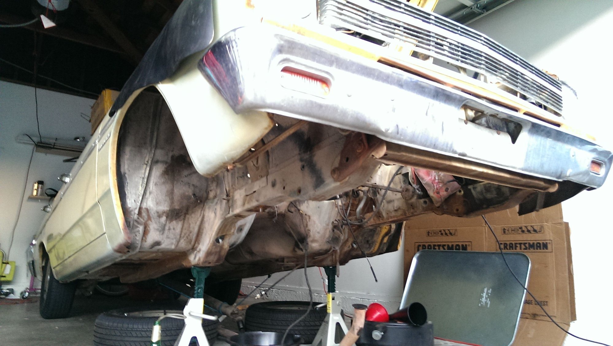

Hi, I've been lurking around thins forum and decided it's time to start posting about my build.

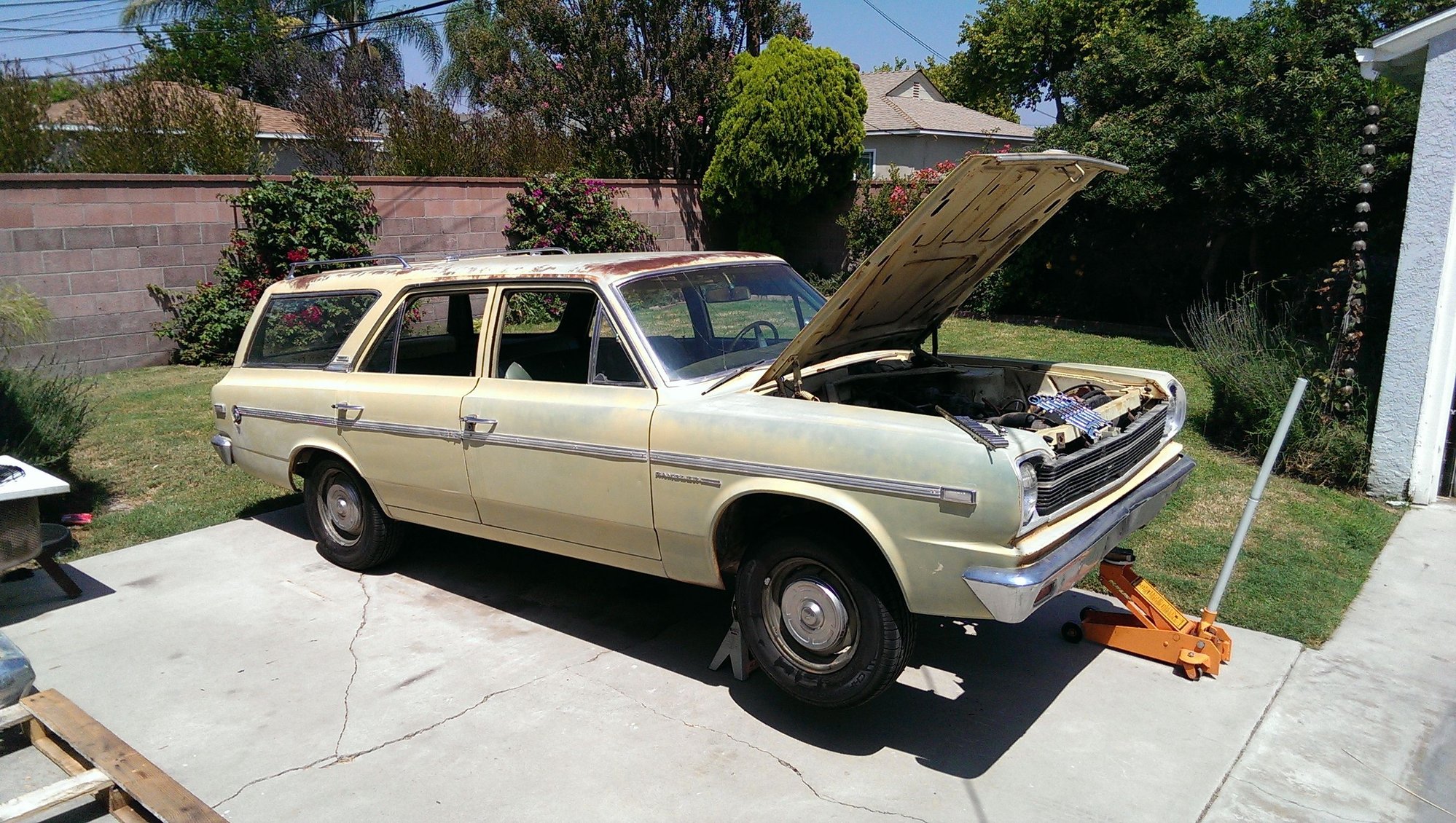

Project Old Lady is a 1969 AMC Rambler American 440H Wagon (what a mouth full) and I have an aluminum 5.7L LS1/T56 combo out of a 2000 Camaro.
Enough with the reading and get to the pictures!
Old and Tired
There, it's in! Haha, I wish it was that easy.

Yea, sleeper will be an understatement! I weighed this car before I started working on it, and it was 2820lbs idling on the scale with no one in it. Seeing as the LS is WAY lighter and 3 times the power, the real trick will be getting it to hook up.

Finally was able to move it into the garage
She's pretty clean for 45 yrs old!

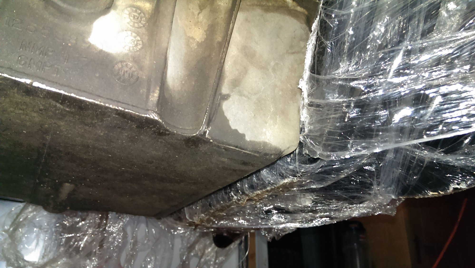

After I took the oil pan off, I was able to move the engine forward. This gave me the necessary clearance for the bulkhead.
Thank goodness for cling wrap!

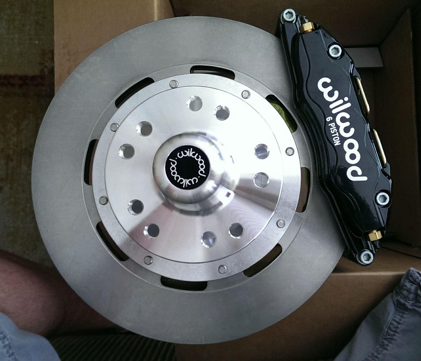

And here are the brakes that are replacing the drums, I hope there is a little more braking force than before!

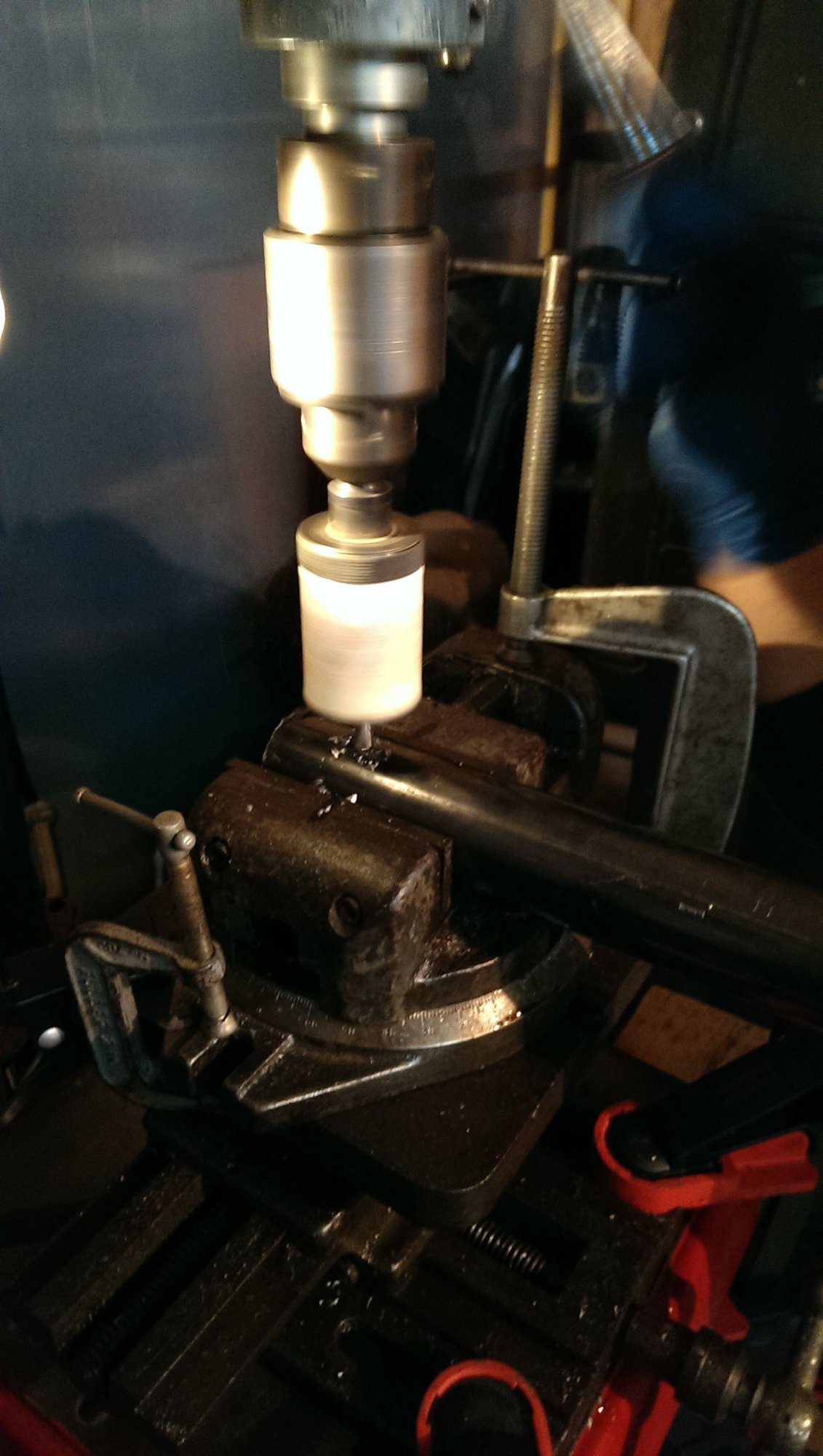

So I've been working on the transmission crossmember, and since the factory one would be too difficult to relocate, my buddy suggested to fabricate one from scratch. Last weekend we built the main support tube and support brackets, this weekend we buit the pedestal that the trans will sit on. Enough talking, time for some pics!
Making the pedestal mounts.

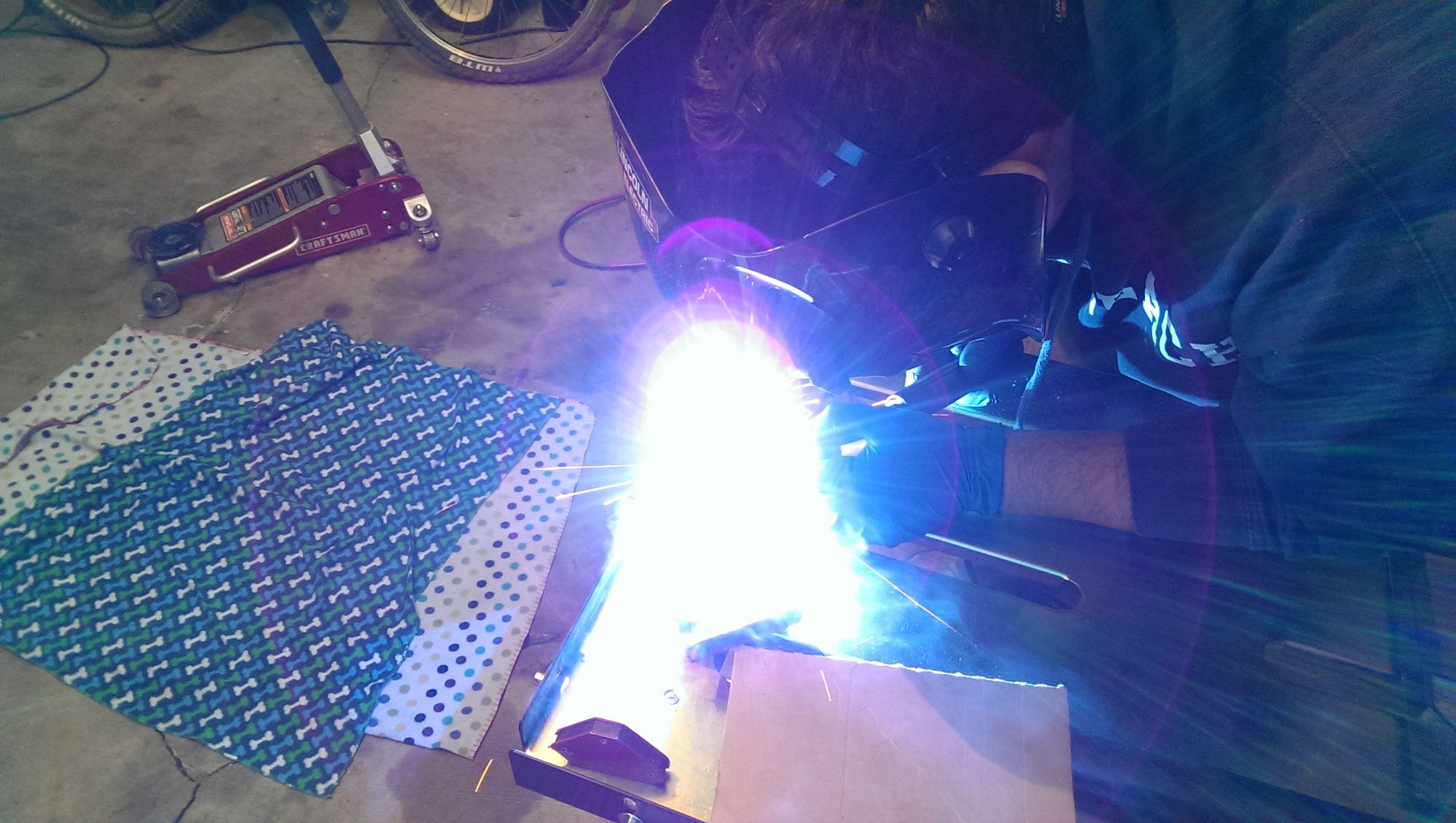

Made some progress this week/weekend. Since the trans crossmember was tacked up and the engine mounts got tacked up, I pulled everything out to clean up the engine bay.
Getting welded up!

The BIG Wilwoods installed.
