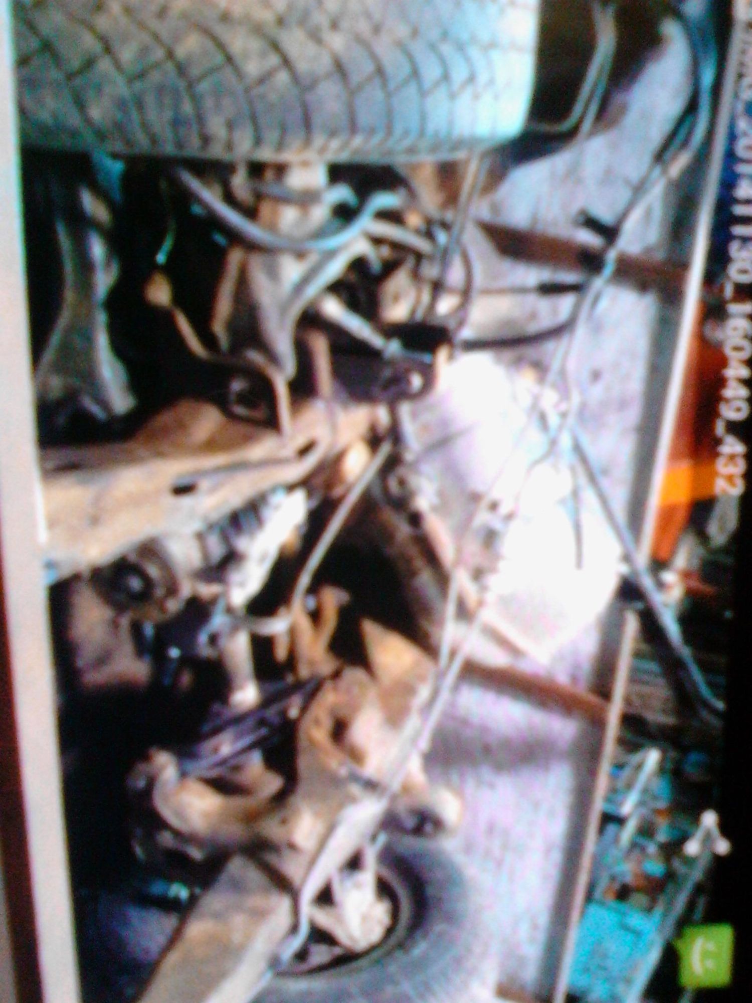

Just stripped off the front suspension. Probably go to work tomorrow to start cutting the front of bravada frame.

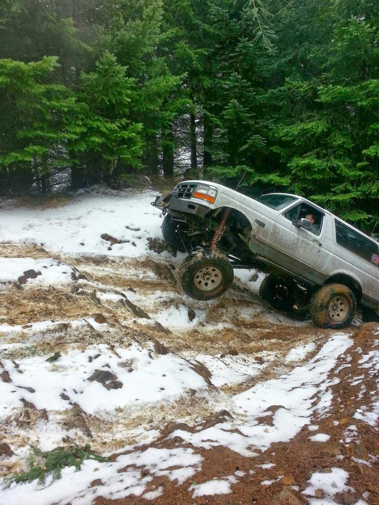

This is the last rig i built and my current daily driver. Custom 3-link front suspension with 18" coilovers, dana 60s, and a 4 cyl cummins turbodiesel. Oh, and it was in the dec '14 issue of Four Wheeler magazine.
Did u make it up the hill?

From: Silverton, Oregon
Yes. I made it. That is the top of "hogsback" in the Tillamook state forest. I stuffed the right front tire into the been to make it a little harder.

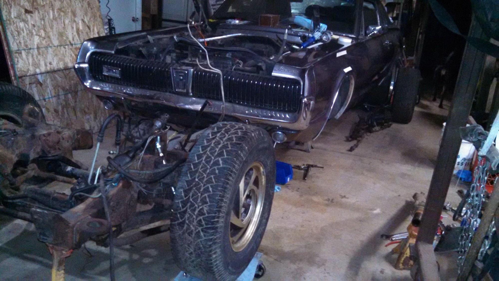

Still have a few things to remove from engine bay yet.
Gotta lose the A/C crap to make room for the intercooler.

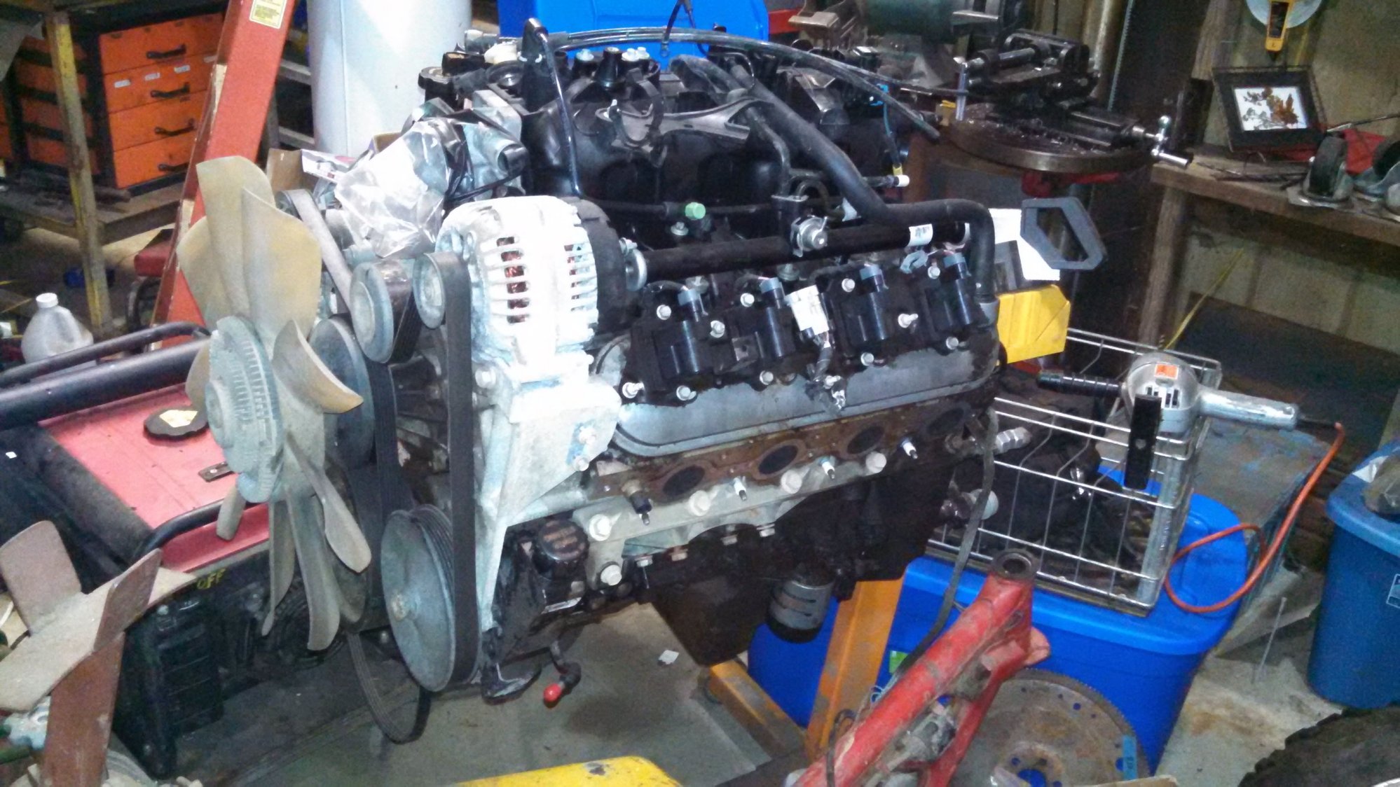

Here is the '99 4.8 I'll be putting in. I'll need to get ahold of a car manifold.
Damn, do i have enough crap in here?!

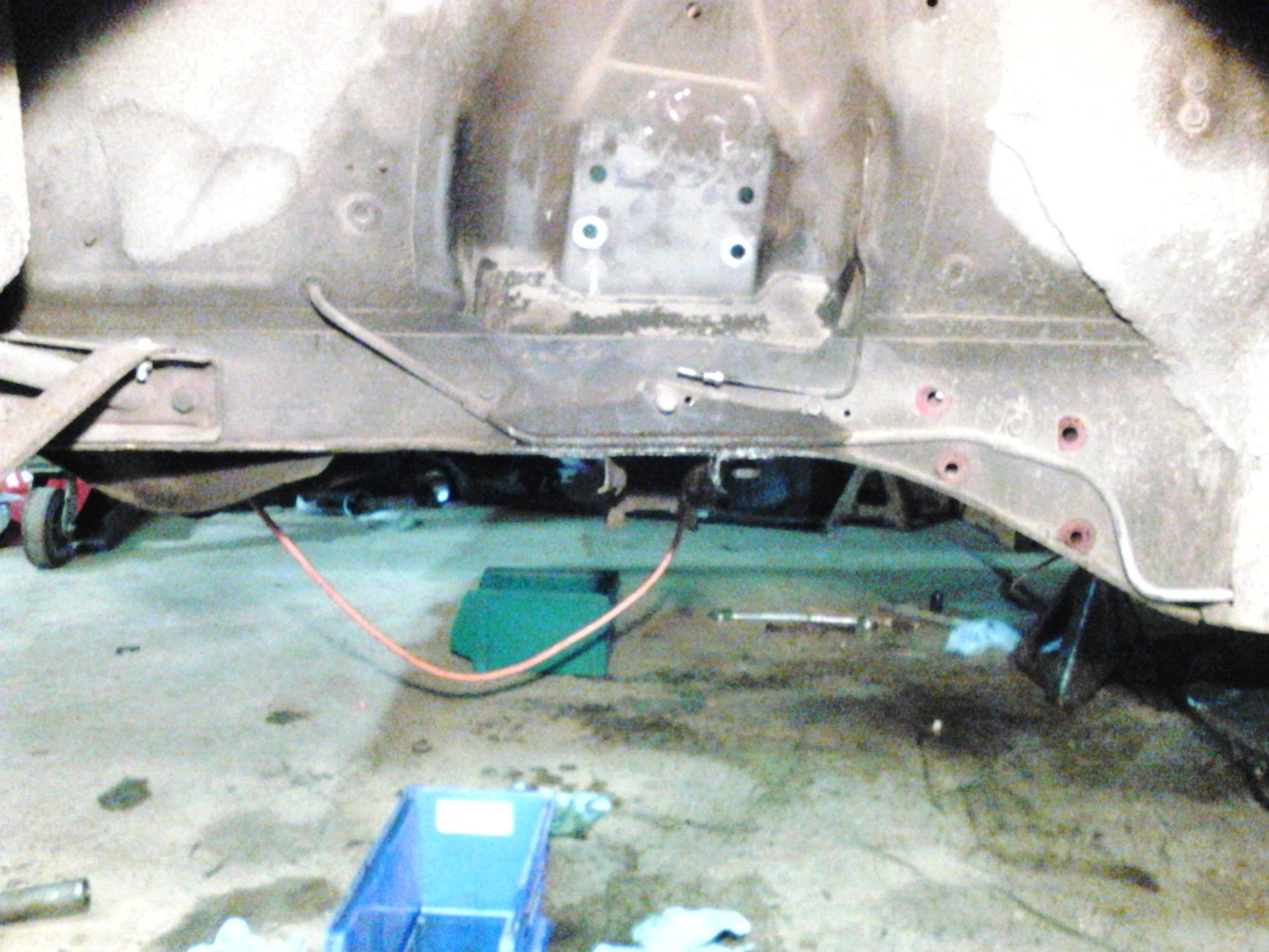

Tonight I did a bunch of measuring. I cut the rear section of the Bravada frame15&1/8" behind the hub centerline with my plasma cutter. I will cut the front section of the Bravada frame 19&1/2" front of hub centerline which will be about an inch behind the rad core support.
Cleaned frame so i could make some cut marks

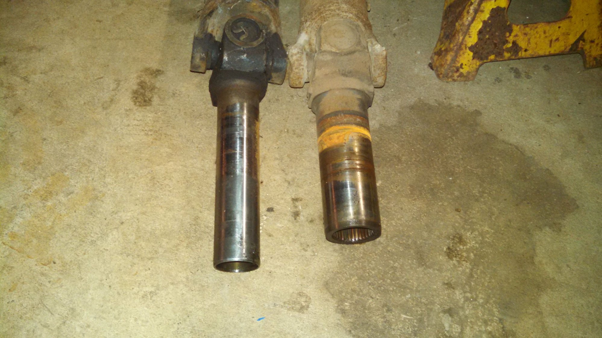

The Bravada rear driveshaft yoke is a bit bigger than the cougar one. 1 & 7/8" verses 1 & 1/2". Bravada output shaft is 32 spline. I'm assuming that the TC input is the smaller 27, or 28 spline. I was originally going to use the 4L60 transmission, then beef it up after it breaks. But, I think that I'll use a TH400 instead, and change the axle ratios from 3.73 to 3.08.

Originally Posted by operatorfailure
With a turbo 4.8 you would grenade the 4l60e. The 400 will be a lot stronger.
Yes. I agree. I would rather only have to build driveshafts once. I thought I read on syty.net that the '94 typhoon transfer case had a 32 spline input shaft. I guess it would be too lucky to have the 32 spline input in my '94 brvada transfer case. I'll pull it off the back of the 4L60 tonight to confirm.
