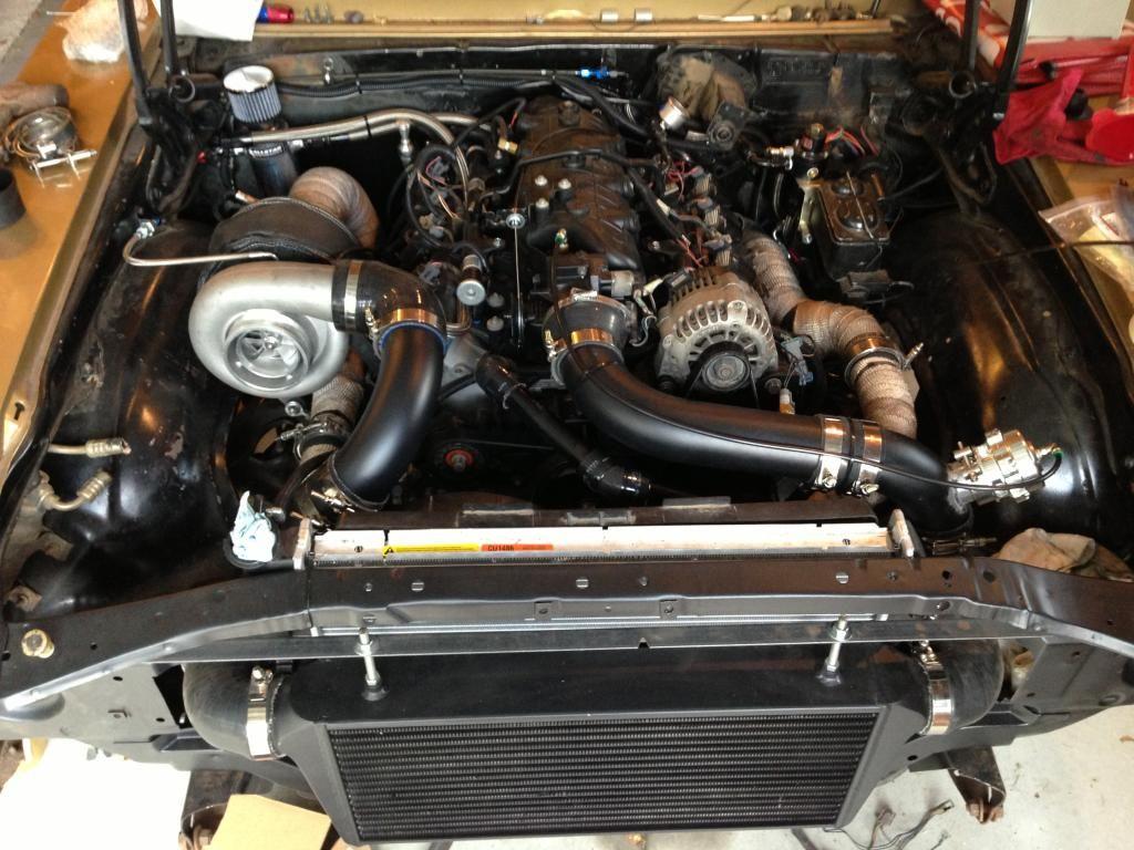

Here's the only helpful picture I have. The two bolts for the engine mount go up top and in the forward portion of the plate, right on top of the front two engine block bolt holes. These front two engine block bolt holes should be countersunk in the conversion plates.

Geez!
Good luck closing the hood with tha lol!
With those mount there I would look on the lower front passenger side of the block.
If you have setback plates they will cover where the AC compressor bolts up.

Originally Posted by Gooker928
Geez!
You mean that hood?
Closes fine.
