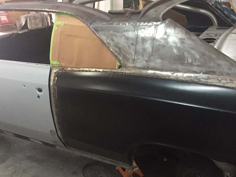

Parts are starting to go on!!! Didn't have my good camera, but here's a couple shots:
Driver's quarter and door skin:
Taillight panel:
Passenger quarter:

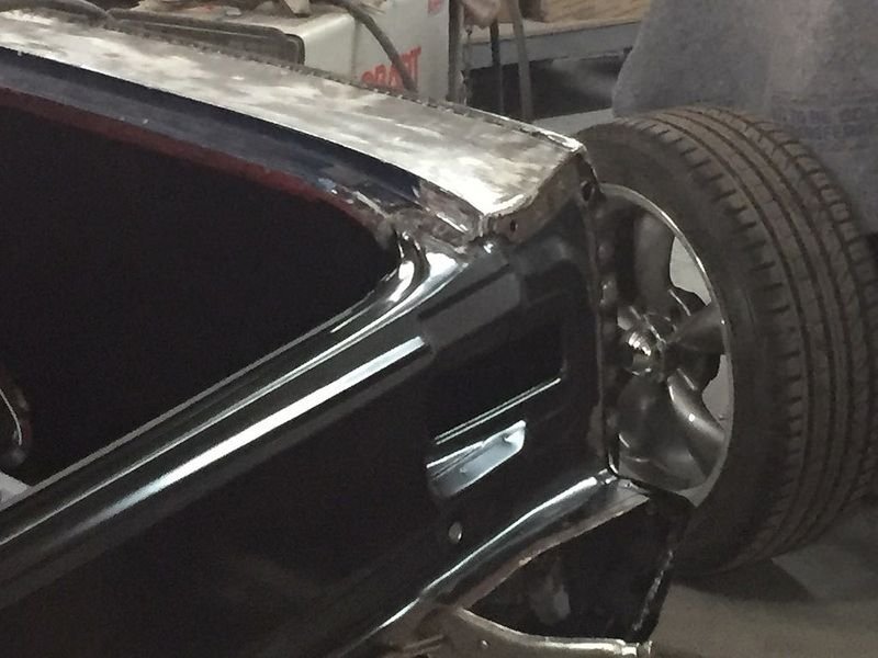

A little more has been done. Quarters completely welded and ground down, patched the drivers sail panel (or c-pillar), inner kick panels patched and tail panel welded. Has to order the very rear crossmember and a couple trunk braces as those were pretty trashed. Slowly but surely. A LOT of $ is going into the body shop, but I'm glad to be fixing it right.
Quarters:
Inner kick panel:
Tail panel:
C-Pillar:

Looks like we might be finally finished cutting out the rusty parts, patching and replacing pieces. The final pieces were the back of the rear wheel-housings where they meet the trunk floor and the rear braces where the body mounts to the trunk. They were almost completely gone. Someone totally botched that area to the point I had no idea what to look for for the replacement pieces. At any rate, I found them and they are now back in.
Cut out and ready for new pieces:
You can see some of the repair to the rear wheel-house. Still needs to be cleaned up:
Passenger side:
New brace:
Drivers inside frame rail:
