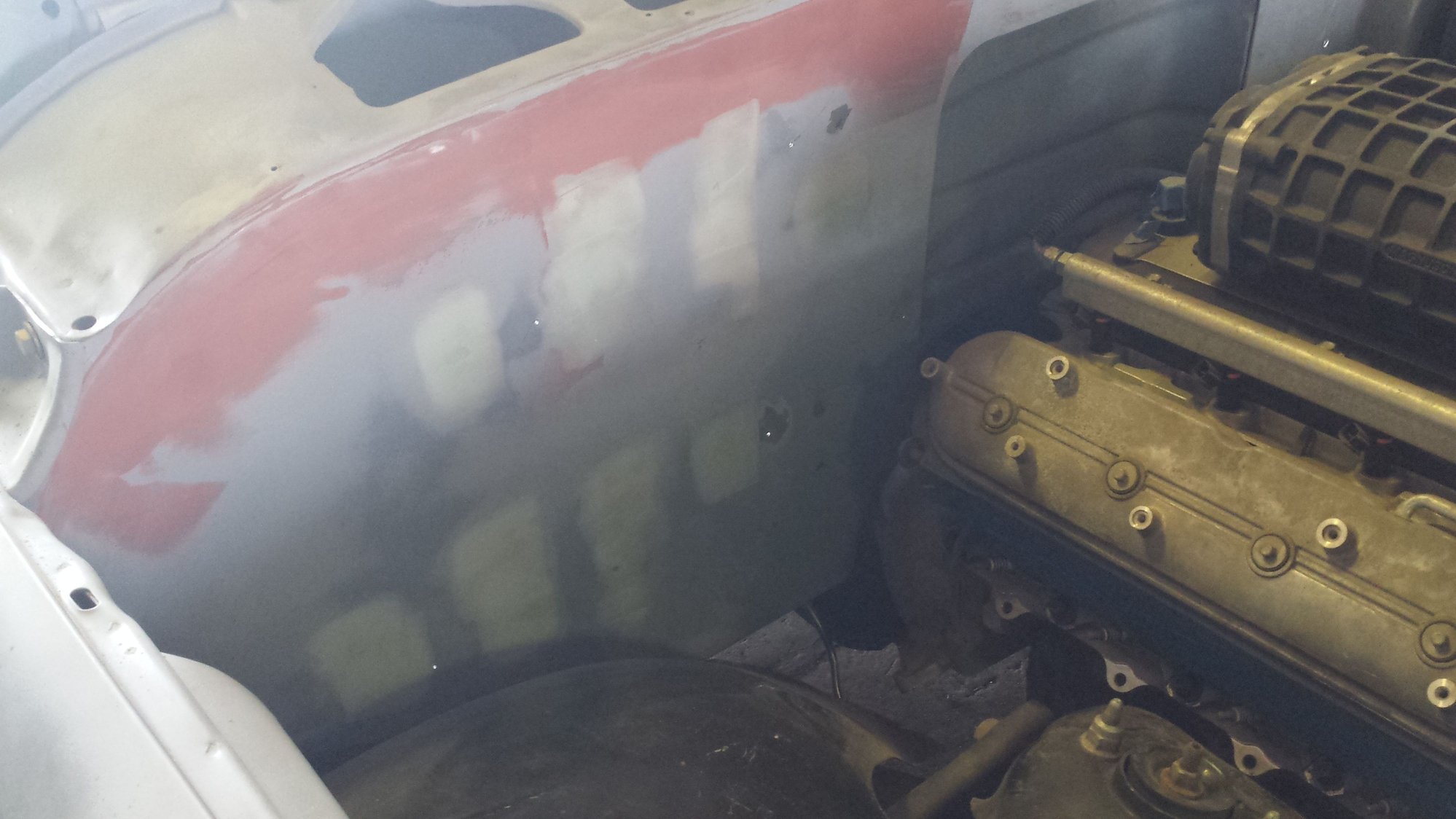

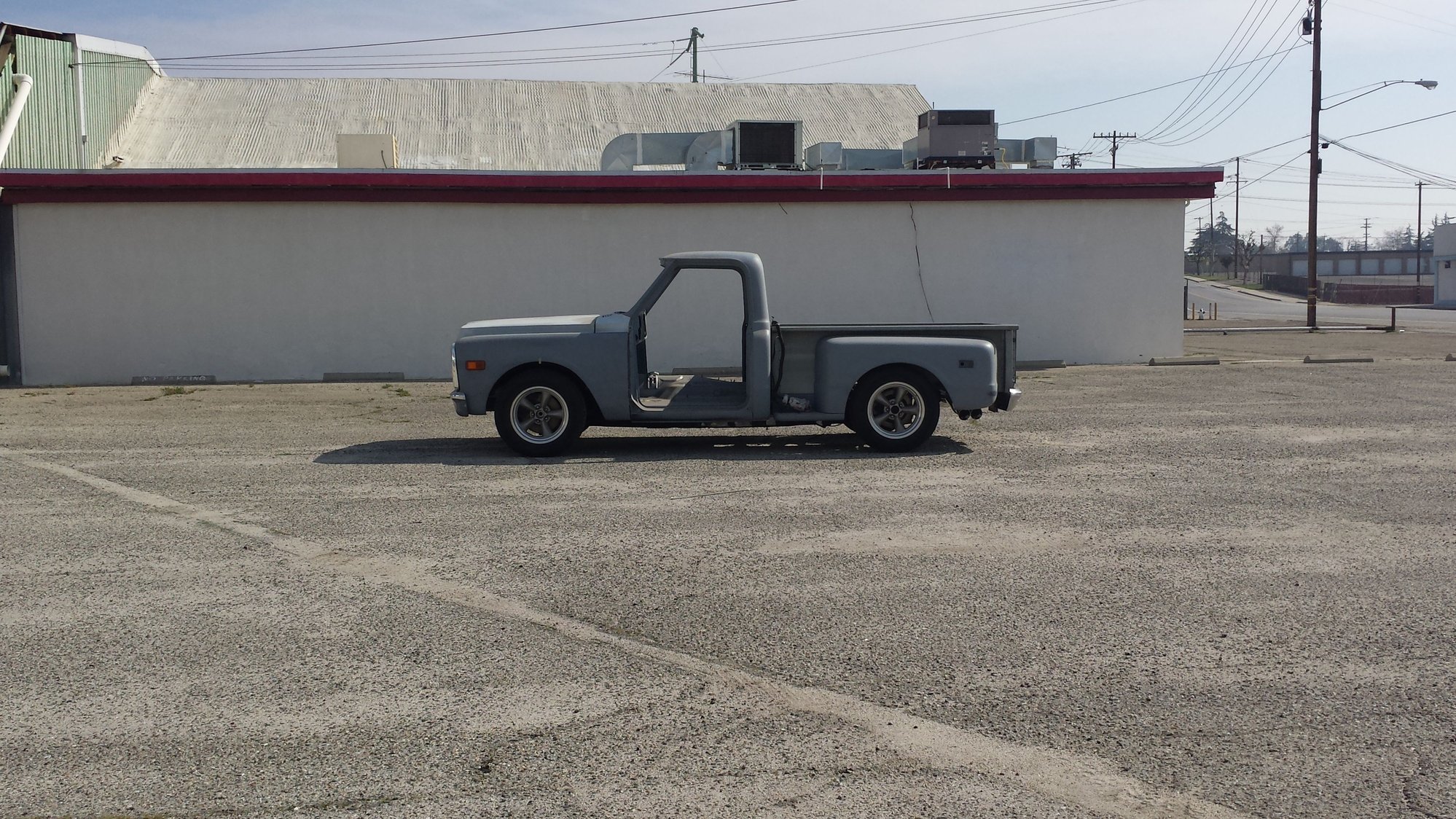

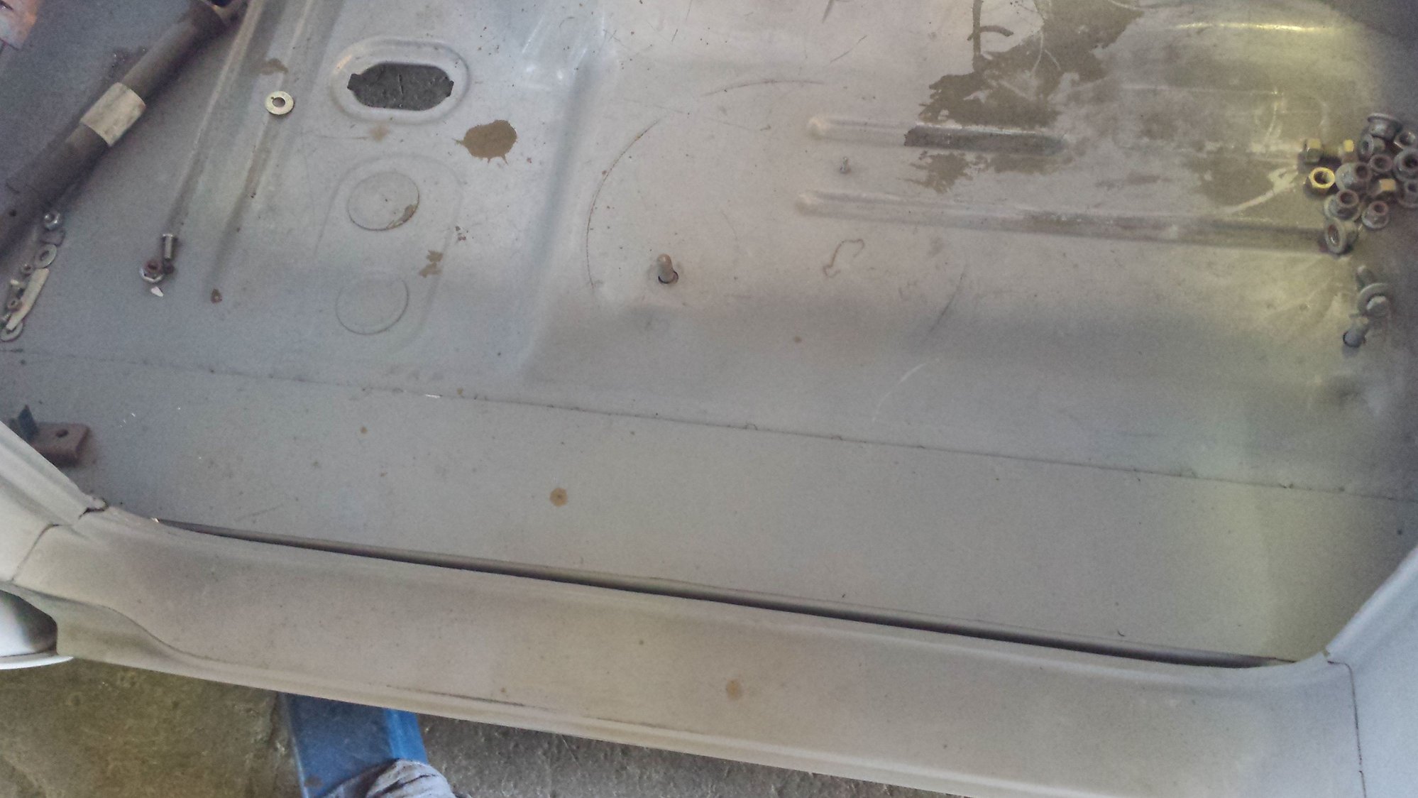

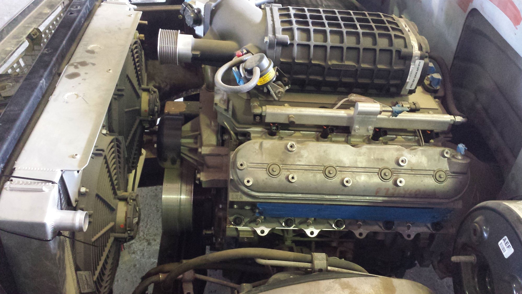

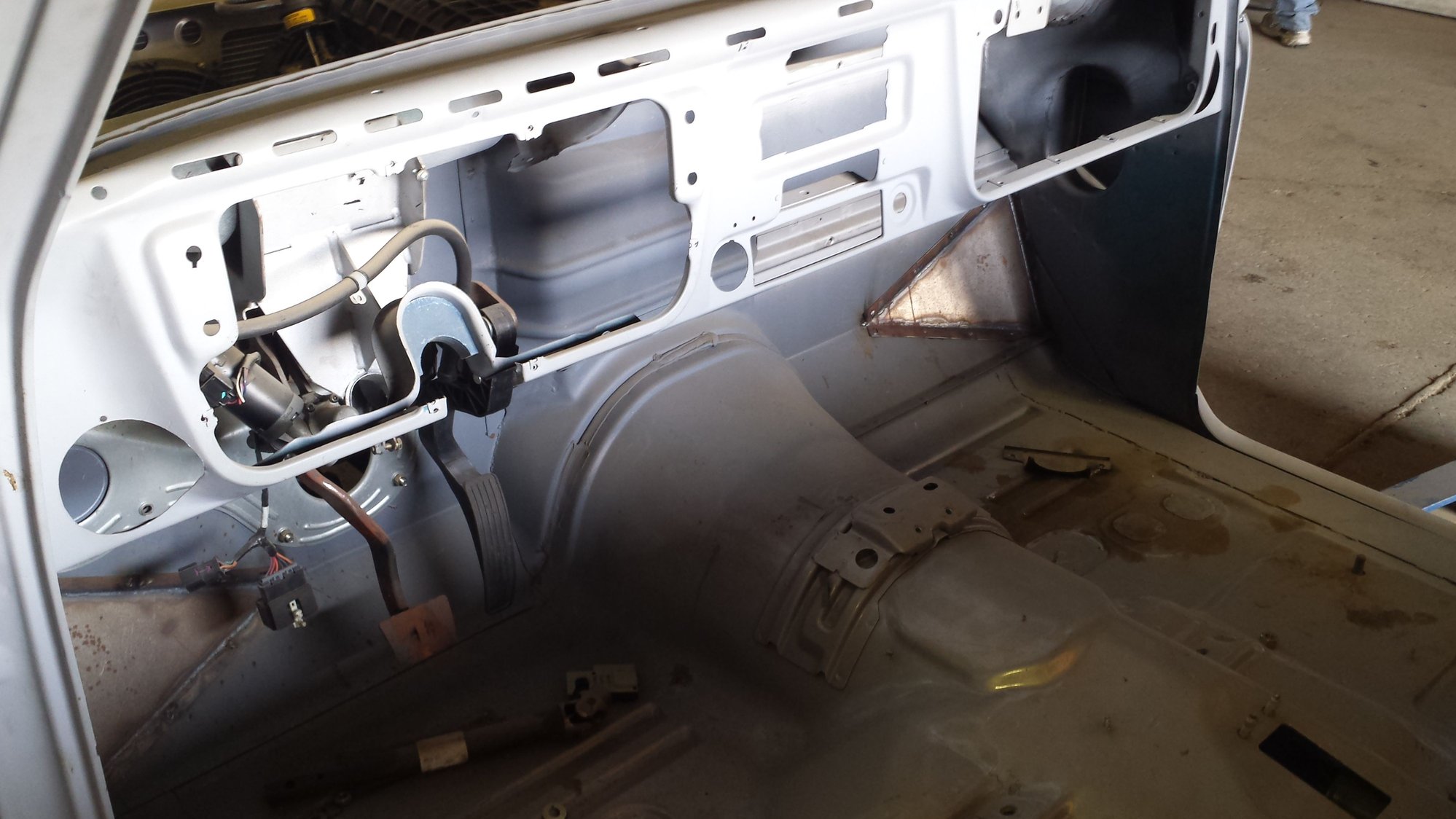

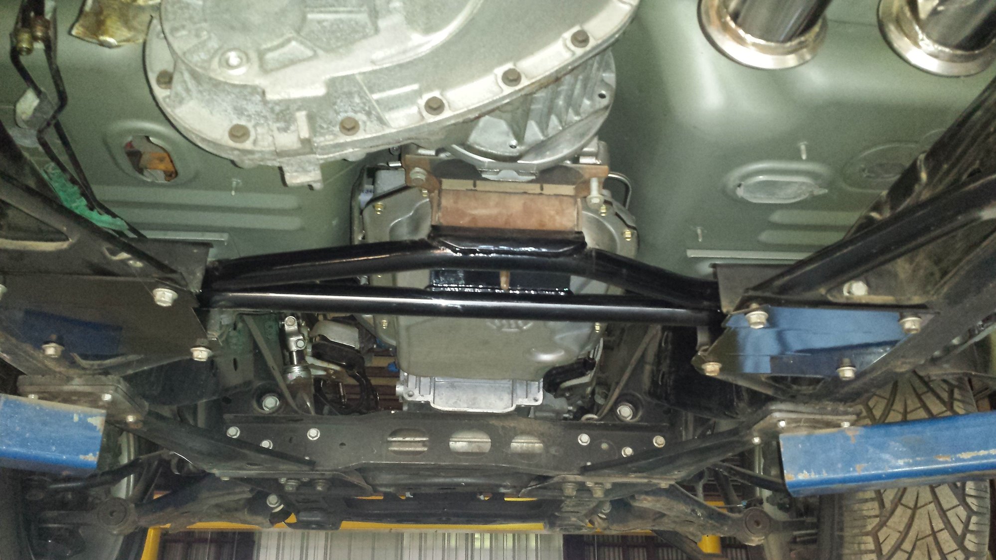

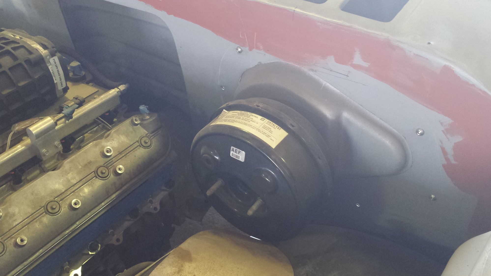

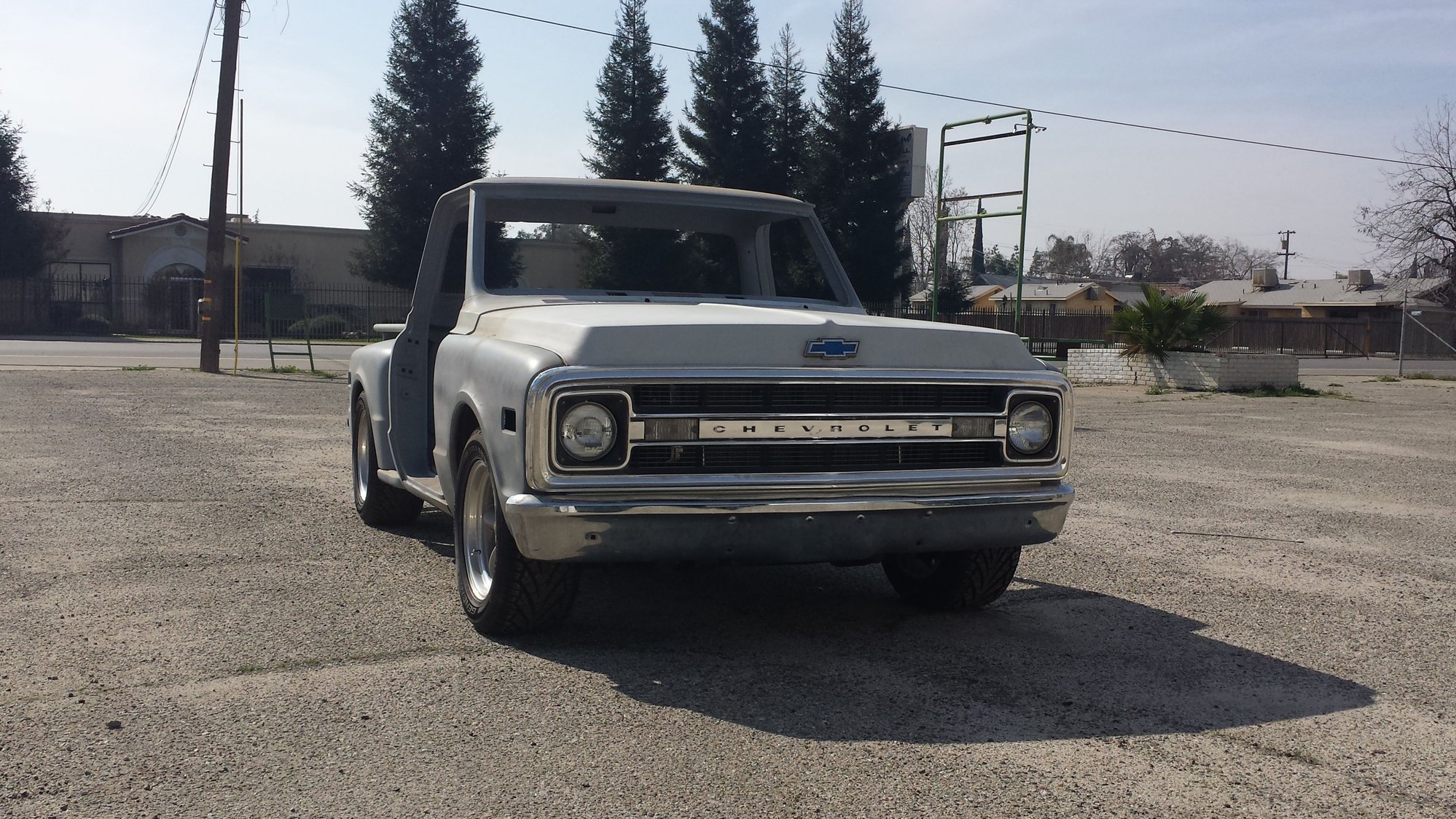

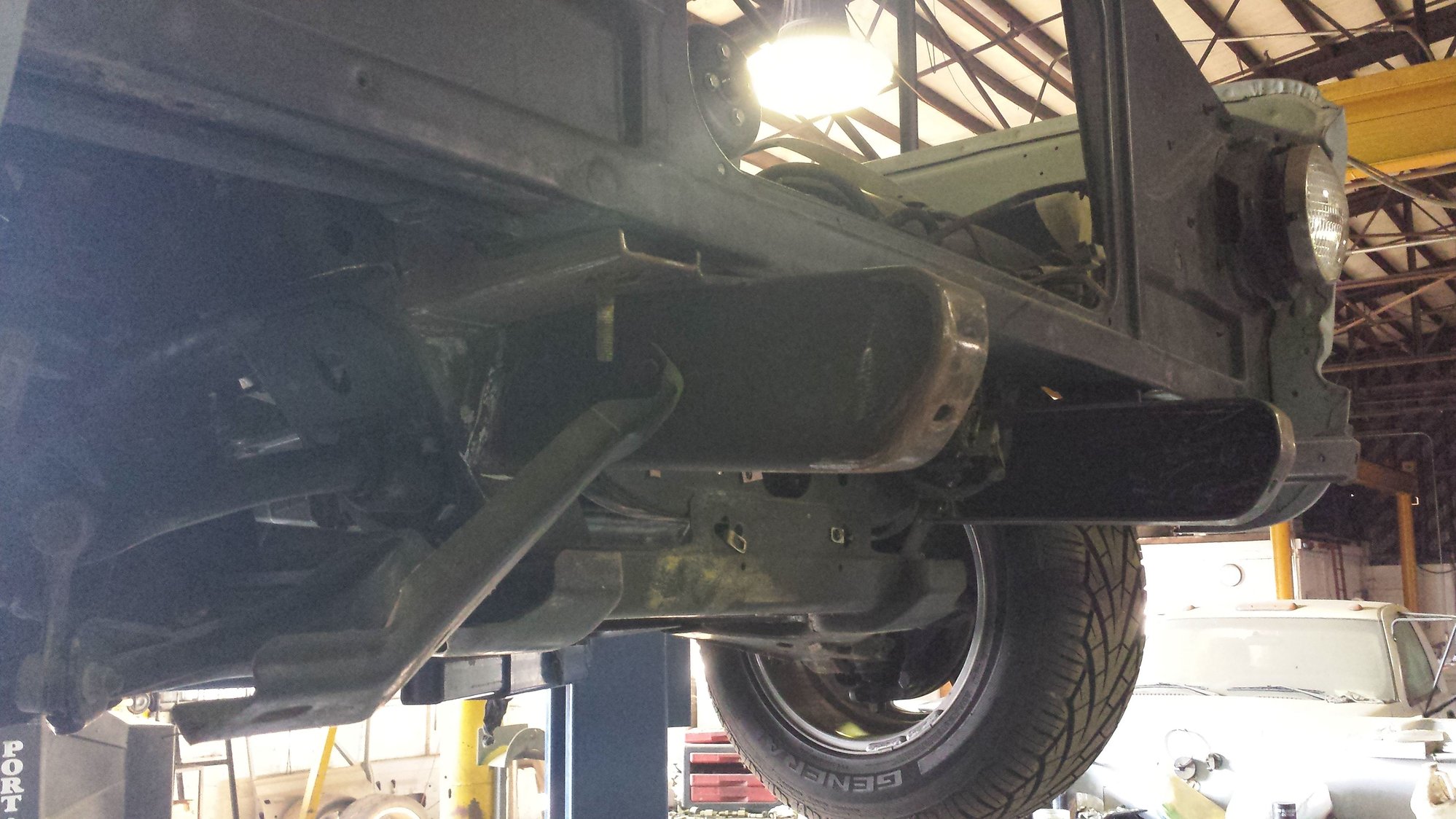

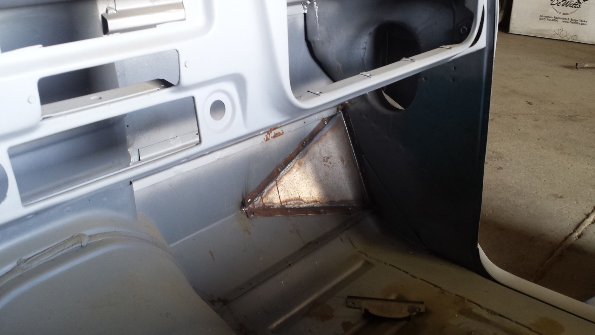

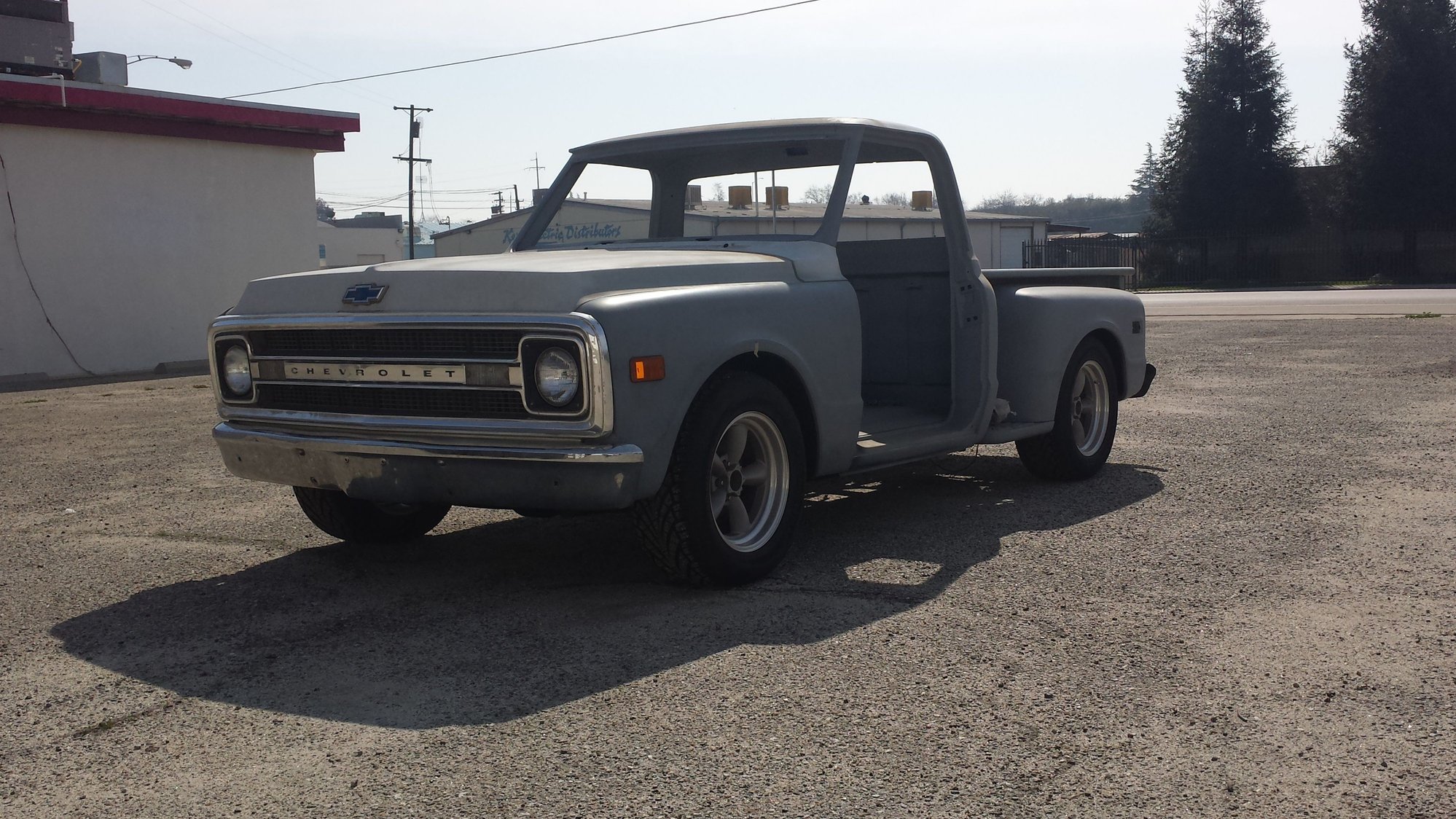

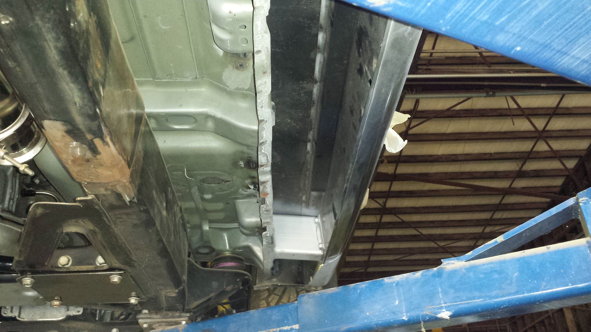

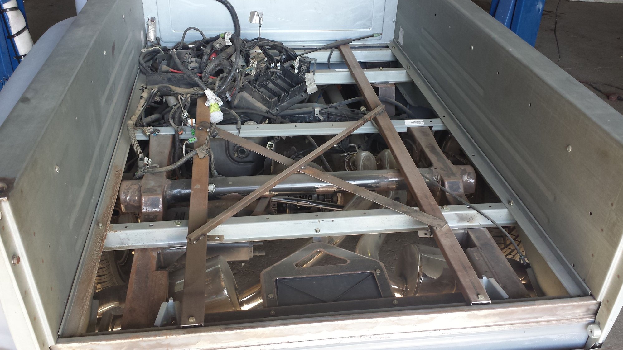

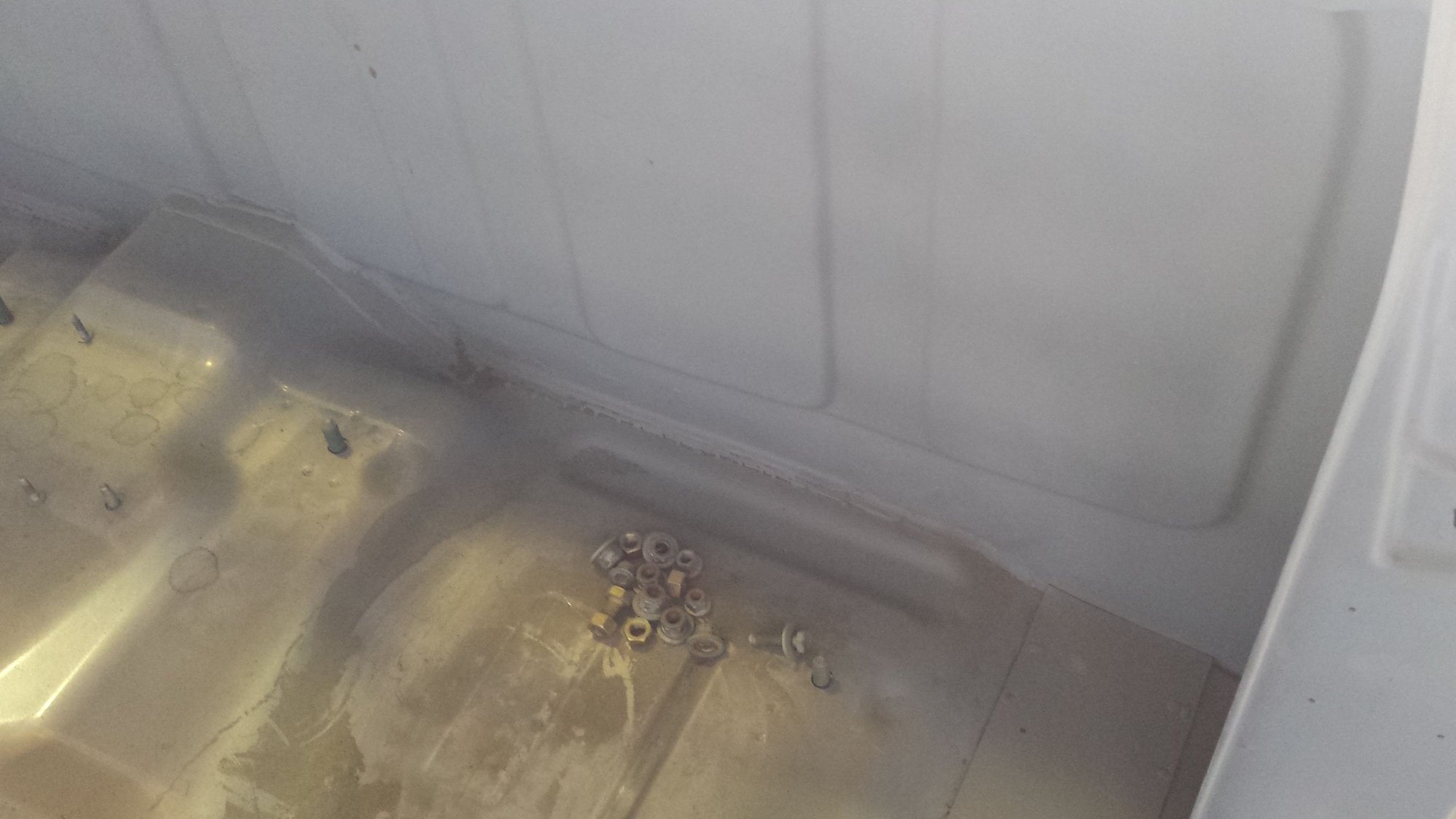

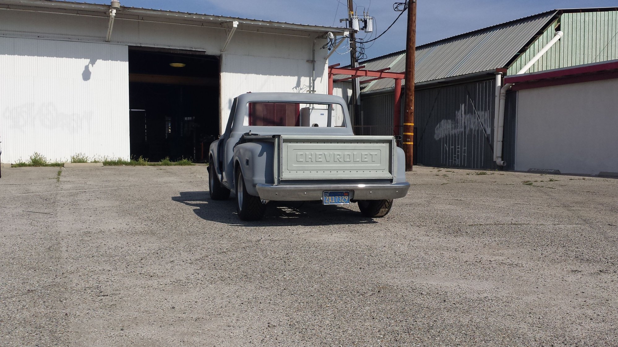

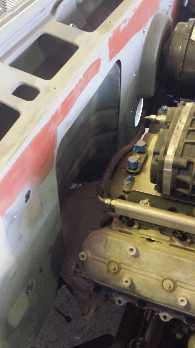

This is my dad's project that he started back in 2010. He got so busy at work, the C10 was put on the back burner. Work's finally slowing down for him so we're started back up on it this weekend.

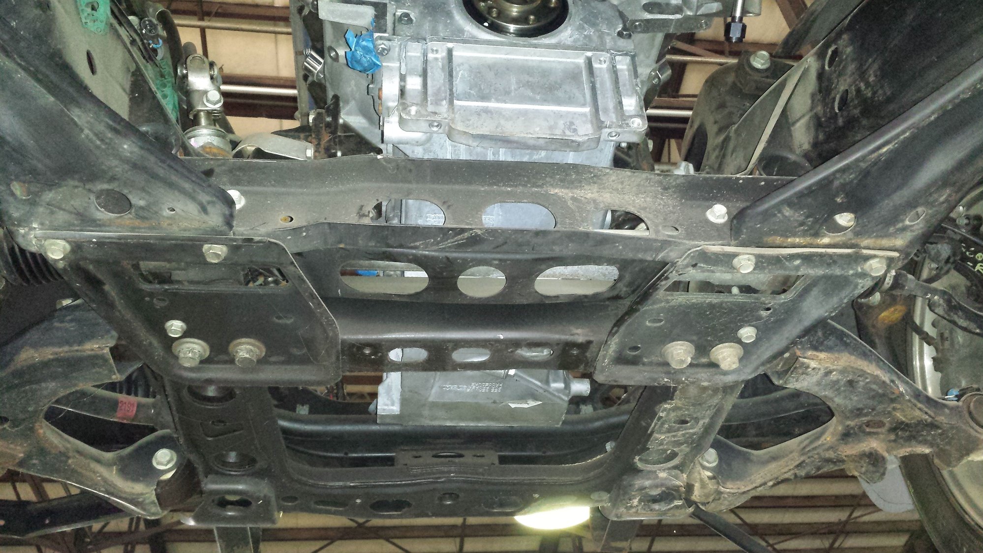

Some details: It started as a 4wd 1970 C10 and a rolled 07 Trailblazer SS. His intention was to adapt the TBSS AWD to the C10, but after some measurements, he found out the frames were really close. So the project became a fully body swap. The entire chassis is the TBSS. The C10 cab even has the trailblazer floor pan now.dum
Here's a link to some info on the engine.https://ls1tech.com/forums/conversio...901bhp.htmldum
The short version is its a Virginia Speed blown 427 LS2. It made 901hp on the engine dyno. The tranny is a 4L80. My uncle fabbed up a custom exhaust using corvette bi-modal mufflers (looks awesome)
My dad's ultimate goal is for the truck to look like a nice sleeper. It'll be painted two tone green with a white top. The work so far has come out terrific.

Wow, this is really cool. Looks like most of the hard part is done. Now onto the fun stuff! I'm amazed how well all of that fit in there. The wheels are perfectly centered in the fender wells too.

Was the wheelbase correct? I am planning on doing something similar, but with a 2000+ tahoe/yukon 4x4 frame and suspension because the wheelbase is almost perfect.
Also, where did you get the 4l80e to tbss transfer case adapter? When I had my tbss I know they were pretty pricy still.

The TBSS frame was lengthened 2 inches to match the wheelbase of the C10. In regards to the transfer case adapter, he can't remember who it's from, but does remember it was pricey. It was purchased 4 years ago or so.

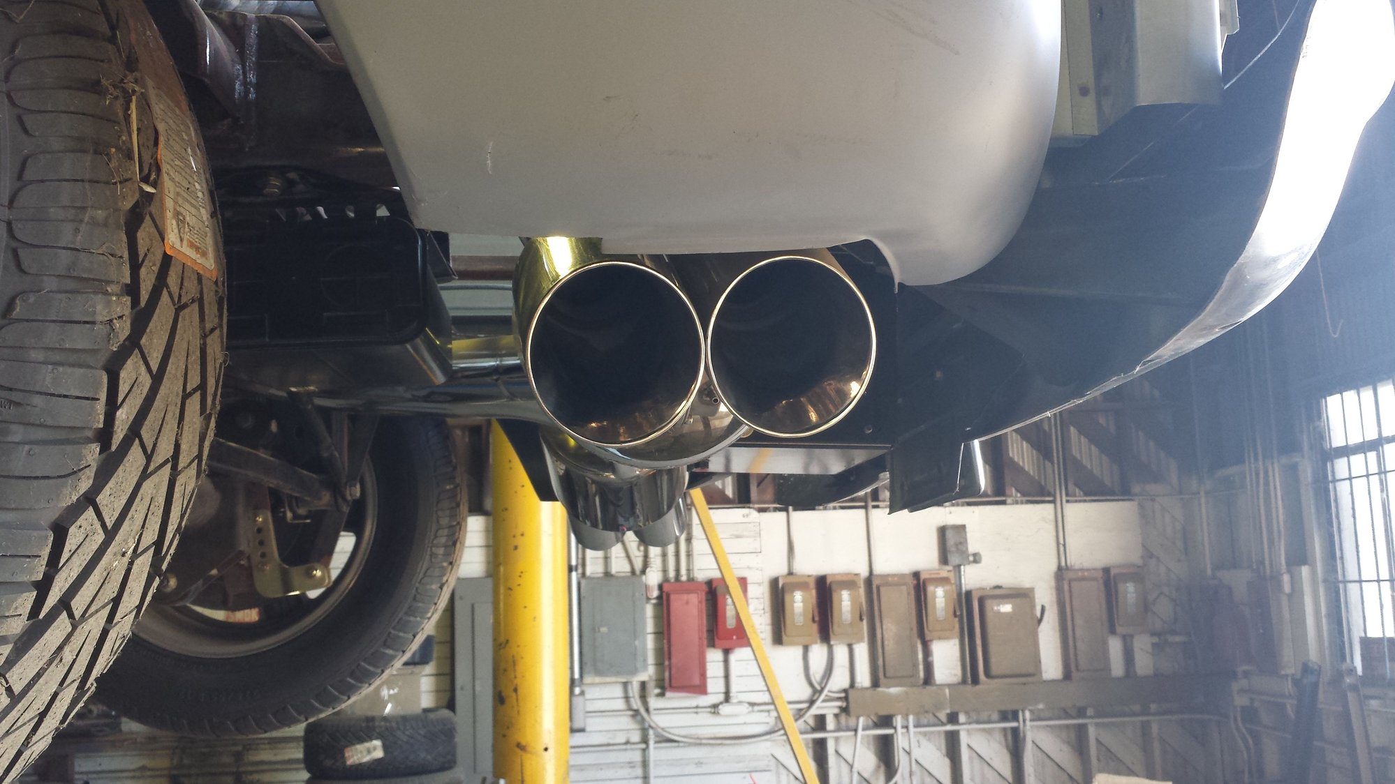

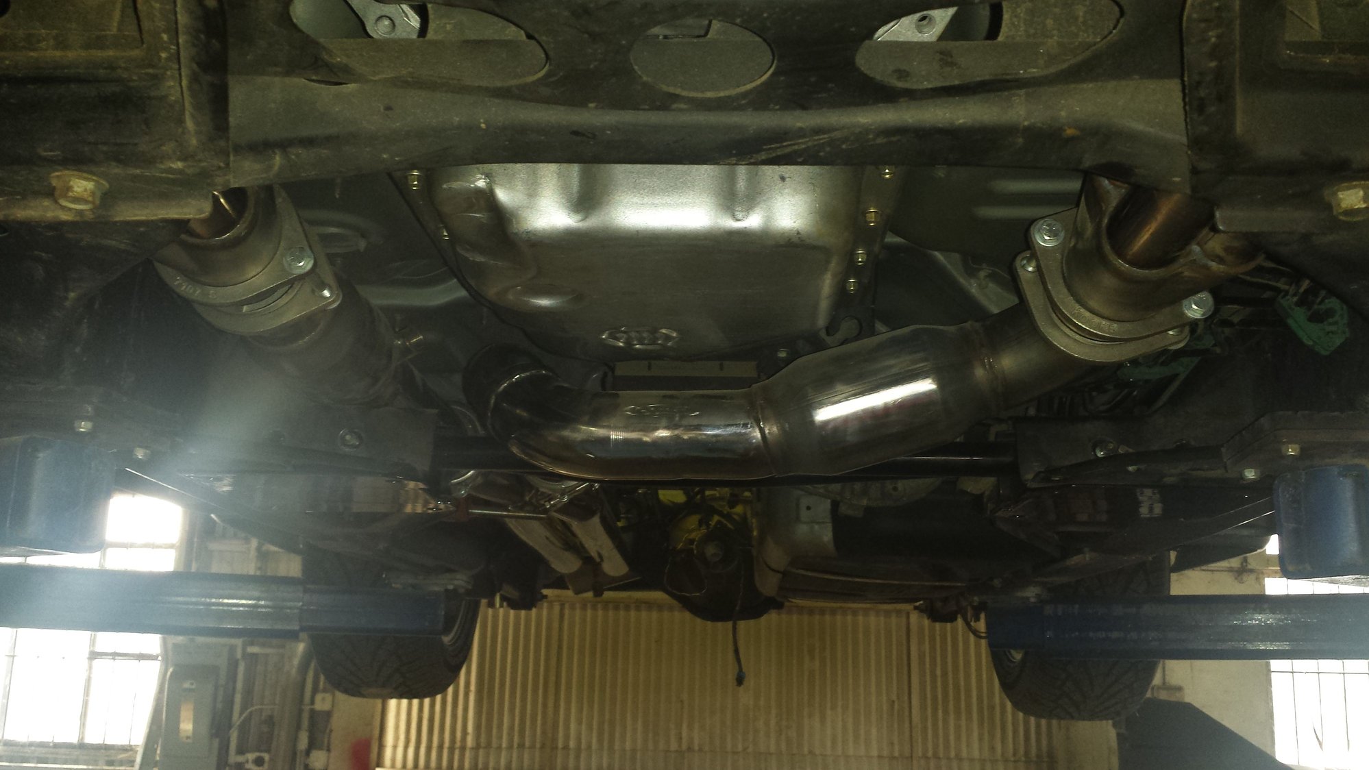

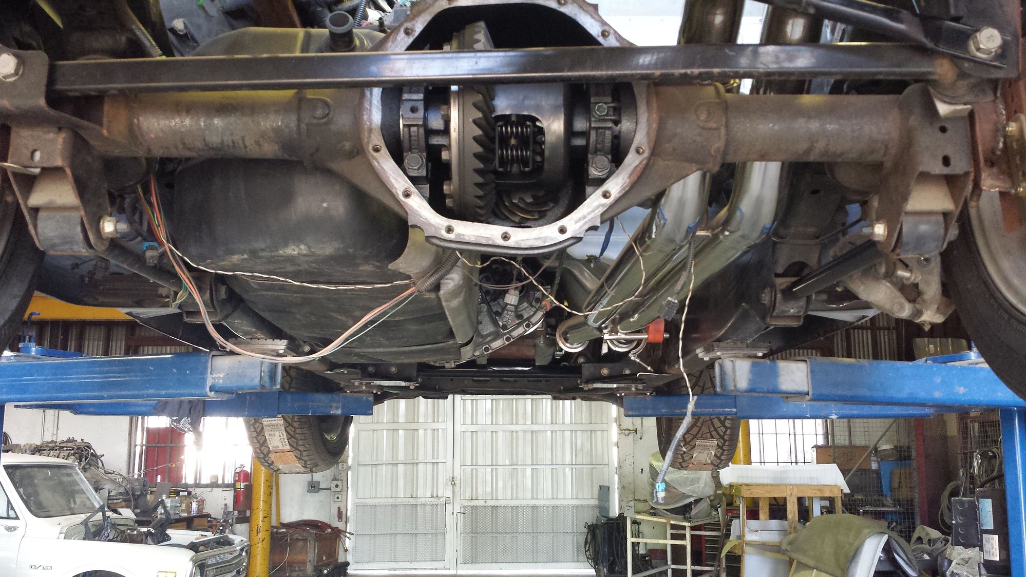

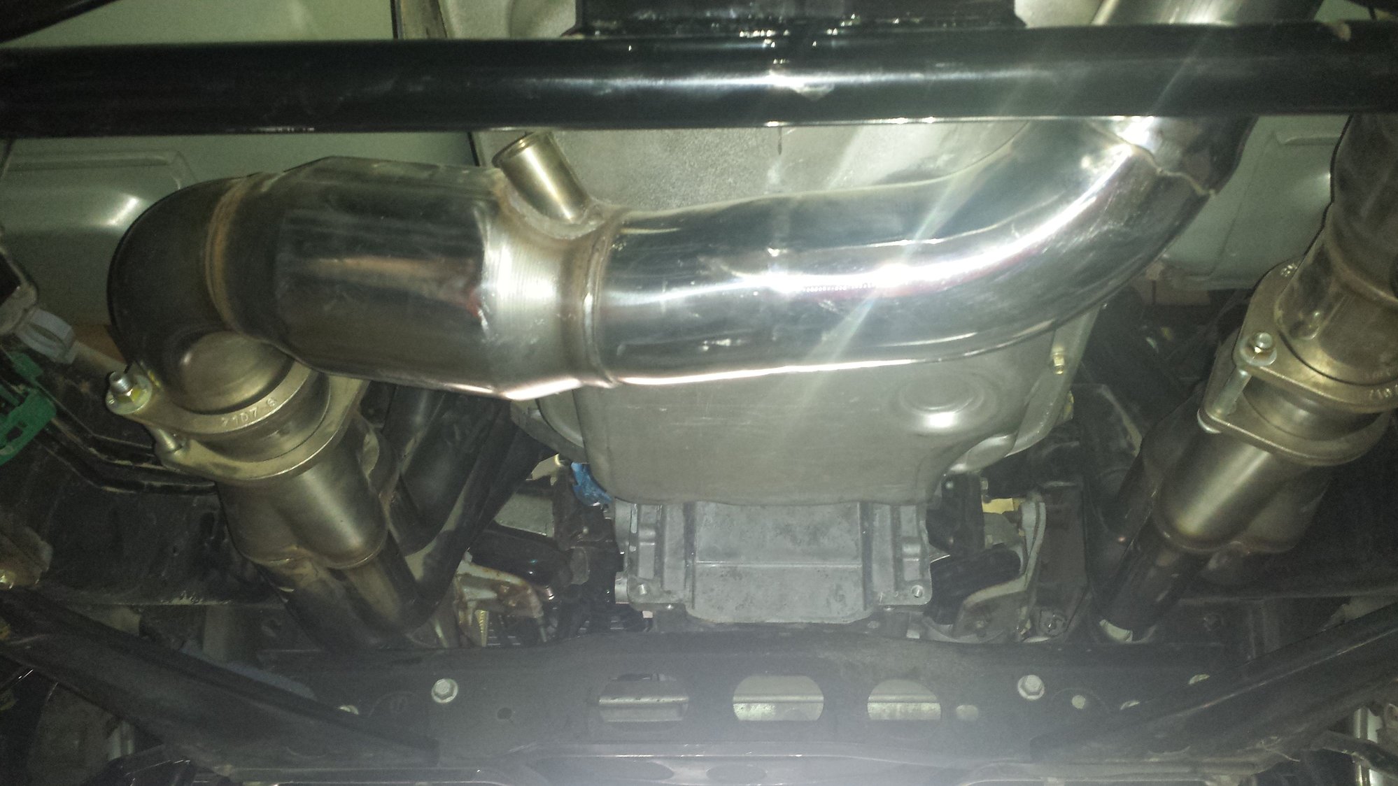

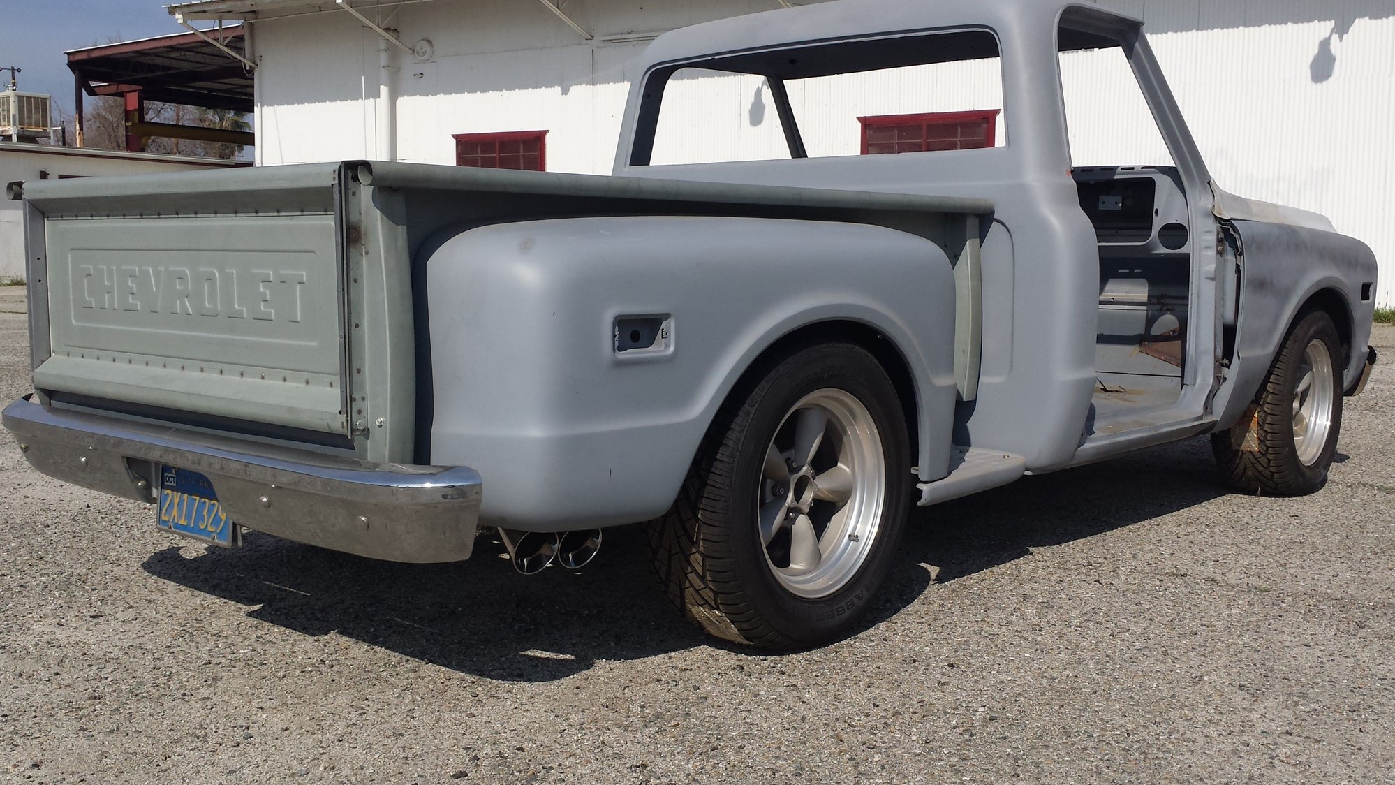

Here's a couple pics of the Kooks headers and the rest of the exhaust. No clearance issues!
