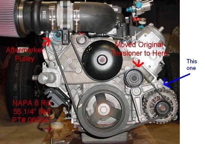

Originally Posted by 1964SS
1998-2002 F-body uses a low driver side alternator mount. I'm sure you could alter this somehow to drive alternator only without the water pump.
Not sure about his tensioner, but see pic 2.
https://ls1tech.com/forums/carburete...10-6012-a.html
