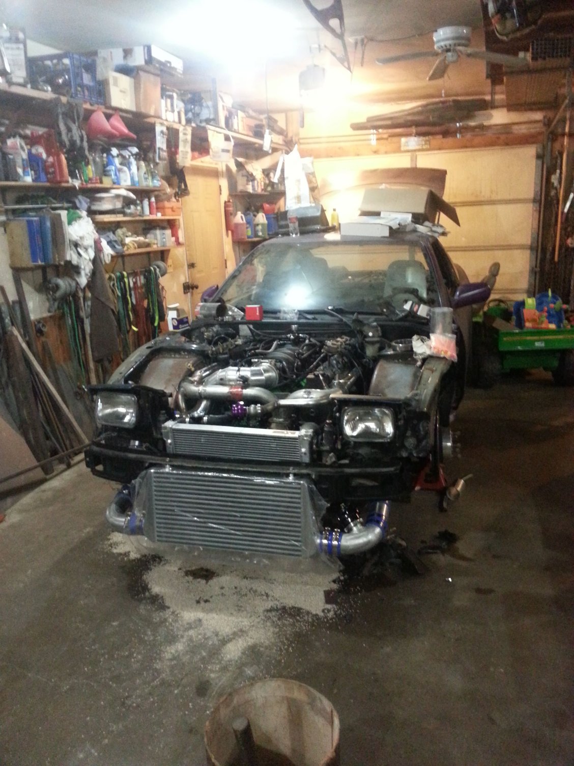

well im having cooling problems with my boosted ls1 in my s13 have limited room for a radiator 24 wide and max of 14in tall would rather have 12ish in tall i bought a cheap rad off ebay it was a Scirocco style but it seems like the coolant doesnt stay in the rad long enough to cool it off anything over 2k rpms wile driving it wants to go above 215 but if i keep it at 1800 it will sit at 210 so i was looking at these 2 rads just cant decide or if any one has some other input
i also have 2 9in fans that are 2300 cfm each

Post a pic of your set up if you can . Is inter cooler right in front of radiator? Ac condenser?trans cooler? Also you can put a 160 thermostat.

Well I seen another guy running that Arco rad I posted he said it cooled his sufficiently with only 1 fan on it I think single 12
I could fit a bigger radiator I would have to delete my headlight flip ups since I dont use them anyways but I'd also have to lower the radiator down I think my 2nd post was a 26x16 radiator I think I can make it fit
the fans I have should be good enough?
And swapping to a 160 thermostat isn't that more of just a bandaid letting it start cooling a lil sooner? It should still overheat if its going to right?

On an ls Motor a 190 thermostat won't open until the water coming from the rad is 190. I put a 160 in mine and now it runs 180 on hyway 190-195 with Ac on in traffic .ls motors are opposite sb chevy ,the thermostat is on the inlet side. How are u running heater hoses? Therm also needs coolant flow at heater hose location to open properly u can loop them or have a 4 way mixer valve. The other thing I noticed is the plastic bag on the intercooler.

my heater lines are plugged and not looped everything i have read plugged is better then looped the bag on the intercooler was before the car was running i just dont have many pics of my car but the thermostat is also designed to open from the coolant being warm enough on the back side since it circulates right there anyways right?
