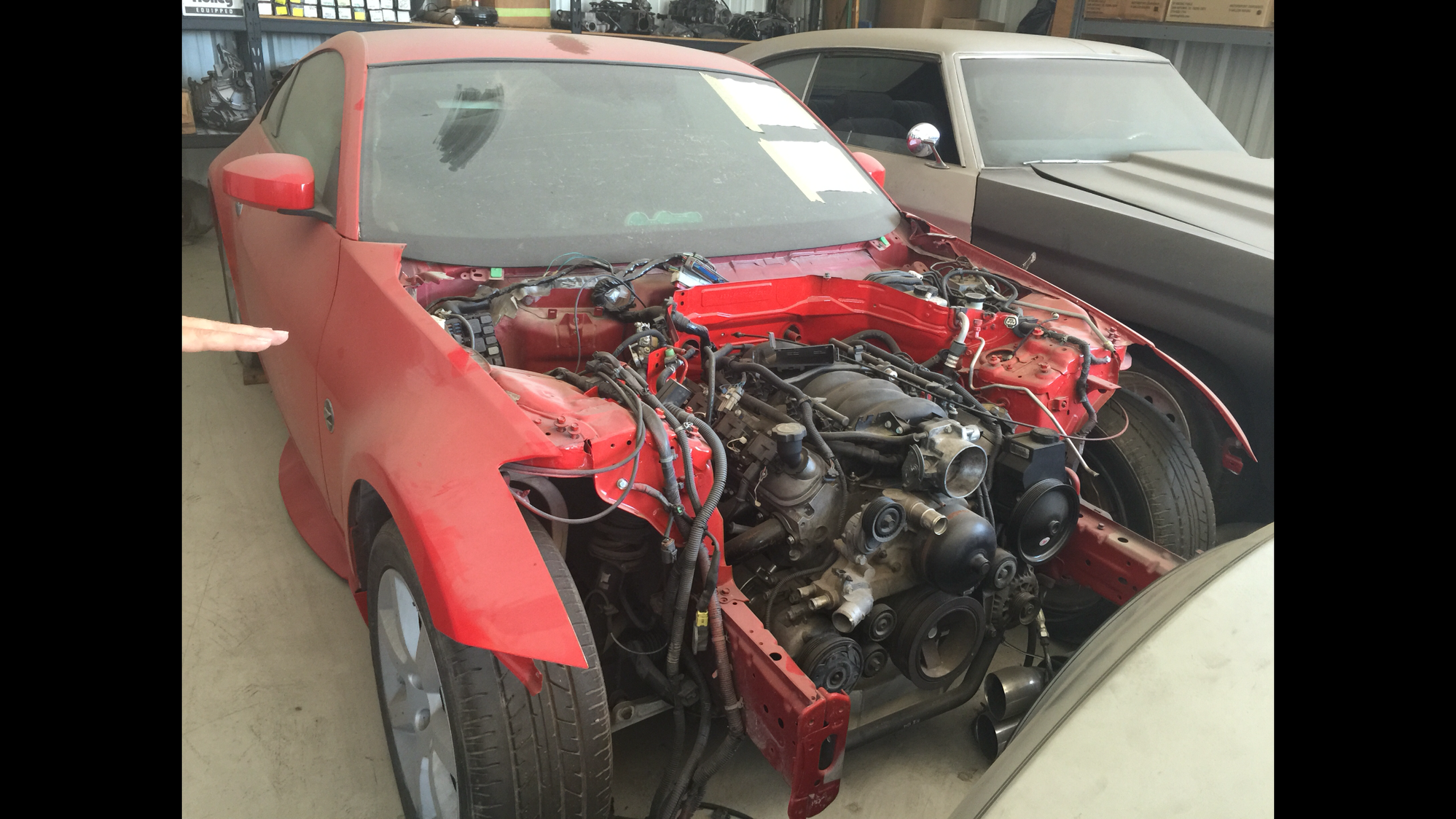

Hello everyone I'm finally building LS 350Z��. It's been a very long time coming but here we go. I bought the conversion kit from Sikky including their Master cylinder, 1 7/8 headers, solid rear bushing, wiring harness and power steering line. The computer is out of a 2002 camaro wich makes it a dbc. As of now the engine and tranny are put in and all the rest is left. I'm trying to keep things on a reasonable budget since I'm having a house build. If you gents could please gid me the right way with the rest of the parts that would be great. Oh and I need to replace the fuel tank. The one that's in there is dirty as heck and no one in SA will clean it. I need to find a solution for a replacement. A stock one is priced at $700ish. Here's what I need of the top of my head
- speed hut Tach
-fuel system
-catch can's
- radiator and fans
- rear exhaust
This car will be a DD so AC is going to be put in. If you gents who have done these swaps help me find the parts I need or some in site on some does and donts that would be great. I'll post a pic as soon as I learn how lol.
