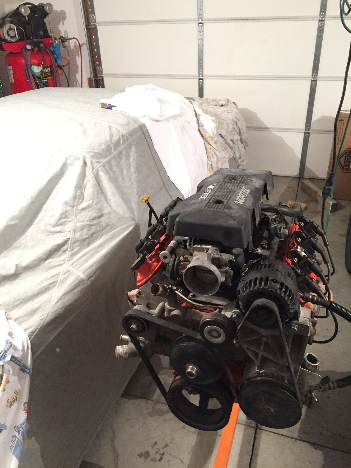

So finally got my motor. 5.3L LM7. 100k+ miles. Not bad for what it is, and the price was right. $800. LS6 cam, 706 heads.
