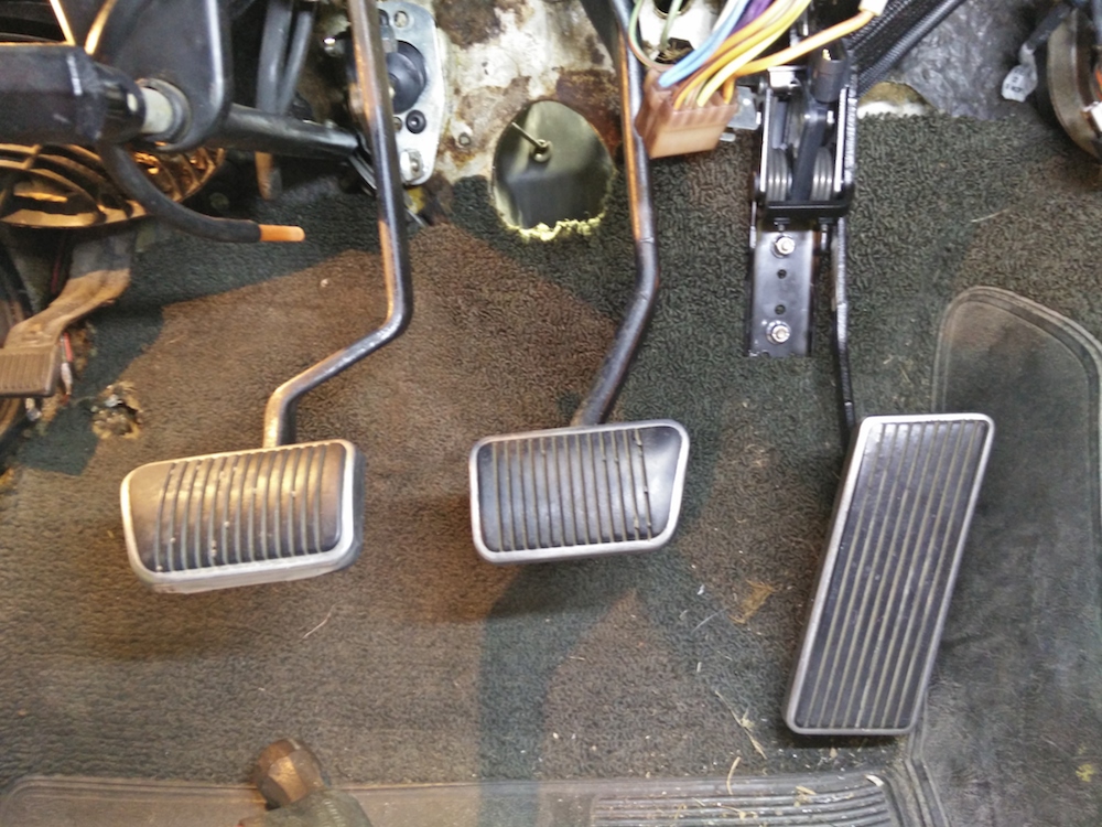

Non-adjustable:
Adjustable:

The plastic 'rheostat bit' on the top one (non-adjustable) looks very much like mine but without the sheet metal mounting bracket around the plastic and the pedal/arm is quite different. If I mimic the angle of the Volvo pedal it looks to me like it will take a few spacers (spaced away from the firewall a bit) to put the new pedal in the same position as the Volvo pedal was. Took careful measurements before removing -- brake and gas pedal were perfect for heel/toe and I don't want to lose that. And it looks like I'll have to drill a hole in the metal arm to allow the pedal angle to be a bit less acute -- but I don't think that will be a problem. So, for now at least, I want to stick with this brand new one I just bought.

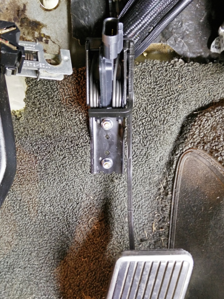

I don't really know how much movement it has, but I have one in the GTO and the Cougar and driving feels very natural. I like it because it has a simple flat mount that is easily adapter to most firewalls. I also like the way the lever is angled. On my Cougar I was even able to adapt the original pedal to the lever.
Here are some pics from the Cougar install:
