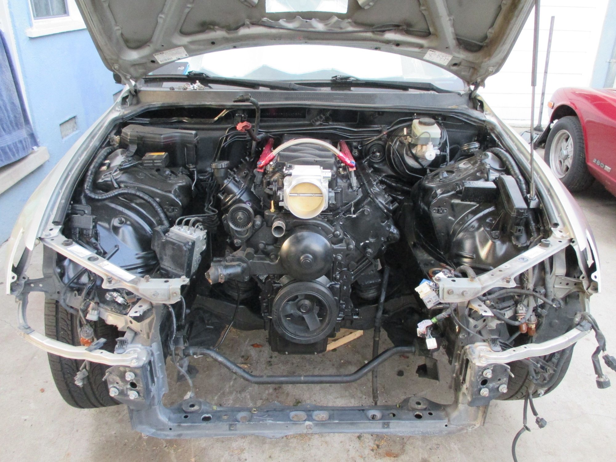

hey need some help from you guys. doin a ls1/4l60e into a 03 is300. need a little bit of help with wiring. i know the LS stuff up and down but need some help wiring it to the lexus stuff and making the gauges, fans etc to work as one. at the moment i have a 99 5.3l harness that i need to break down. i was goin to buy the Dedicated harness but i heard it work more for t56 and not the auto as much.
any help is greatly appreciated.
random pics of the car. lol
