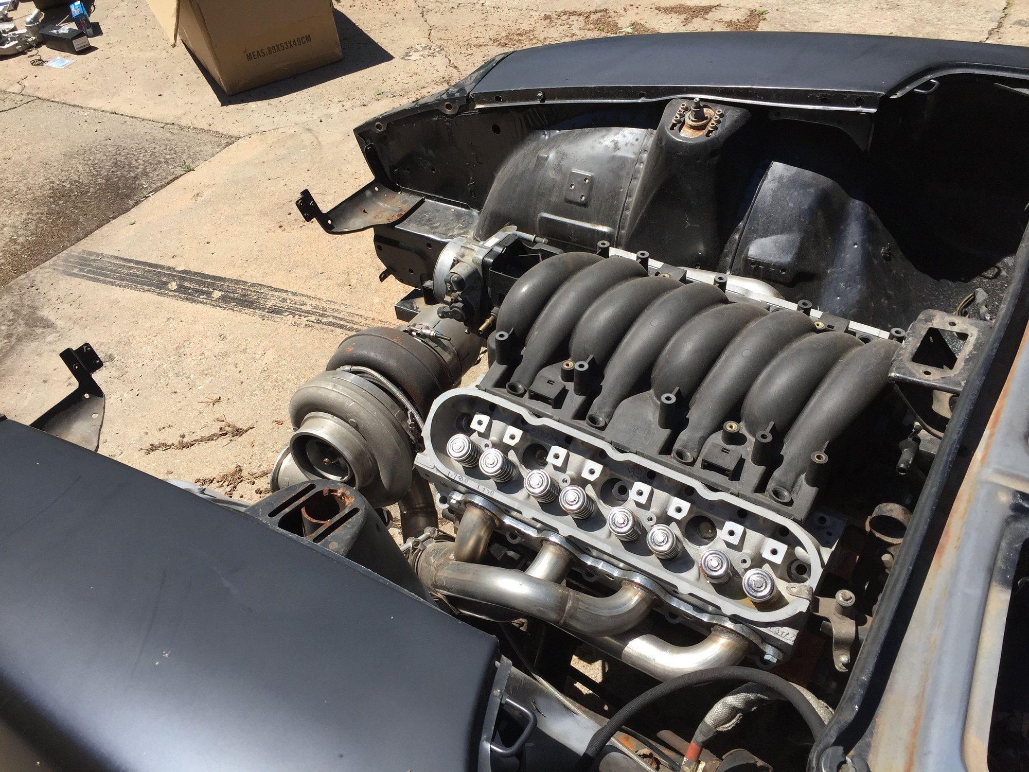

Starting yet another build. Finishing up the '65 C10, making progress on the '65 Continental, and now this. My buddy is abandoning a 280z project we started a few years ago. I got out of the Army and moved back to Austin, and he's getting stationed overseas, so i'm buying it and finishing it. Car was originally a 1jz swap when we first picked it up.
Has a 6.0/t56/single turbo in it now, all of which will be going in our '72 Camaro SS.
He already did the 8.8 IRS swap, but once I get it in the shop and on the lift I'm going to take a look at it and might end up changing it.
I still have the Weld RTS's off the turbo 5.3/t56 Volvo Wagon I built a few years ago, so they will go on this car. Along with a new set of black CR1's that I've had in the shop waiting for a project to go in.
Some of the work he's already done to it:

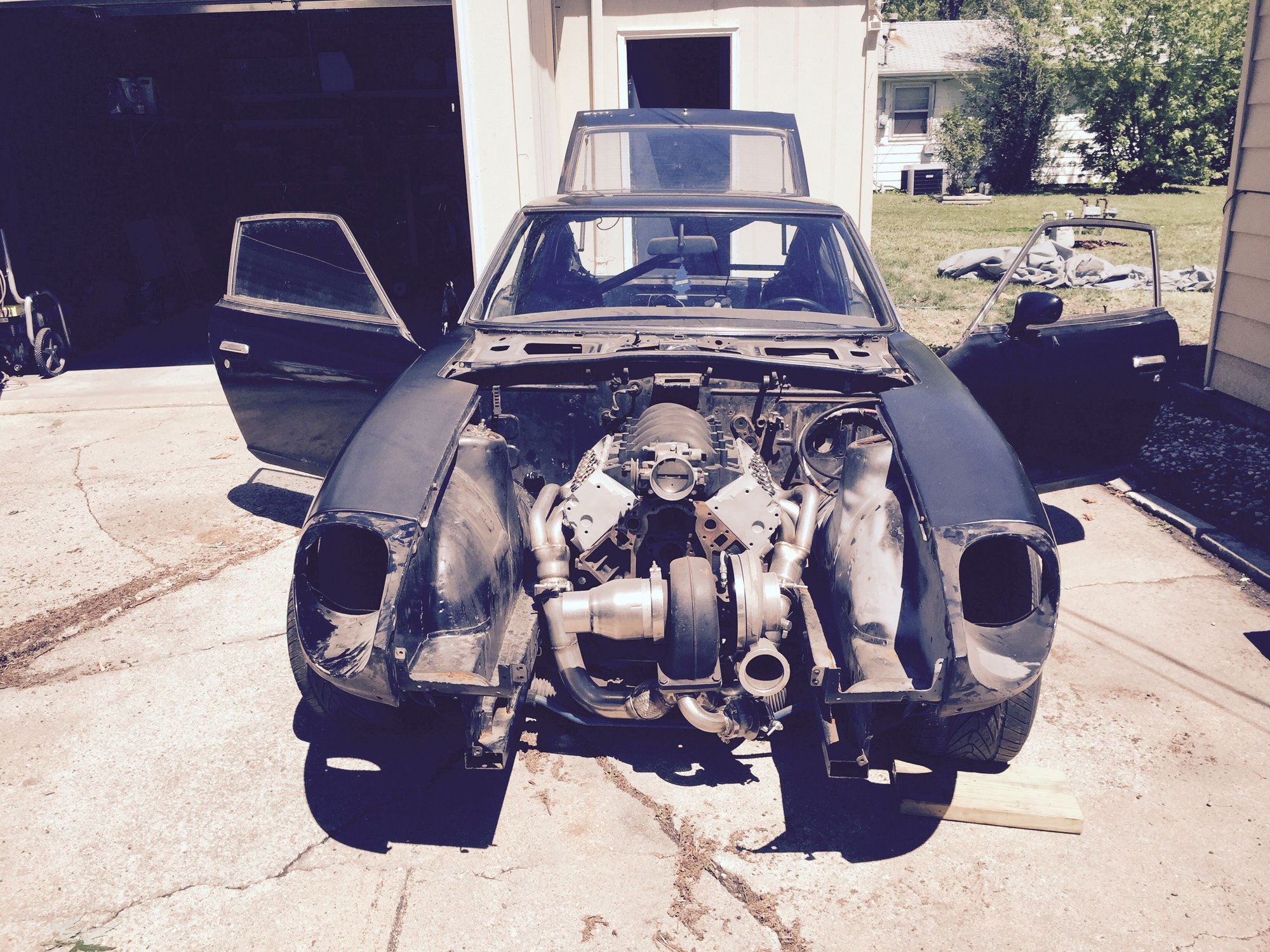

Not sure what they were planning for control arms in the front, that should be fun.

I need to figure out a front end. They pretty much built a full frame under the car, so the stock k member won't work. It's tacked on the frame rails just to move it around for now.
8.8 is actually a lot further finished than I thought. I just need to reinforce it a little.
I'm going to strip it down and prep it for paint (white) and then go from there.

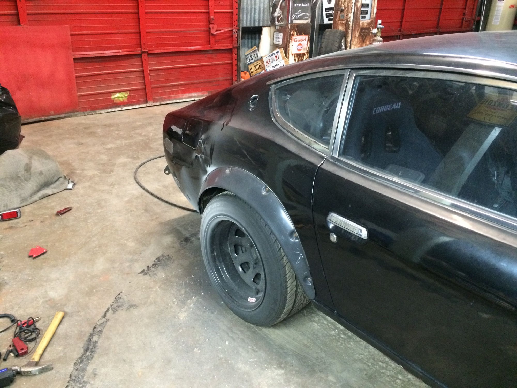

Shaved all the side markers, antenna hole, louver holes and started fitting the corbeau's in it. Need to finish a few pieces of the floor pans first.
