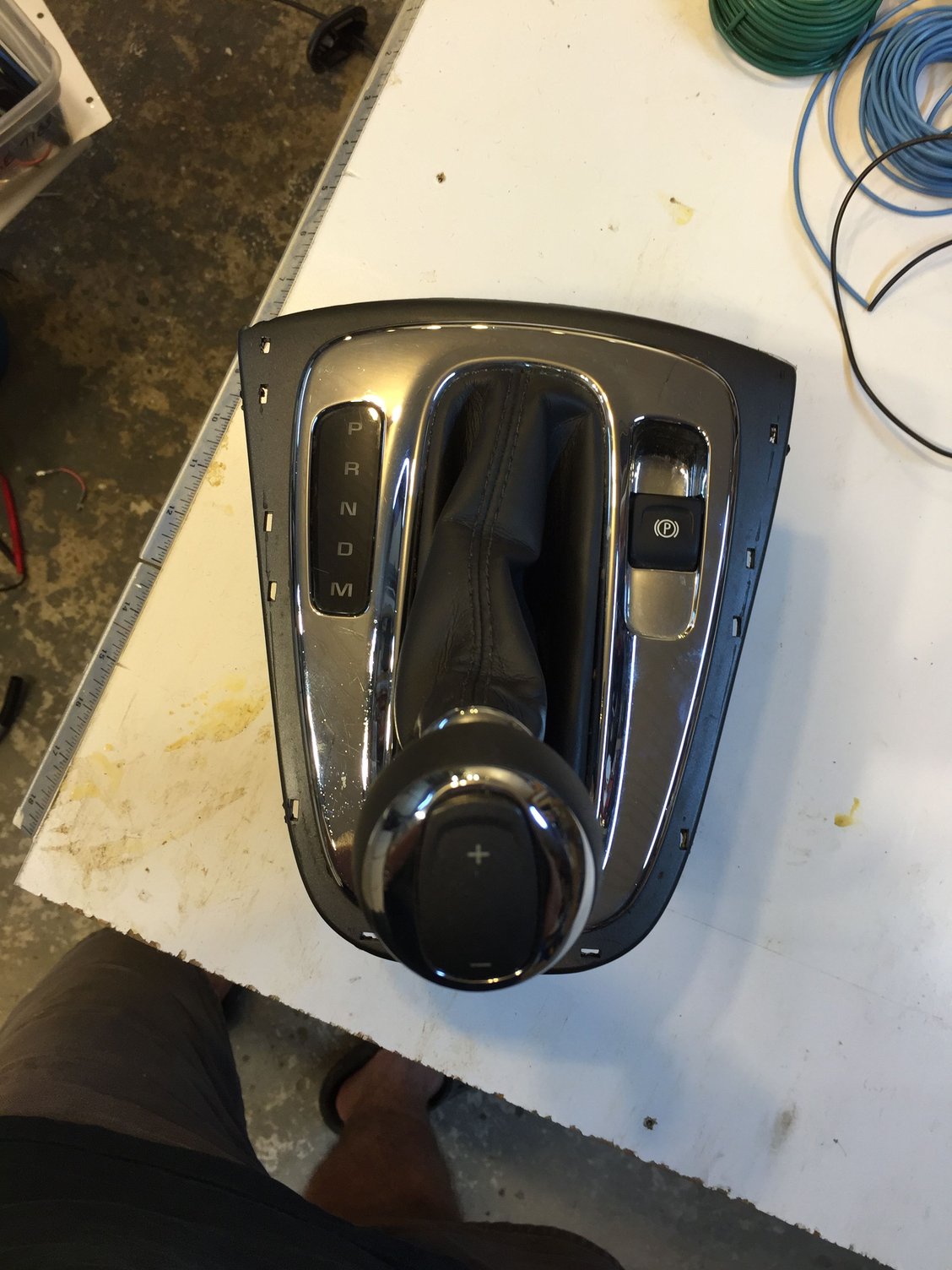

This is a 2013 Malibu shifter that I will try to incorporate some or all of it. Main thing I really want is the tap shift operational

I looked at that same shifter and almost bought it but I ended up buying the one out of the 2012 Malibu, that's a great-looking shifter!
