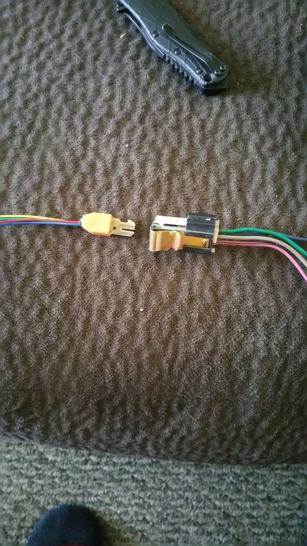

I saw your write up I took the guts out of a 1995 Chevy suburban it is 4 wires
These are the 2 switches I found
This is the pig tail that was in the 95 suburban it's different than the gen 4 camaro but I think it still should work.
Let me know what you think also going to try to maybe repaint the letters on the lever so you can see them.

Looks like you're on the right track, those are the pieces you need. You did good by finding two of them, I cant seem to find them around here any more, I guess I've cleaned the yards of them! Anyway, since you saw the write up you know how I do them, but the only thing I do differently now is find a long single q ire and resolder them directly to the switch, it makes for a cleaner job.
As for painting the lettering, I never had any luck with it so I had these stickers made. You need to paint the black part so that its dark and better matches, but it makes them look really nice. If you want one I can sell you one for 3 bucks shipped.

On the pigtail, they are wired as follows:
Pink-Ignition power
Gray-On/Off
Green-Resume/Accel
Blue-Set/Coast
