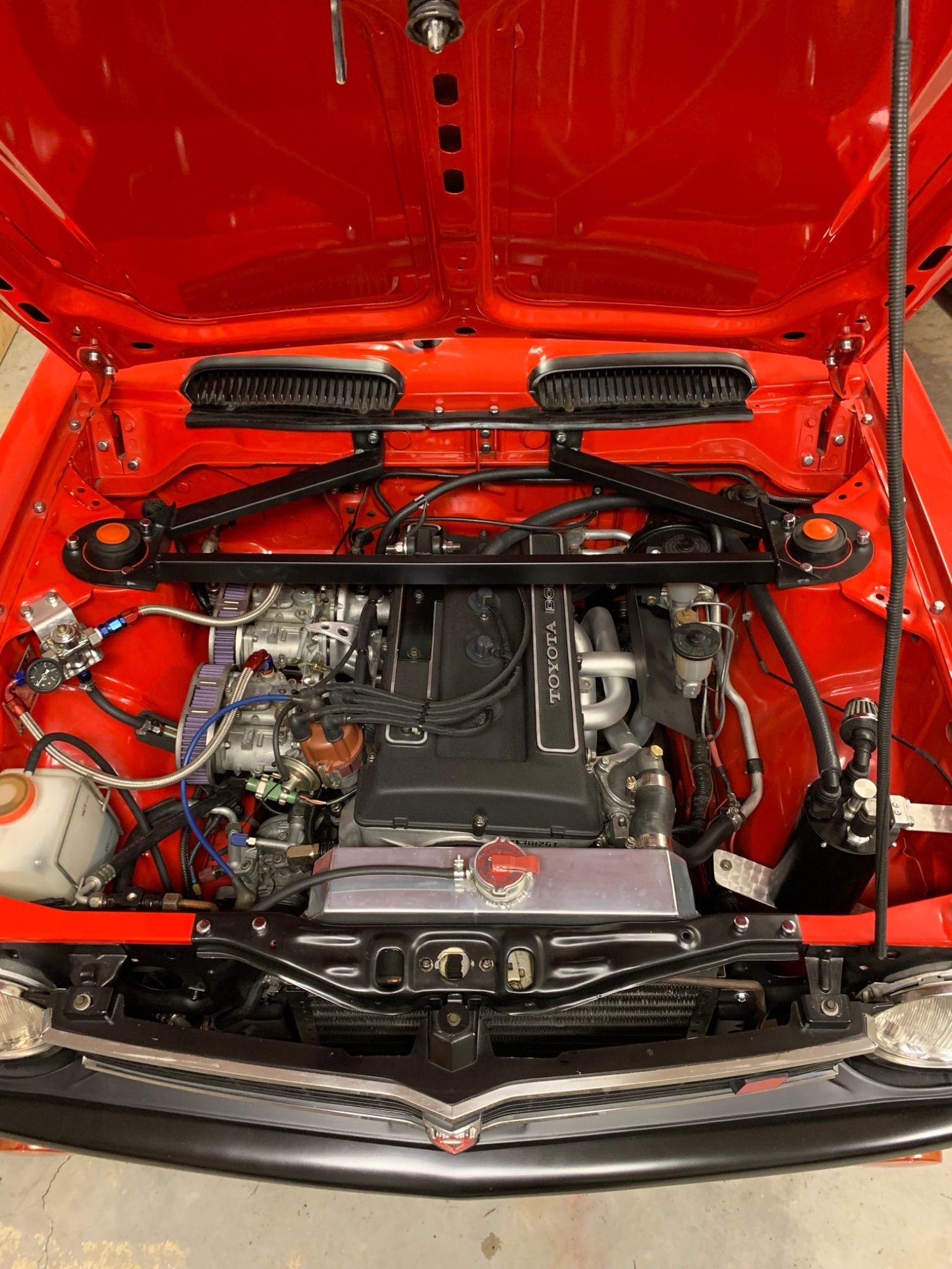

Well, the Corolla is getting close to having a new, period-correct engine transplant. Yamaha-headed 2TG DOHC motor similar to the ones that the JDM market Levin's and Trueno's got. We never got the engine here. This one has been bored and stroked from 1588cc up to 1941cc. Should be fun.

Old Aug 28, 2022 | 06:33 PM

Side draft Webers (or ??) and tube headers on a DOHC 4-cyl...... classic look!
Love it!

40mm Solexes -- I think there was/is some licensing agreement between Weber, Solex and Mikuni. They're all similar.

There was another one - Dell'Orto (or Dellorto) which supposedly had better metering than Weber. The air cooled VW folks really like them. Not sure they did sidedraft though.

Yup - they made some side drafts too - LOTS of motorcycle carbs from those folks.
