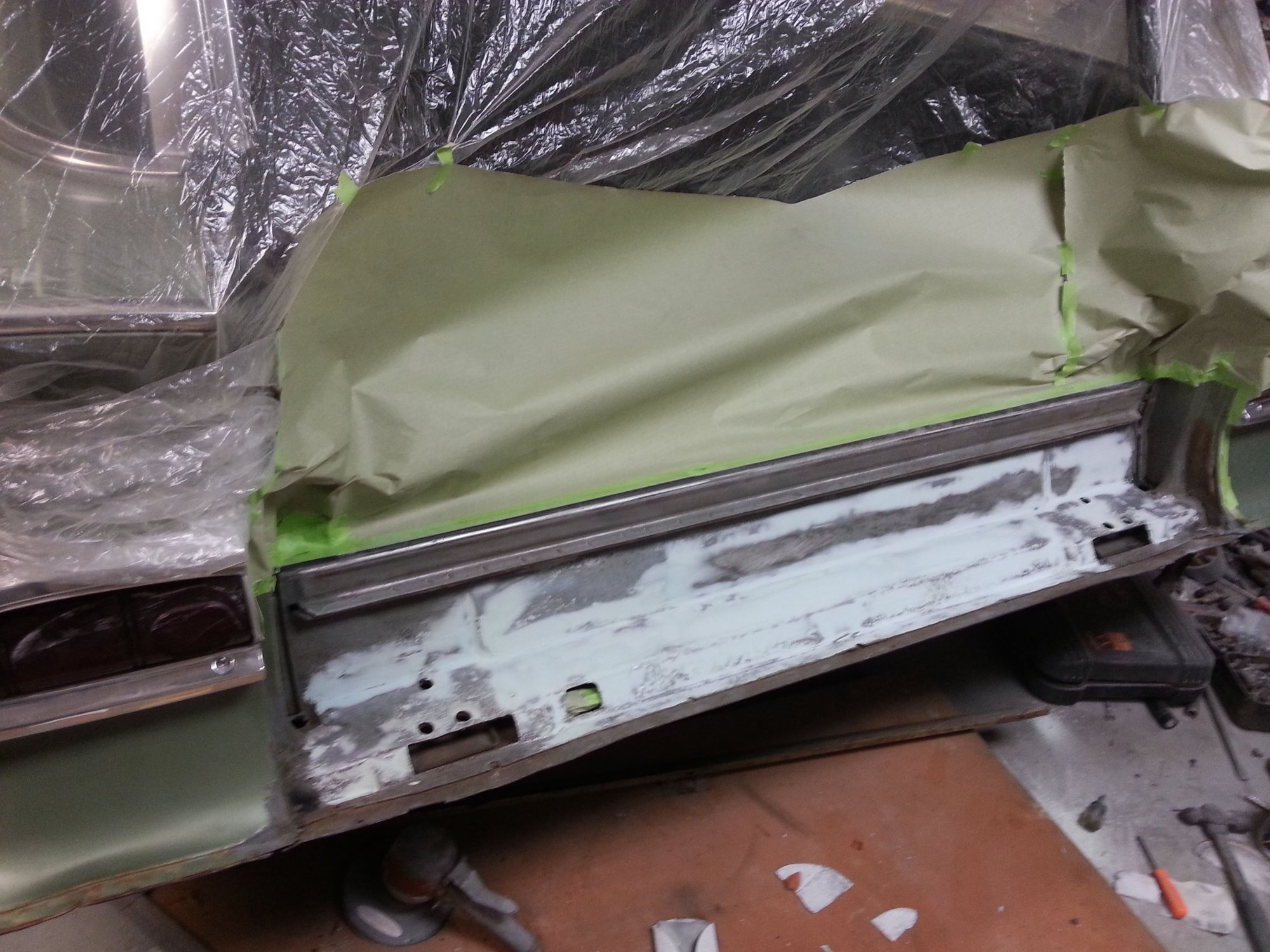

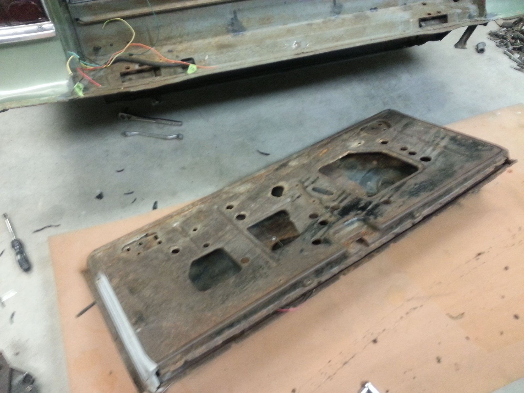

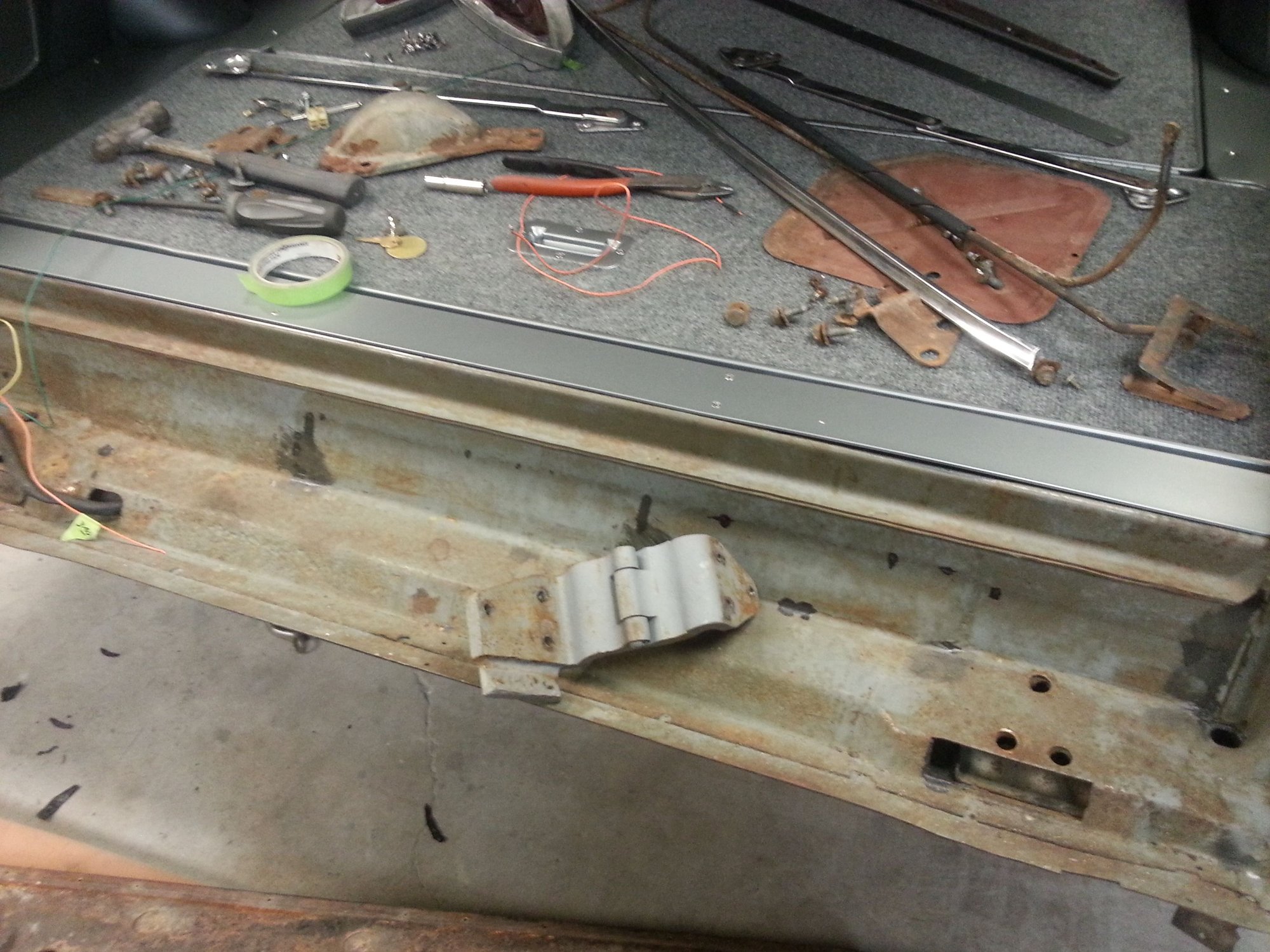

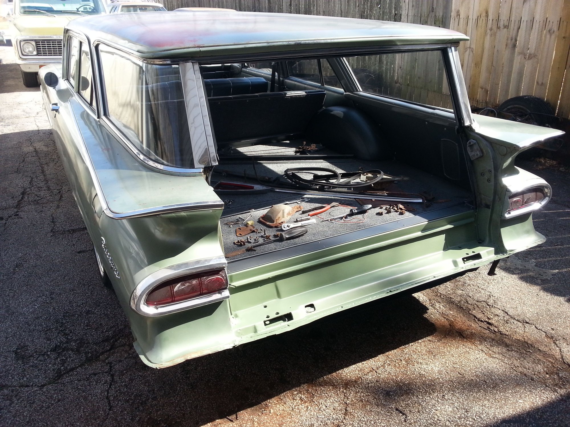

I put this car away at the beginning of the winter to finish up some other projects, but got it back out a week ago to try and finish up a few things that never got done before. I was originally going to paint the tailgate, but don't think I want to do that now. The original lacquer paint I bought matches the base/clear I got for the firewall, so I'm thinking the green has just faded and although it buffed up to a decent shine, the color wouldn't match good enough. So, I decided to just paint the inside of the gate so the interior part is finished and I could finally put the weather strip on it. Had to disassemble the whole thing to make it manageable to remove.
Old Mar 5, 2018 | 10:54 PM
  #456
ls1nova71's Avatar
Joined: Jan 2008
Posts: 4,406
Likes: 211
From: Liberty, MO

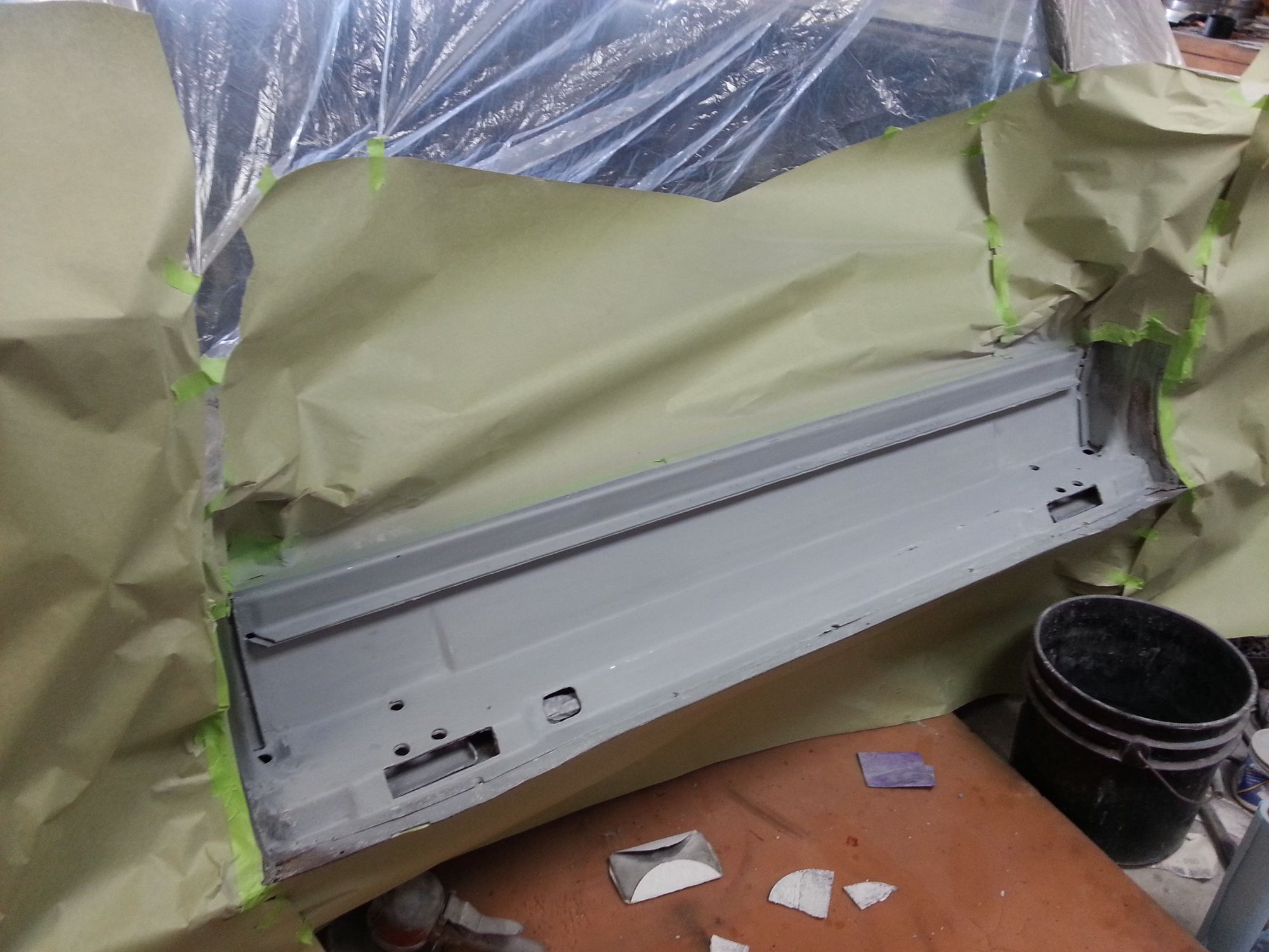

The lower part of the tailgate jamb had a few patches welded in it and was primered, so I decided to clean this area up too since I don't really care for primer.
Did a quick smoothing of the whole area.
A little primer on the jamb area and the tailgate.
Then sprayed the green lacquer on the jamb and the hinges that had also been primered. You can see how it looks a little greener than the rest of the car.

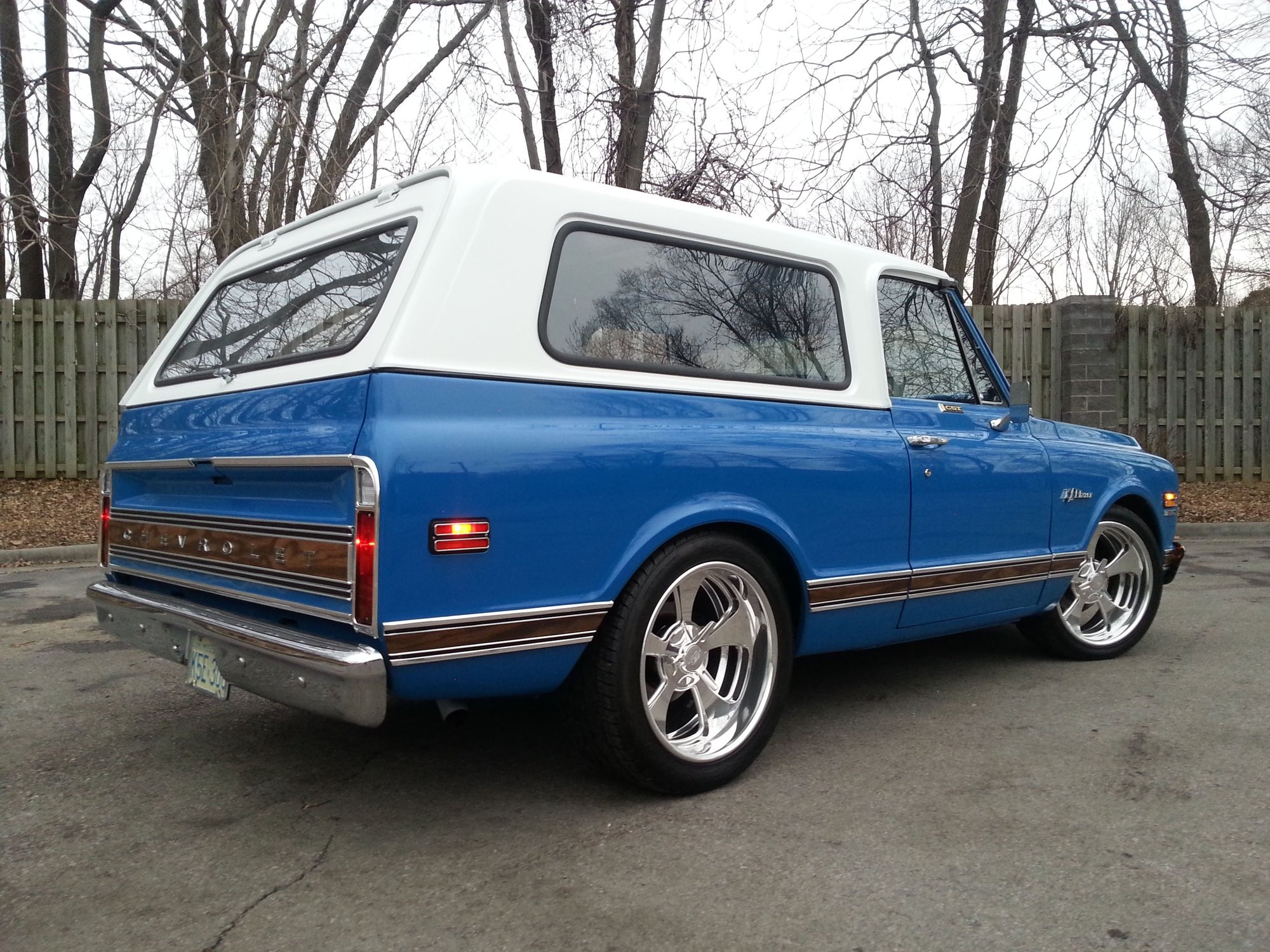

I also painted the inside of the gate the gray that all the rest of the interior metal is painted and now just need to get it back together in the next two days so I can drive it to Texas this weekend for the GoodGuys show in Fort Worth. I'm going to this show because I sold the nicest vehicle I have ever built, my Blazer, and the guy who bought it is taking it down there. I had wanted to take it to a big show, but it was really too nice to drive that far, and it never had a top when I was driving it, so not something you leave in a motel parking lot. But, this way at least I'll get to see how it does at the show!

The wood trim really stands out to me on the blazer

I couldn't sell the blazer if it was mine. Too nice and rare.
Agreed. Really nice touch.
