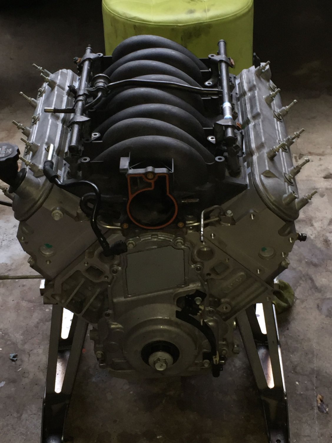

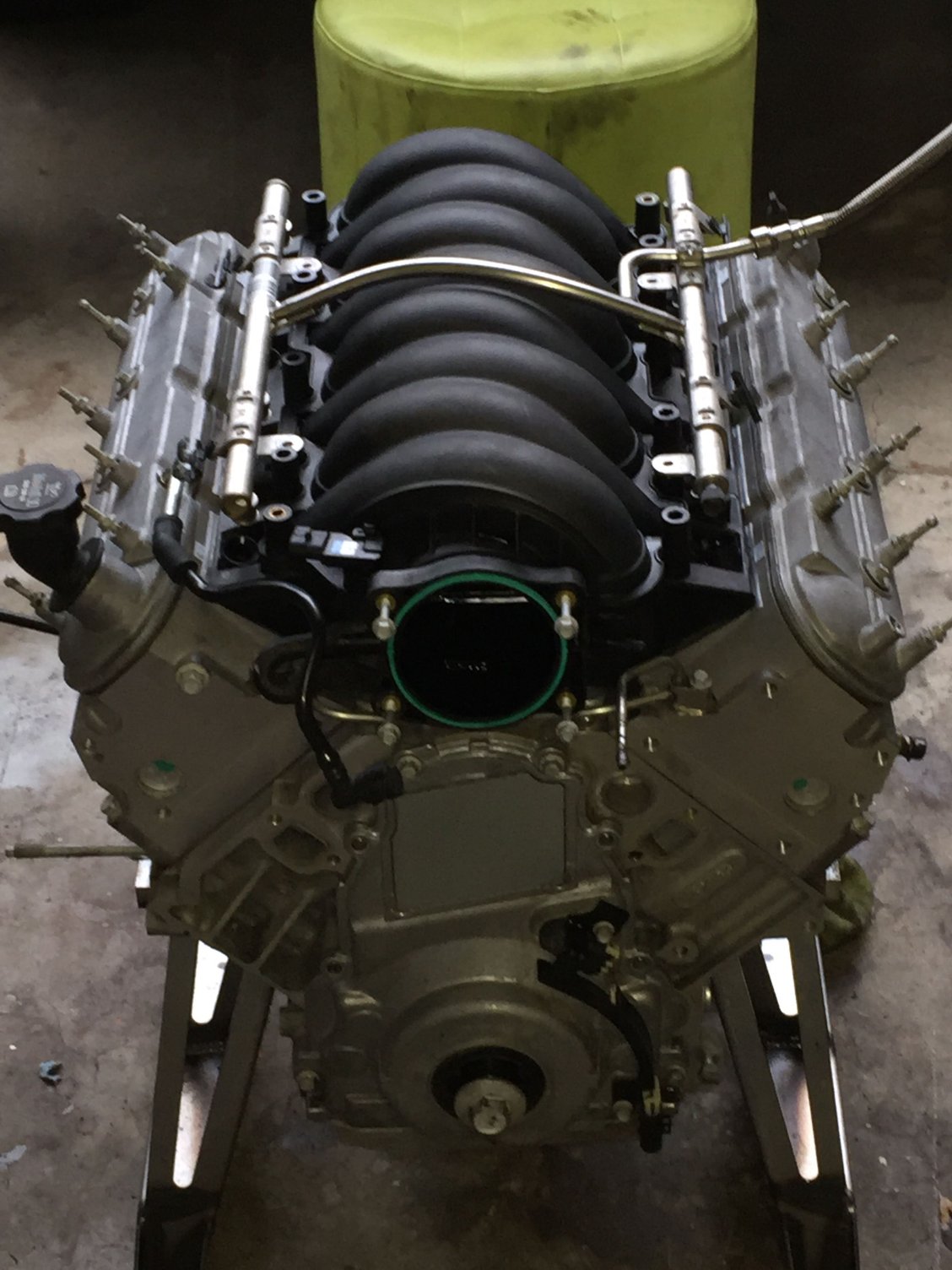

I have a Ls2 with a 228r cam. My question to all of you is i have a ls6 intake siting from a old project. Should I run the stock Ls2 intake or Run the Ls6. Is it worth the trouble to adapt the harness to the Ls6 injectors. Thanks.
