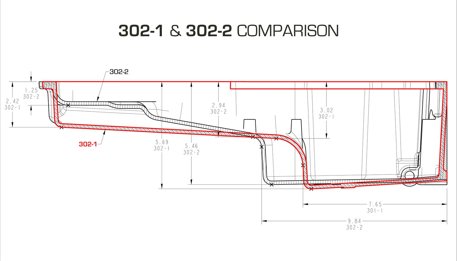

There are two versions of the Holley pan (302-1 and 302-2) and they have different dimensions. Holley's site has all the technical information for fitment.
