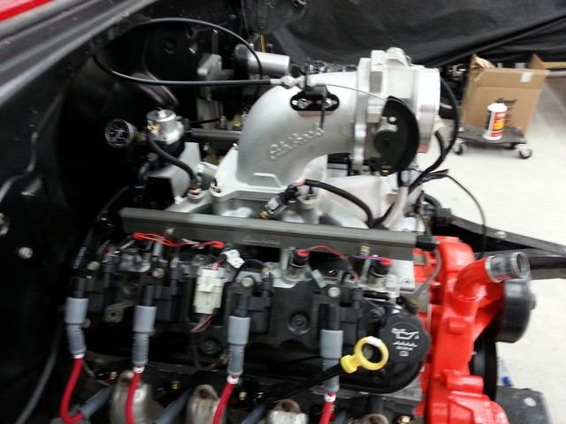

If you're using a Holley regulator just put the pressure sensor there, that's what I did. The sensor is not in yet in the picture but you can see the fitting. I used a T to mount the sensor and a small pressure gauge.
You can see the gauge here, I put it there to make setting the static pressure easier. Picture is not the best but you get the idea.
