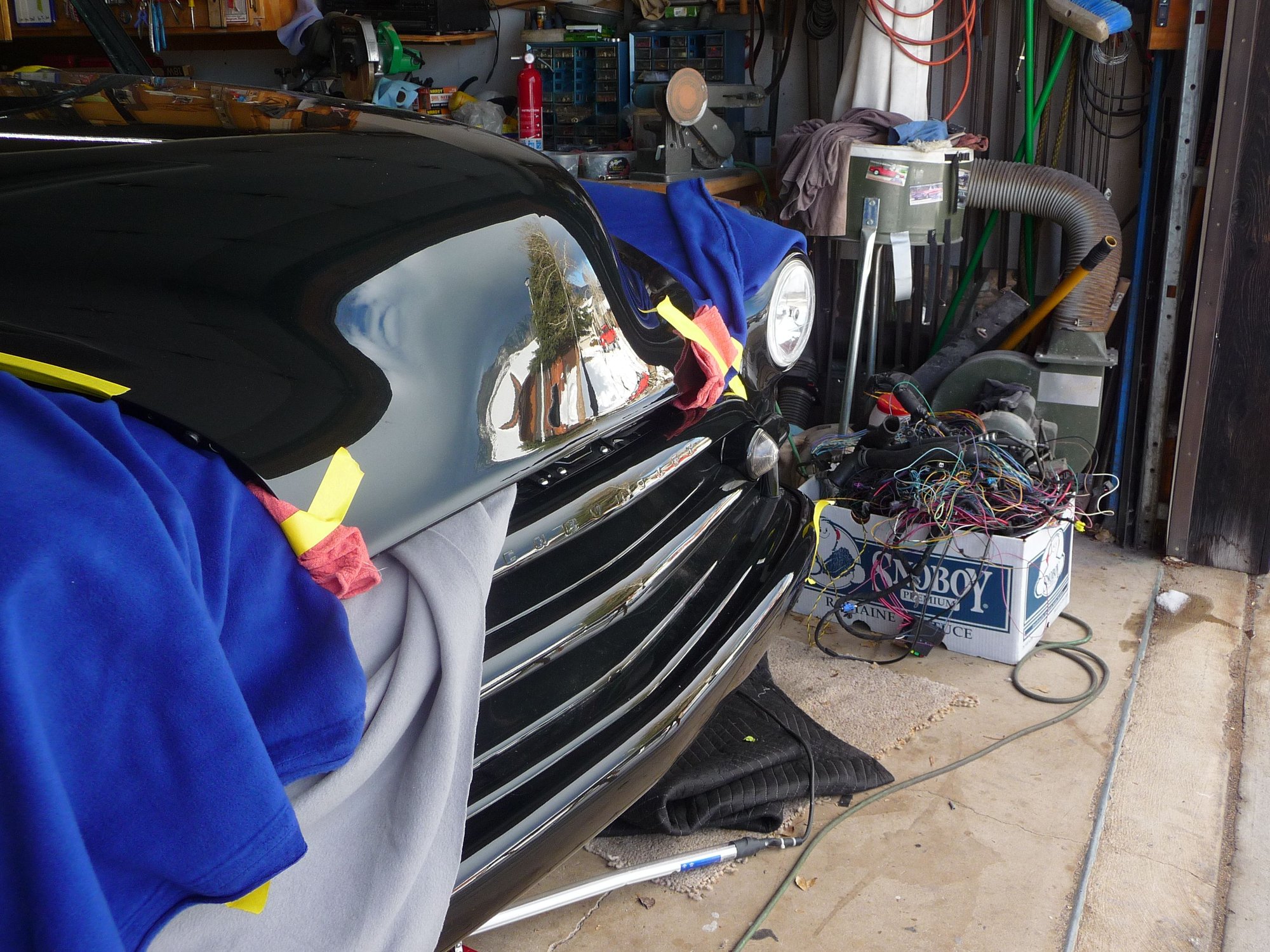

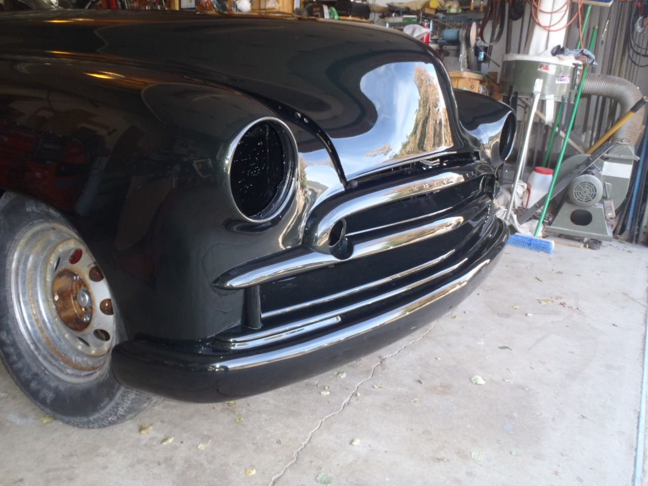

Smile

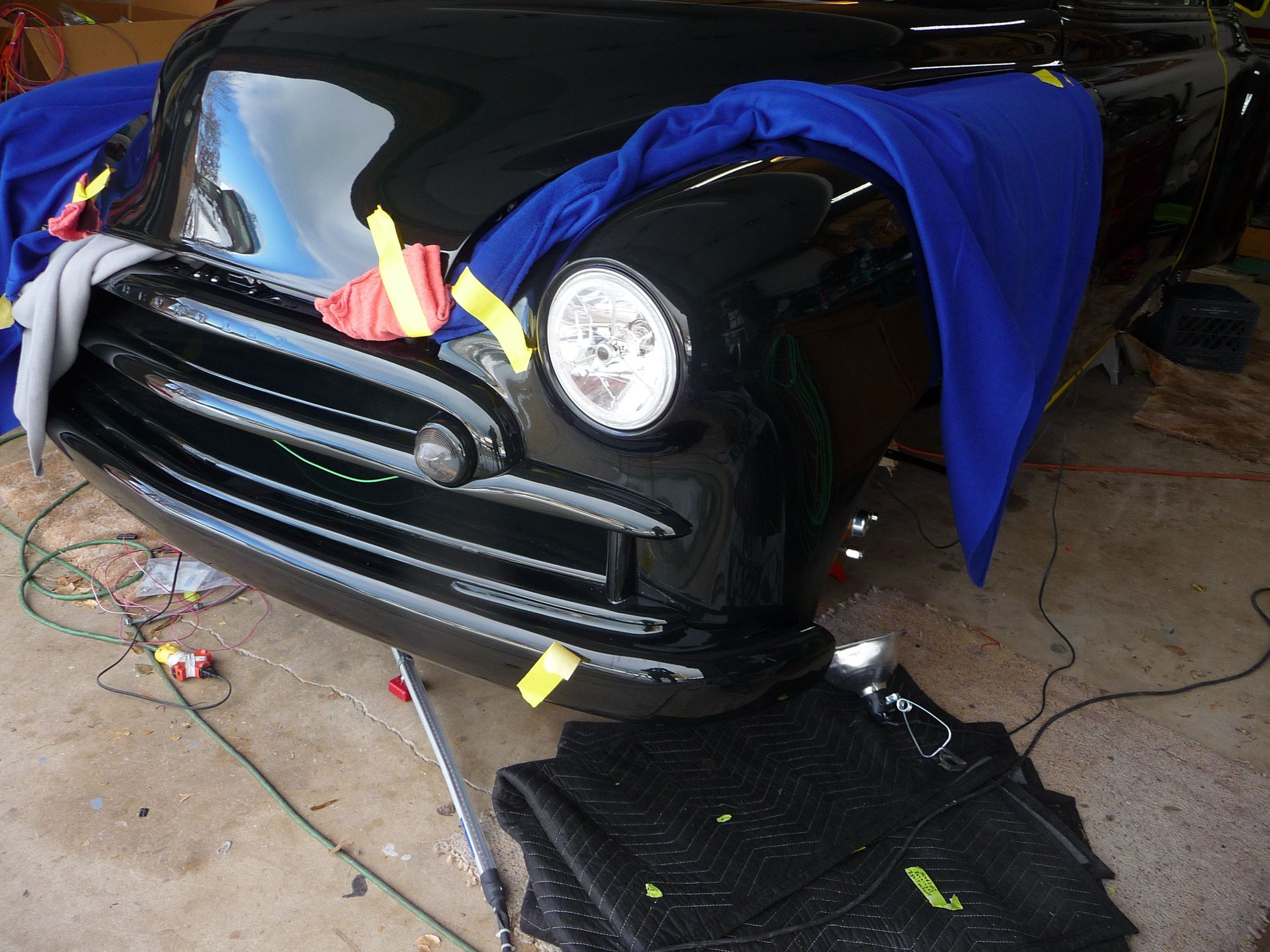

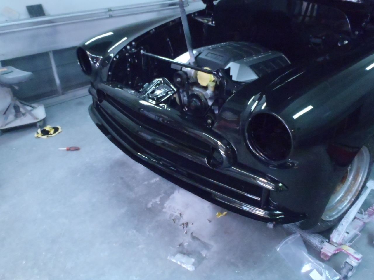

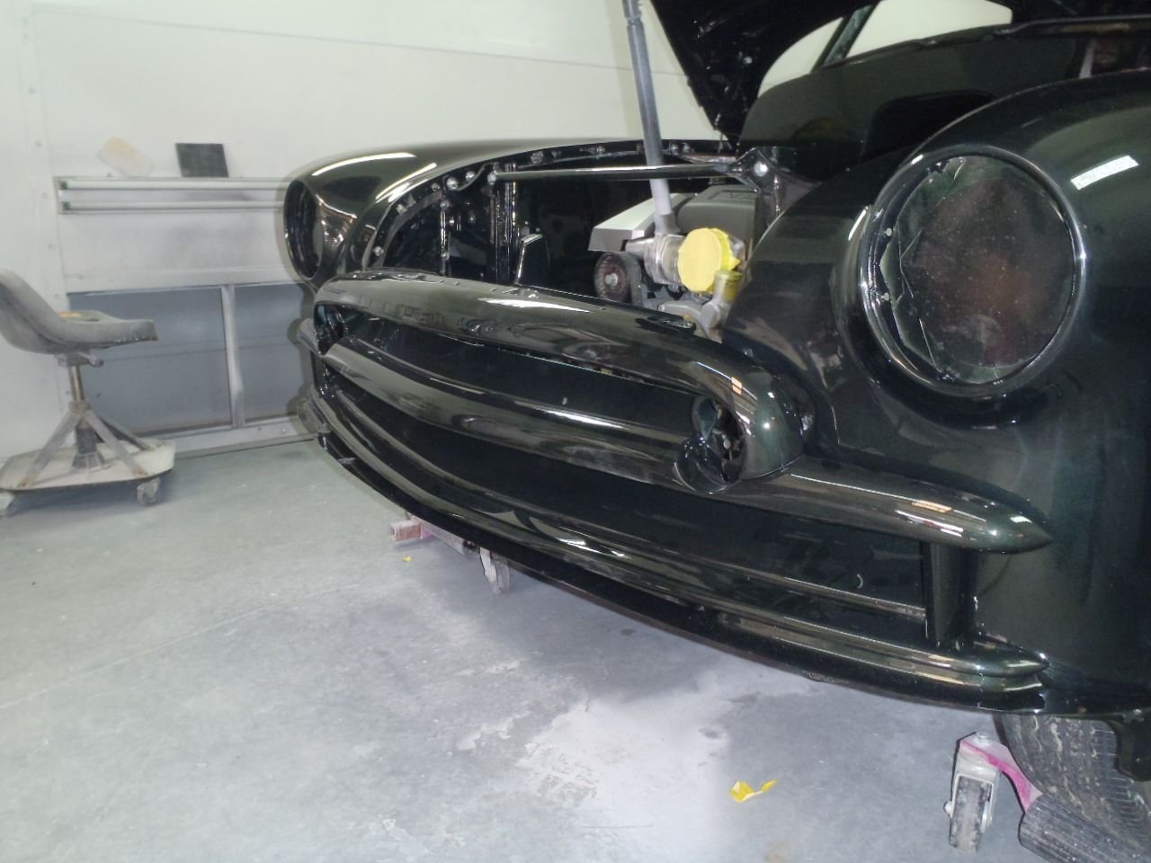

I rely like the painted grill and bumper.
In the sunshine.

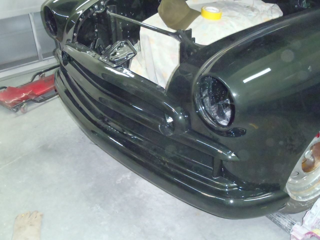

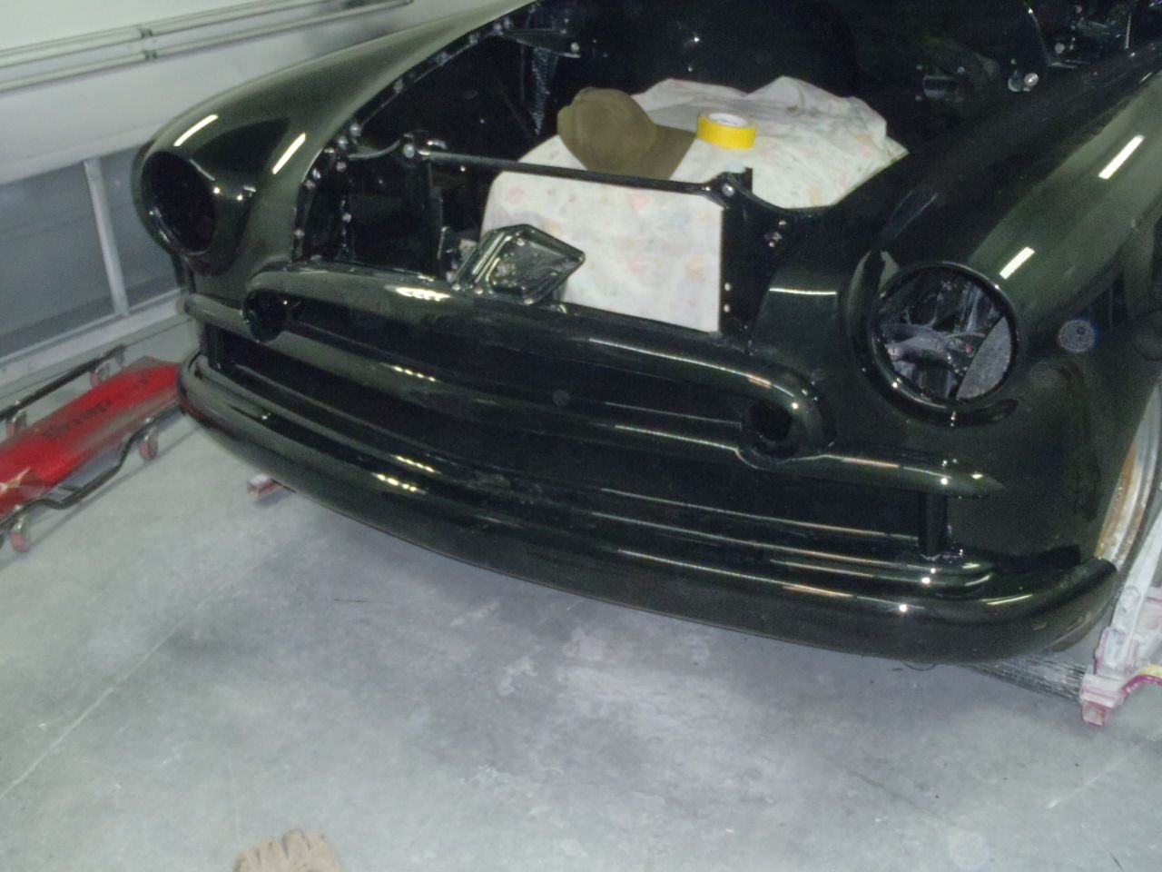

Installed the ft valence and grill today bumper tomorrow.

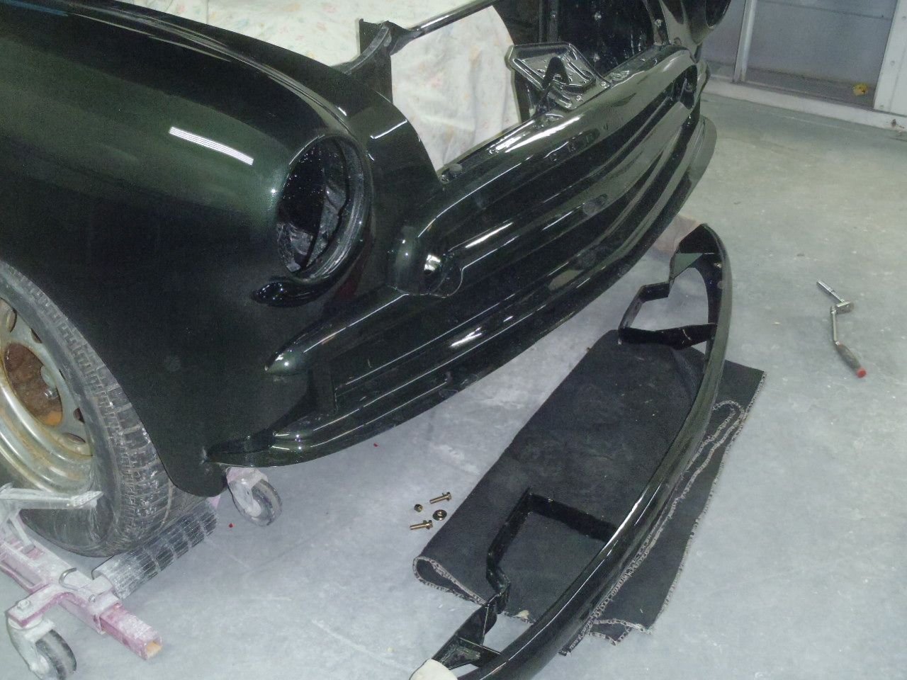

From: montana

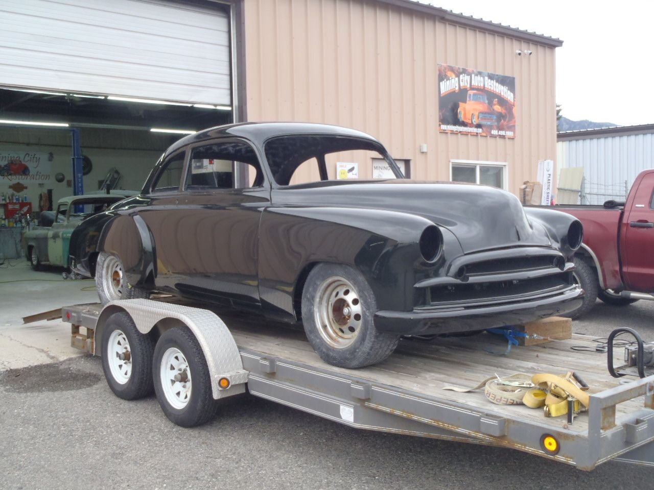

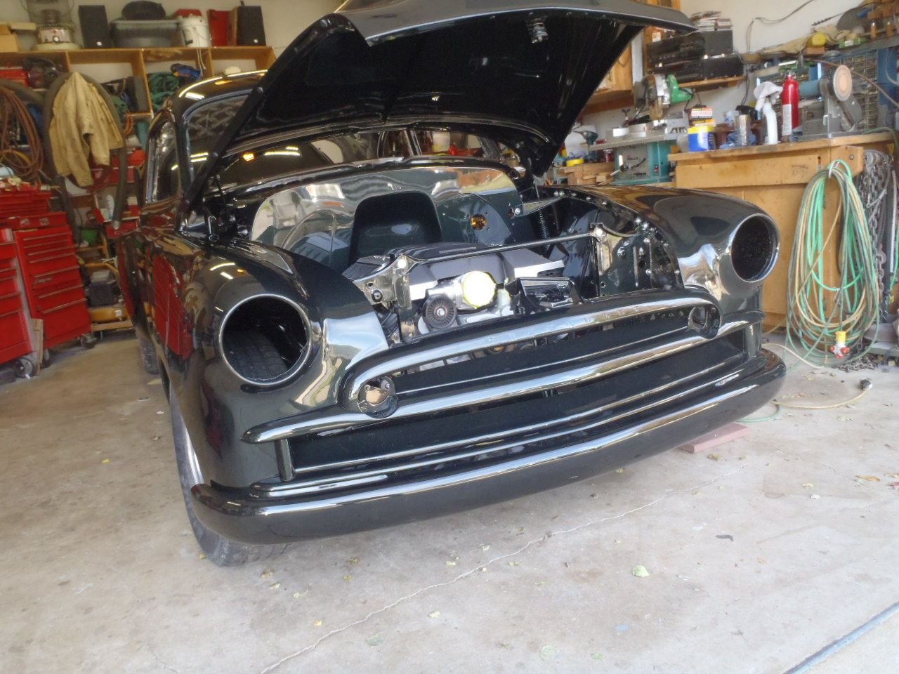

Bumper installed, looking great, car will be home Thursday.

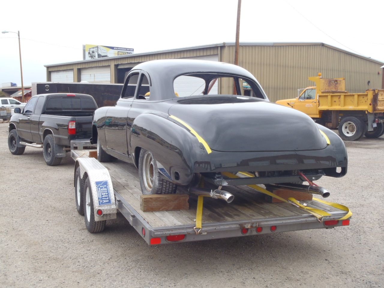

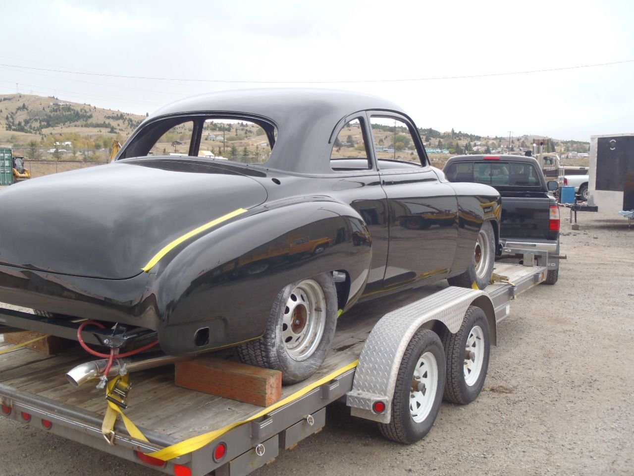

From: montana

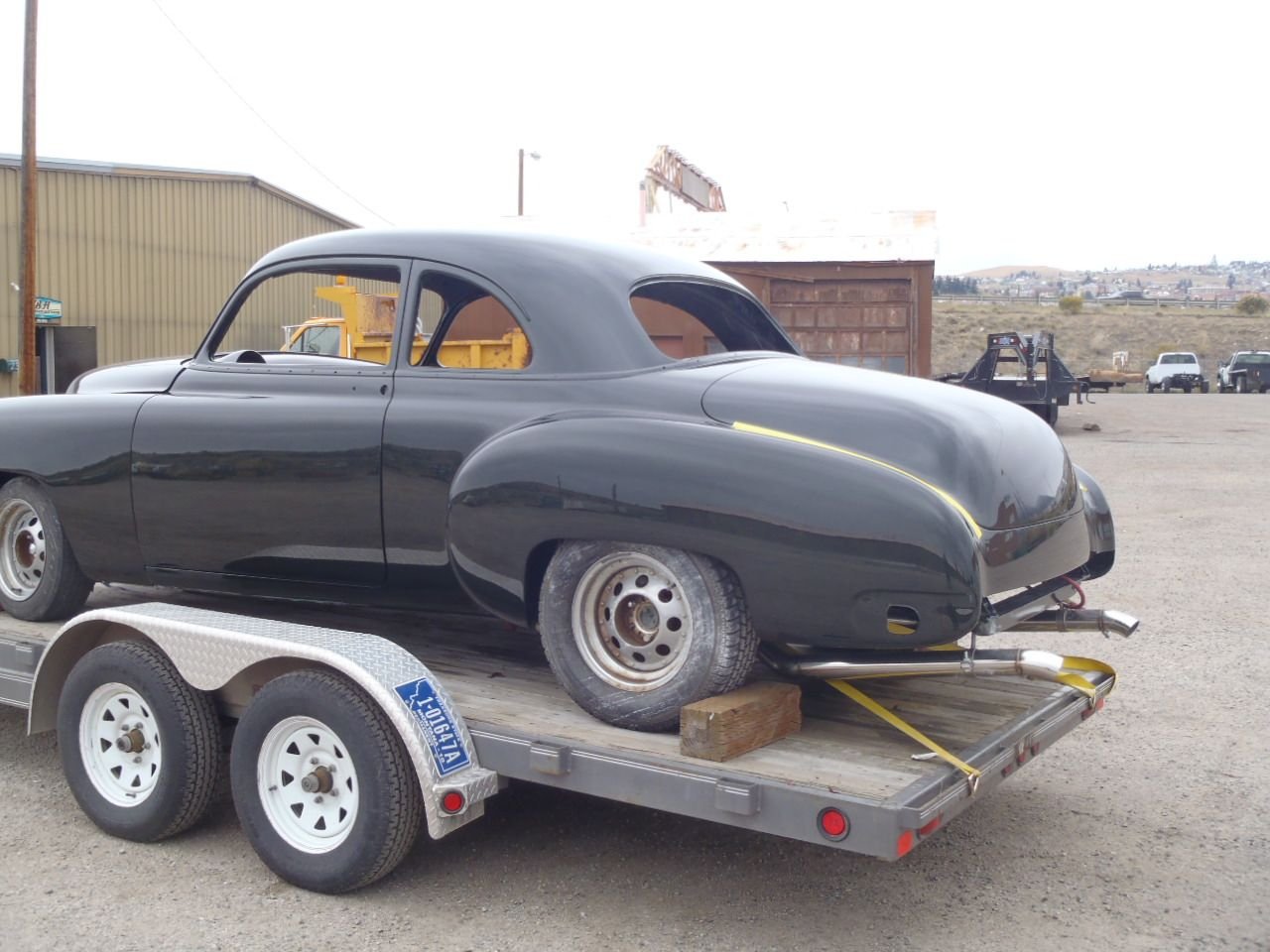

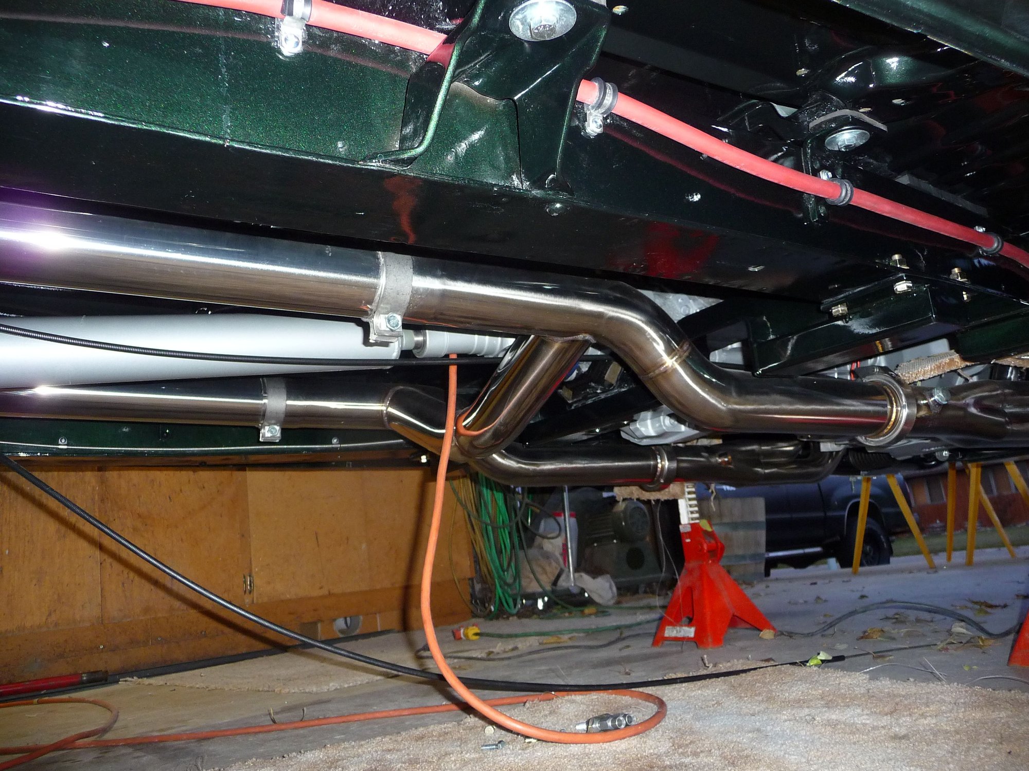

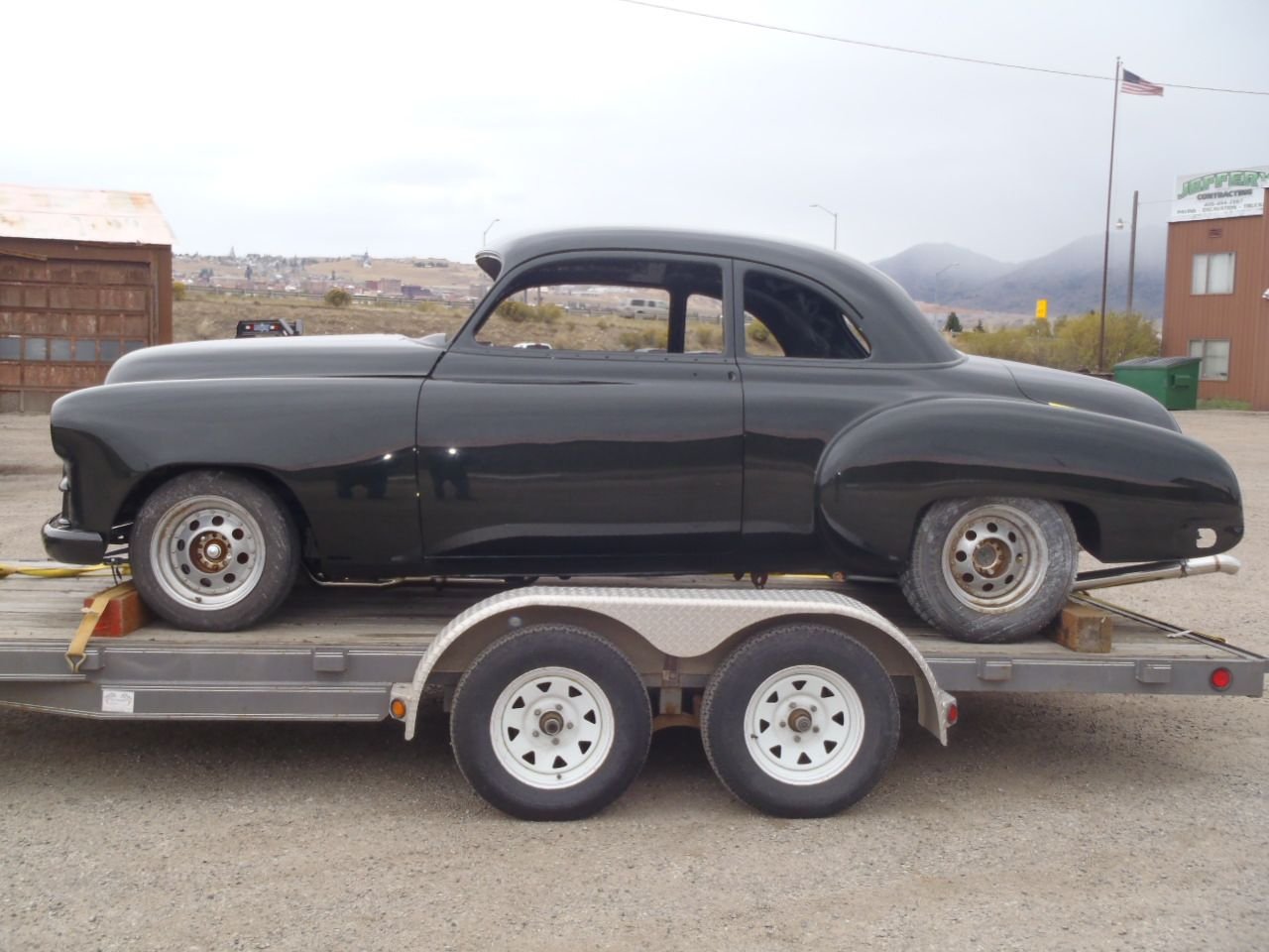

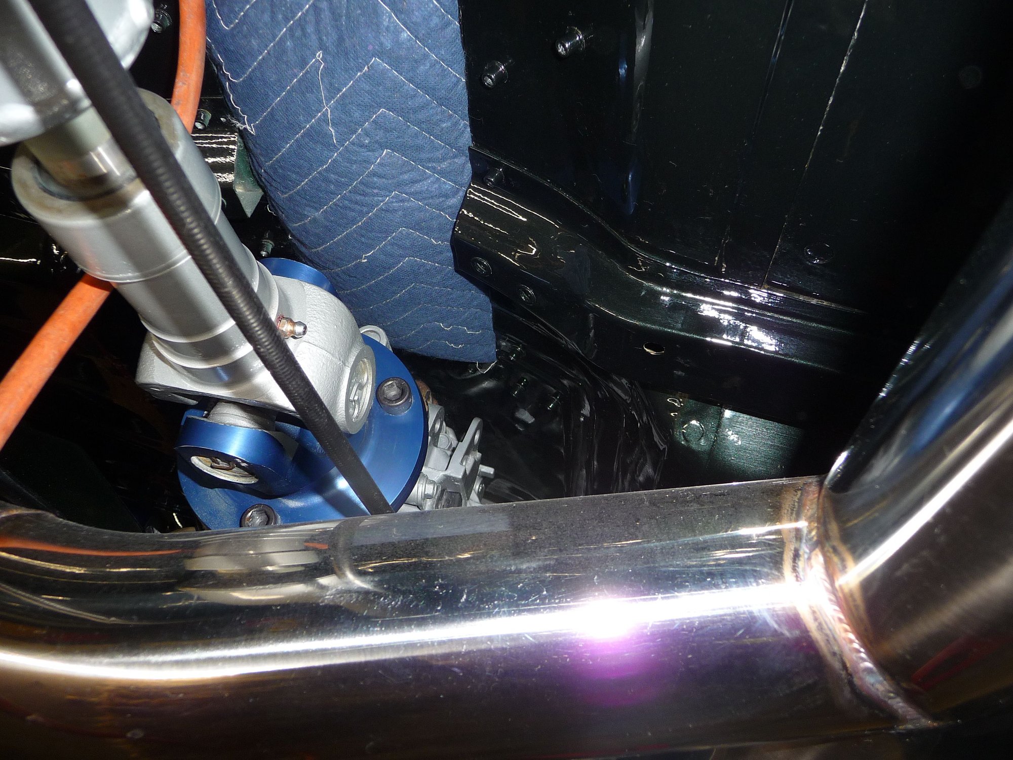

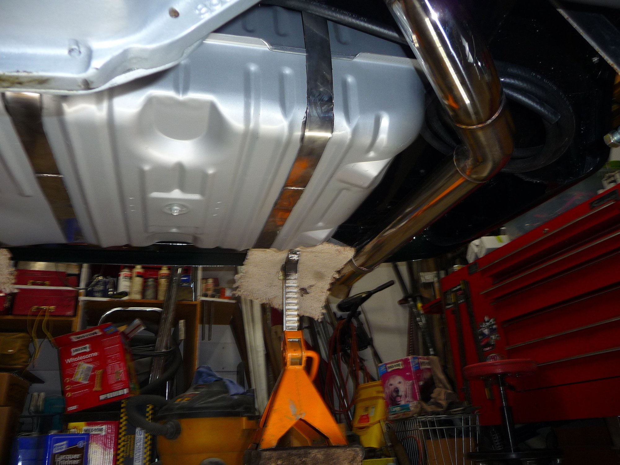

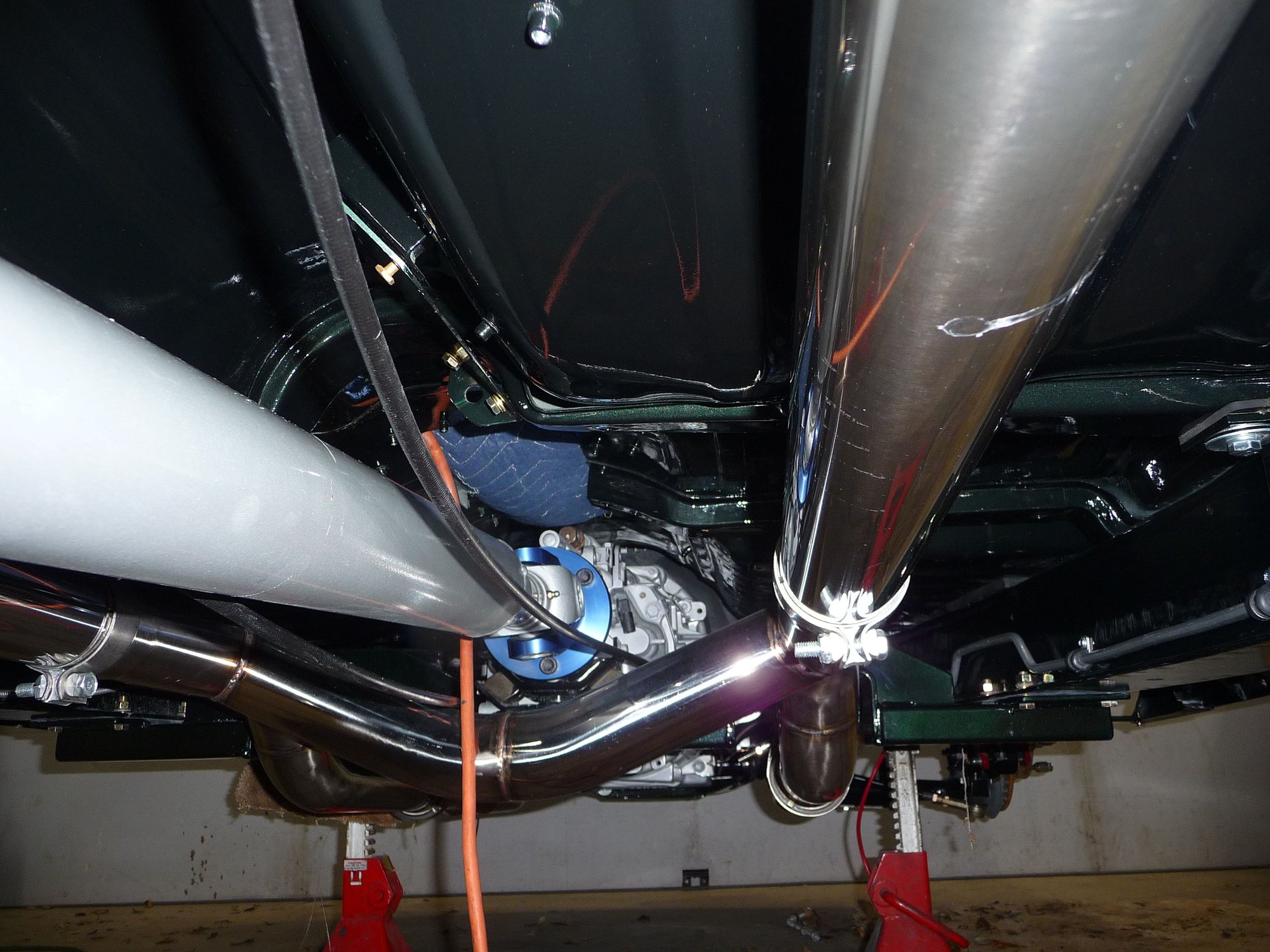

Just dropped this off to have the exhaust finished, hangers ect, the weather has been the ***** here lately.

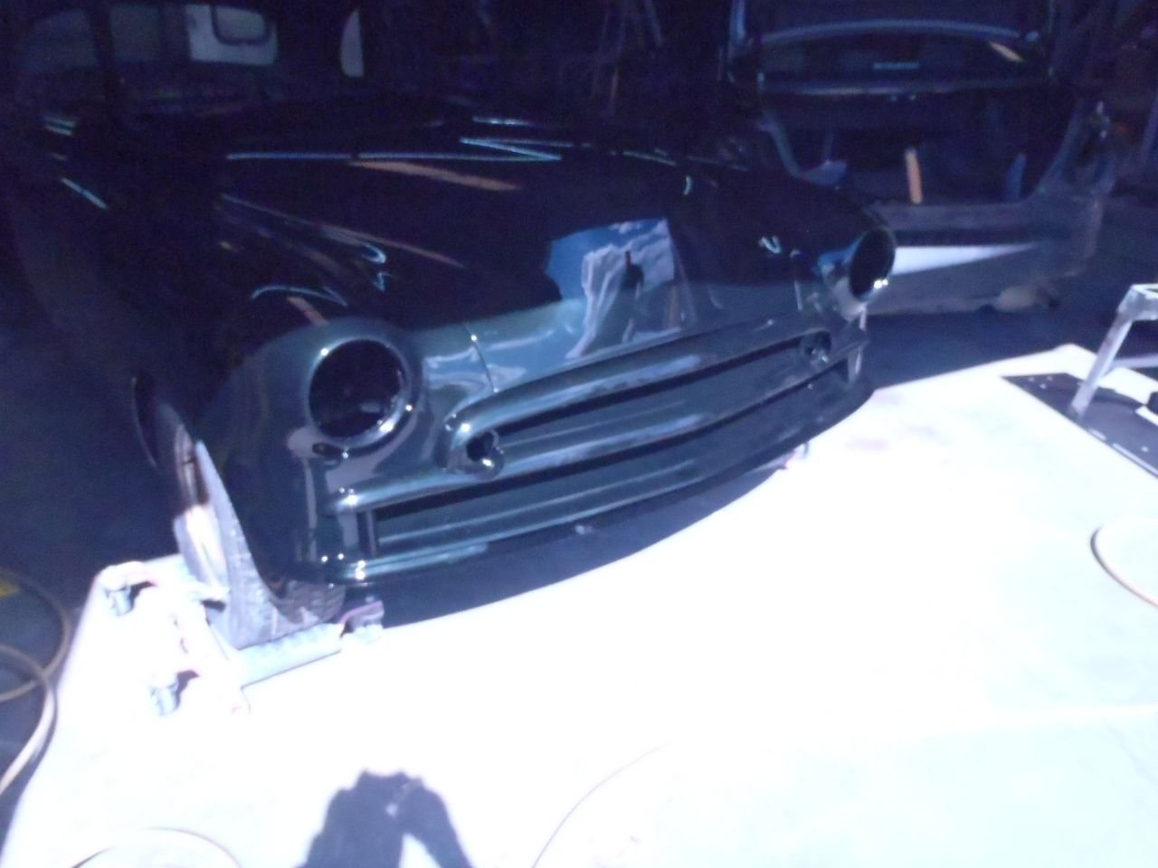

From: montana

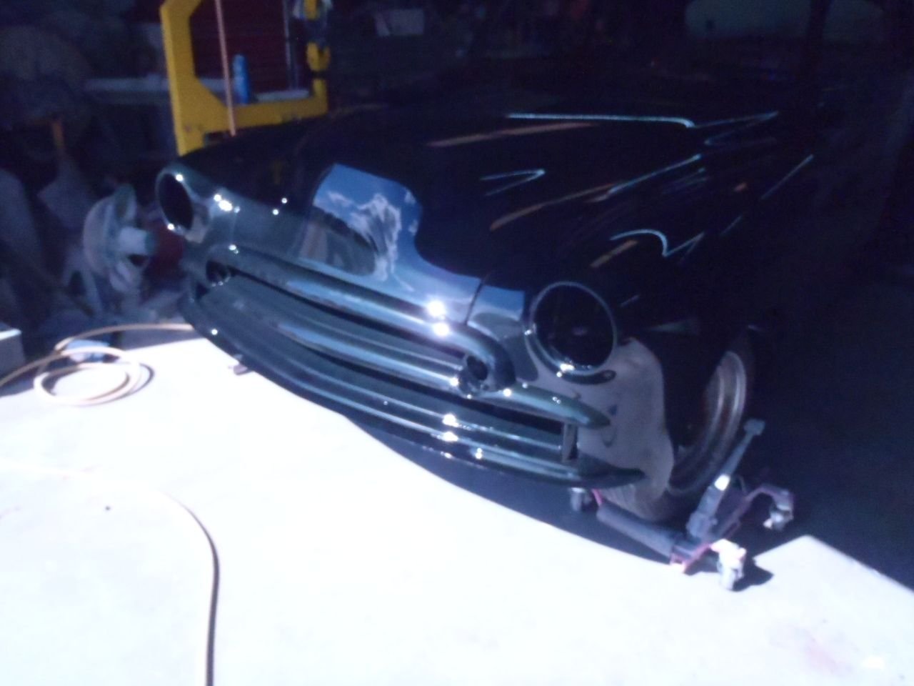

Car lis home after a GREAT paint job. Next is the fun part putting this all together.

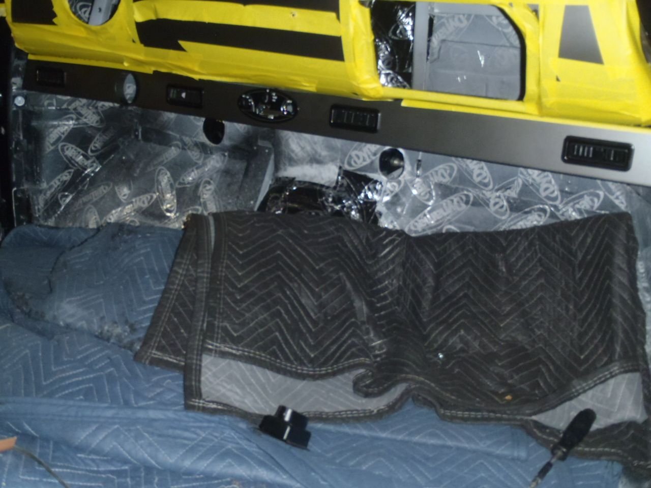

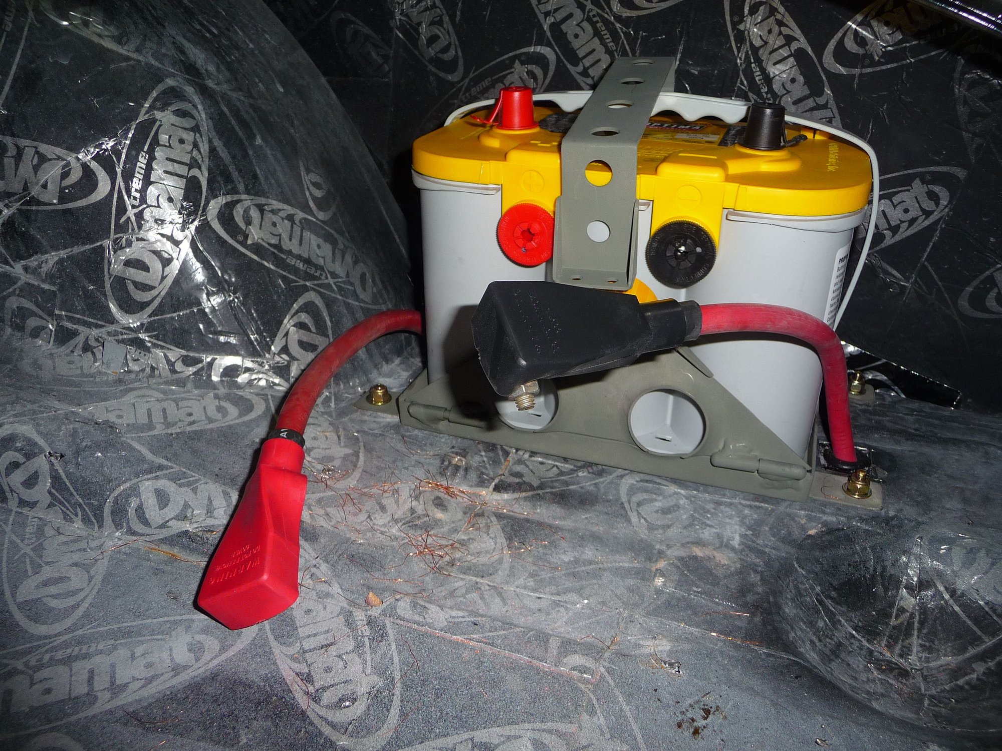

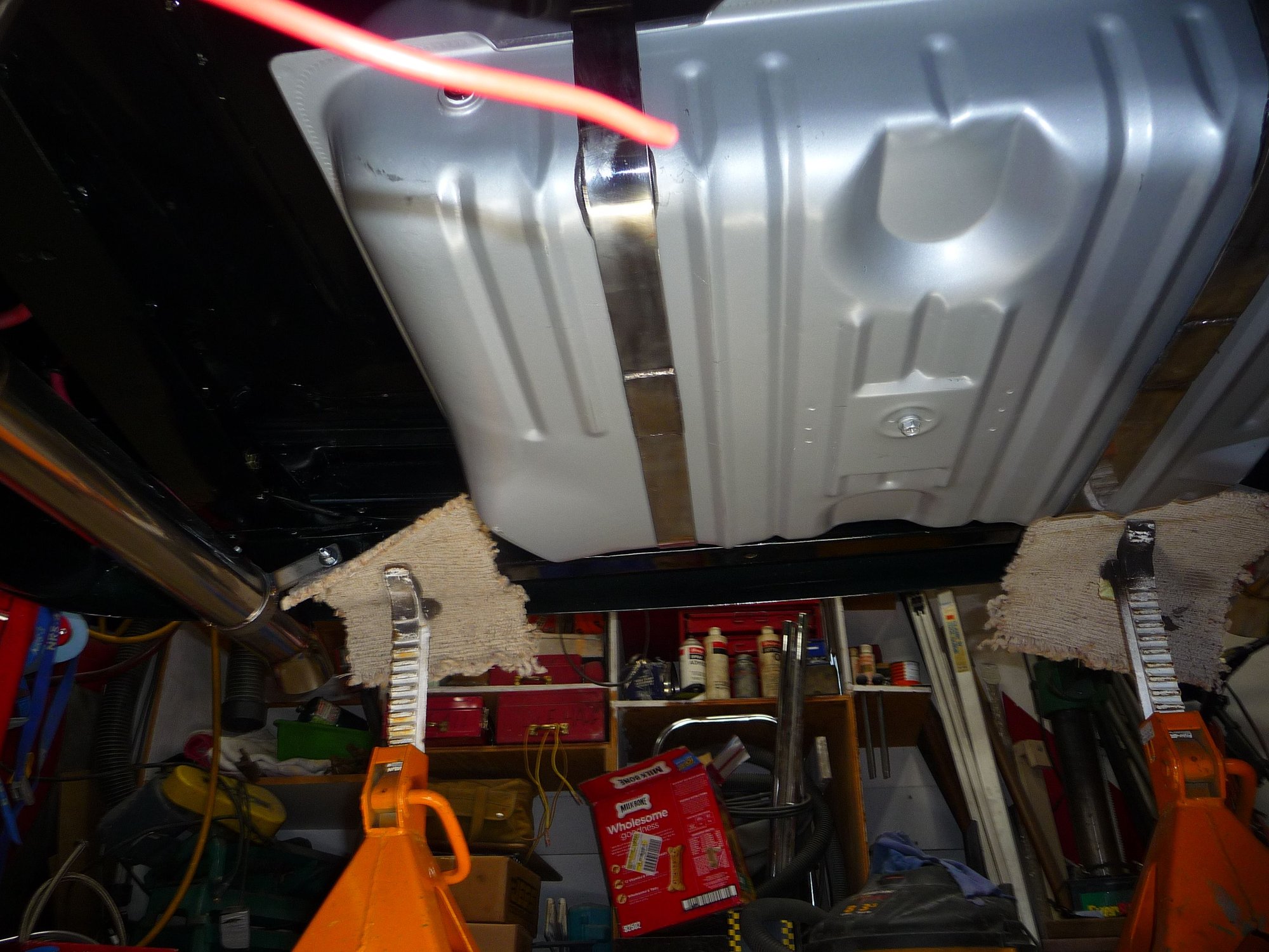

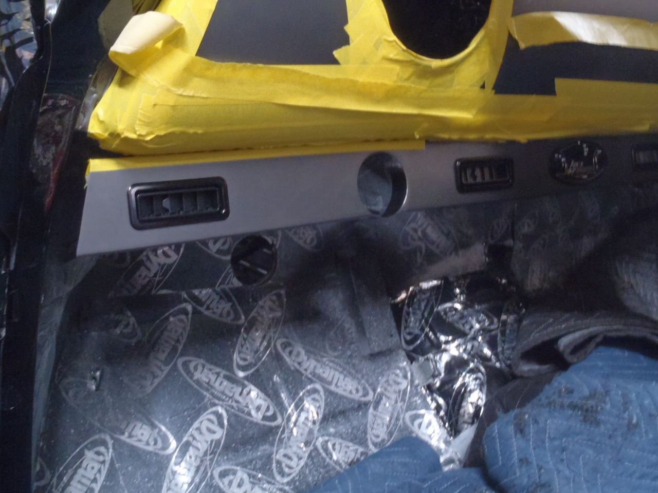

Gas tank is in, A/C controls and vents fit in and look great, this moves ahead little by little each day.
A/c control and vents came out nice.

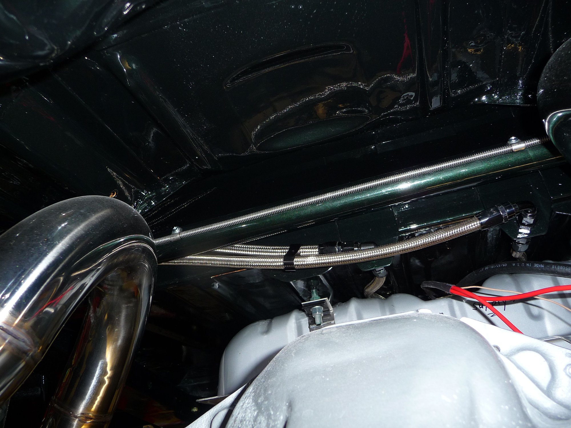

From: montana

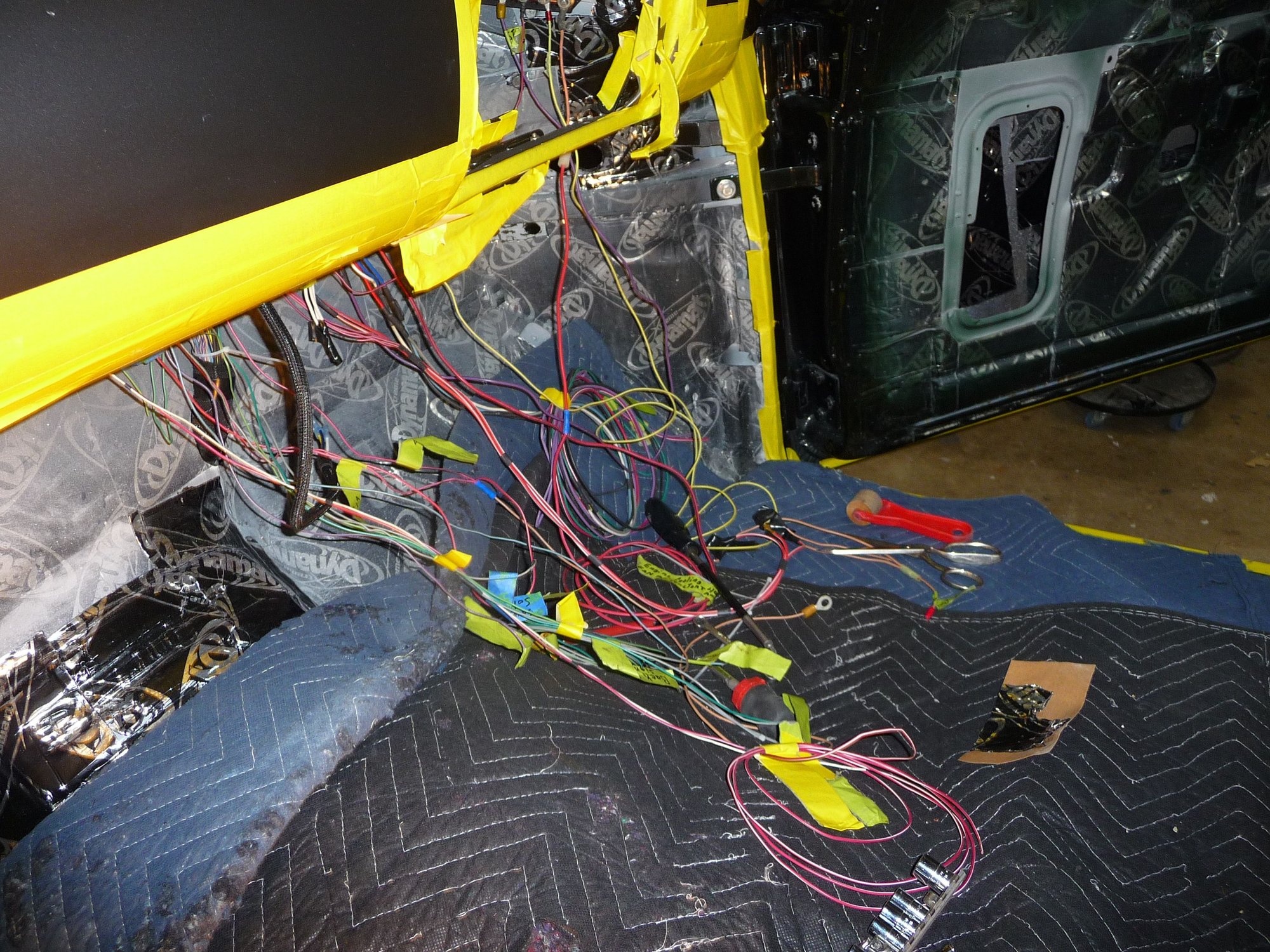

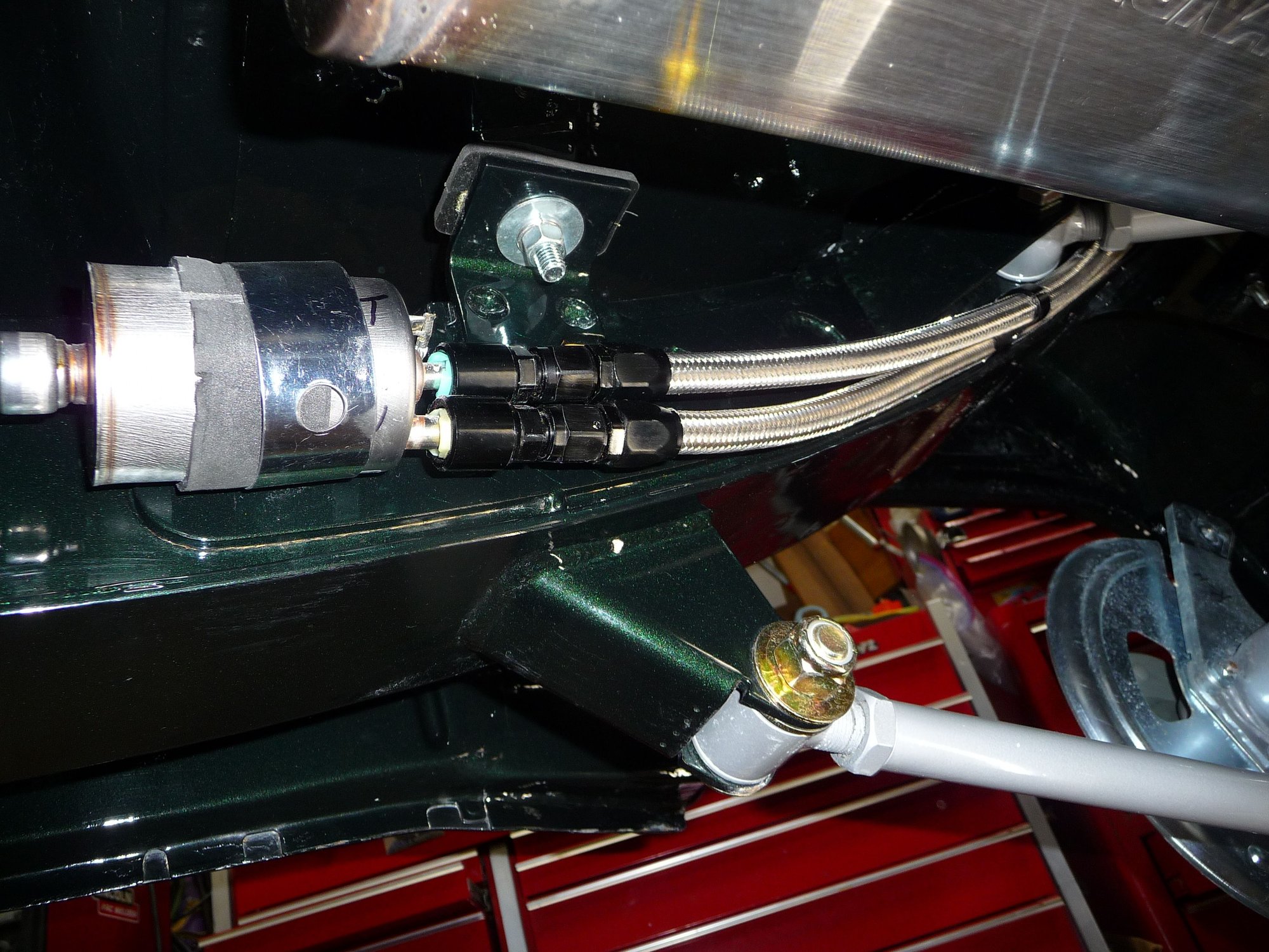

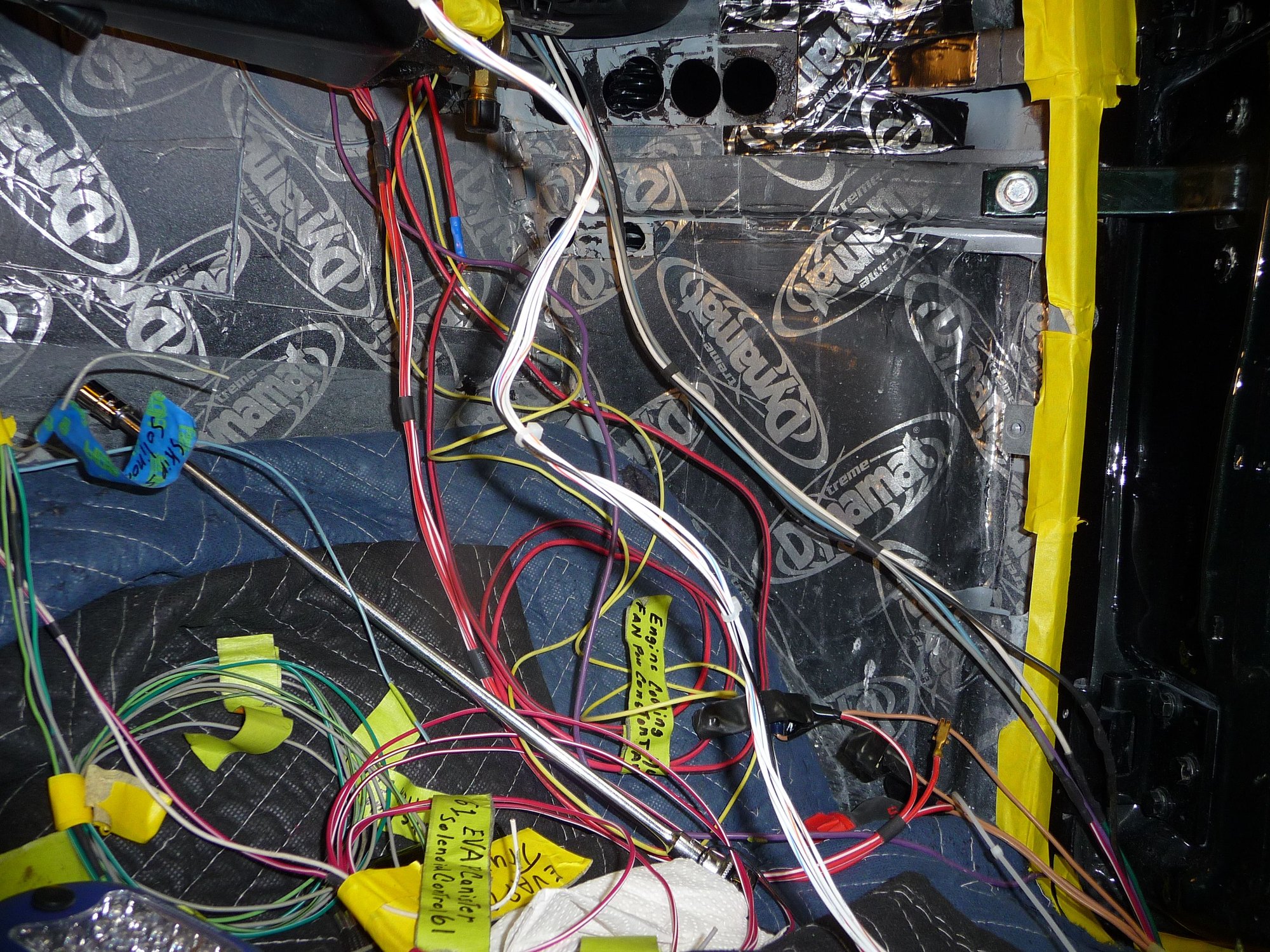

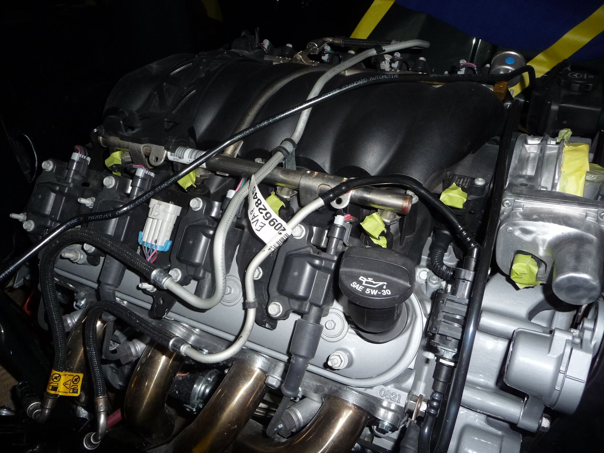

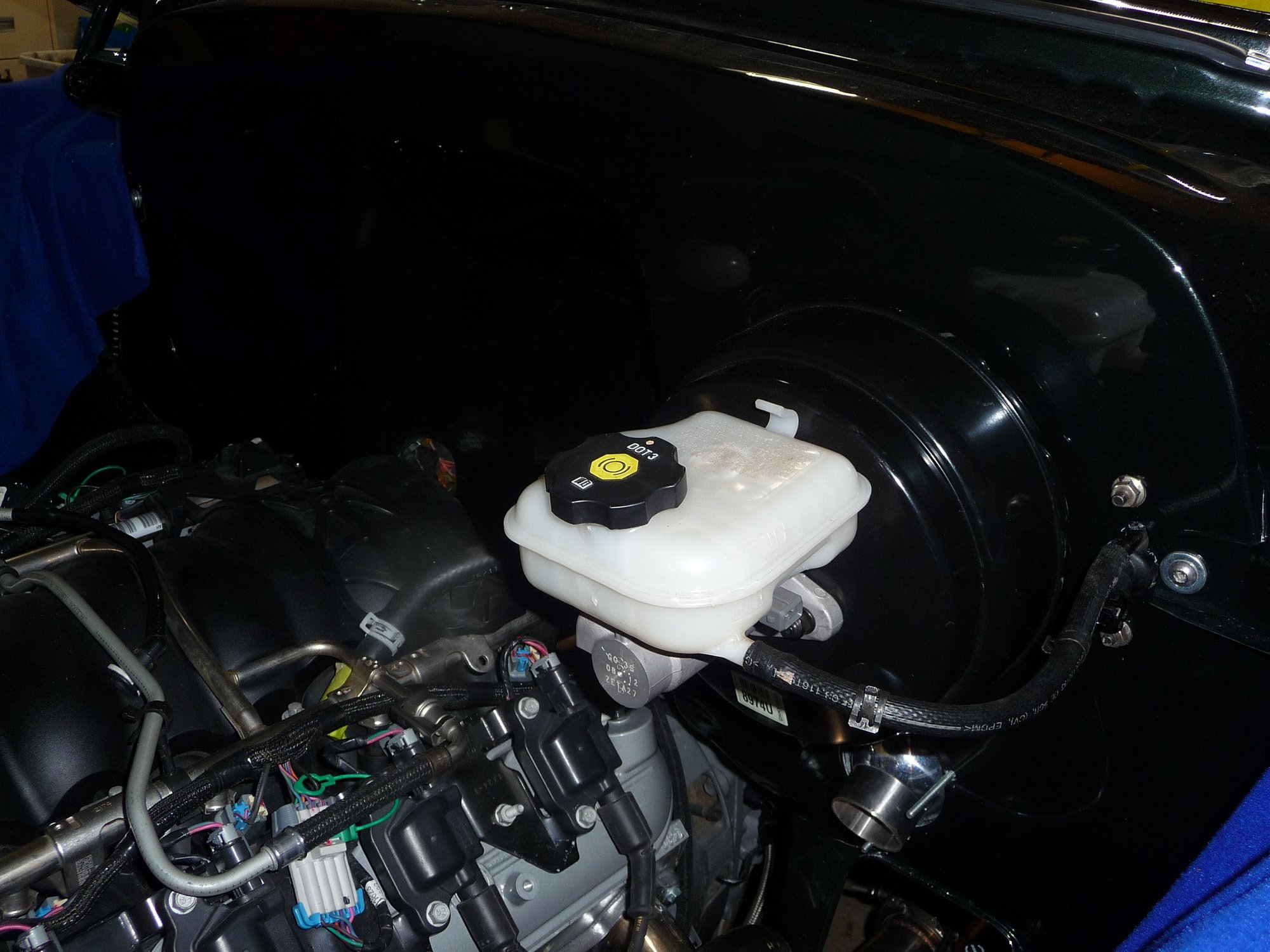

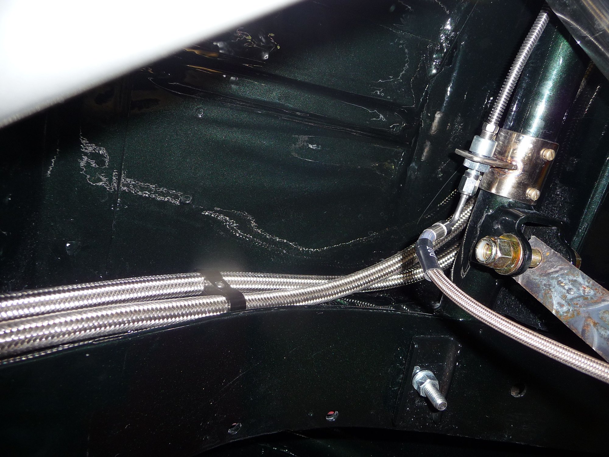

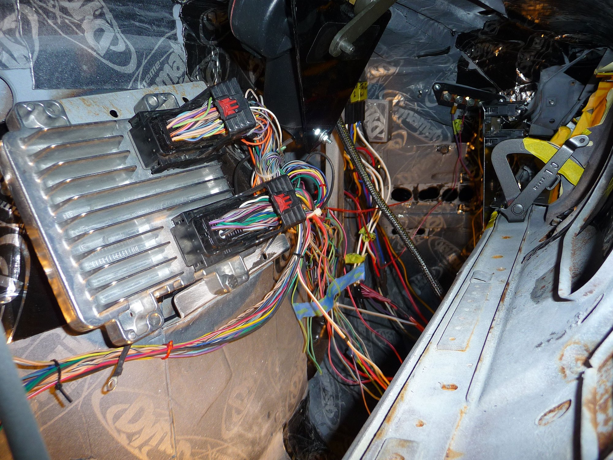

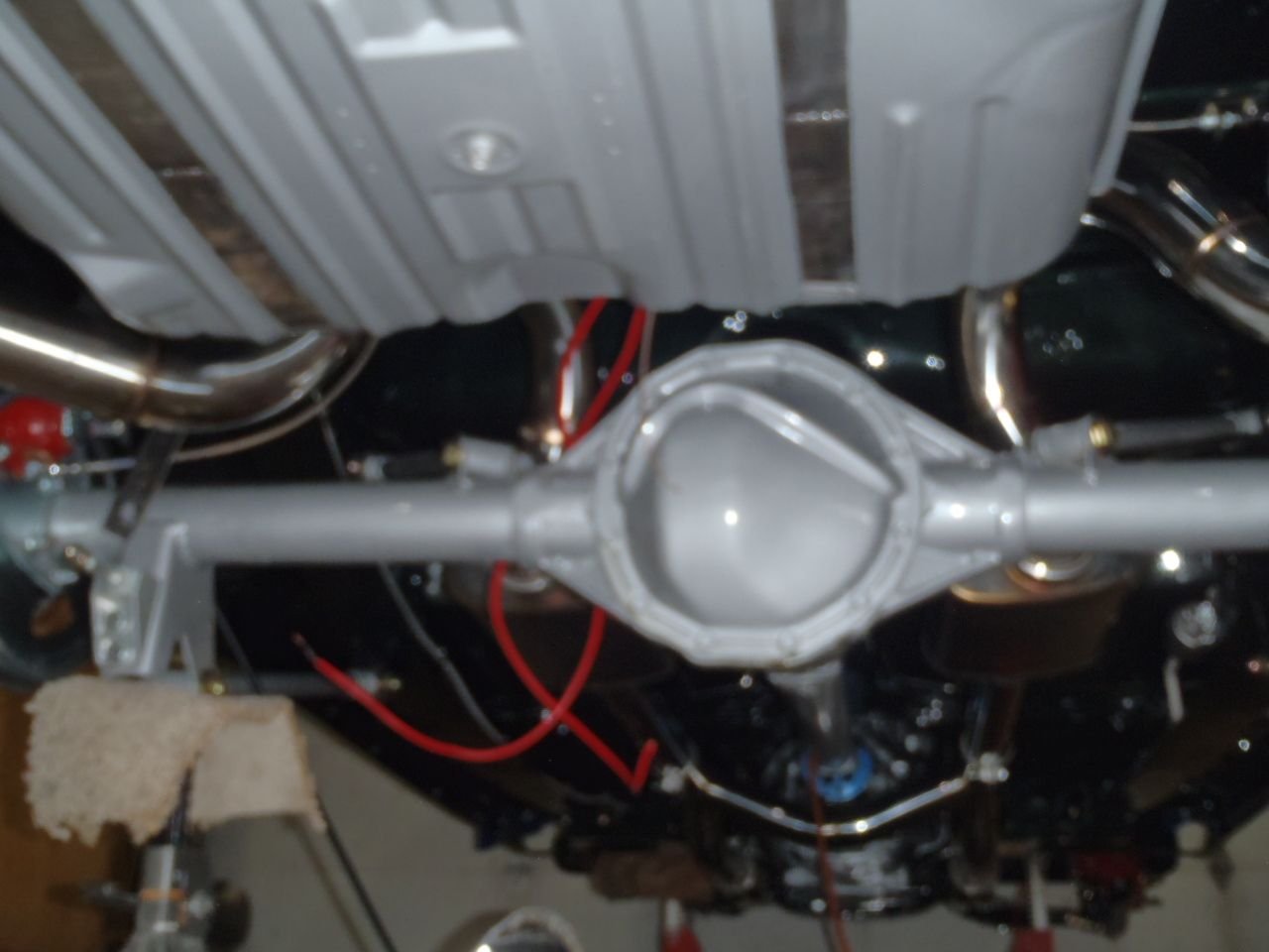

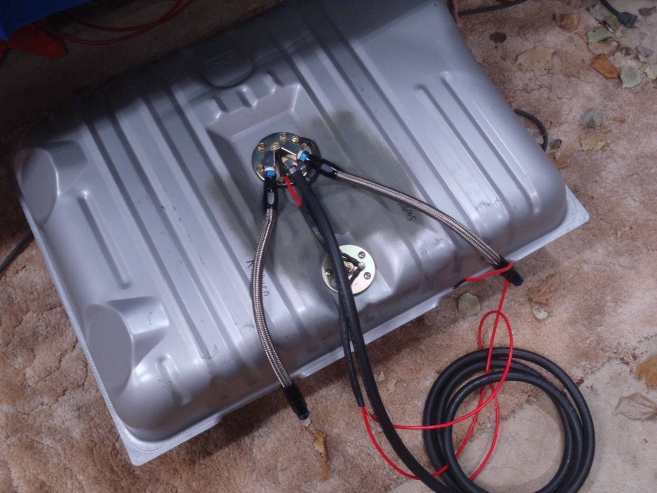

Fuel lines are finished up, wiring fun is starting up lots to do.
Old Nov 3, 2019 | 06:29 PM
  #192
Project GatTagO's Avatar
Joined: Mar 2003
Posts: 10,608
Likes: 1,881
From: Little Austin
Looks good, but I would swap out those AN adapters with the plastic clip. They will burn your car to the ground. Earl's makes good ones with a screw on back.
Andrew
Andrew
I'm not sure what AN adapters are you refering to? I need to know. Thanks.
Old Nov 5, 2019 | 07:18 PM
  #194
Joined: Mar 2003
Posts: 10,608
Likes: 1,881
From: Little Austin
The ones on the feed and return on the regulator/filter.
Andrew
Andrew
I took your advice and bought 2--- Thanks for the advice-- nothing like a nice fire to ruin your day, they will be here tomorrow.

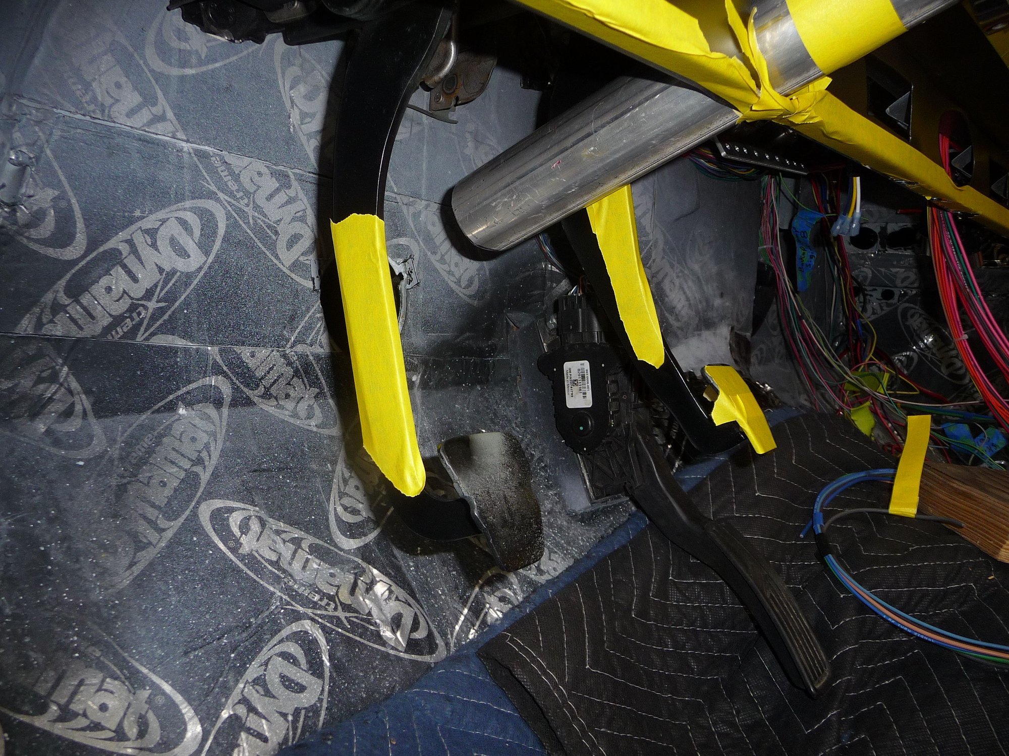

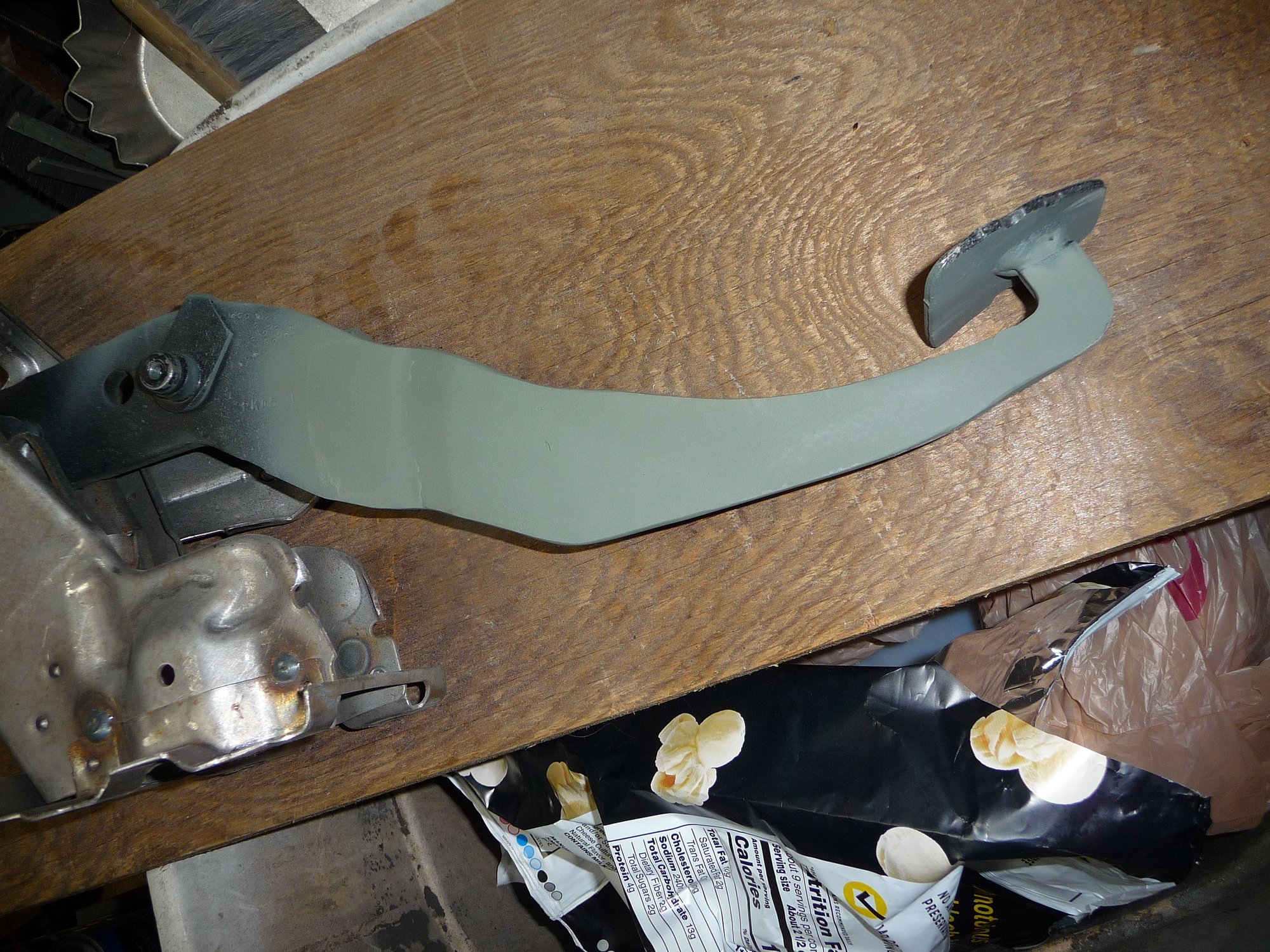

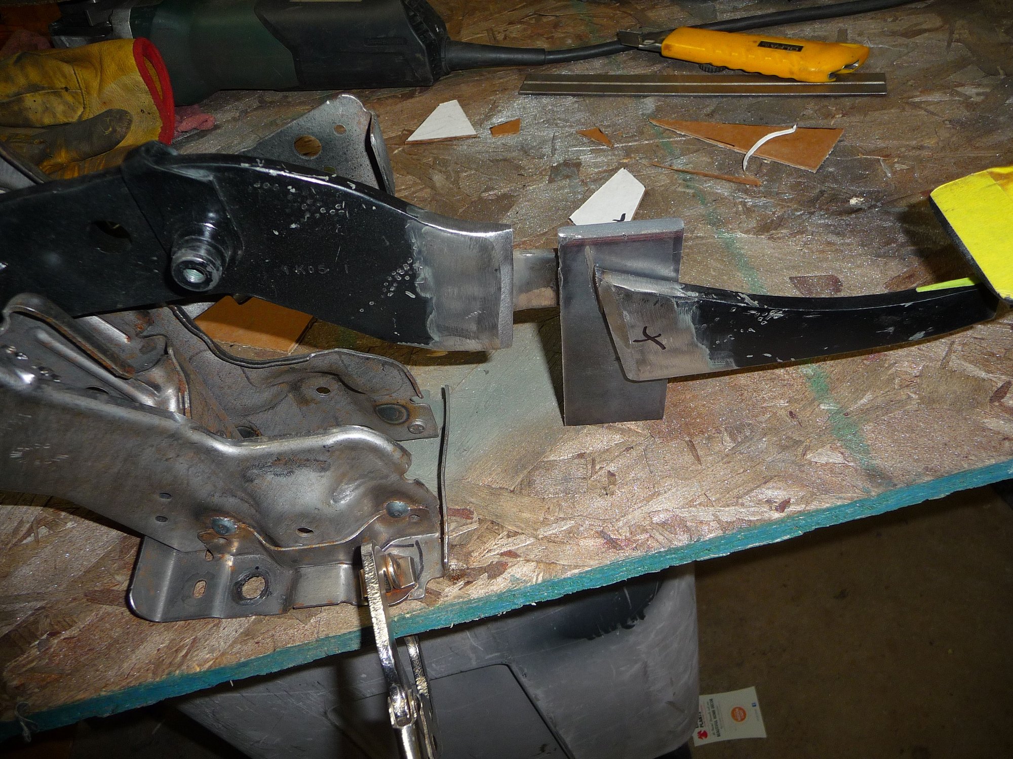

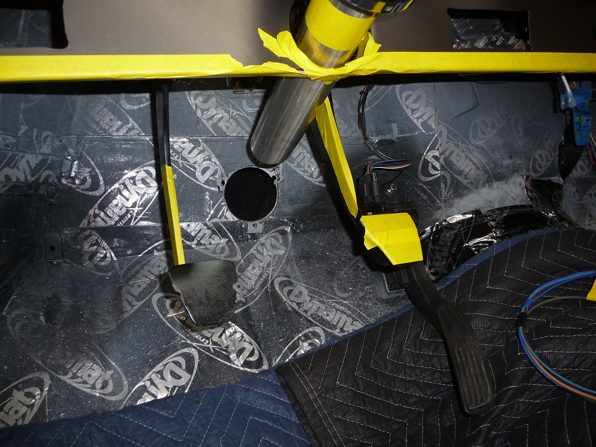

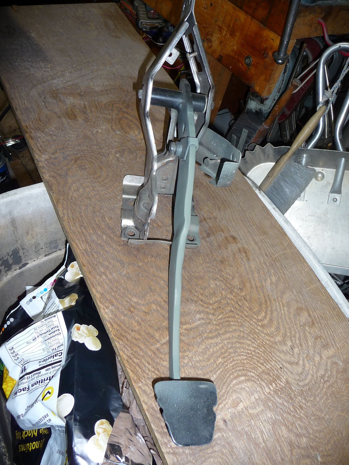

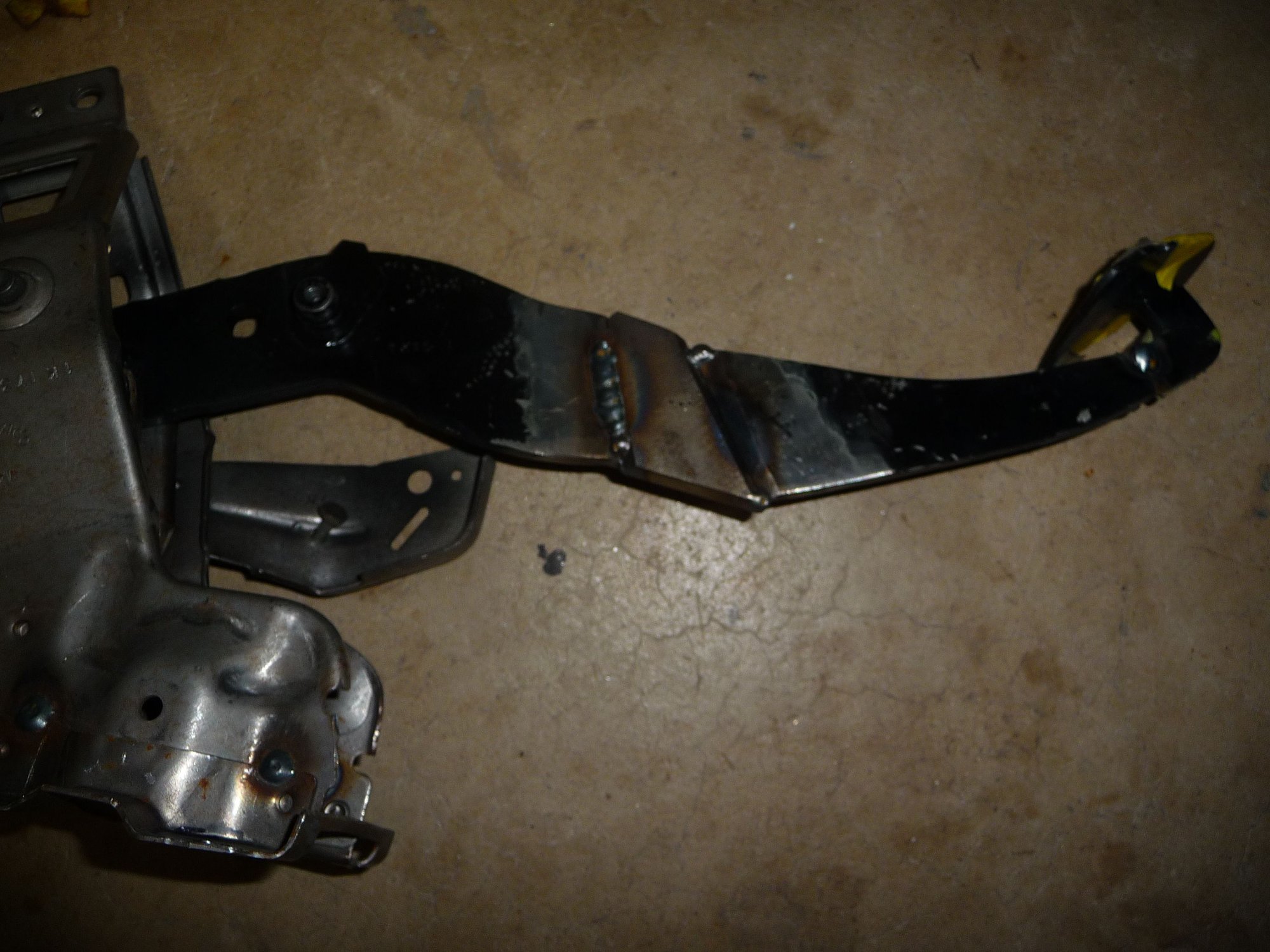

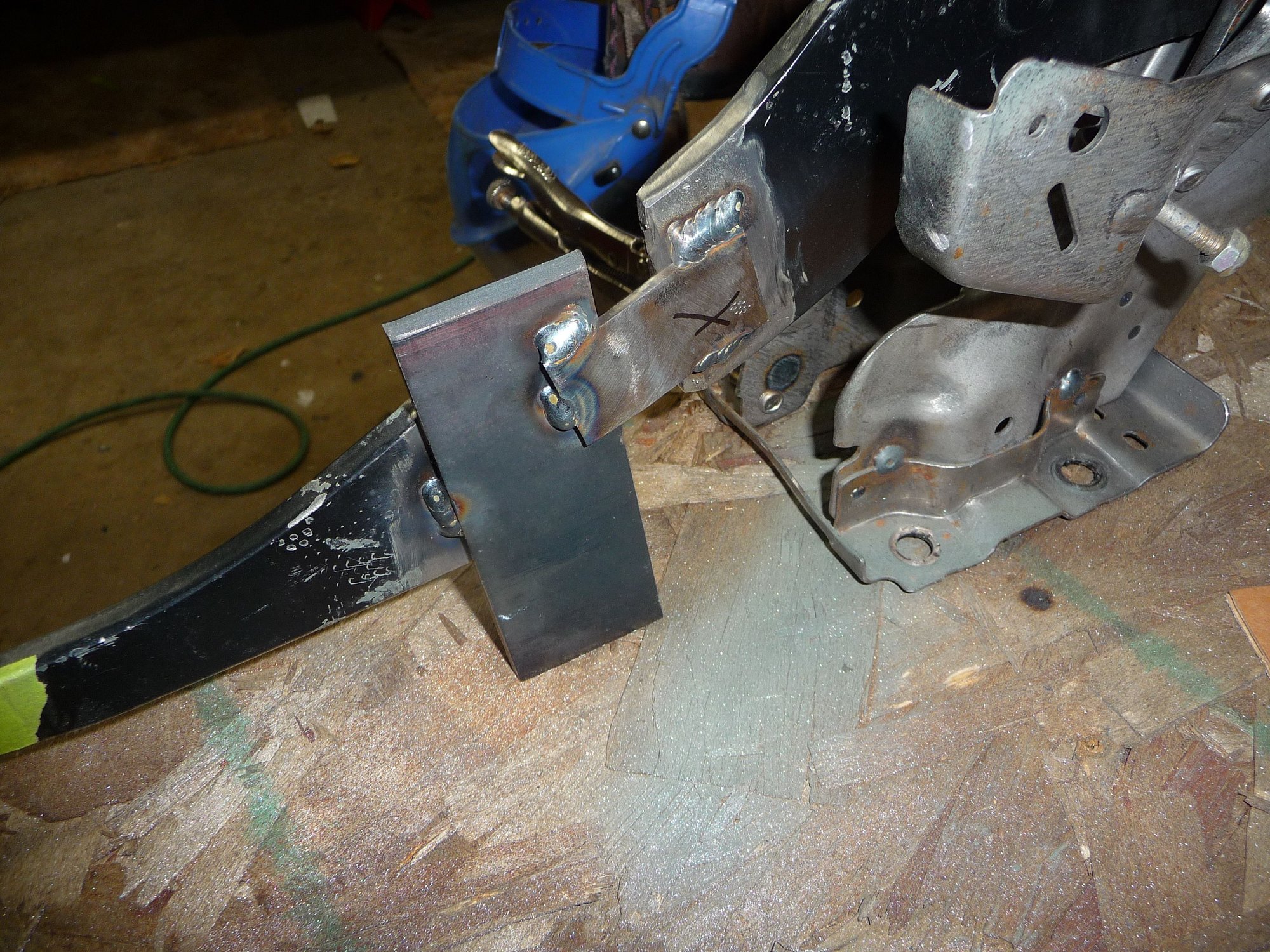

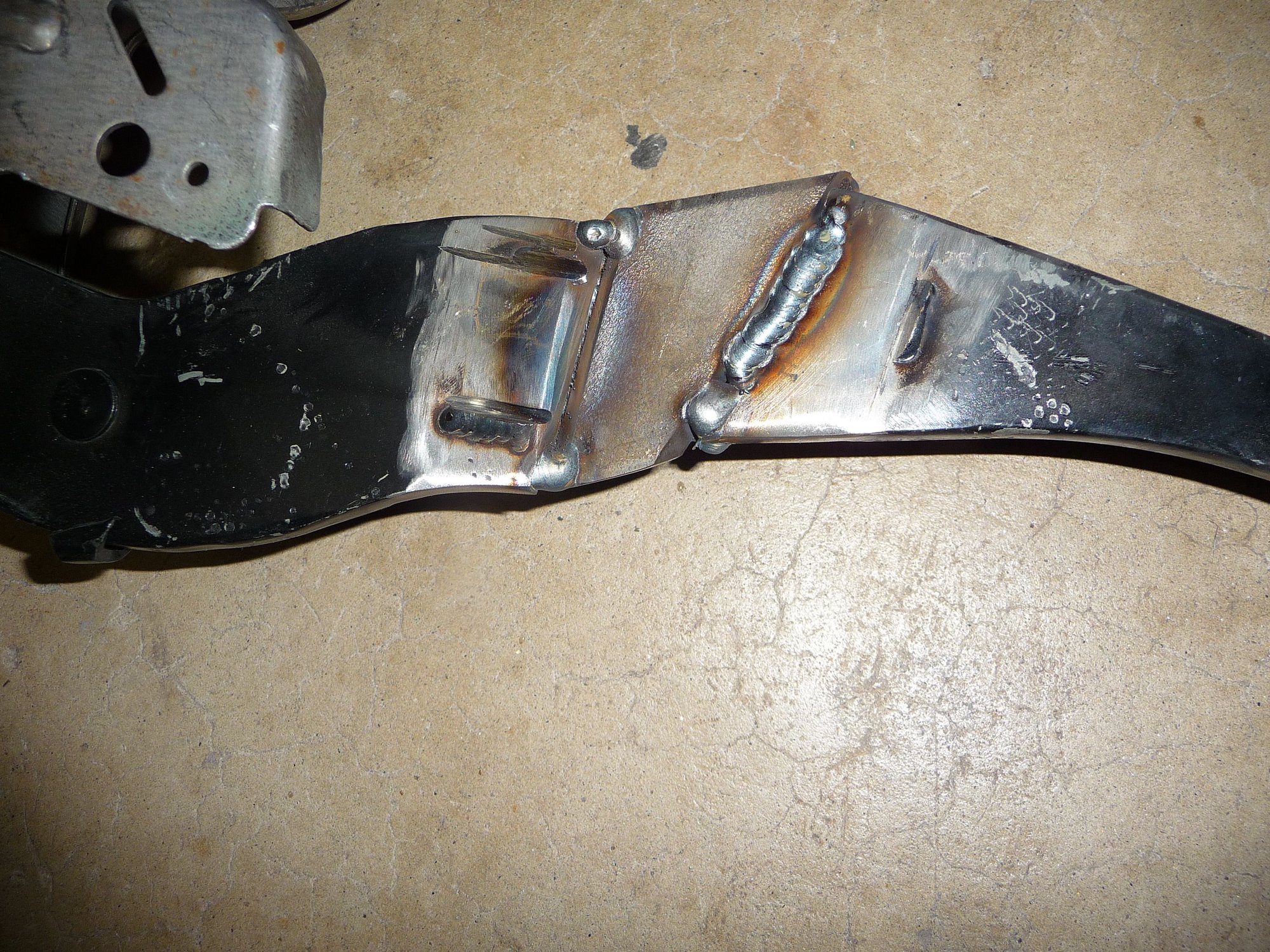

Her'es a few pix of fabing the Brake pedal, was way to HIGH to use--- cut it in 2 and added a plate,V ground plate and welded it back together. This is getting close to be able to start up, want to make sure it will run ,before I go any further with the wiring. This is starting to finely take shape.
Brake pedal was way out of line
Cut in half to add in a piece of plate, and welded up..
Some scrap welded to pedal to mock up the pedal into the right place.
Plate to move pedal into place.
Came out nice.

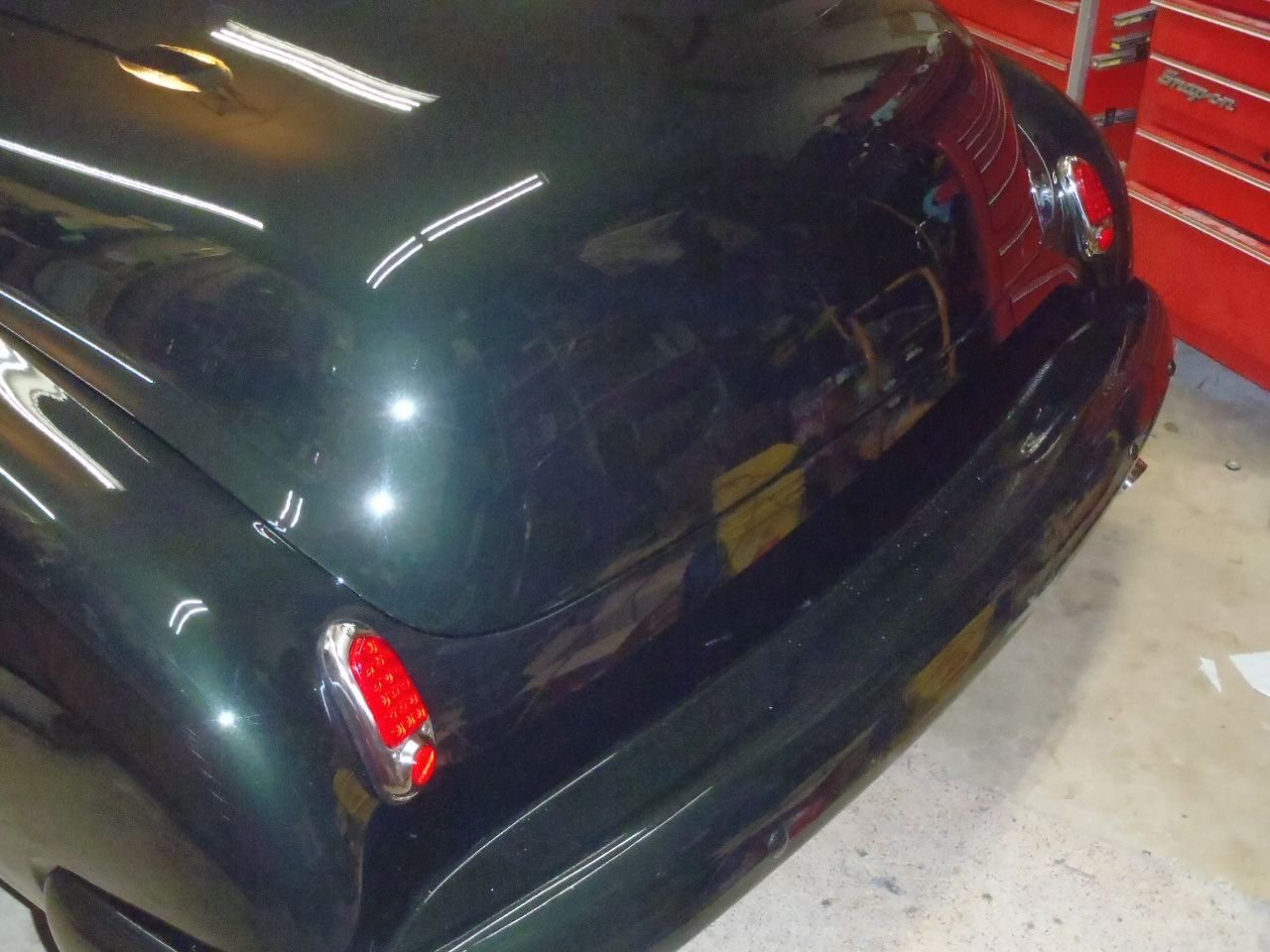

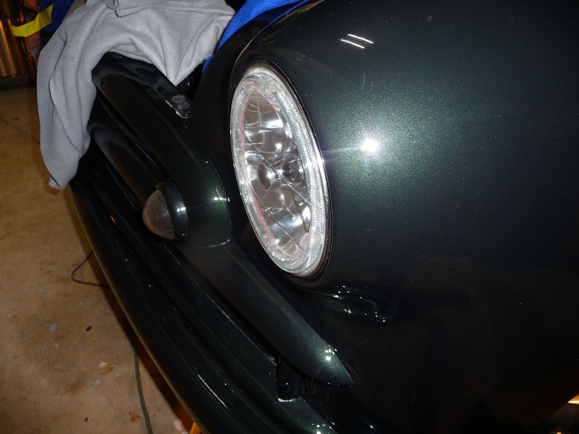

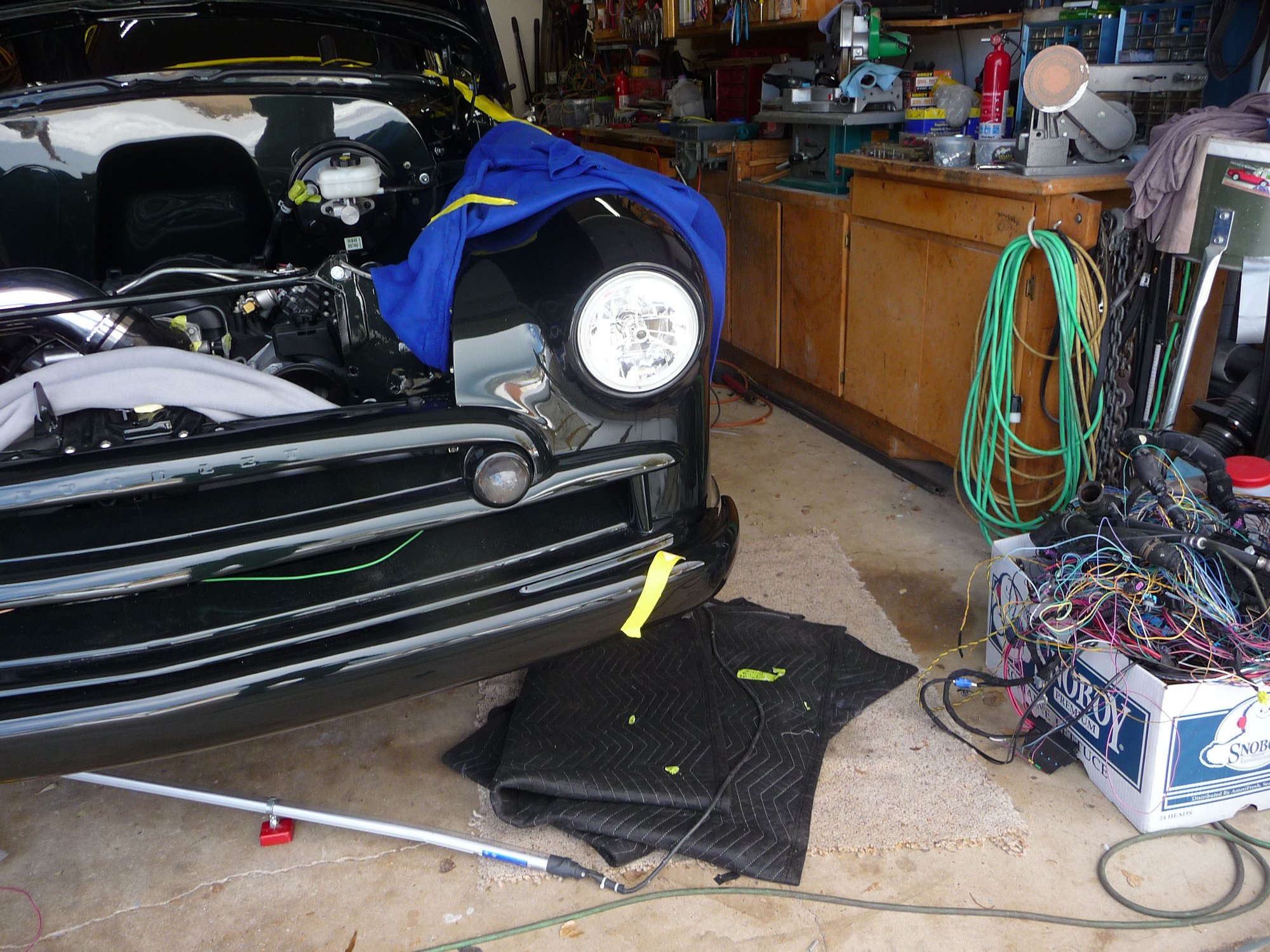

Headlights are in -- Look great-- headlights, tail lights are all wired up, This is starting to take shape.
These look great, I was a little leary how these would turn out, but I'm quite happy with the results.
Shines nice.
