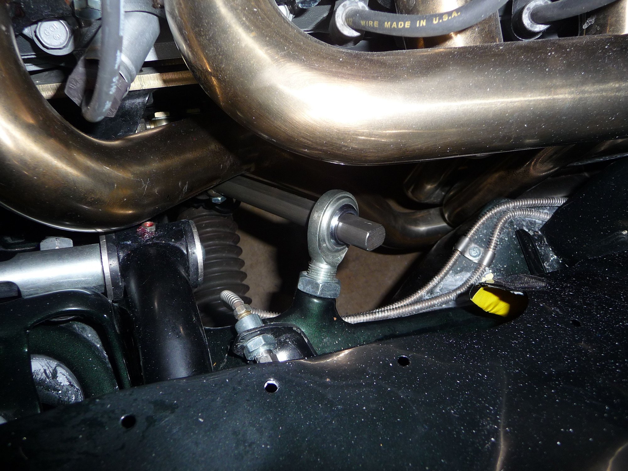

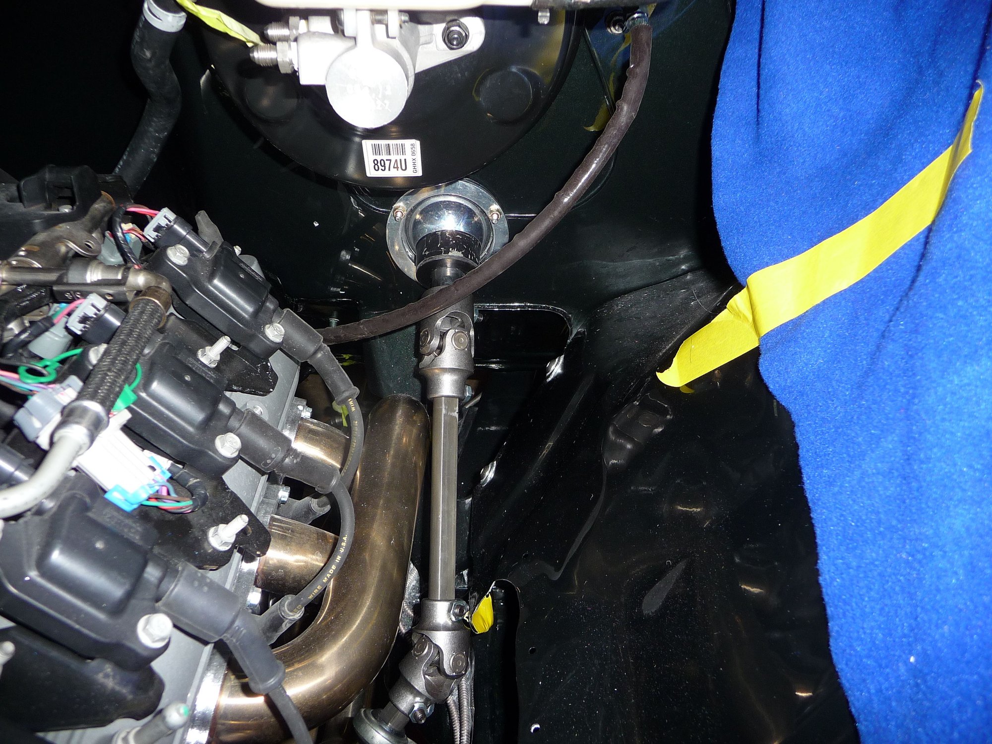

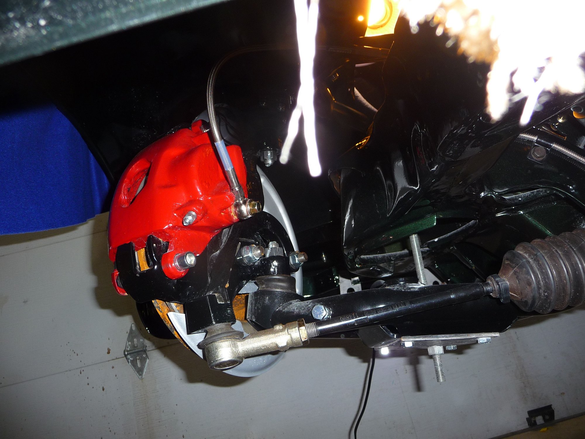

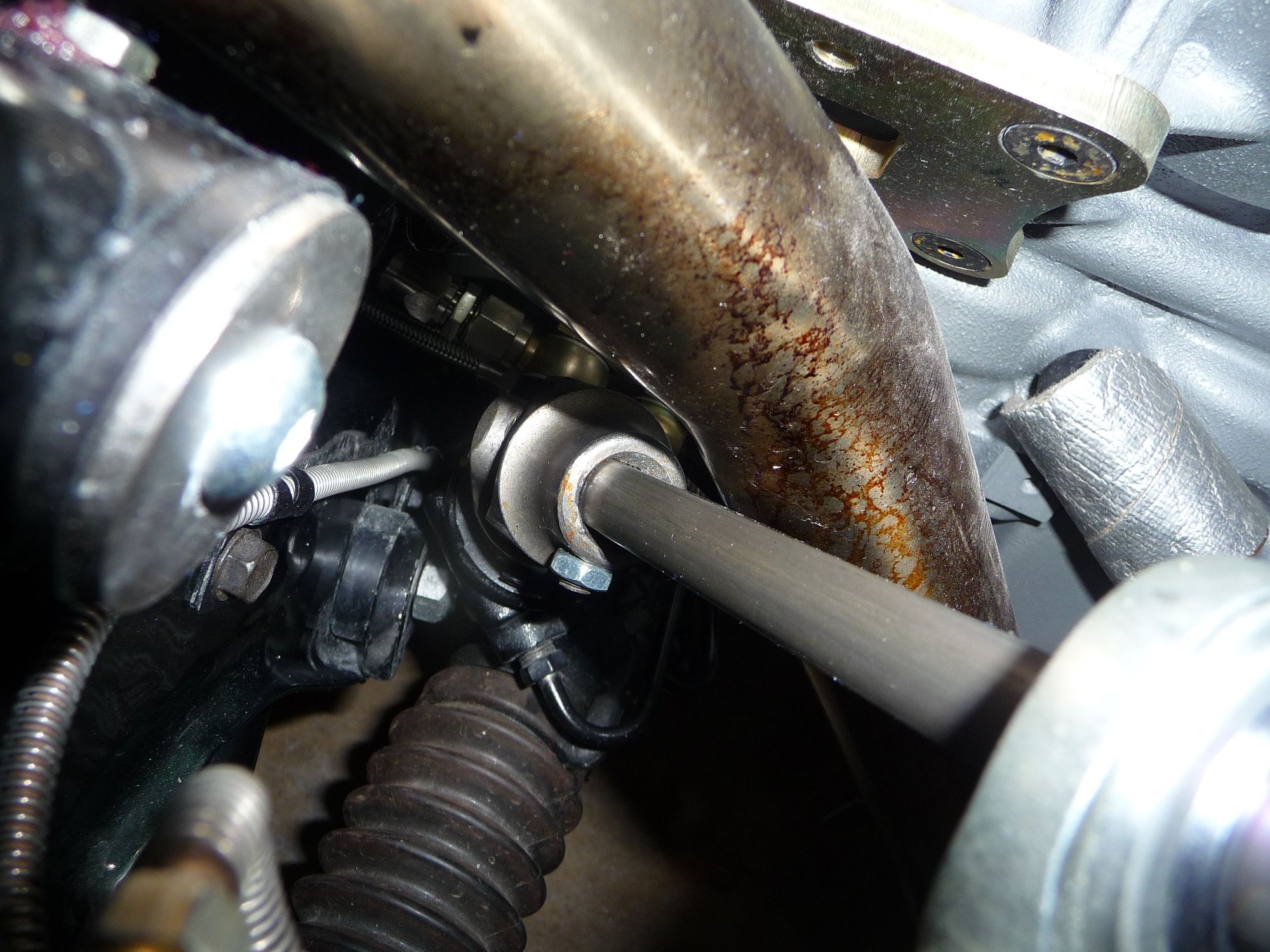

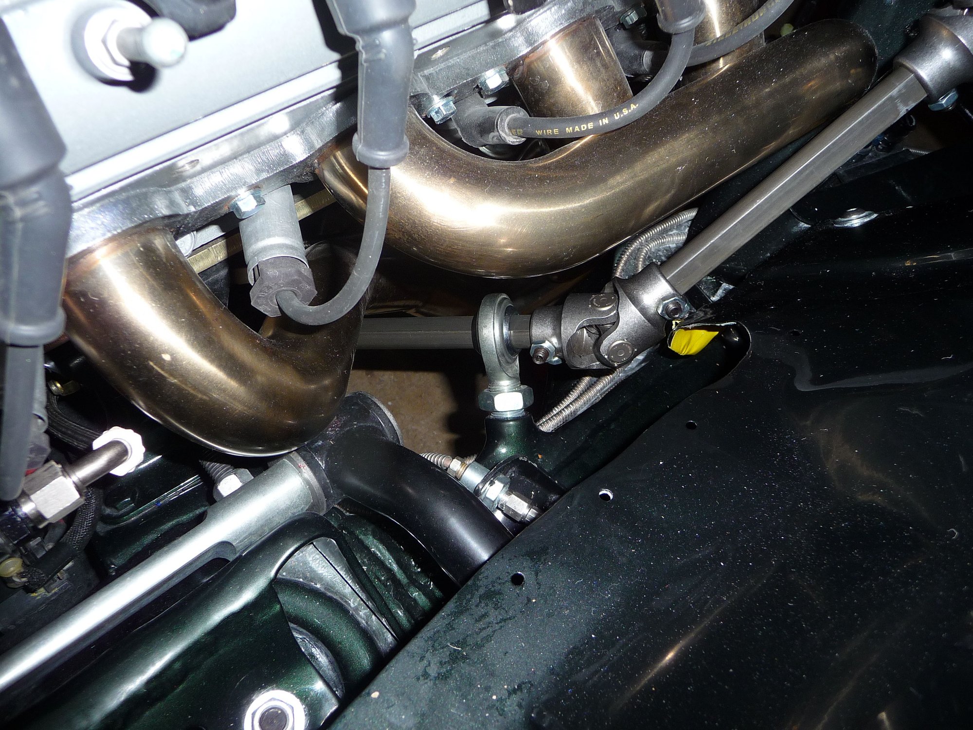

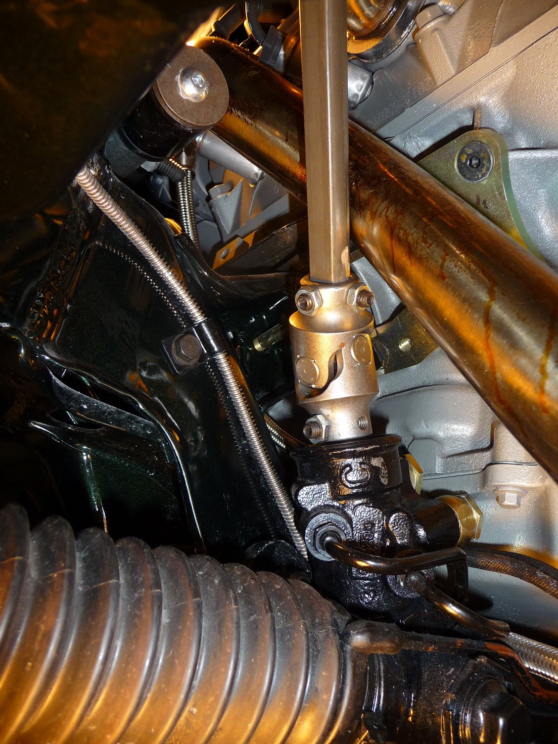

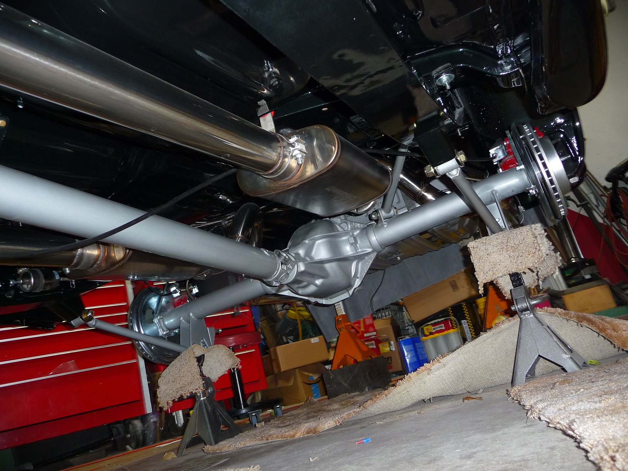

A few more pix of the progress , steering column and linkage to the P/S rack-pinion.

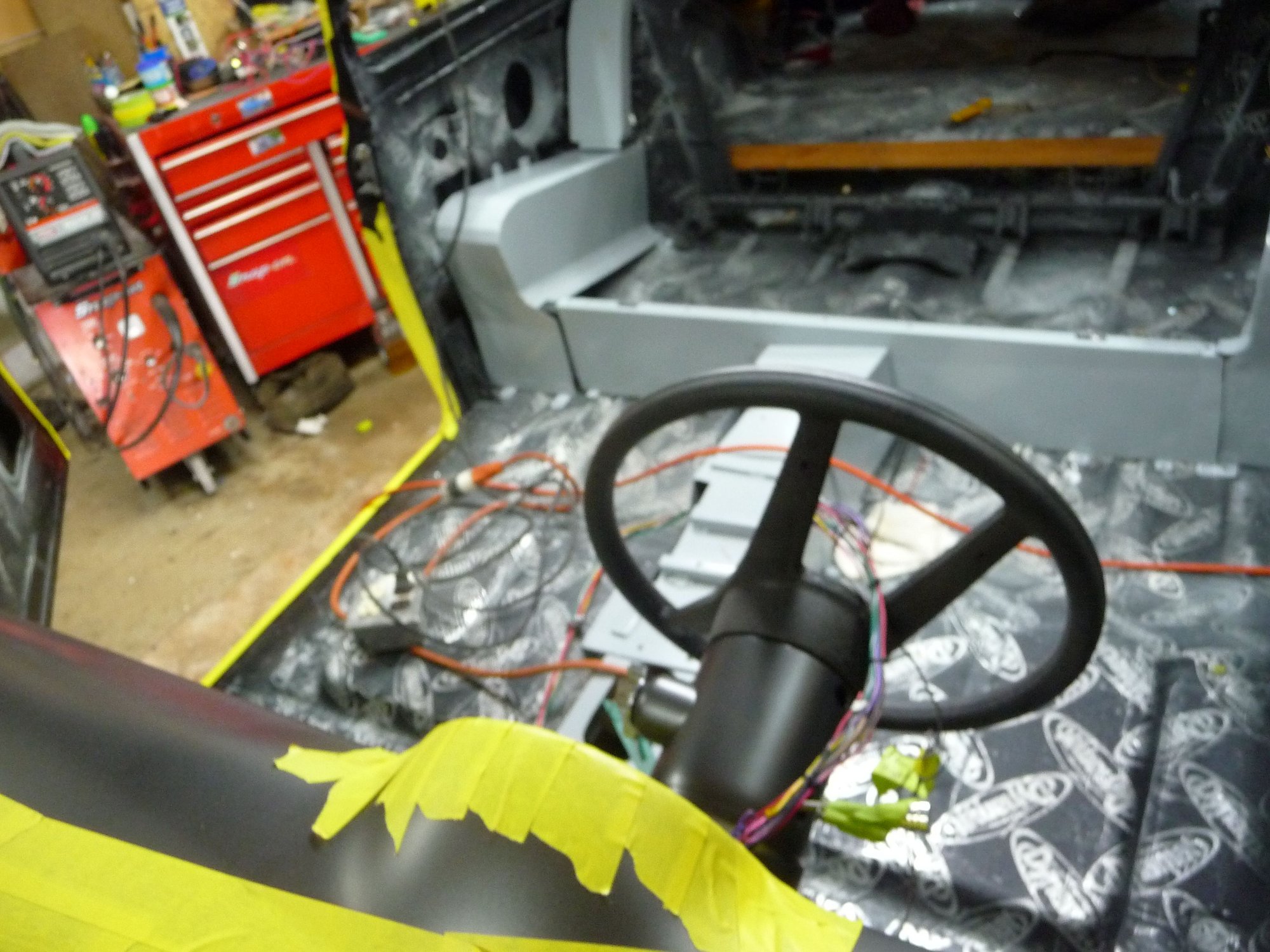

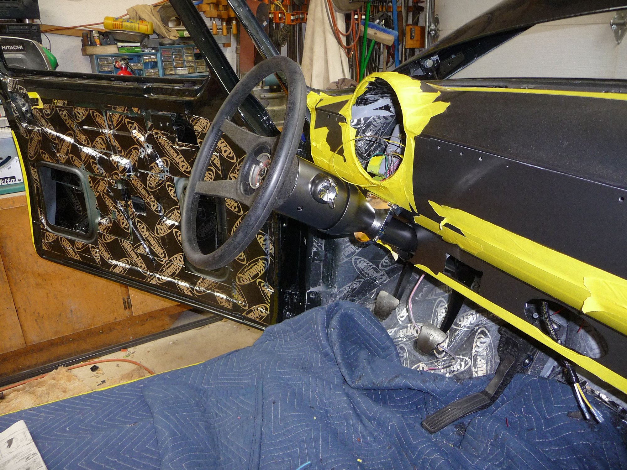

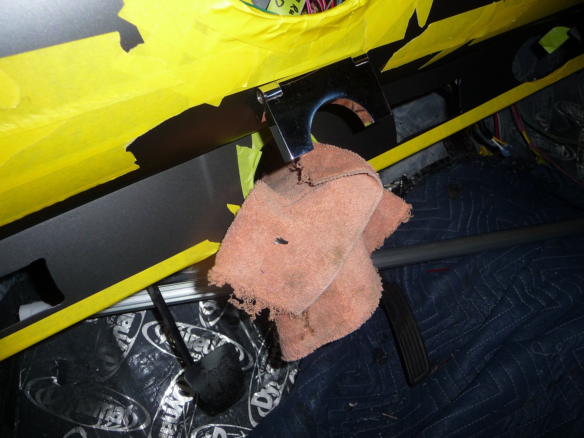

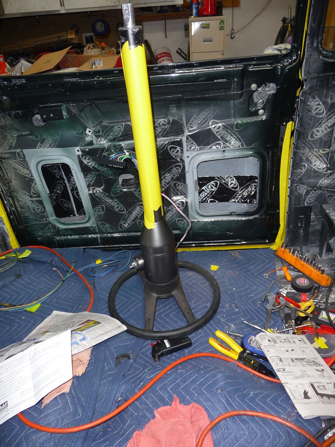

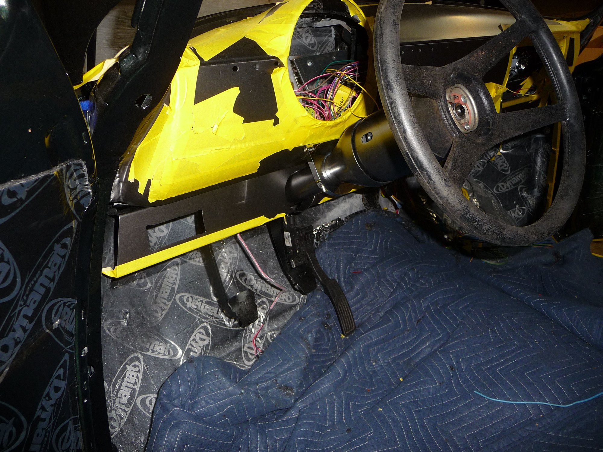

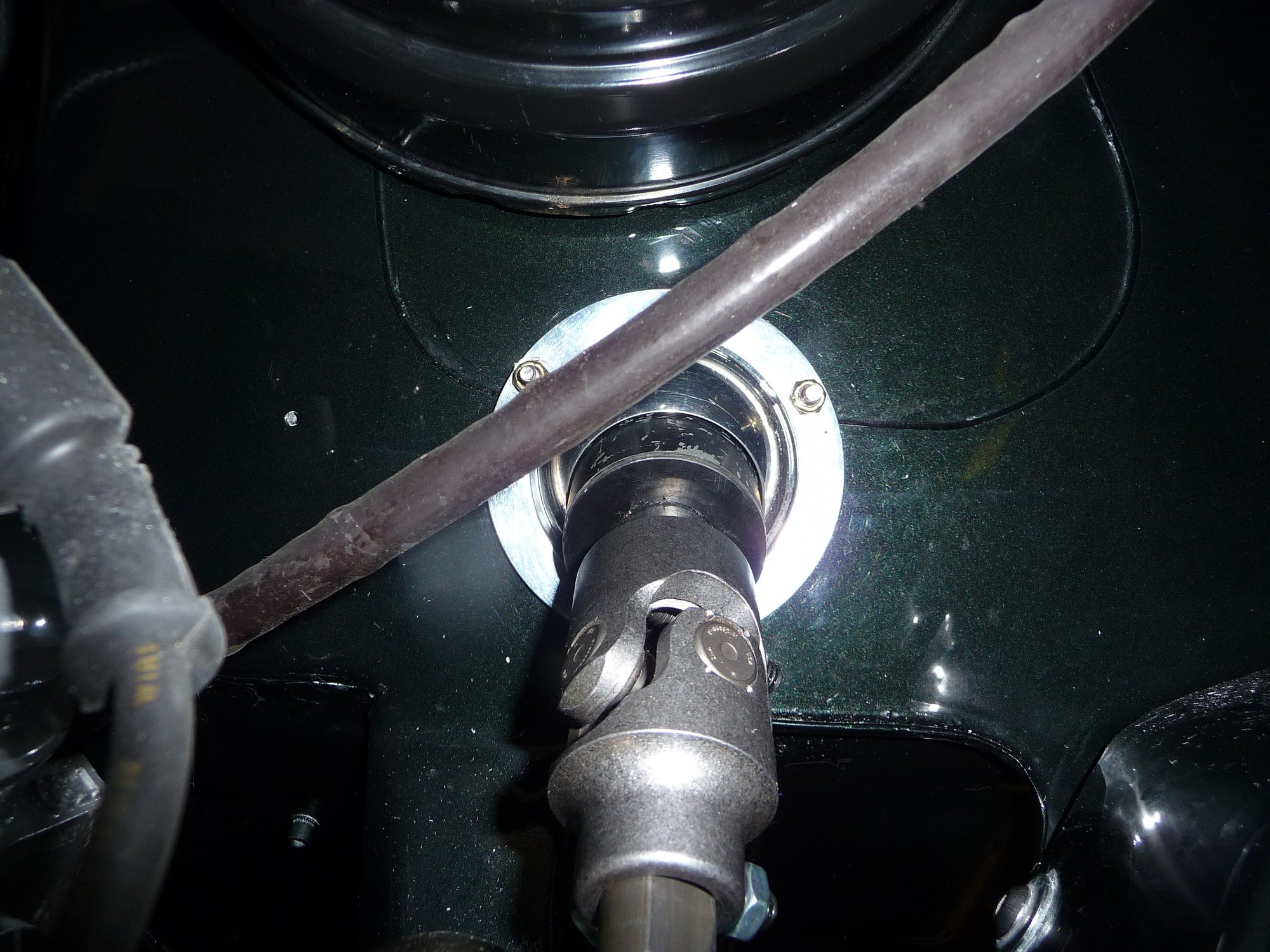

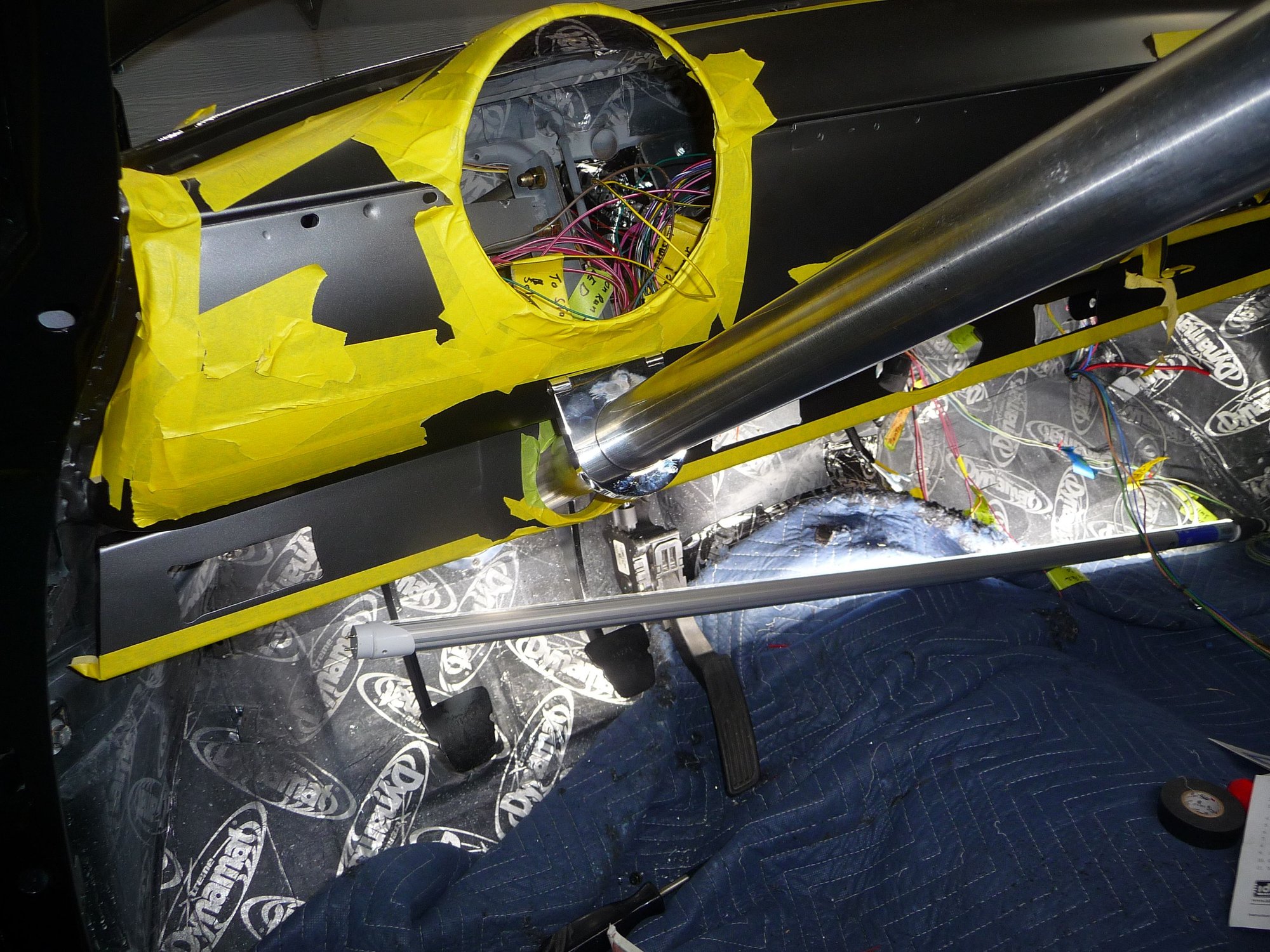

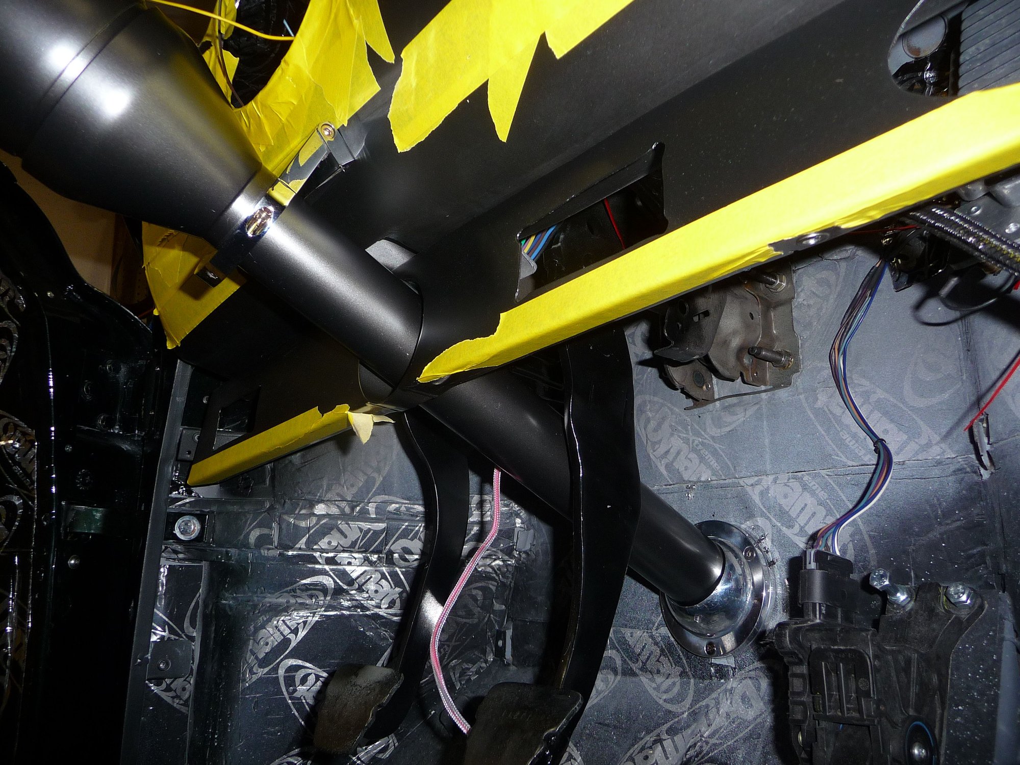

Steering column is installed, all the u-joints were spot drilled and thread locked. this is finaly taking shape -- won't be long before this will be far along so I can start this.
Column fit up came out nice

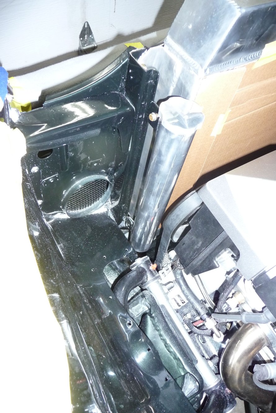

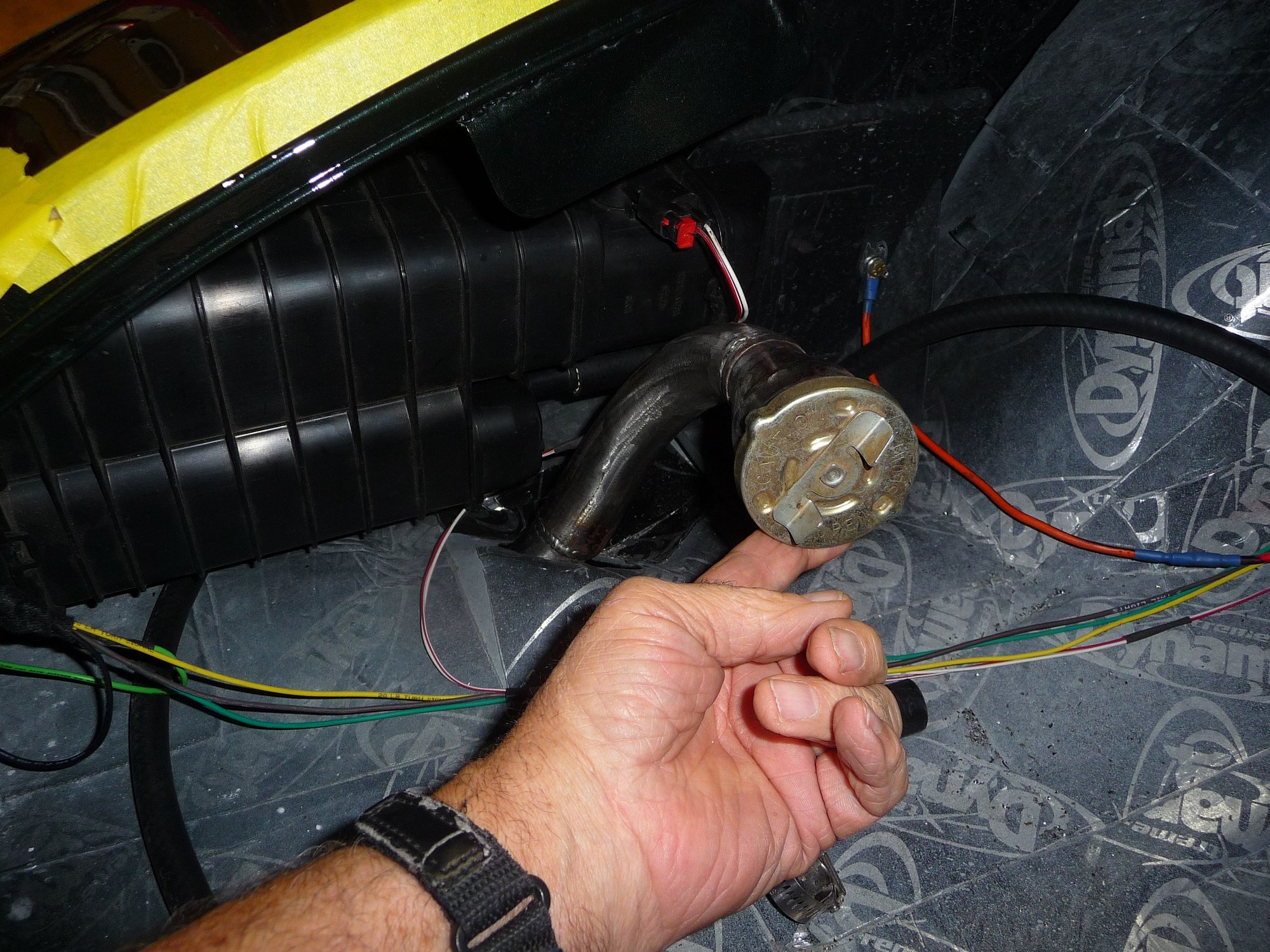

In trunk gas filler

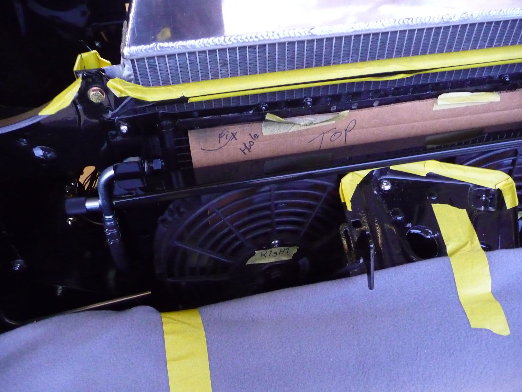

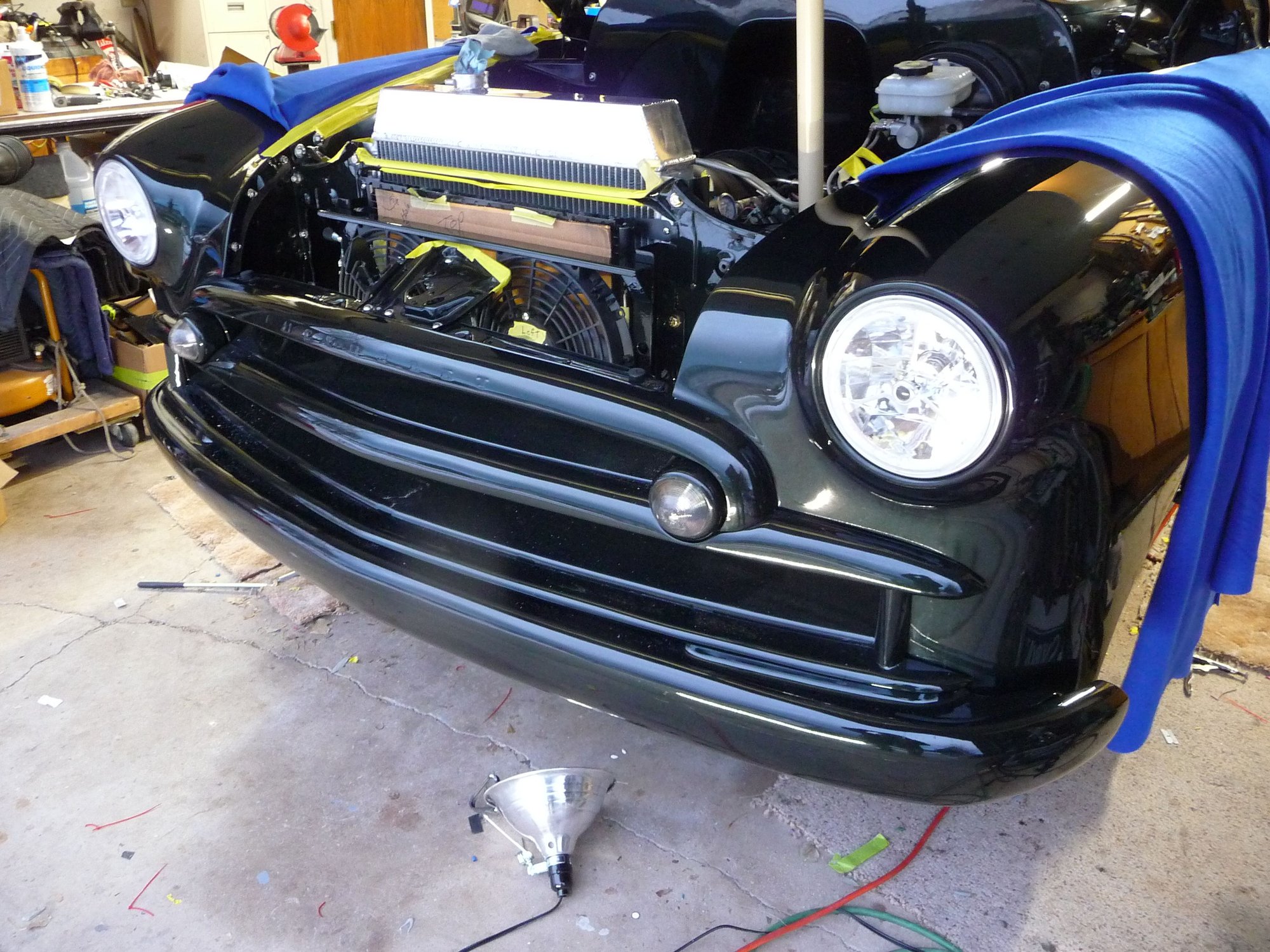

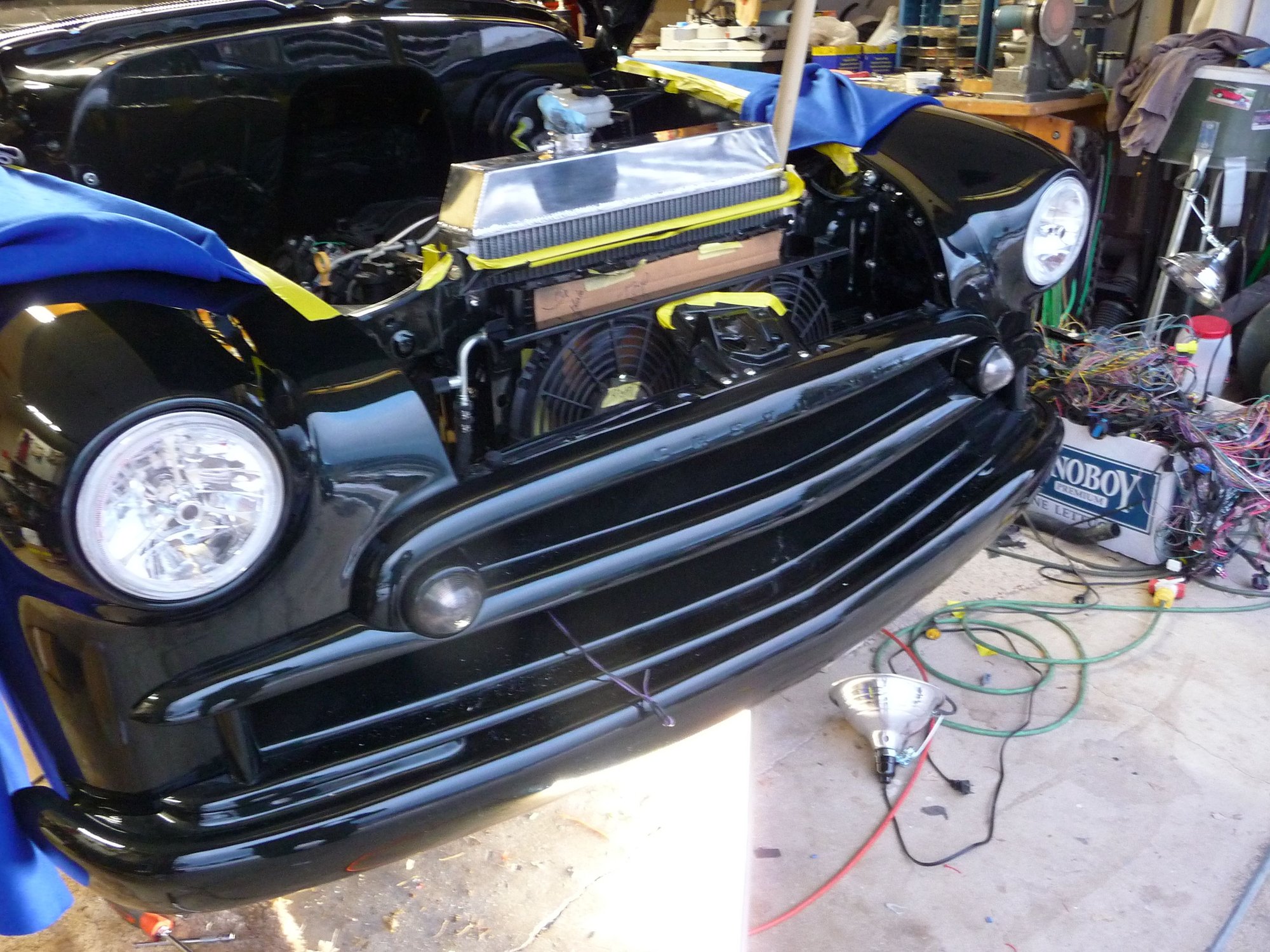

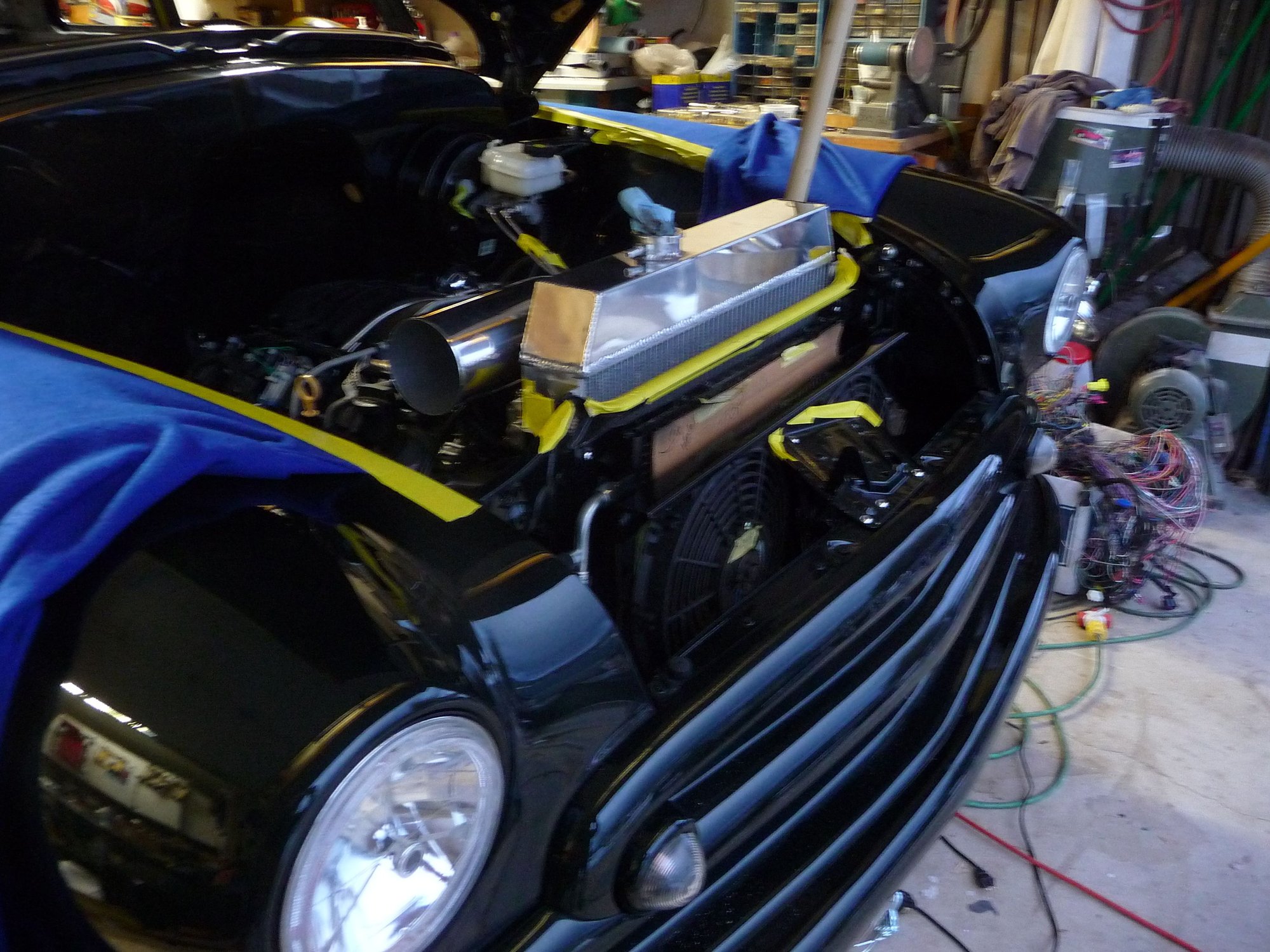

Brackets to hold fans in place came out nice.

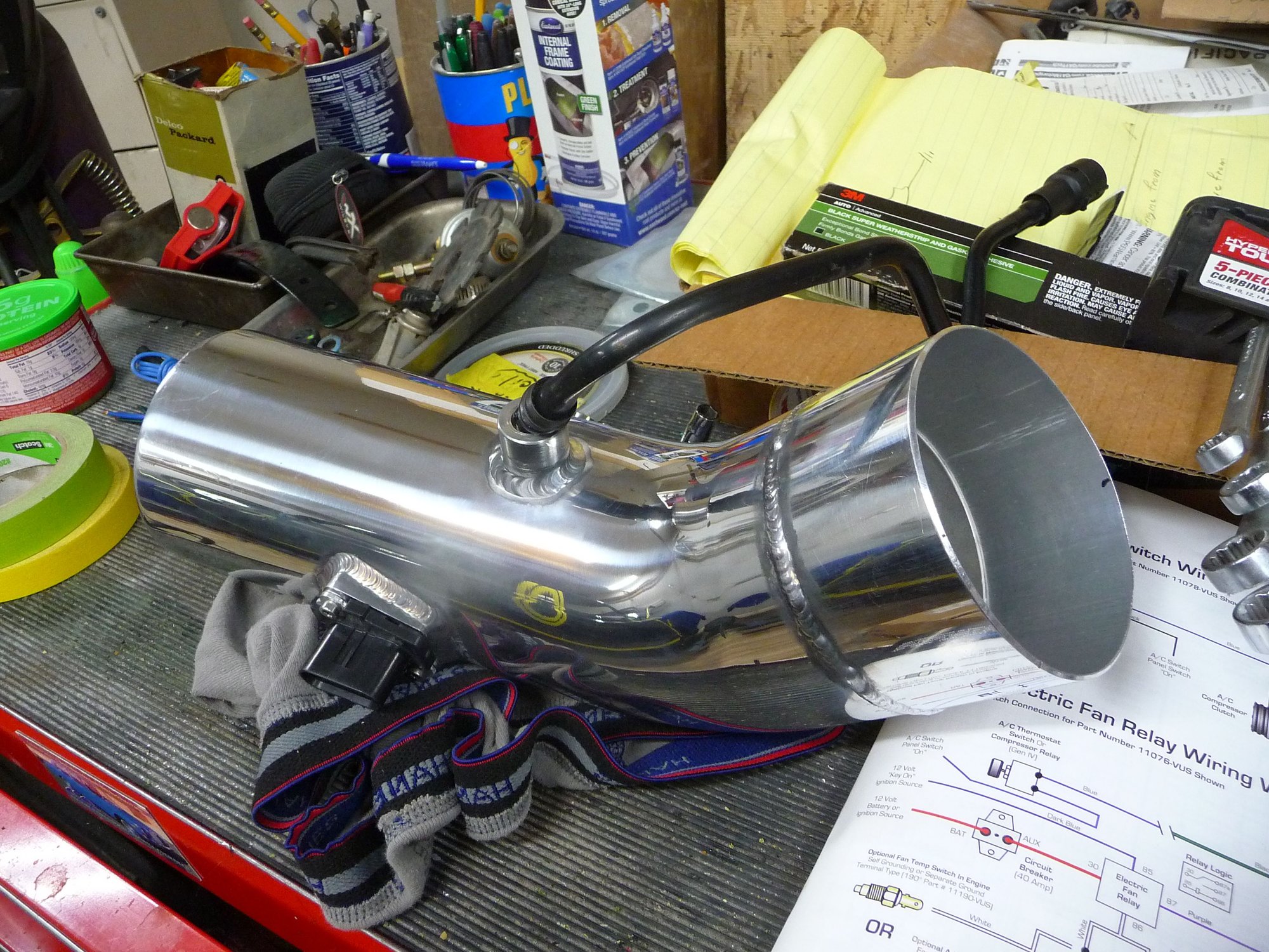

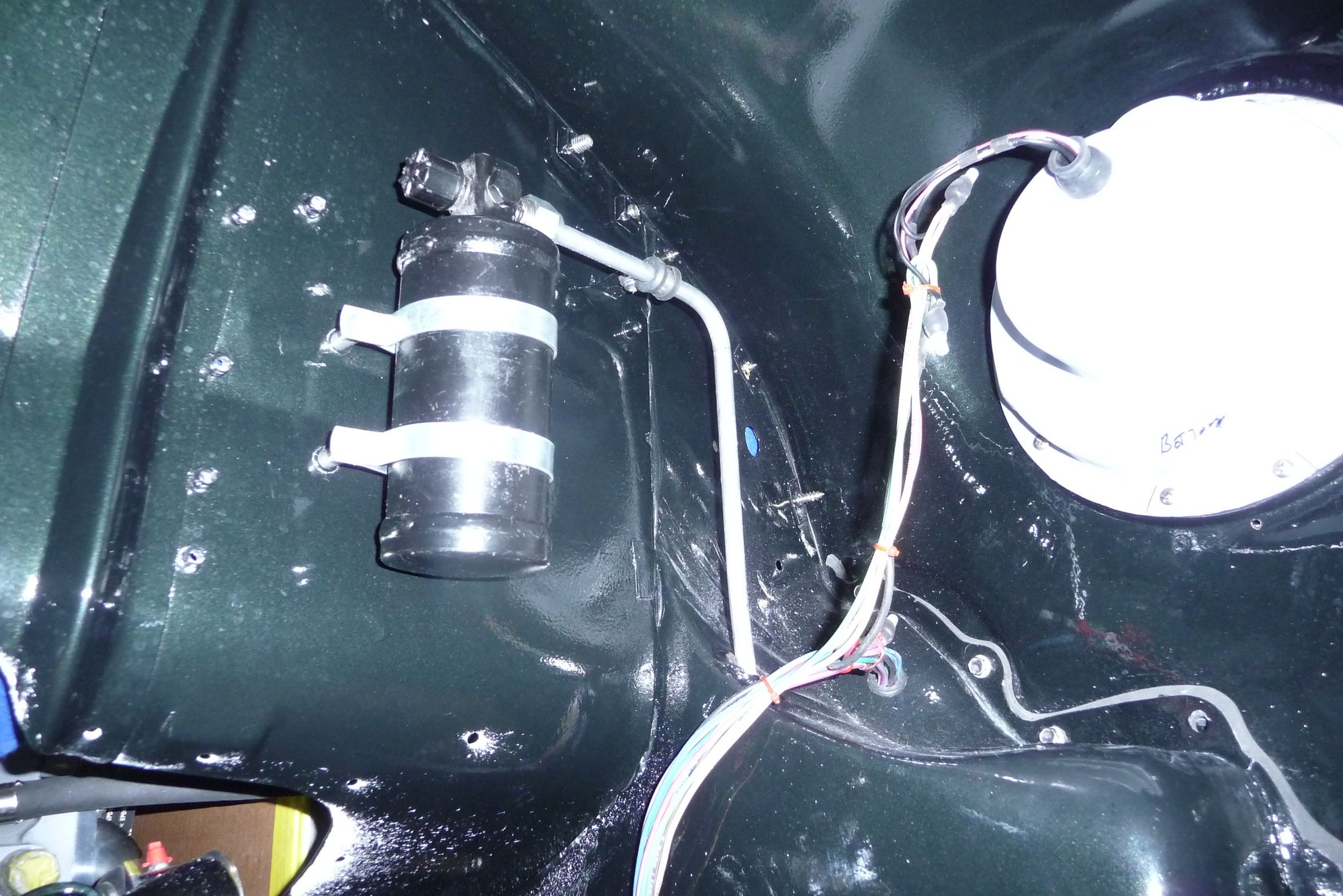

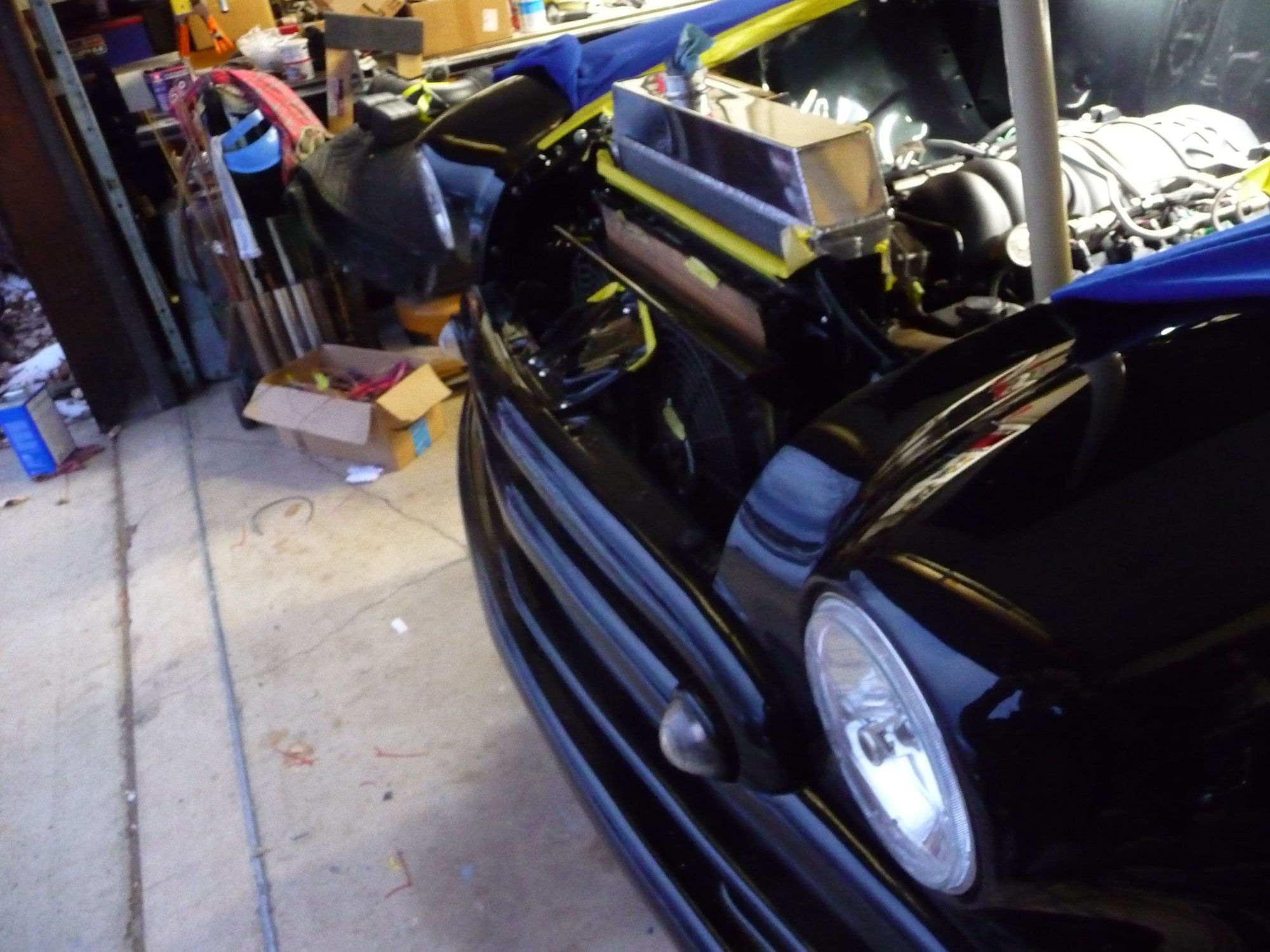

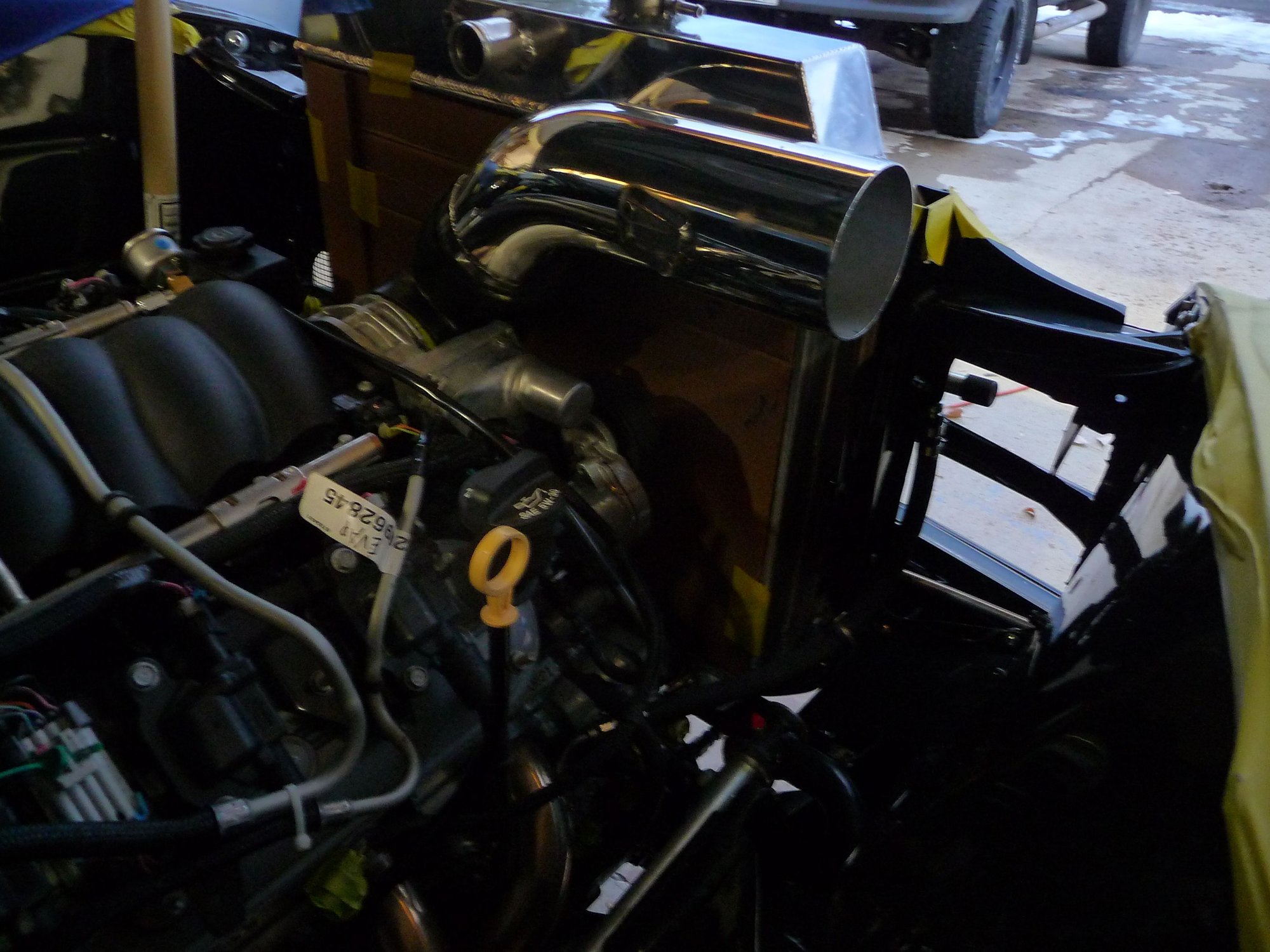

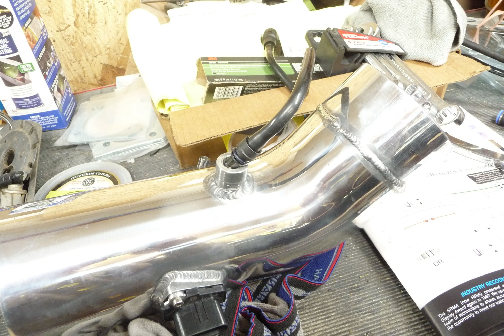

tig welded by a friend
a/c dryer

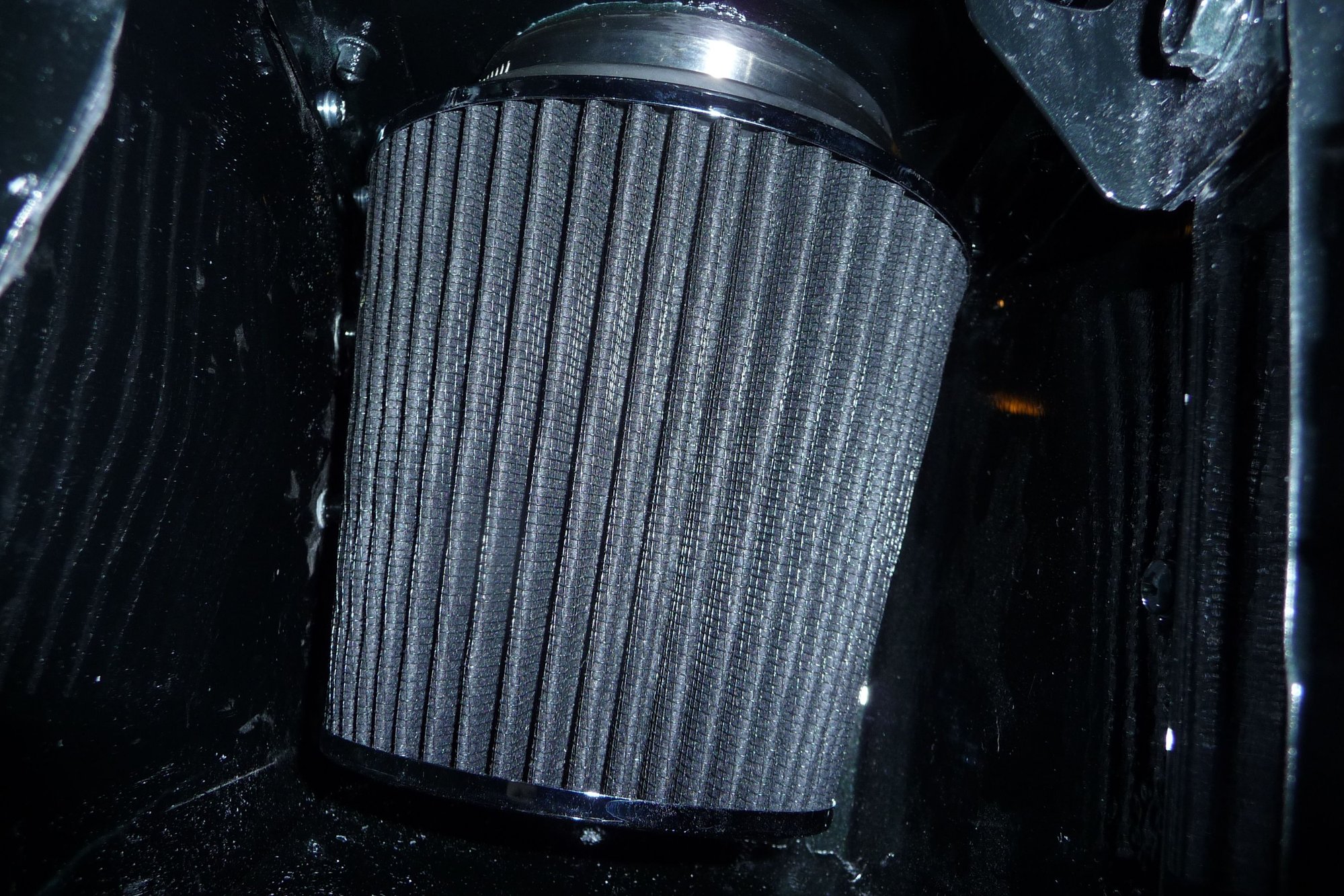

cold air intake
set int in place so Stero guy knows wwhat he is dealing with

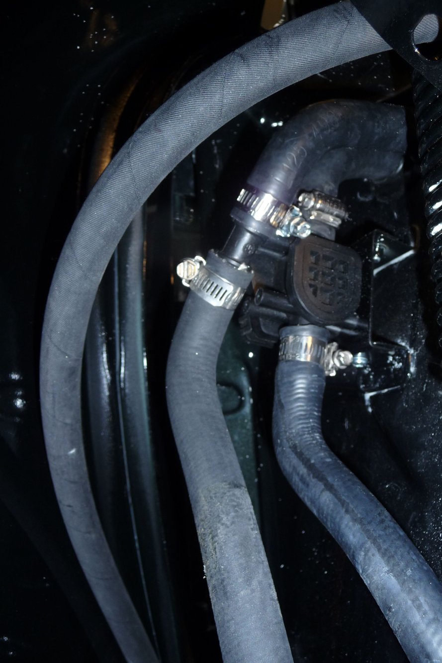

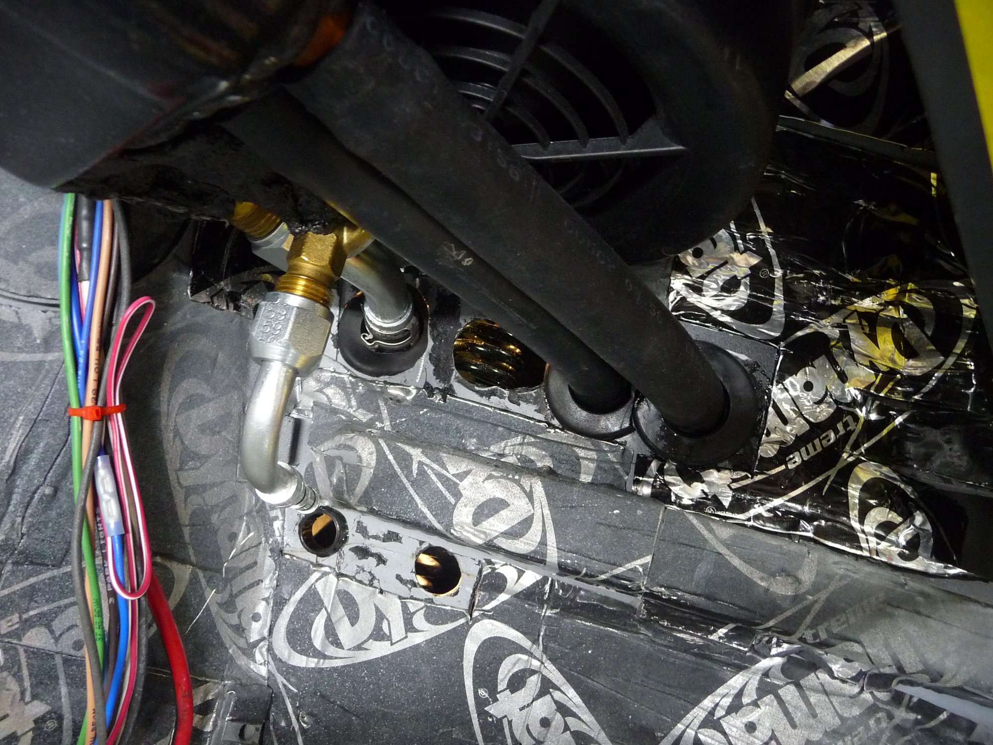

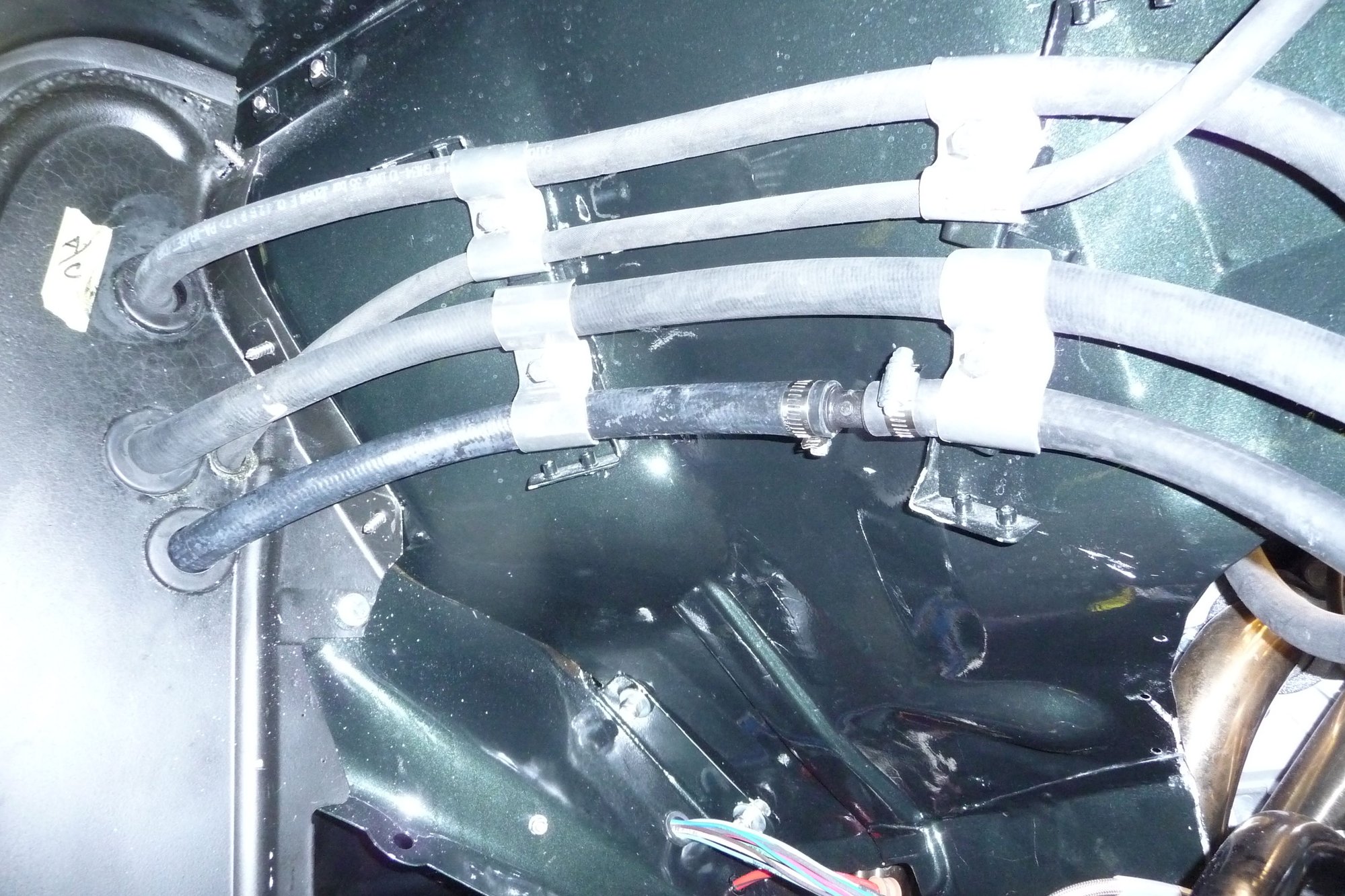

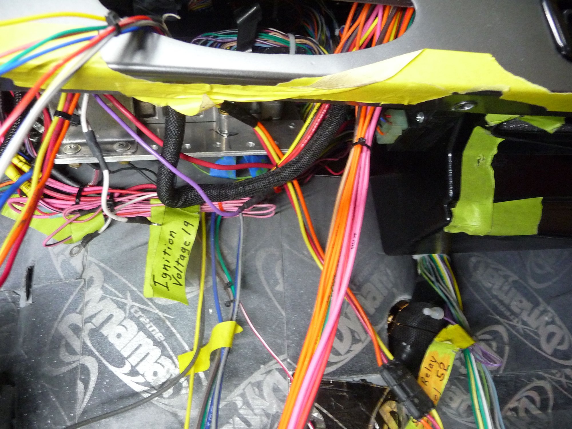

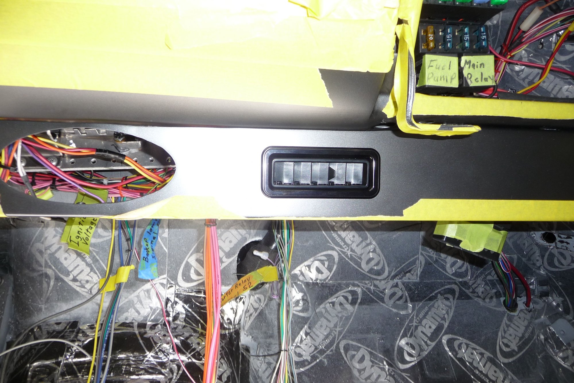

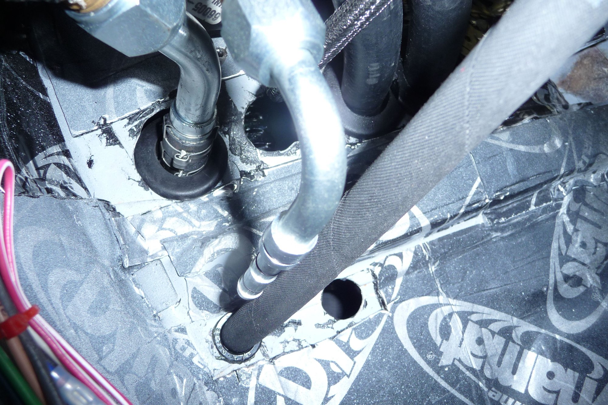

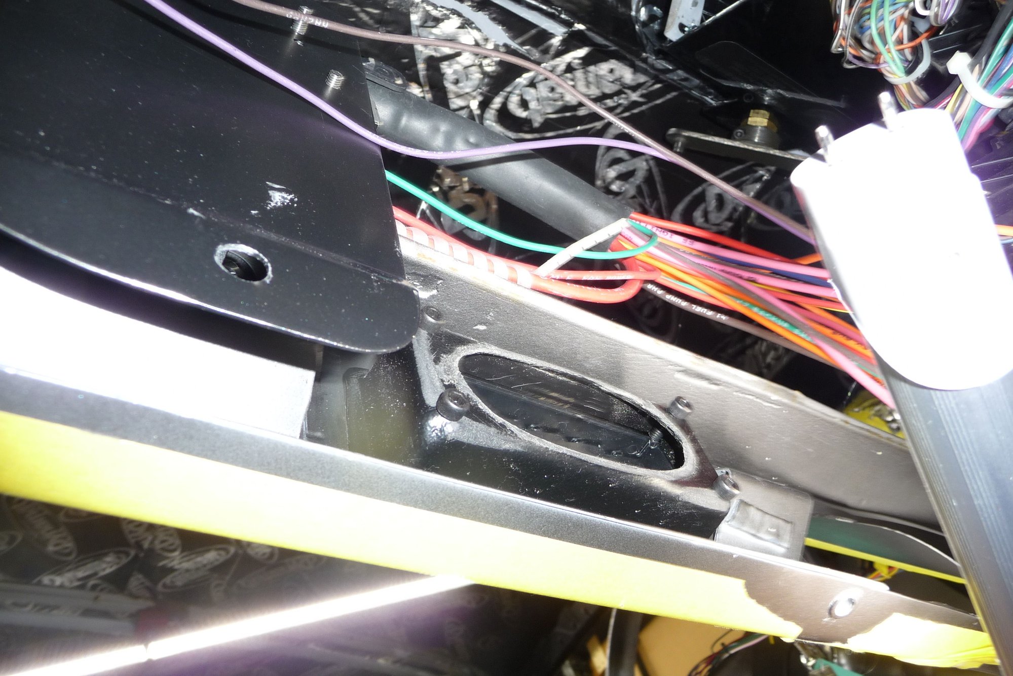

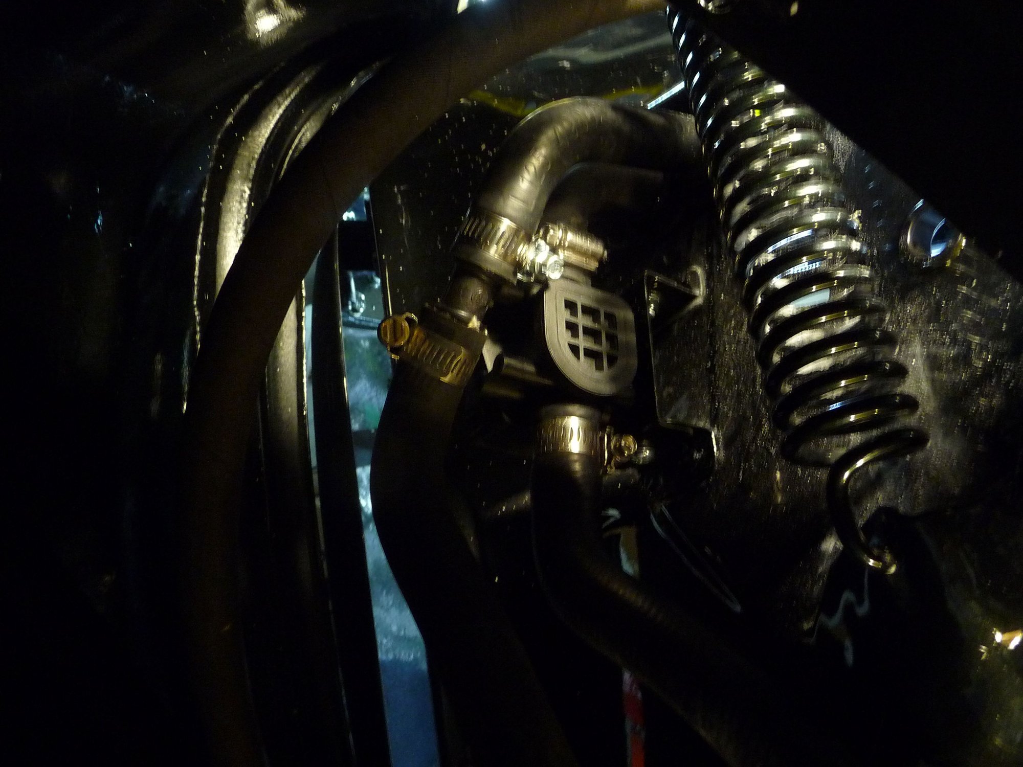

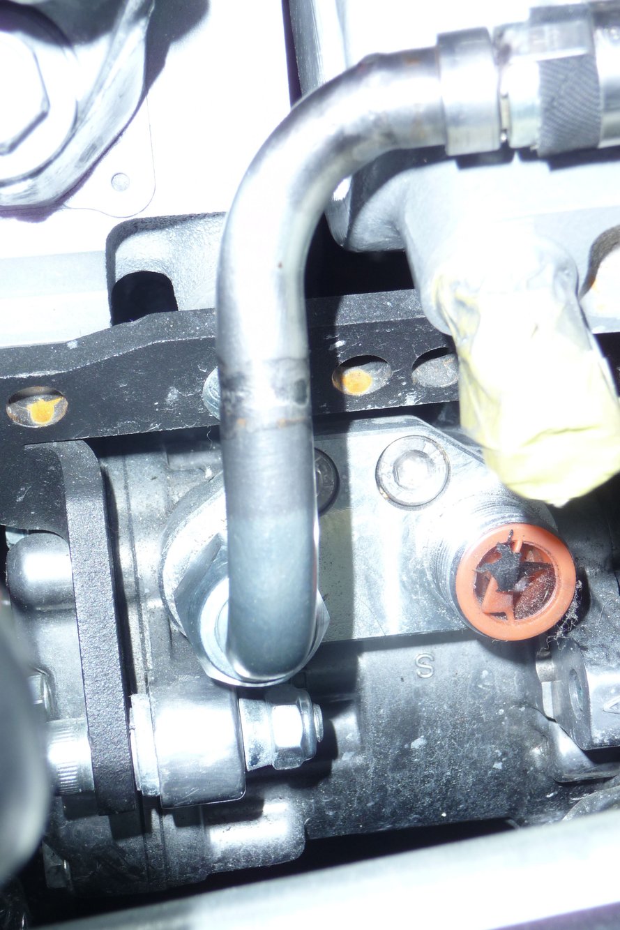

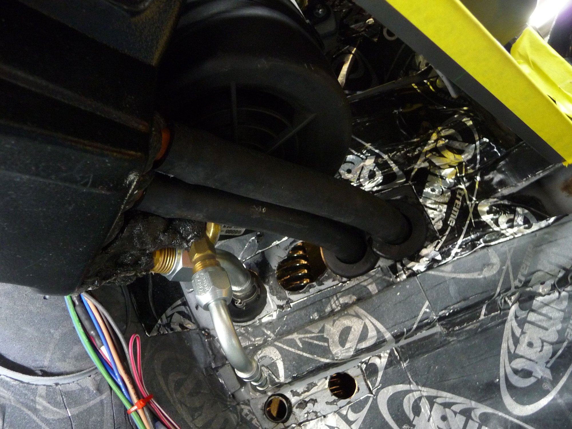

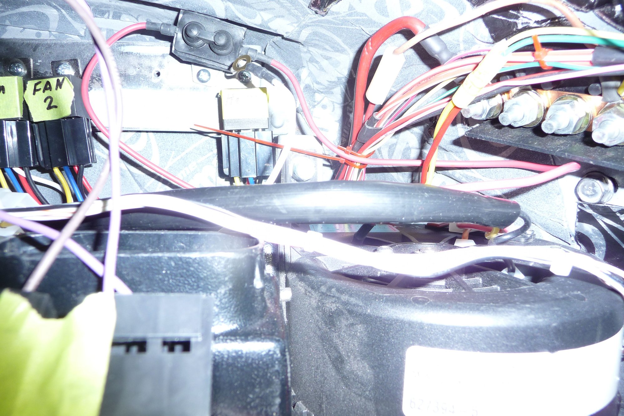

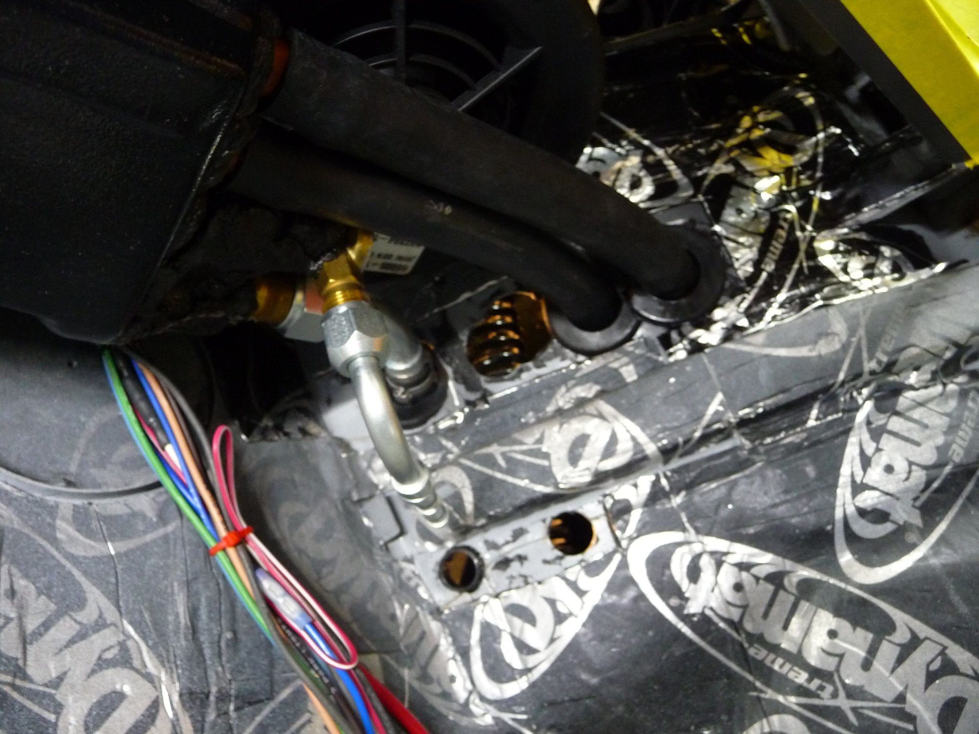

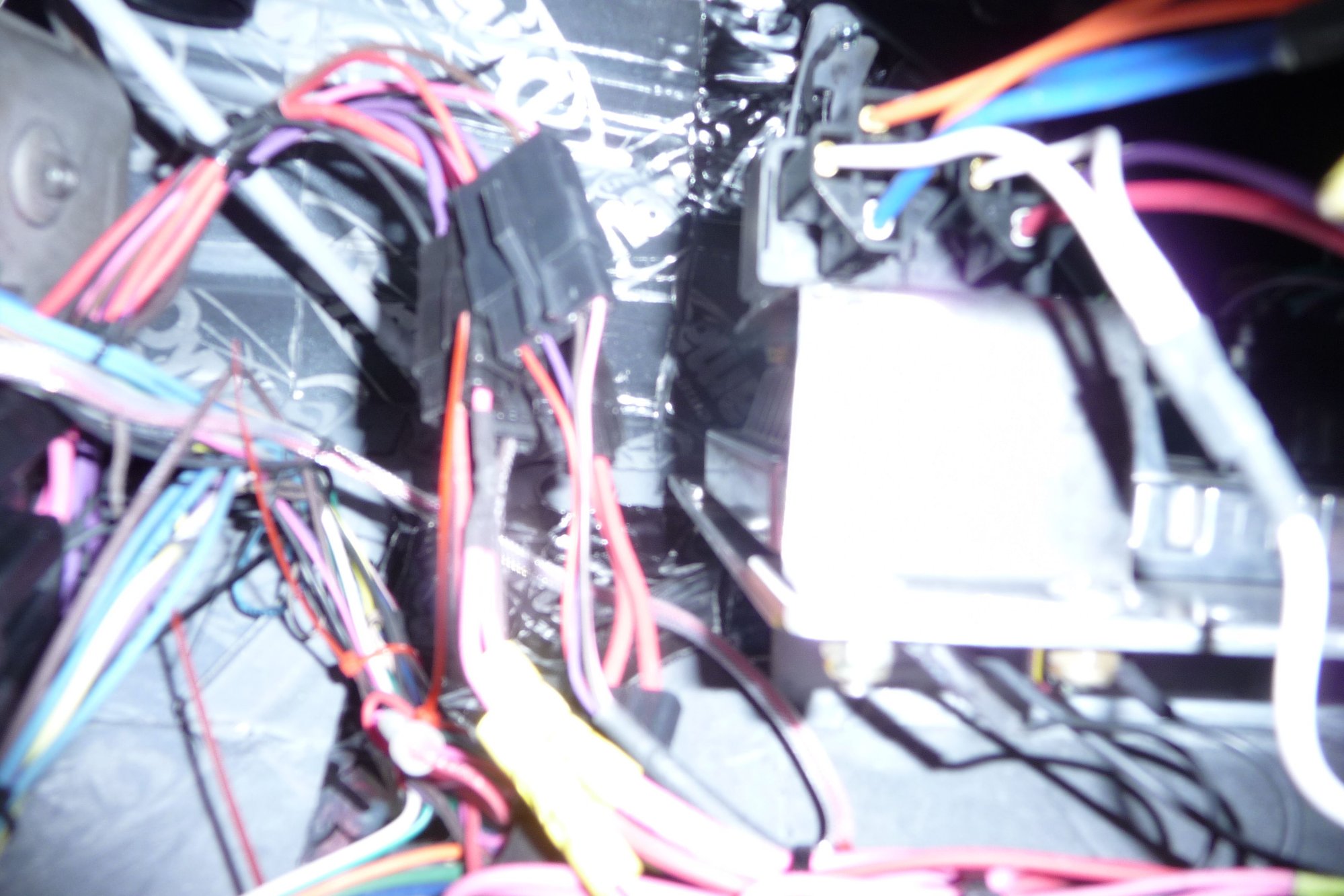

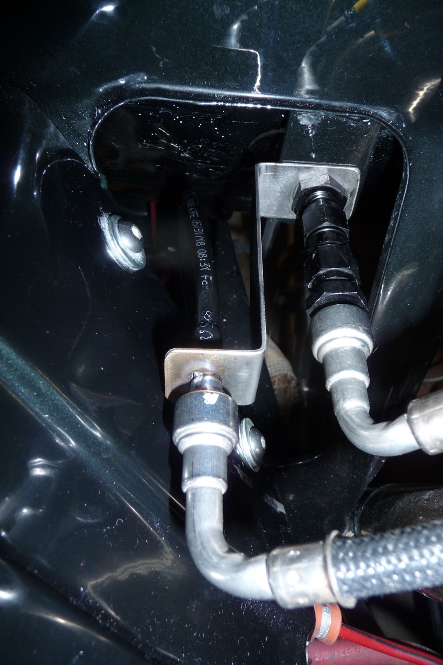

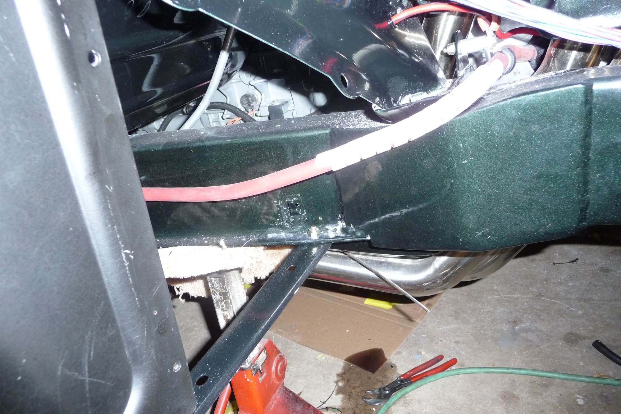

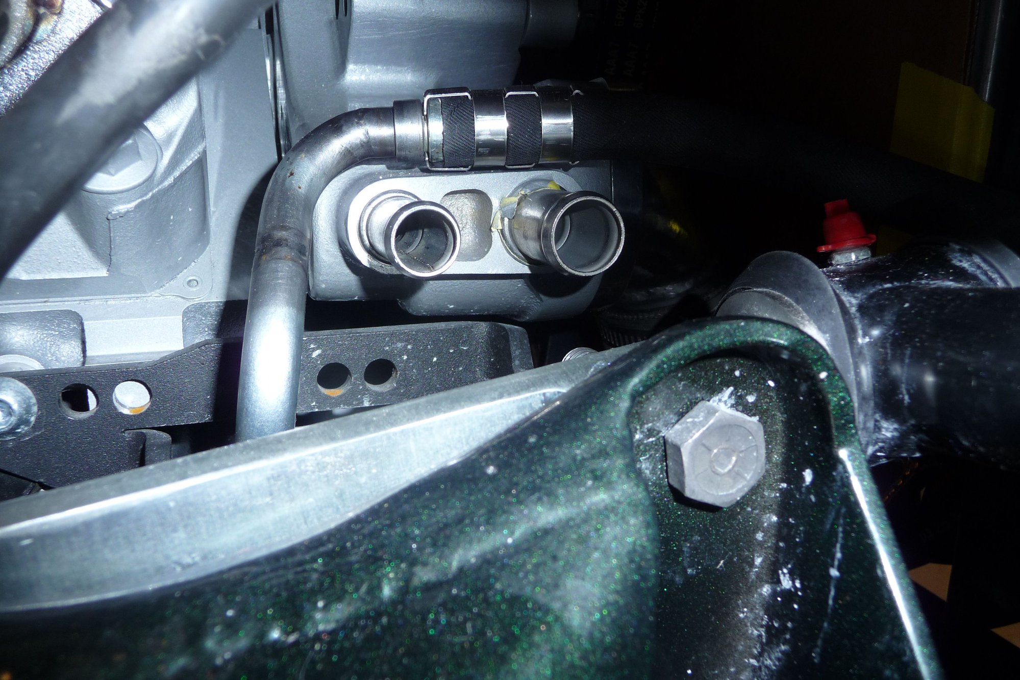

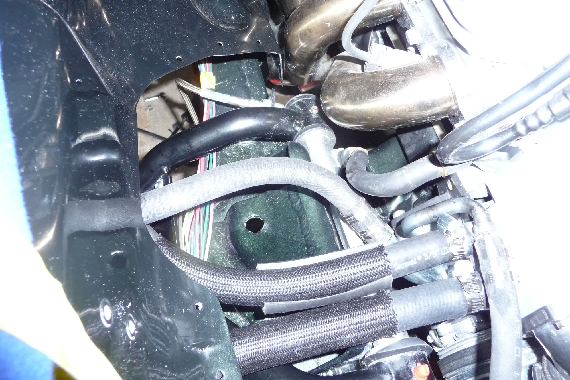

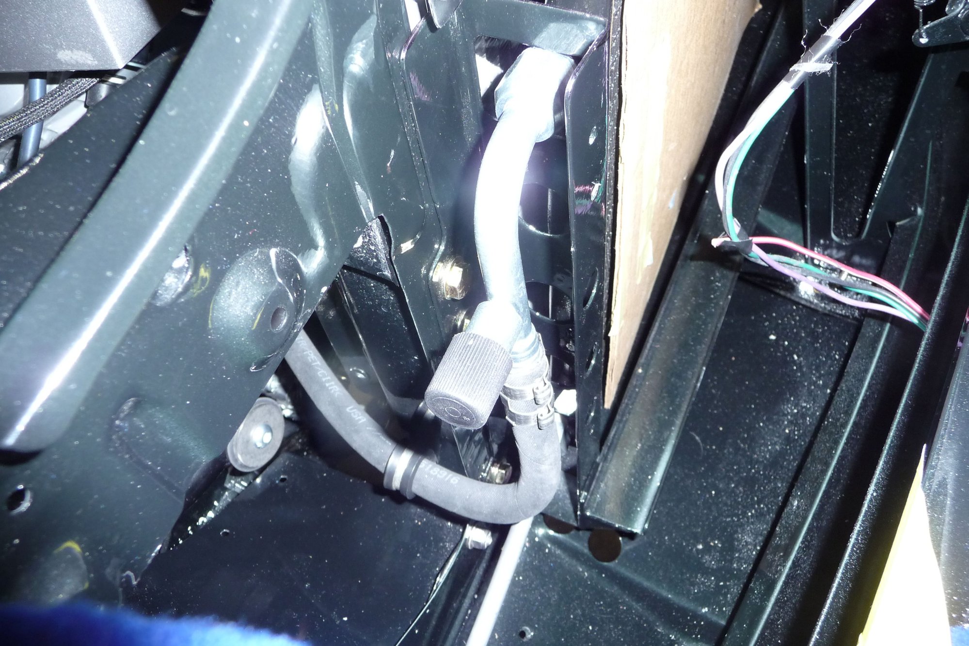

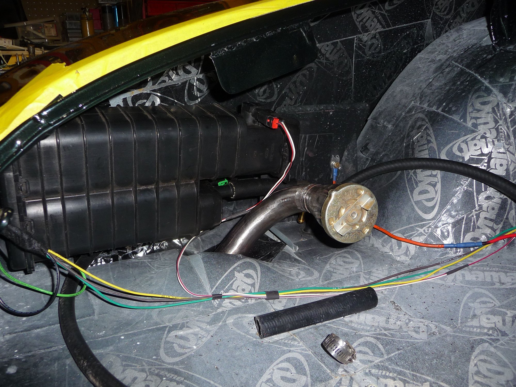

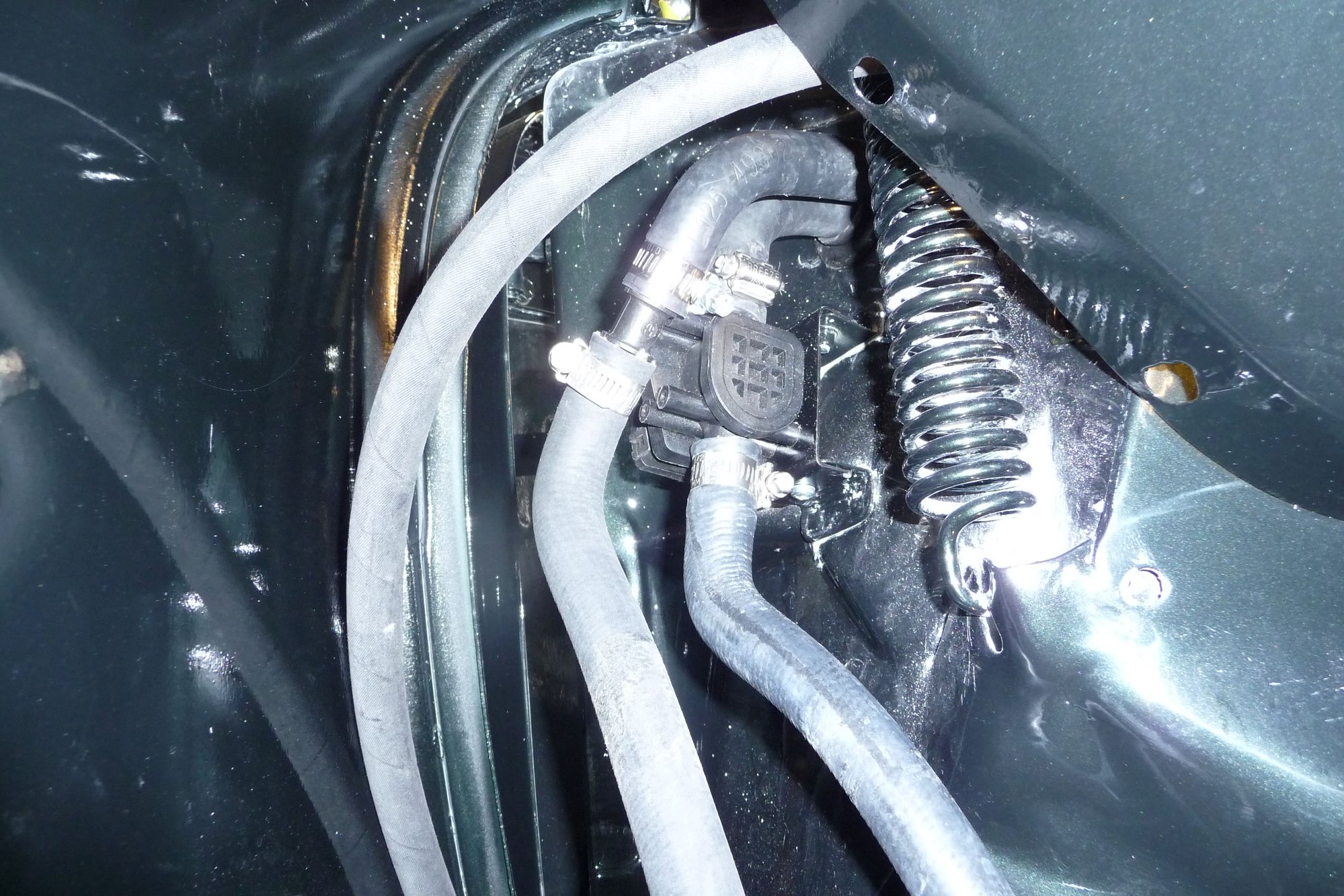

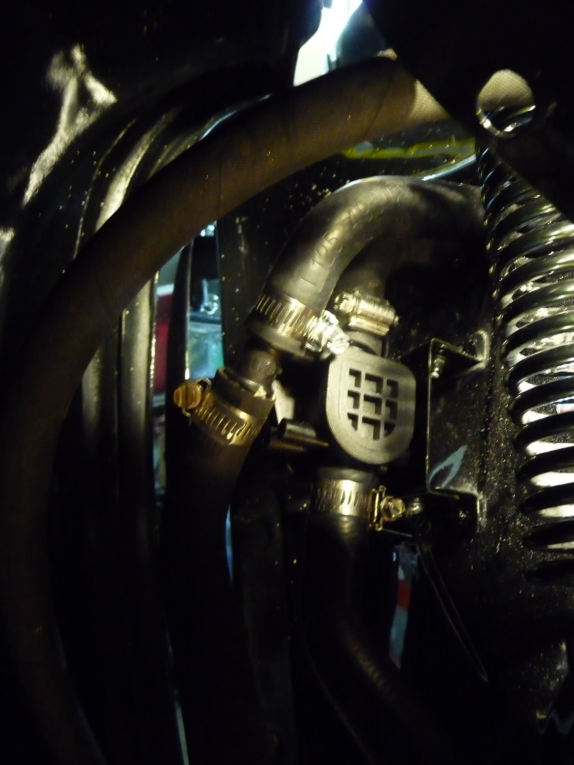

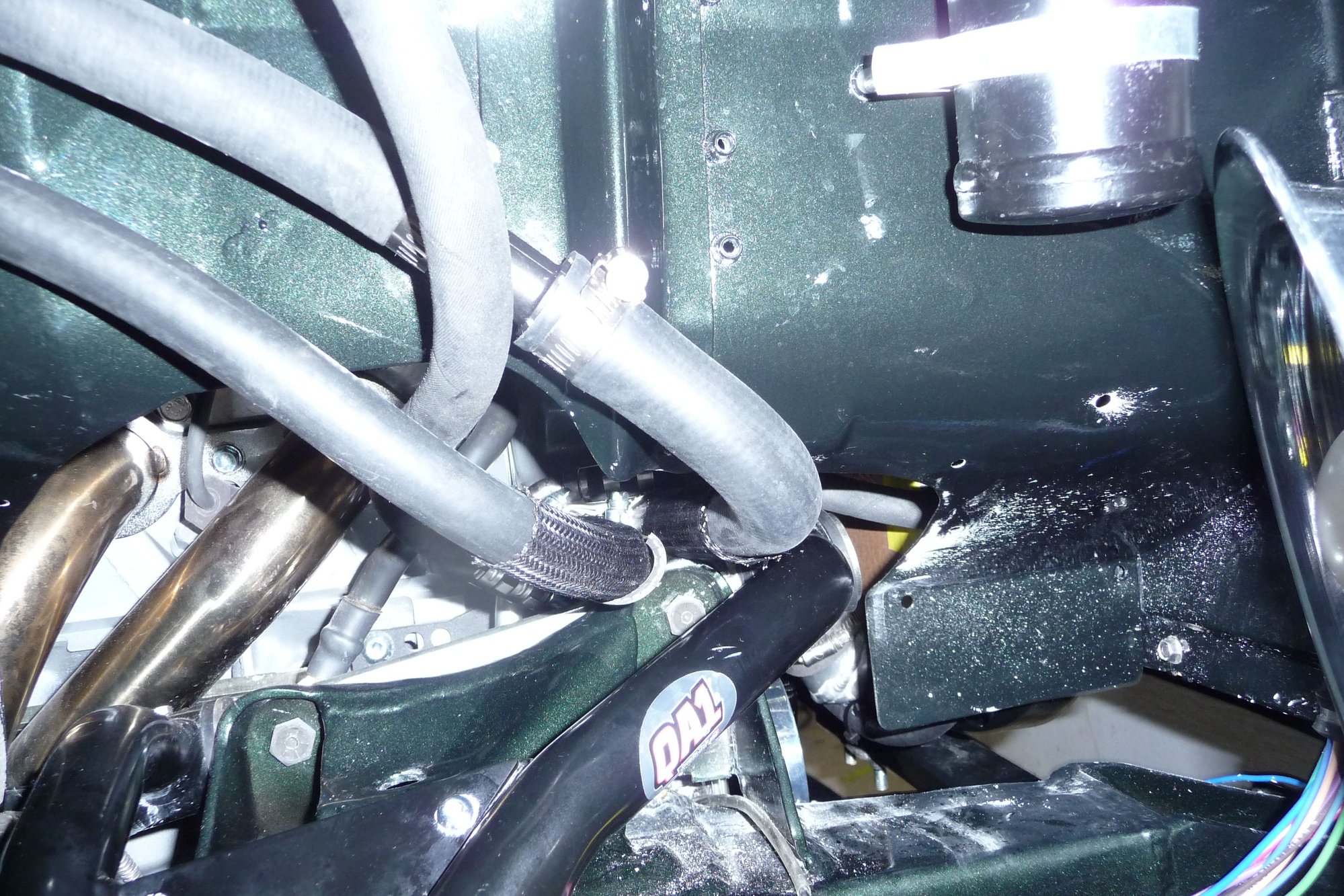

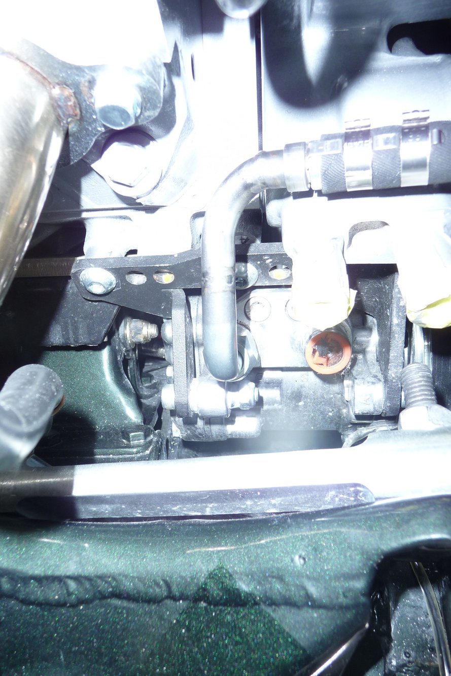

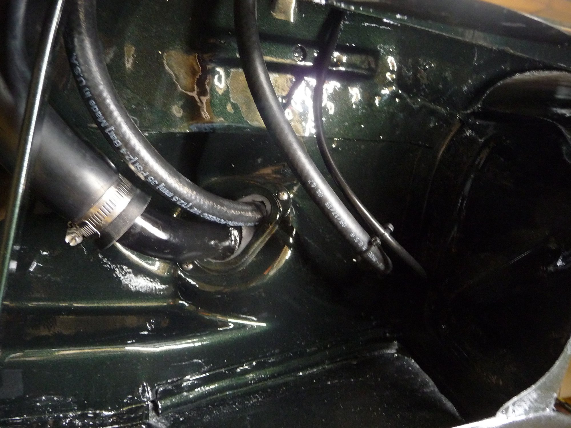

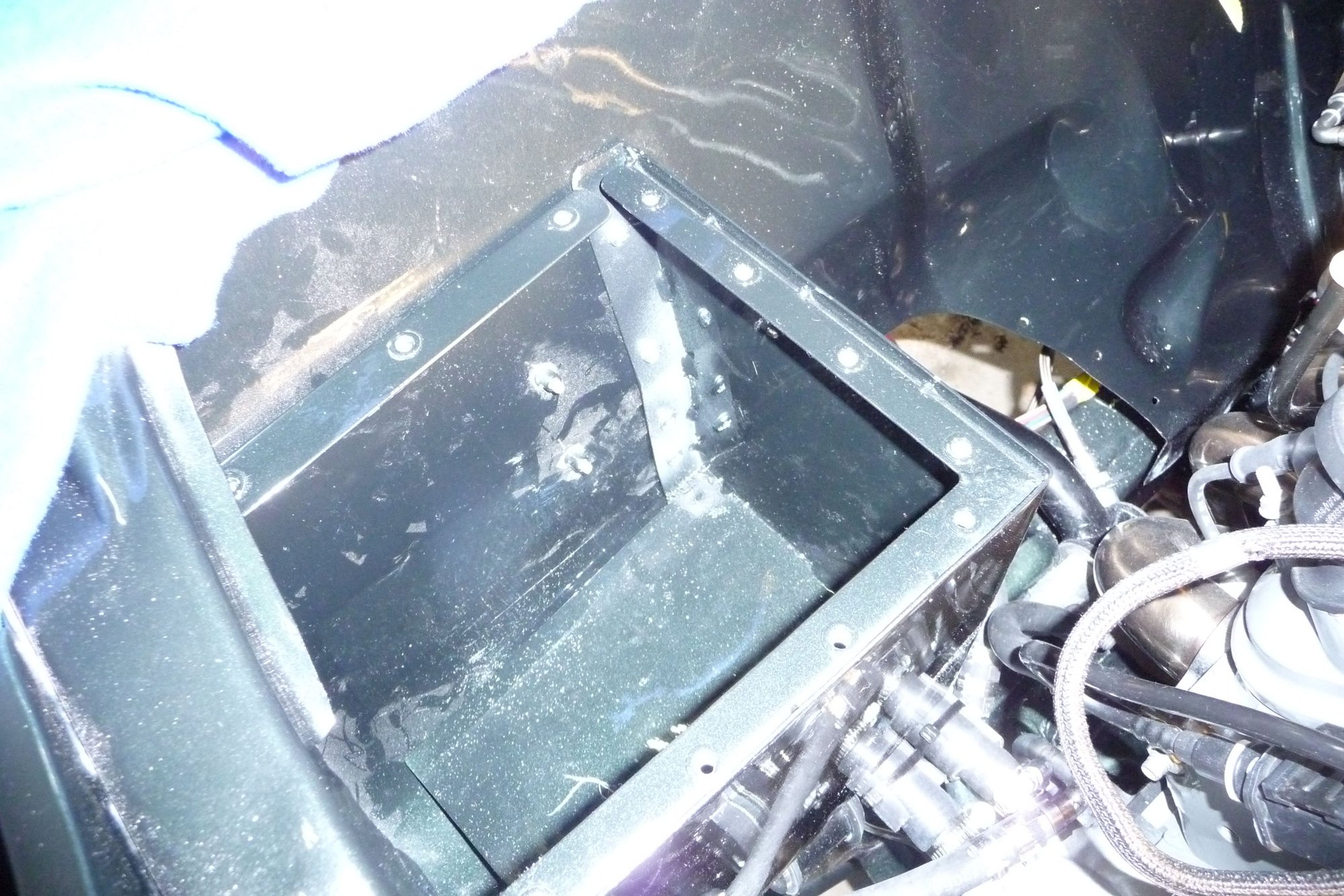

A few more pix--- installing A/C lines and heater hoses, this is one hell of a tight fit.

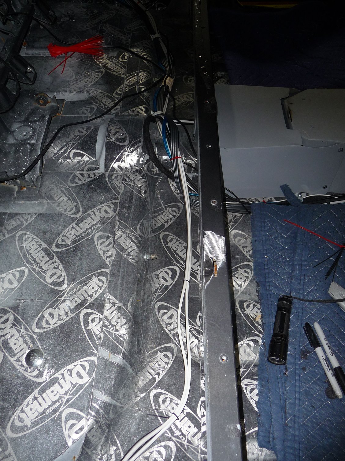

Lots of wire in this project.
Fake A/C vent rear side.
Ft of the vent.

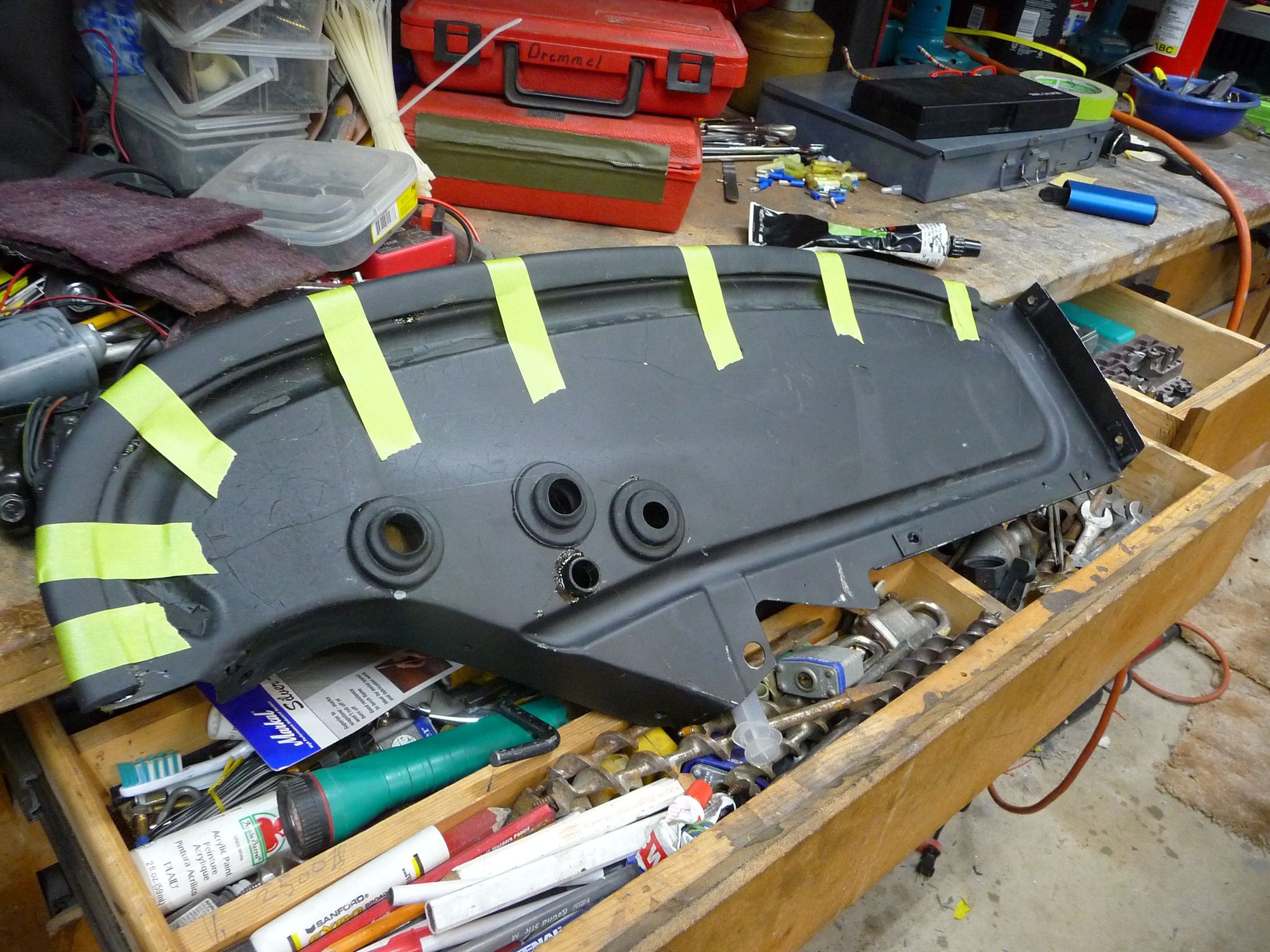

Inner fender panel with grommets for lines.
Heater control valve.

A few more pix of A/C heater hoses hooked up. might need to cut away some of the inner wheel to get a little more clearence for the hoses.

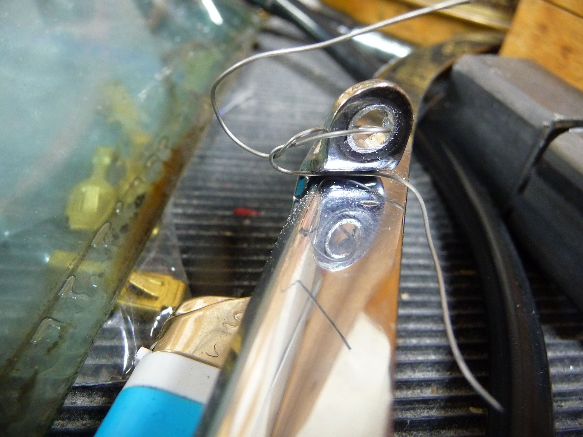

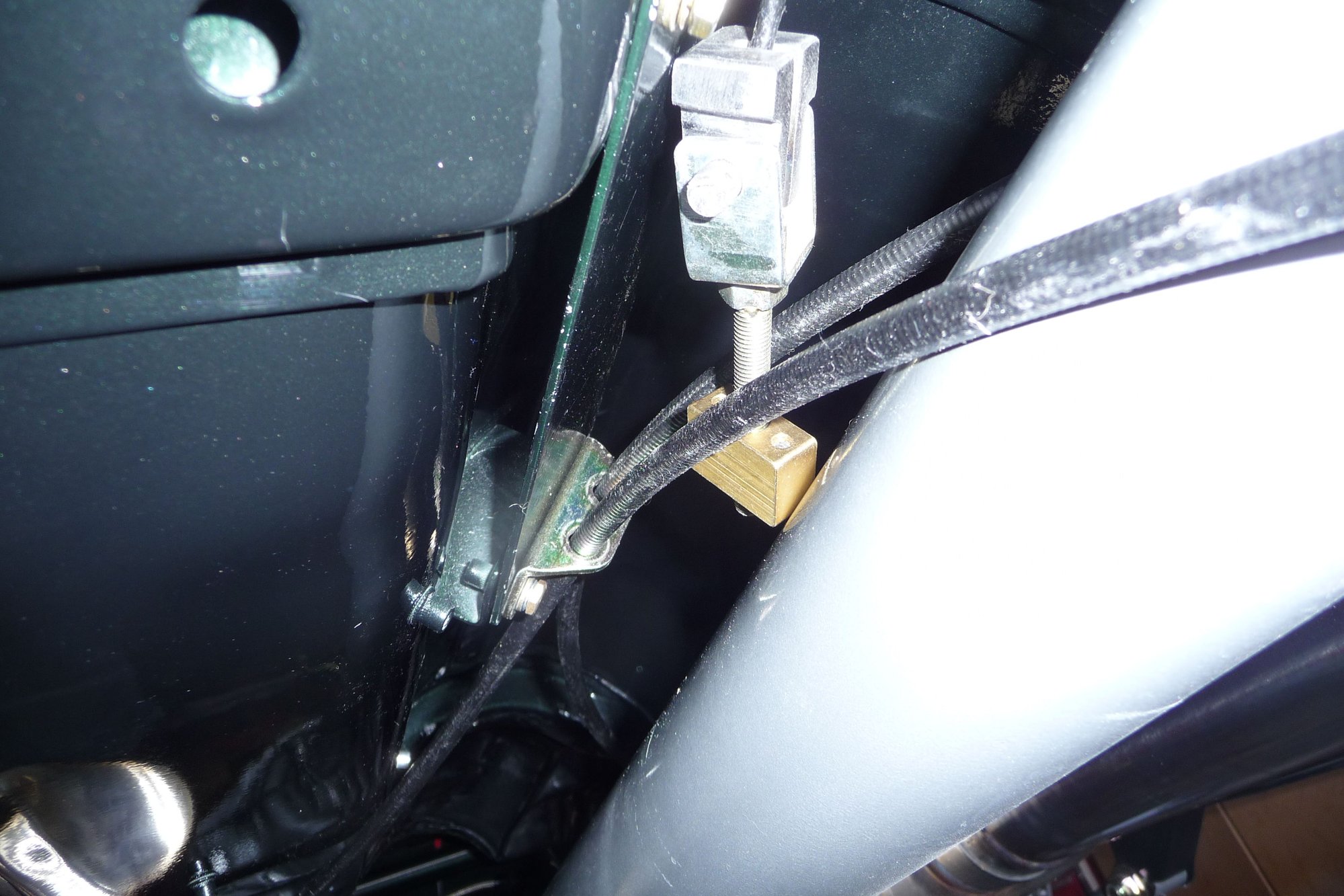

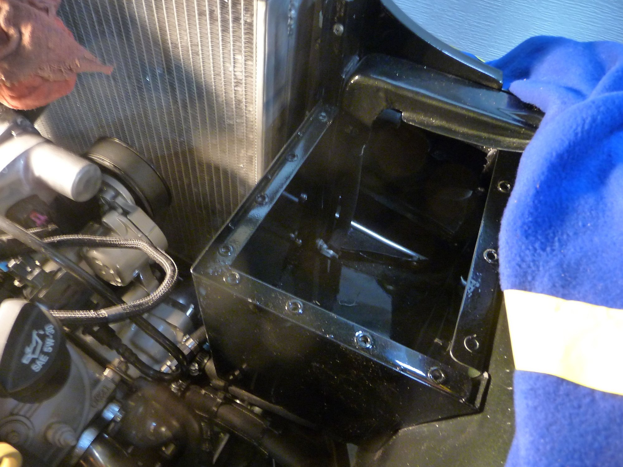

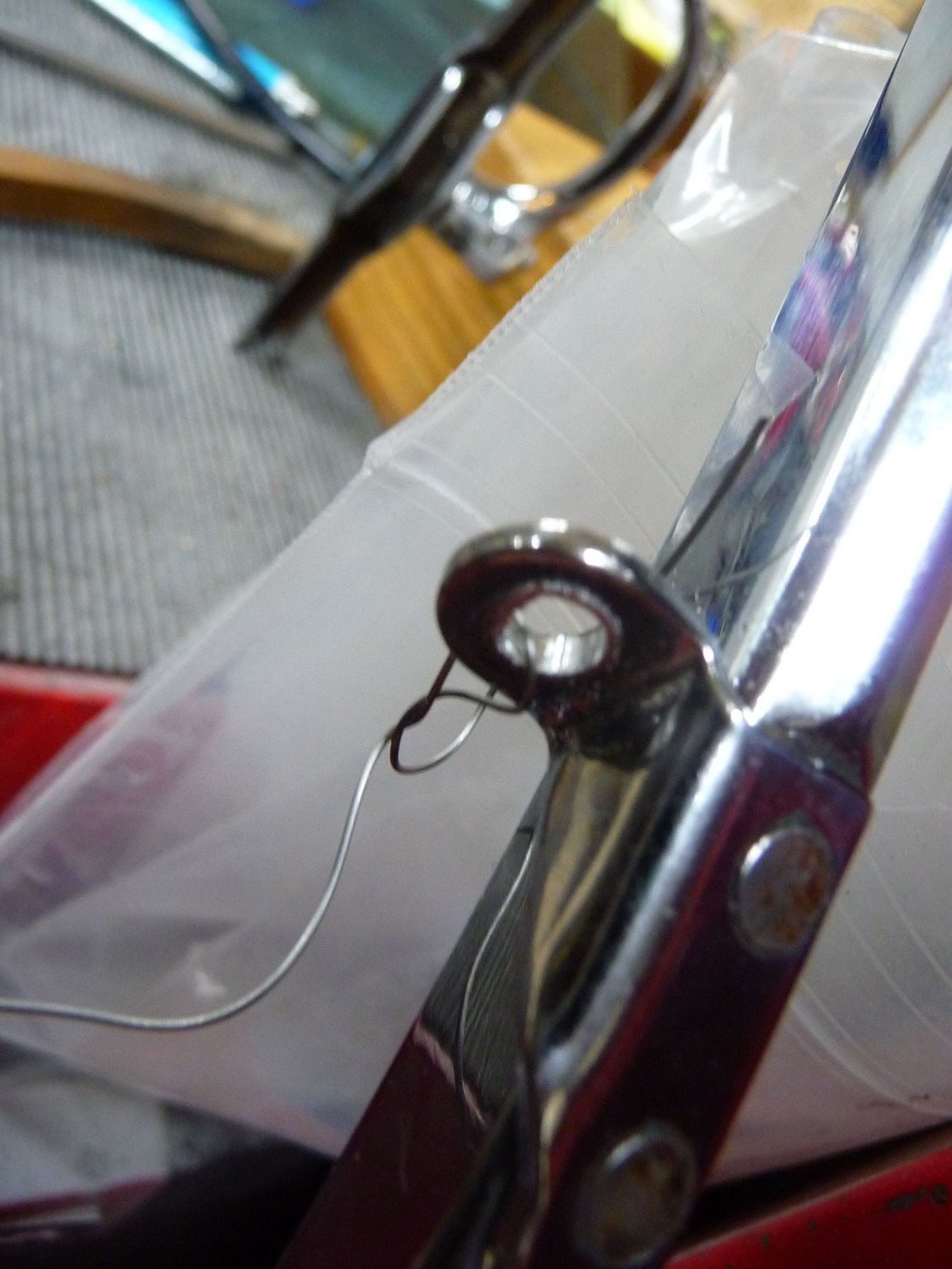

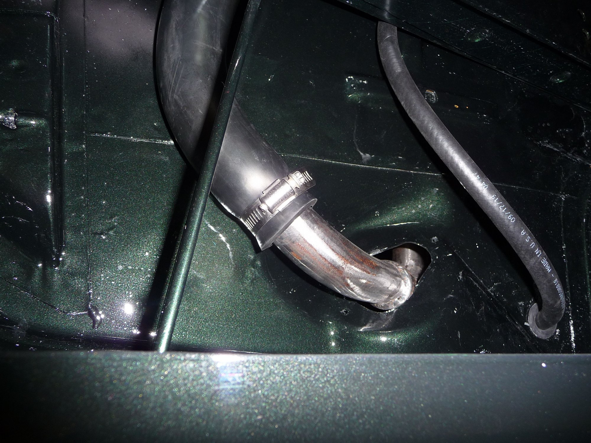

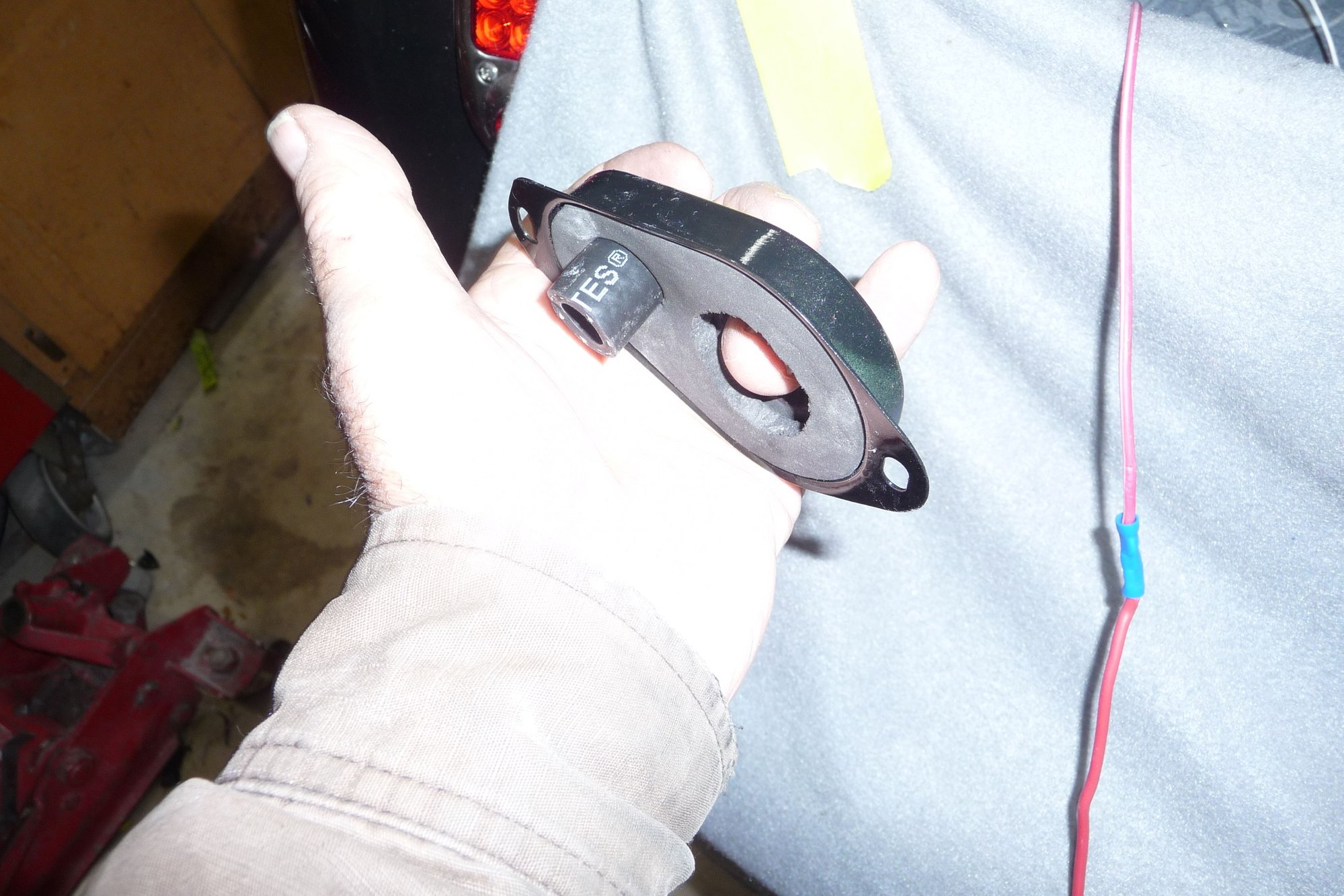

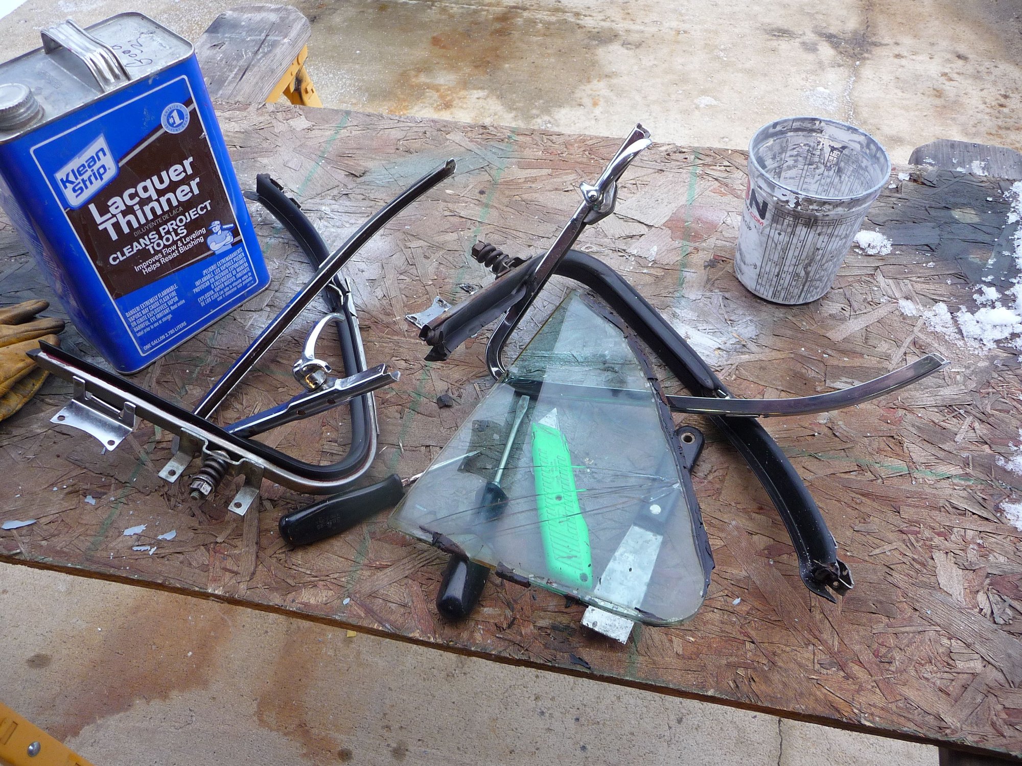

Evap system is in-new steel vent rubber-- fabbed some micro bushings for window pivet .
Pcv connect to valve cover
Bushing
steel vent rubber

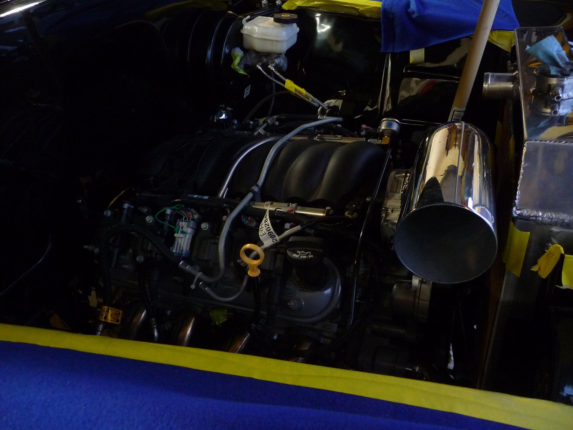

A few more pix of the ride.

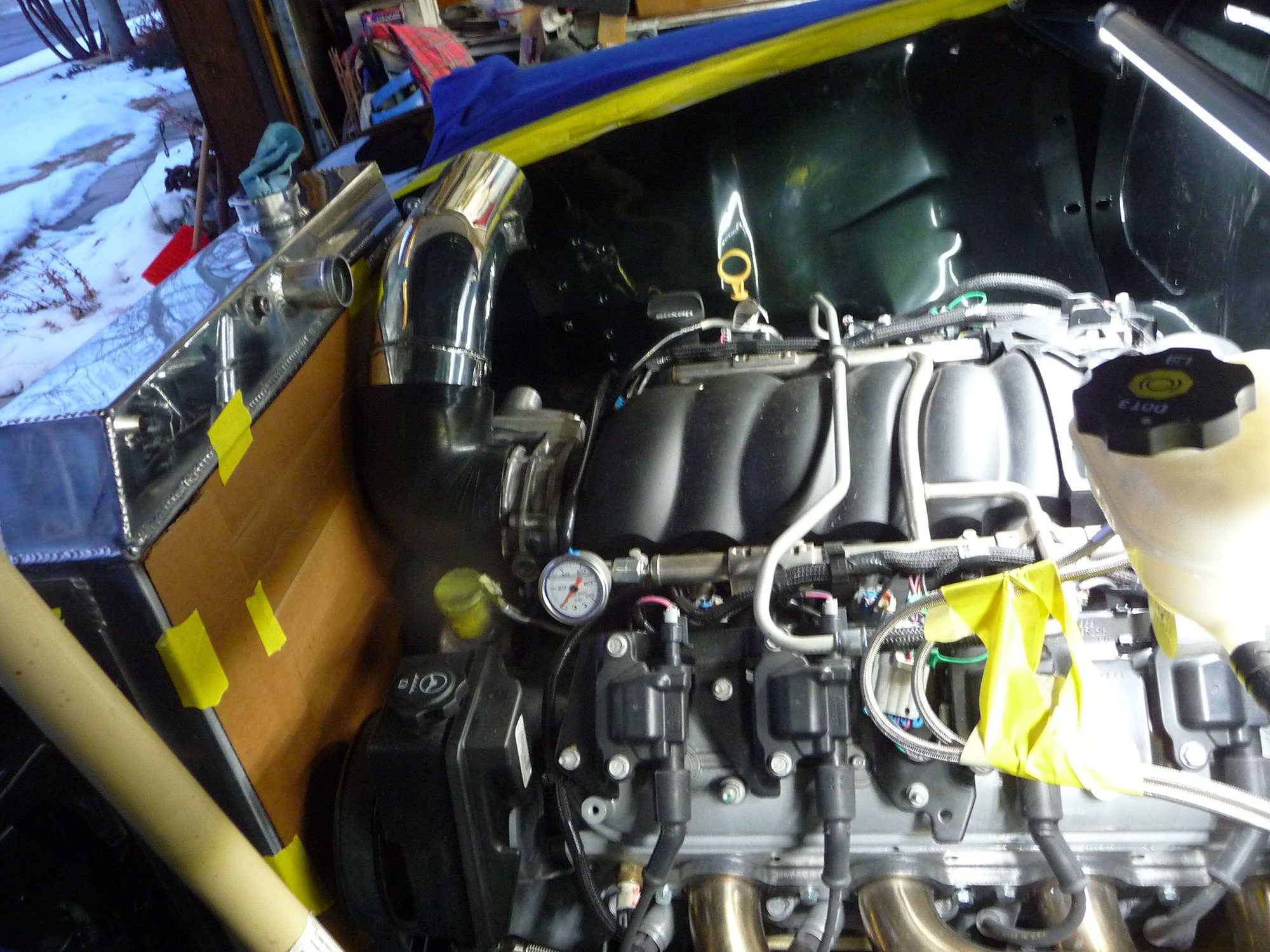

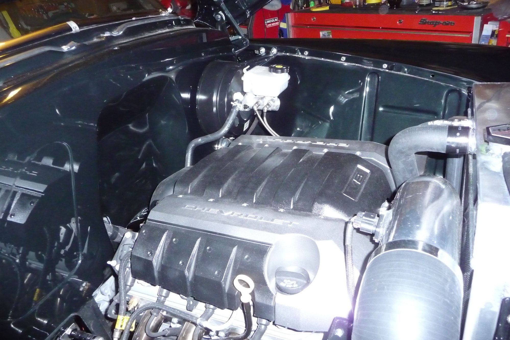

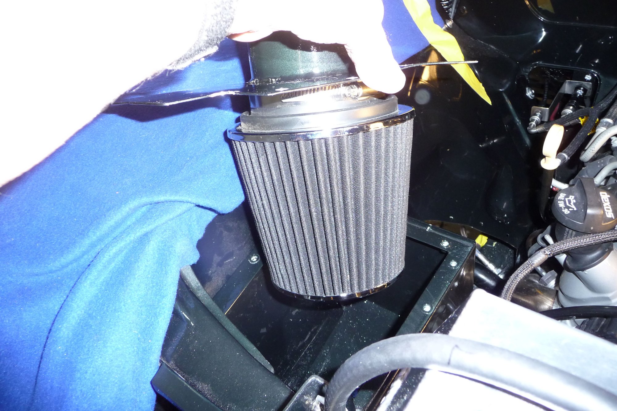

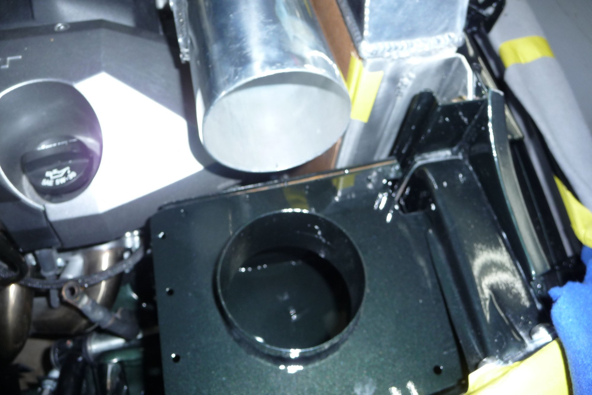

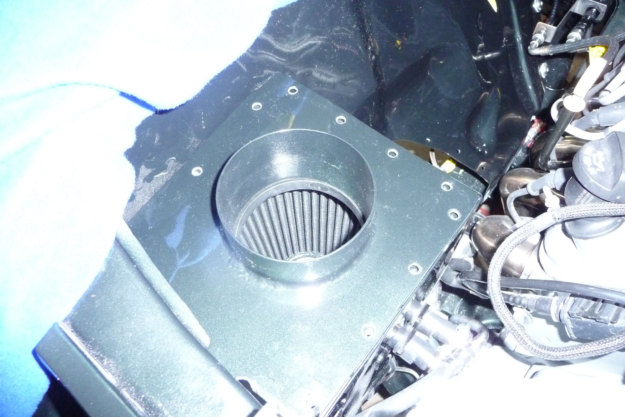

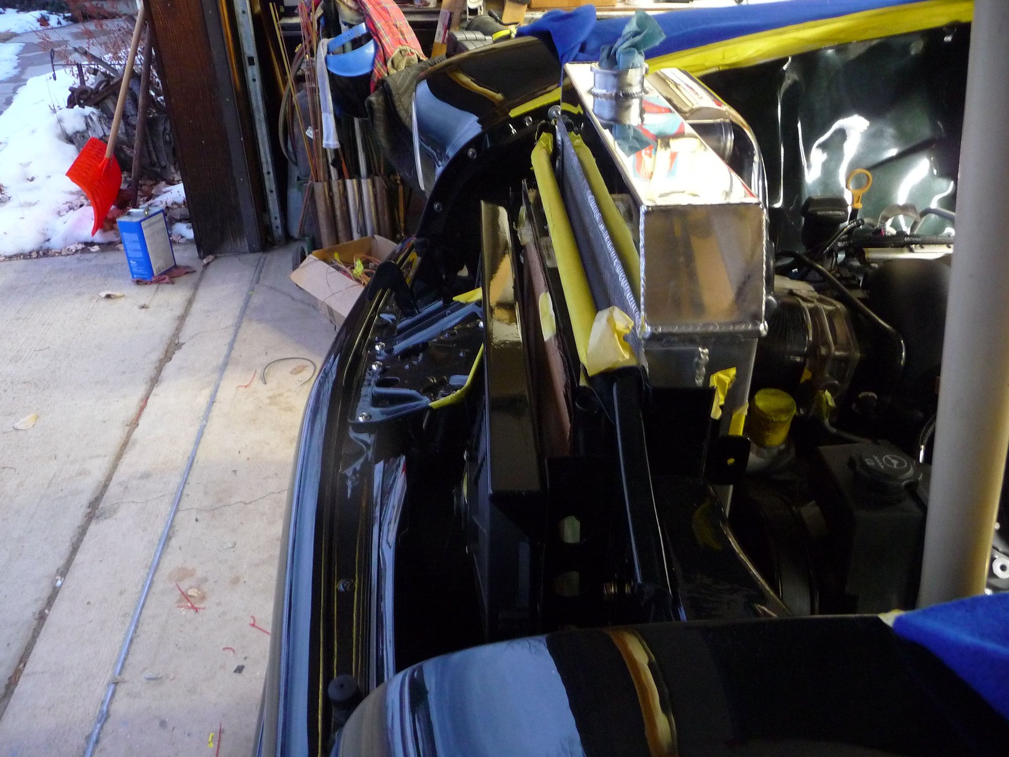

cold air intake
Cold air intake

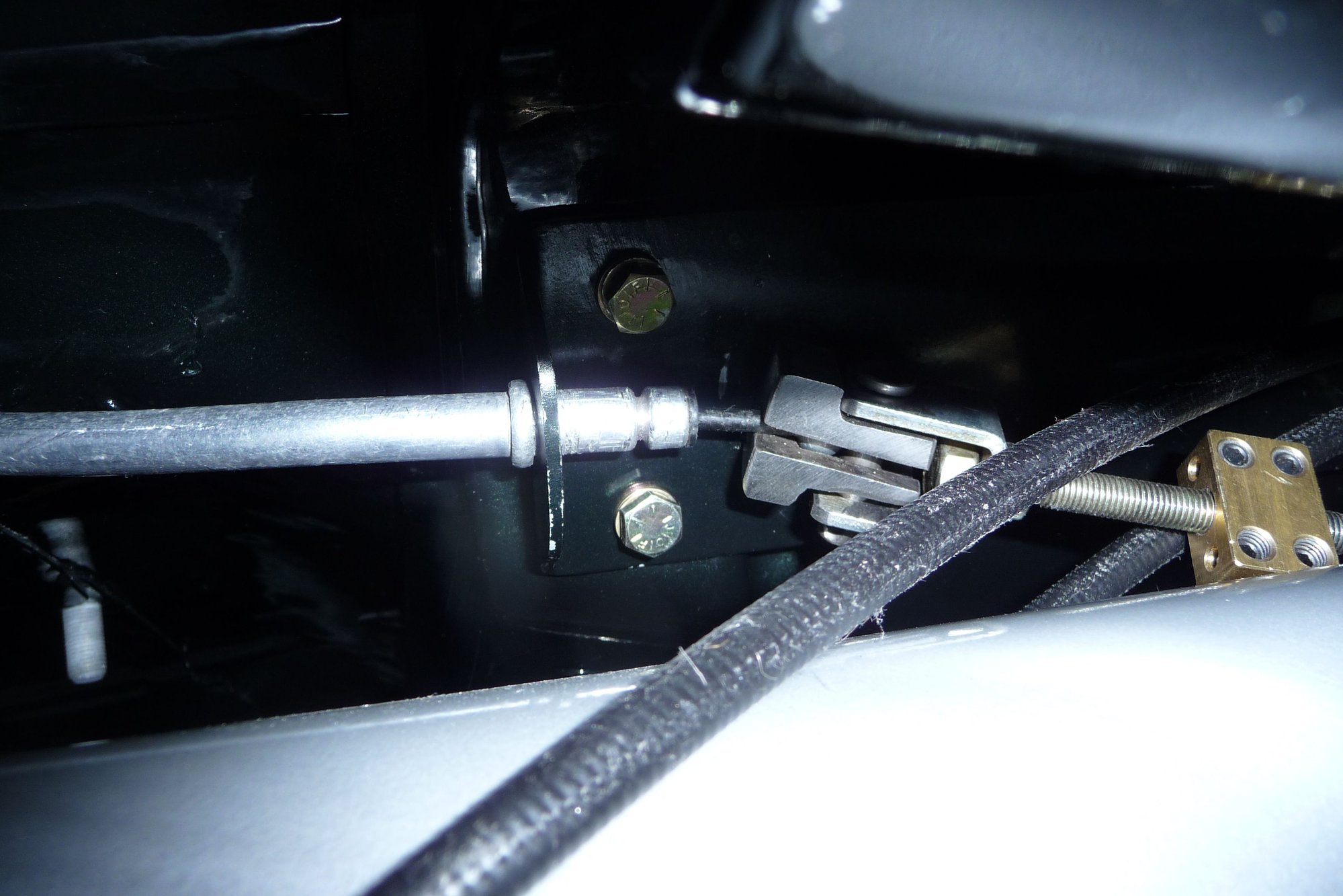

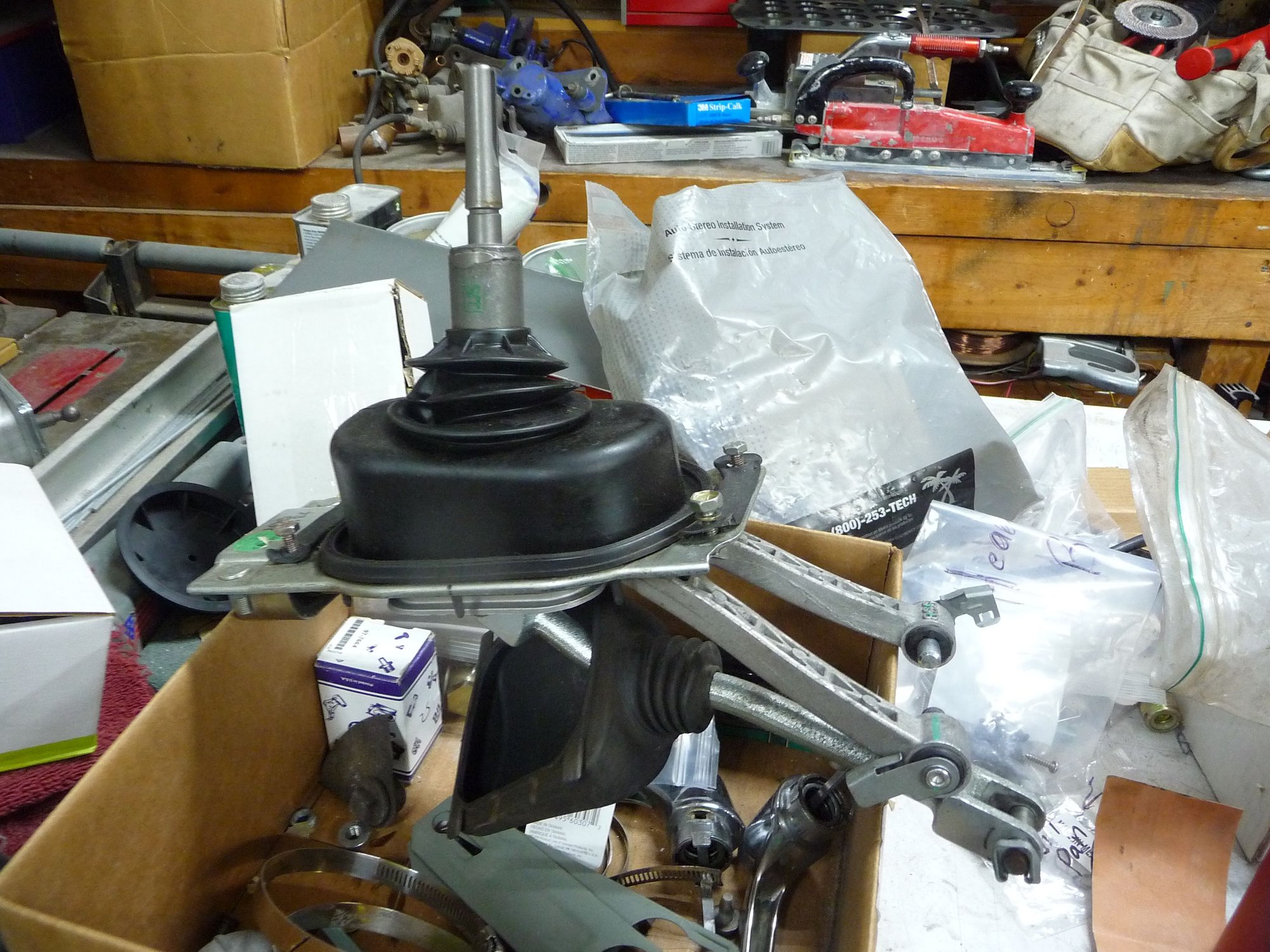

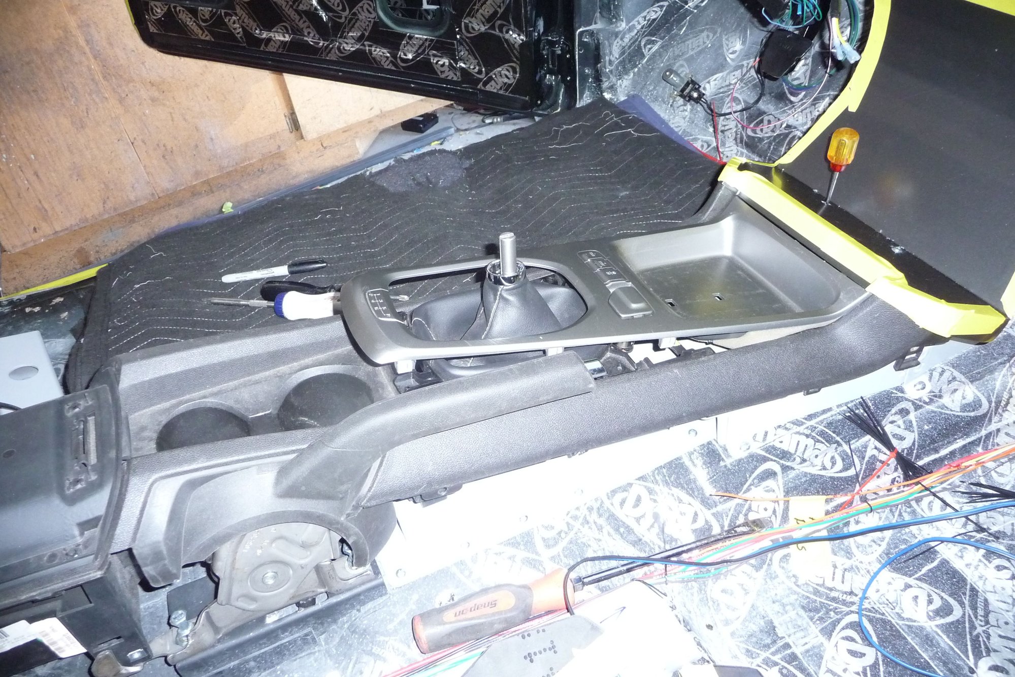

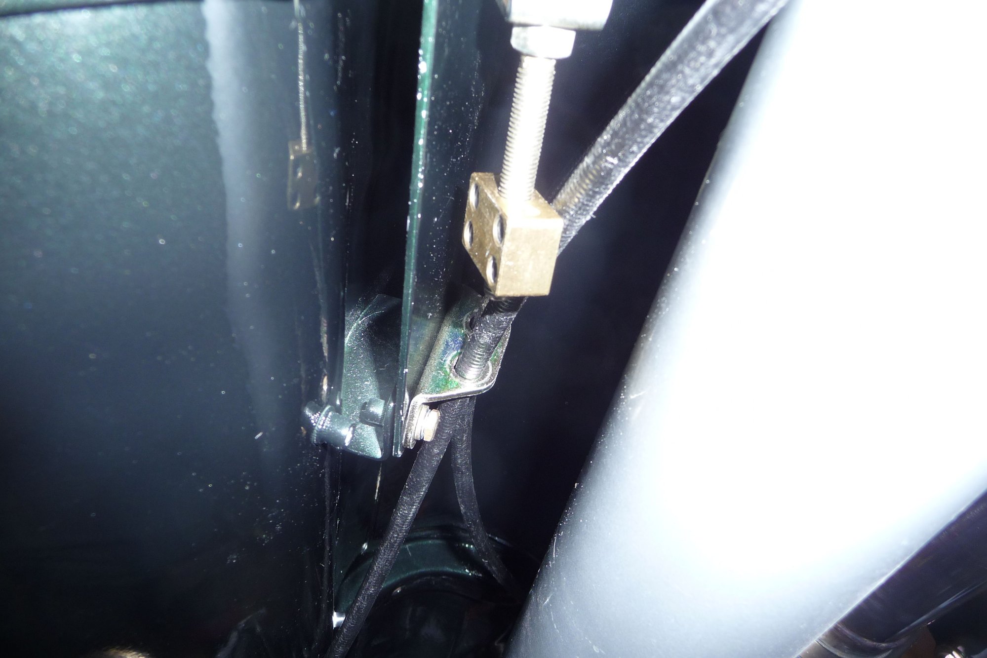

E brake handle

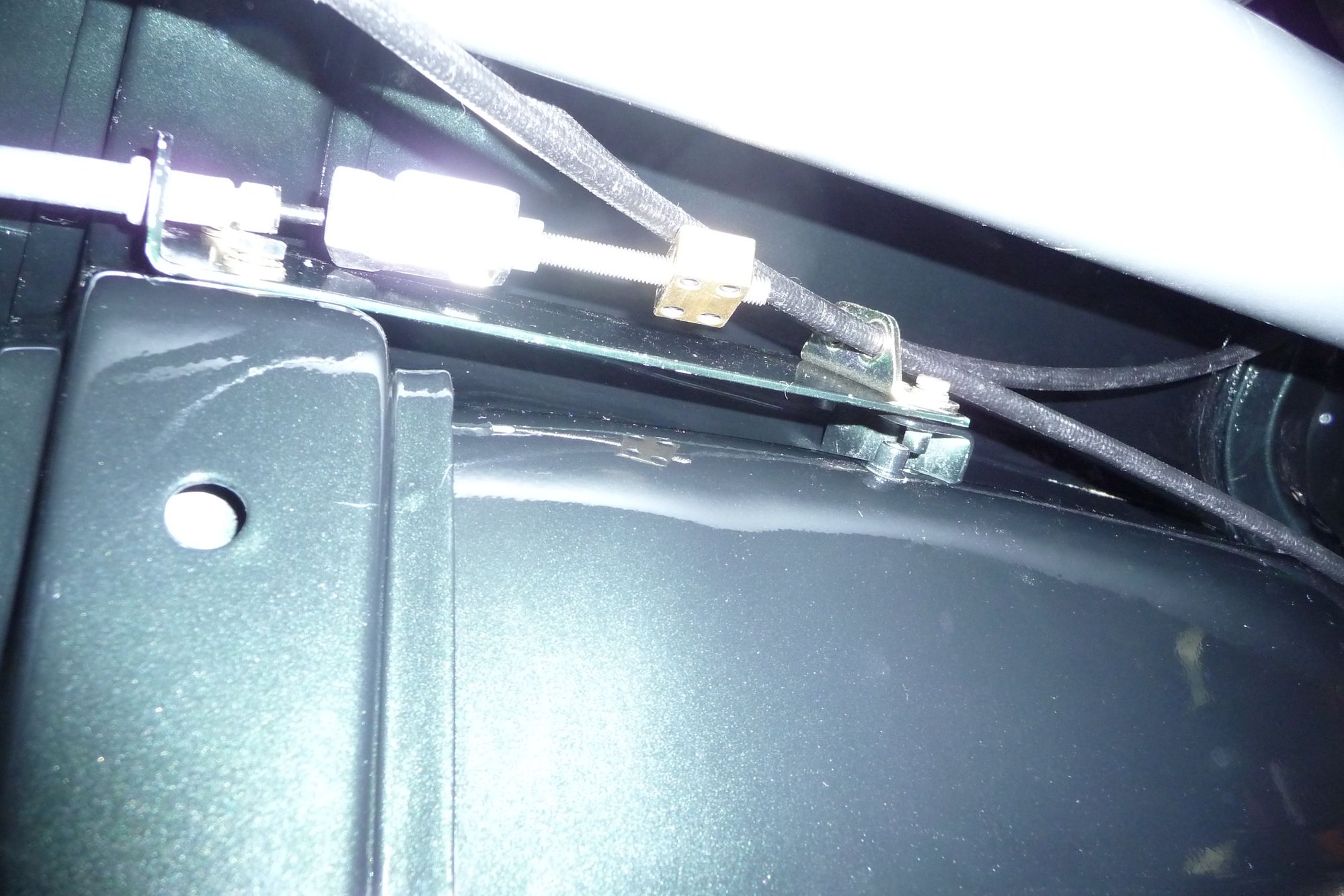

E brake linkage

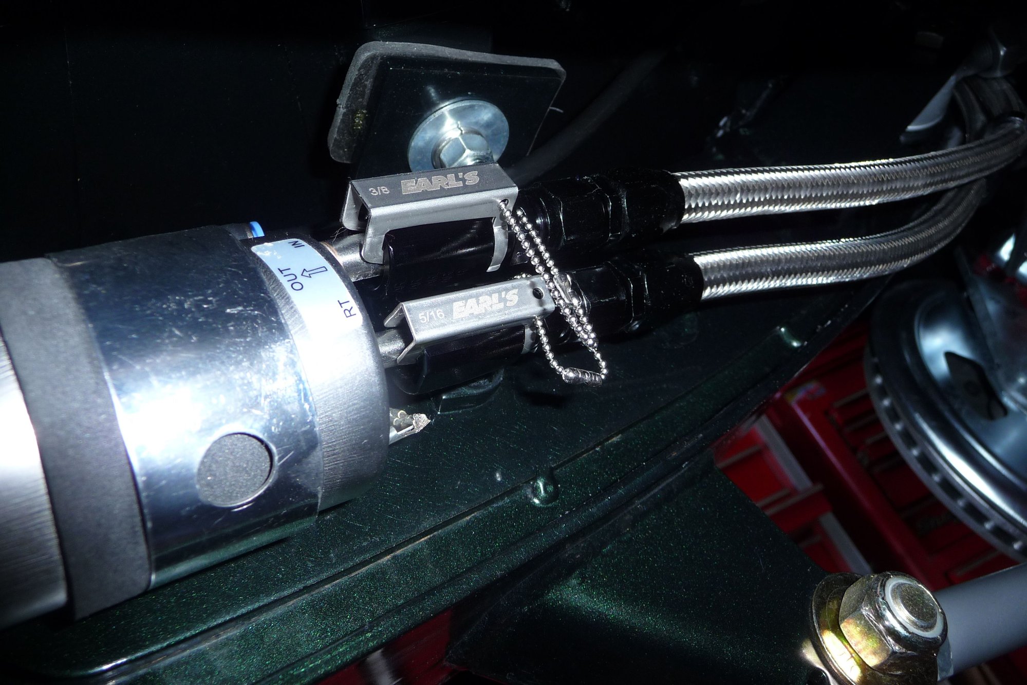

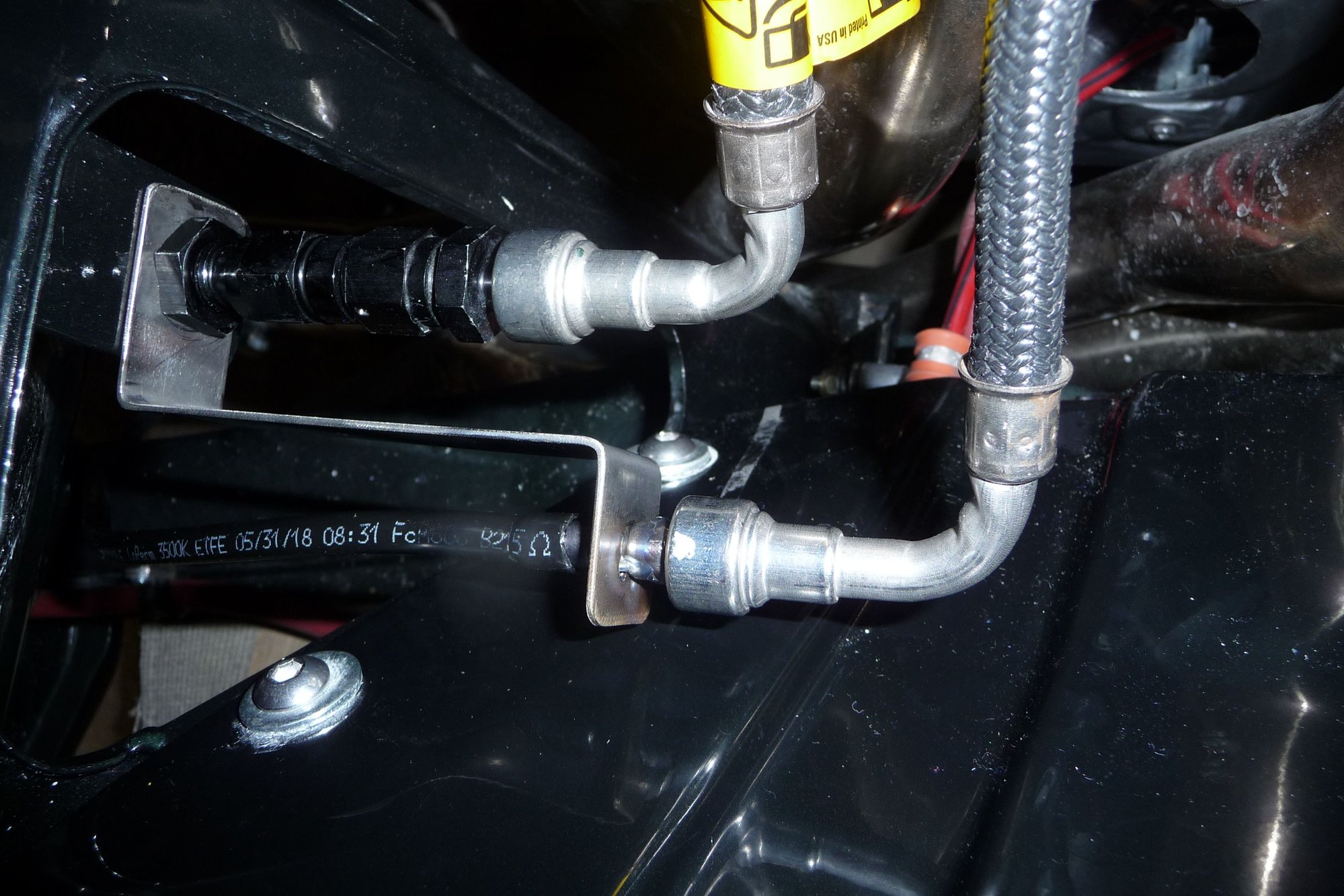

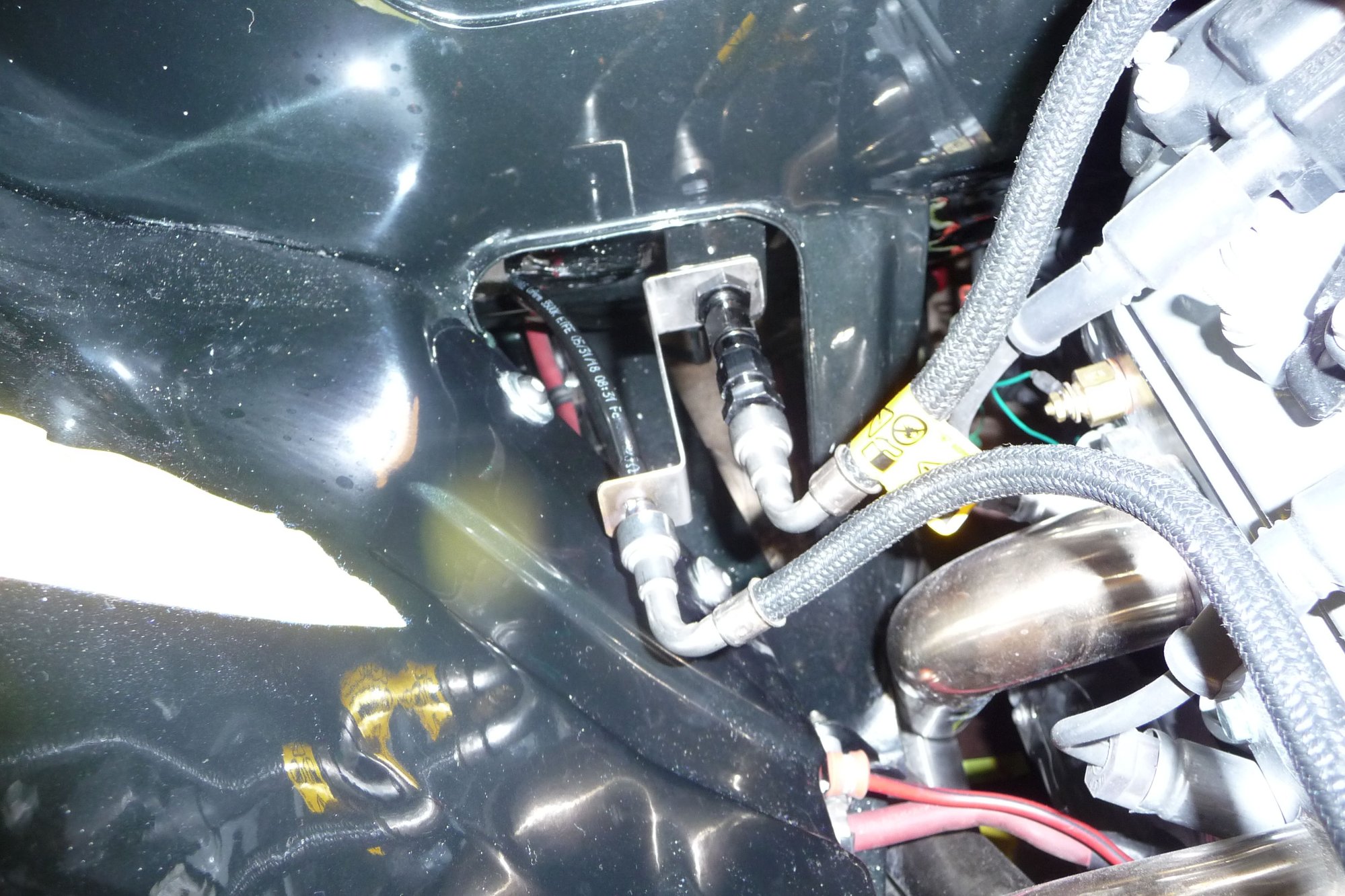

New fuel line seccured
Council coming together

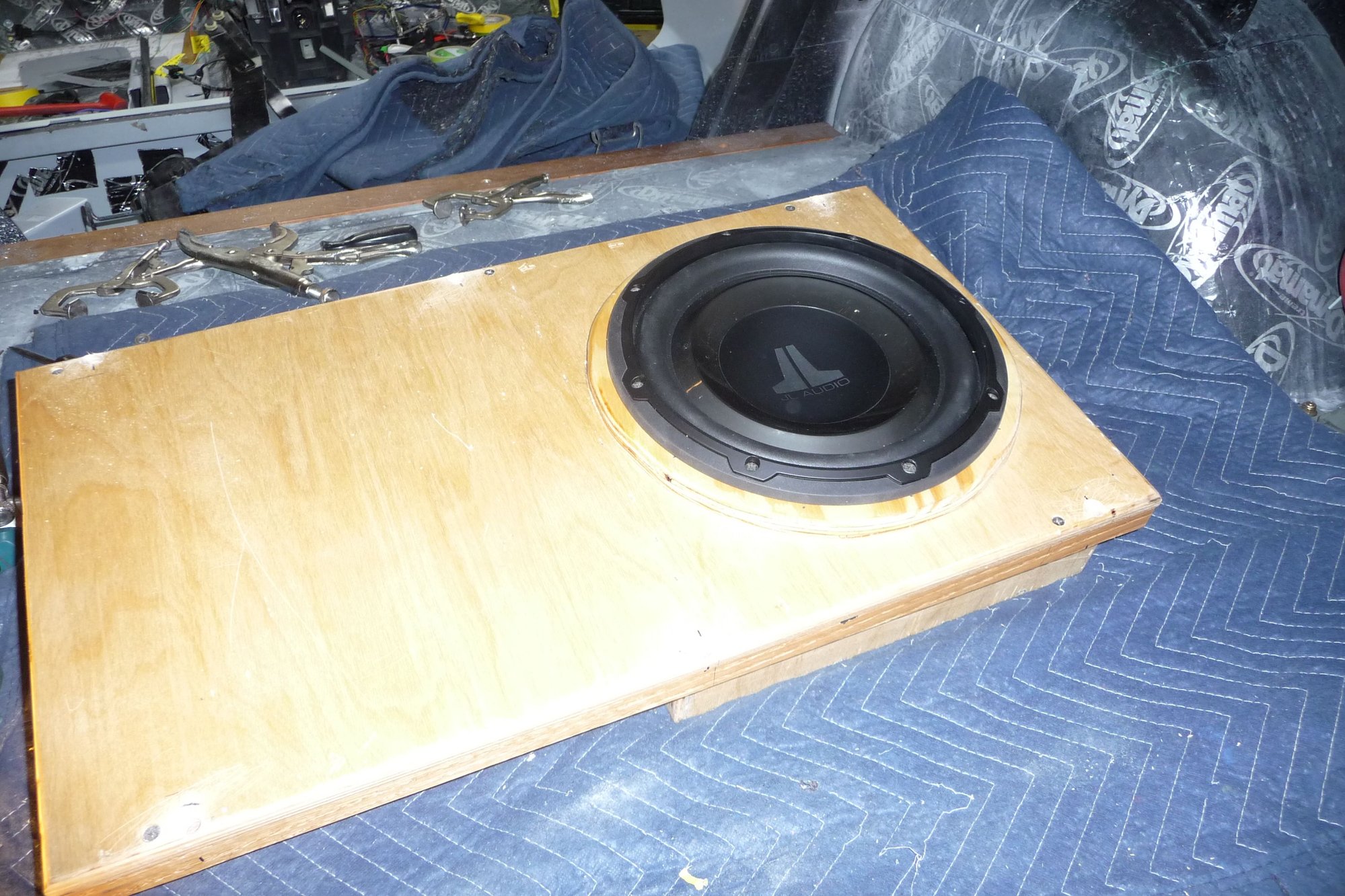

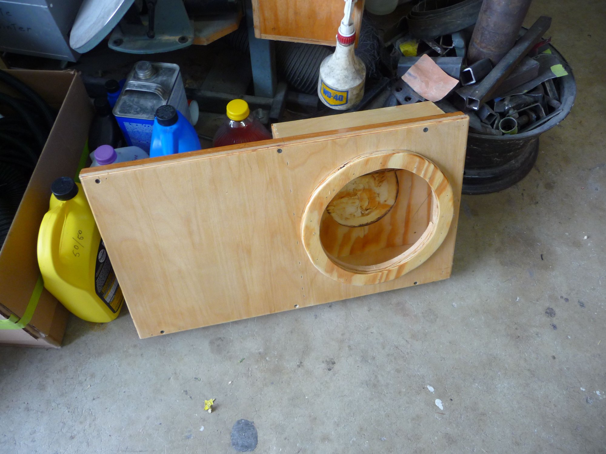

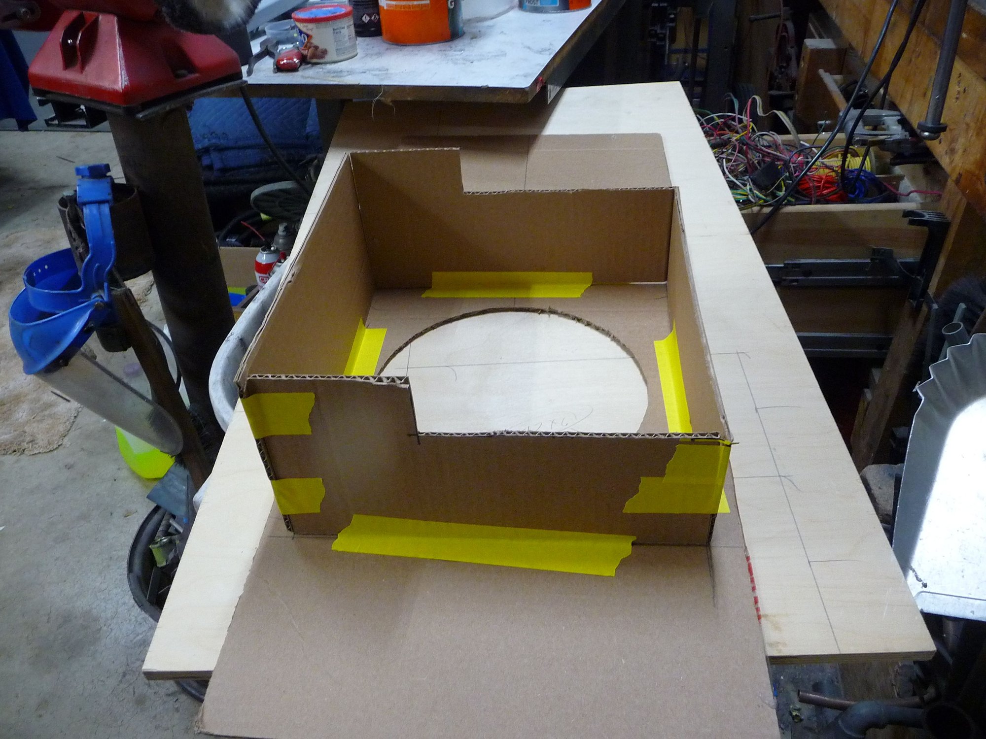

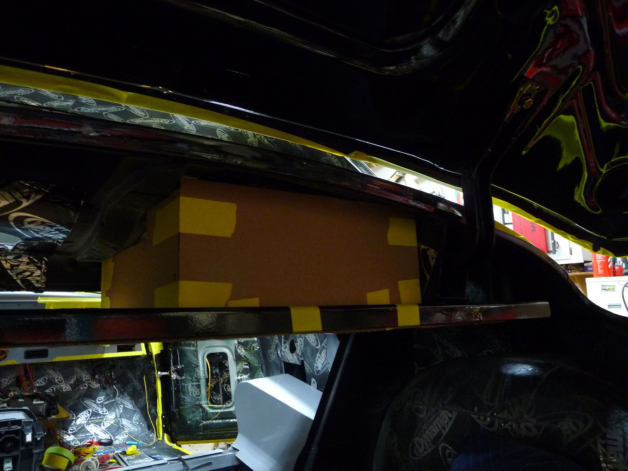

A

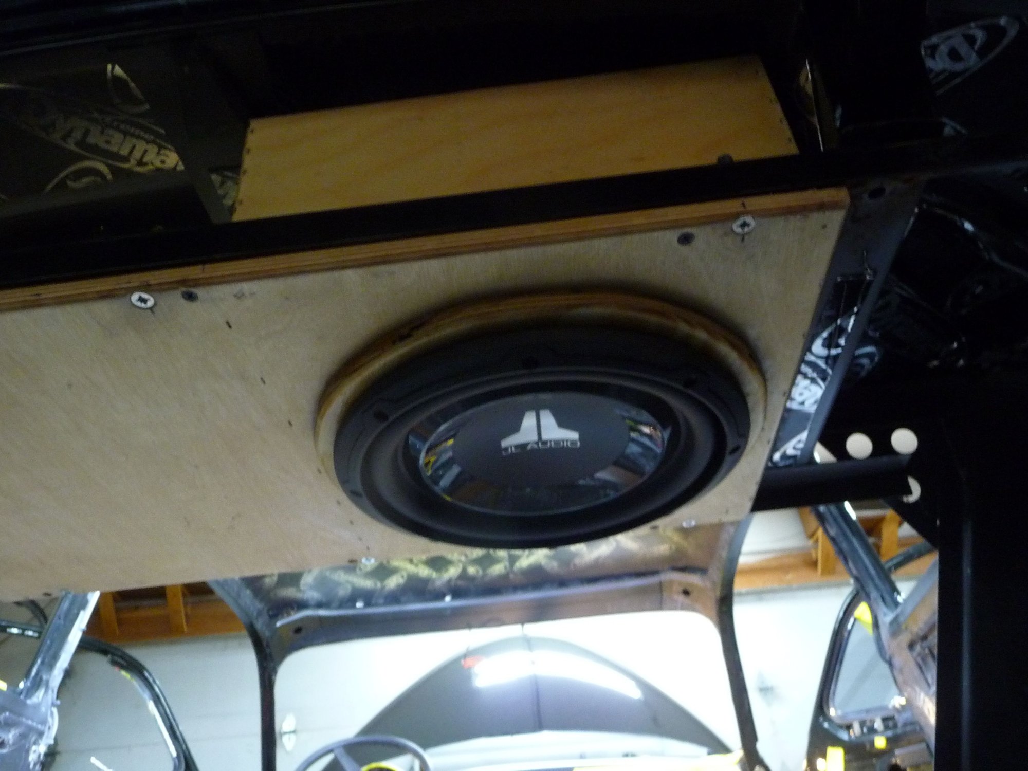

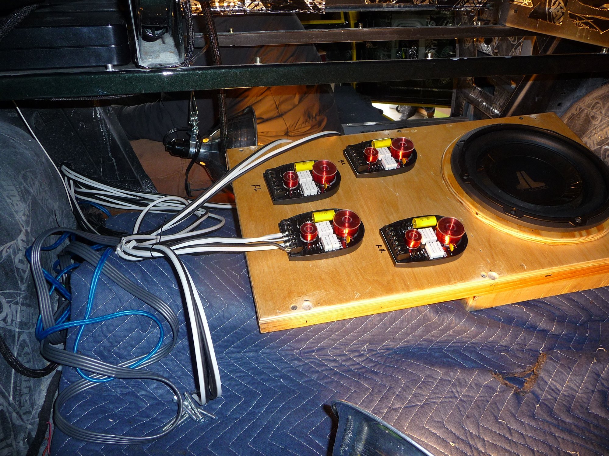

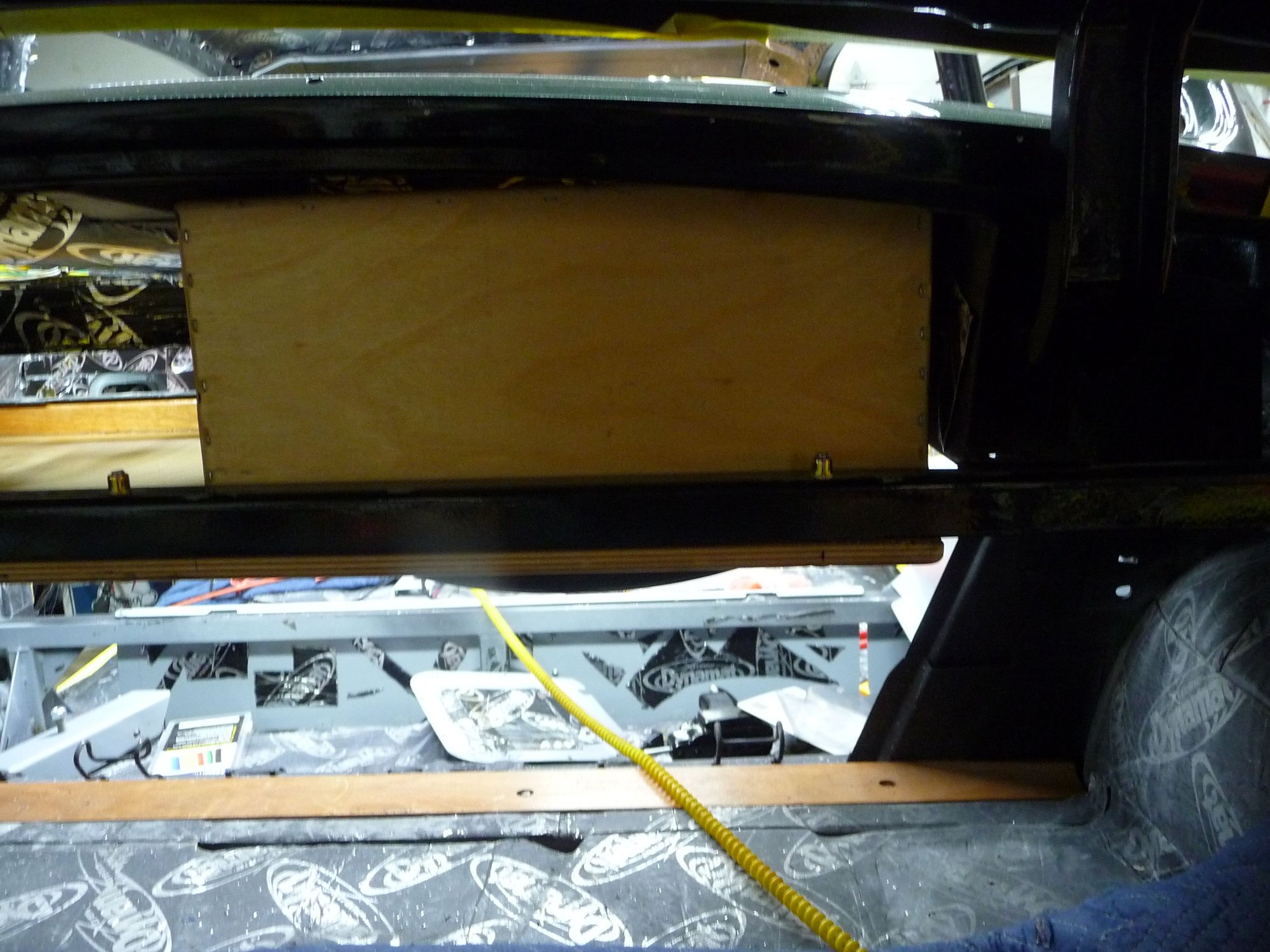

Cardboard mockup for sub woffer box
woffer instaled
few pix of the progress

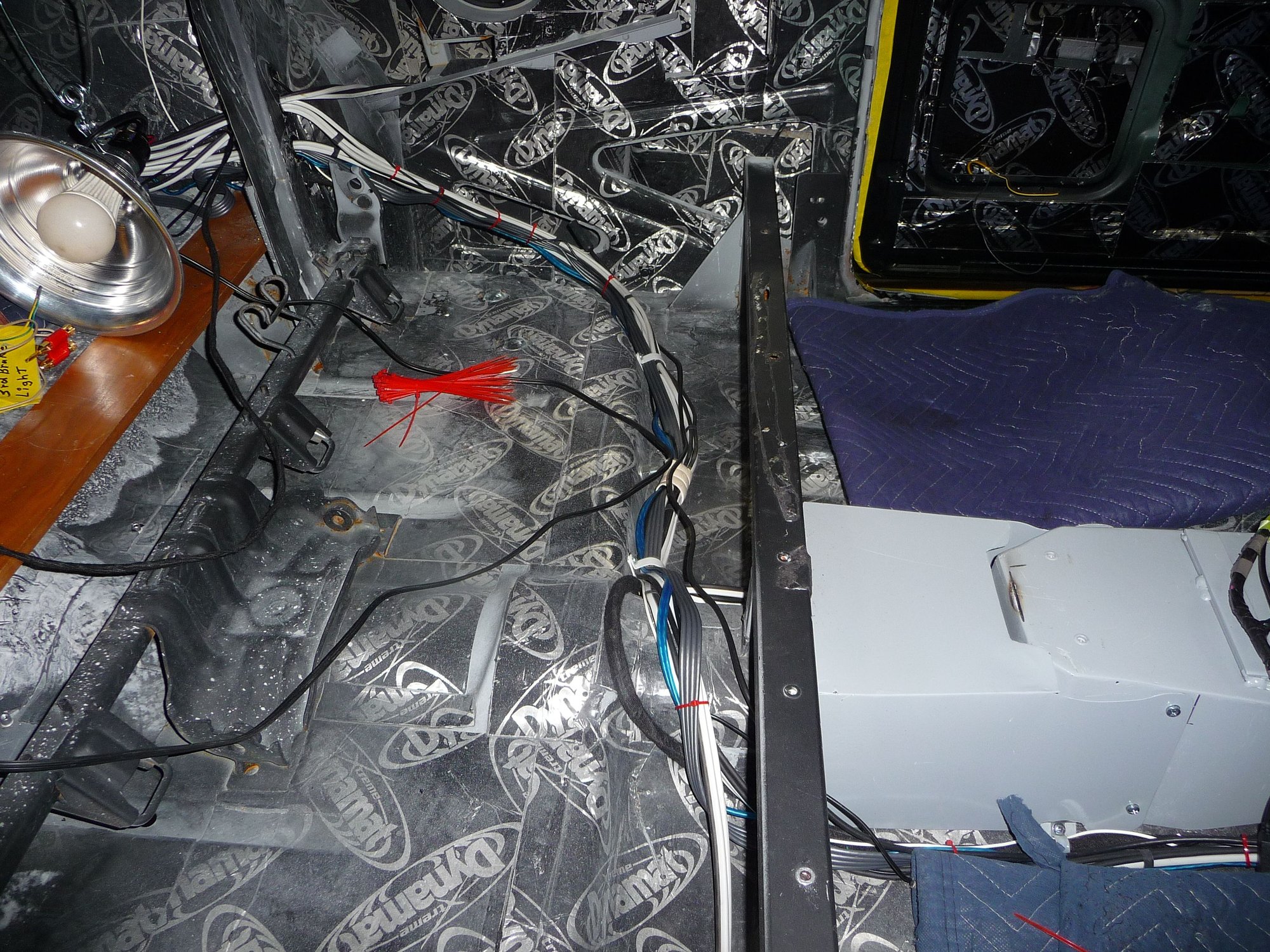

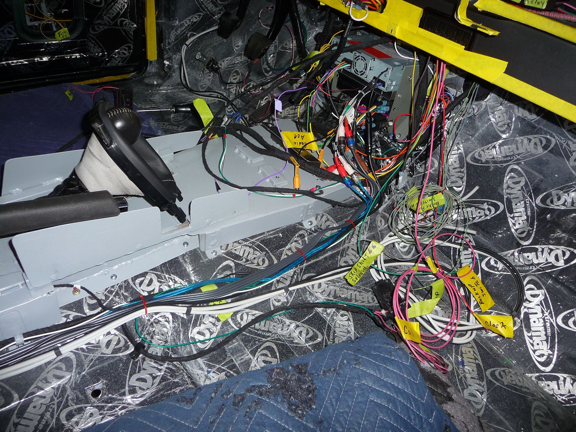

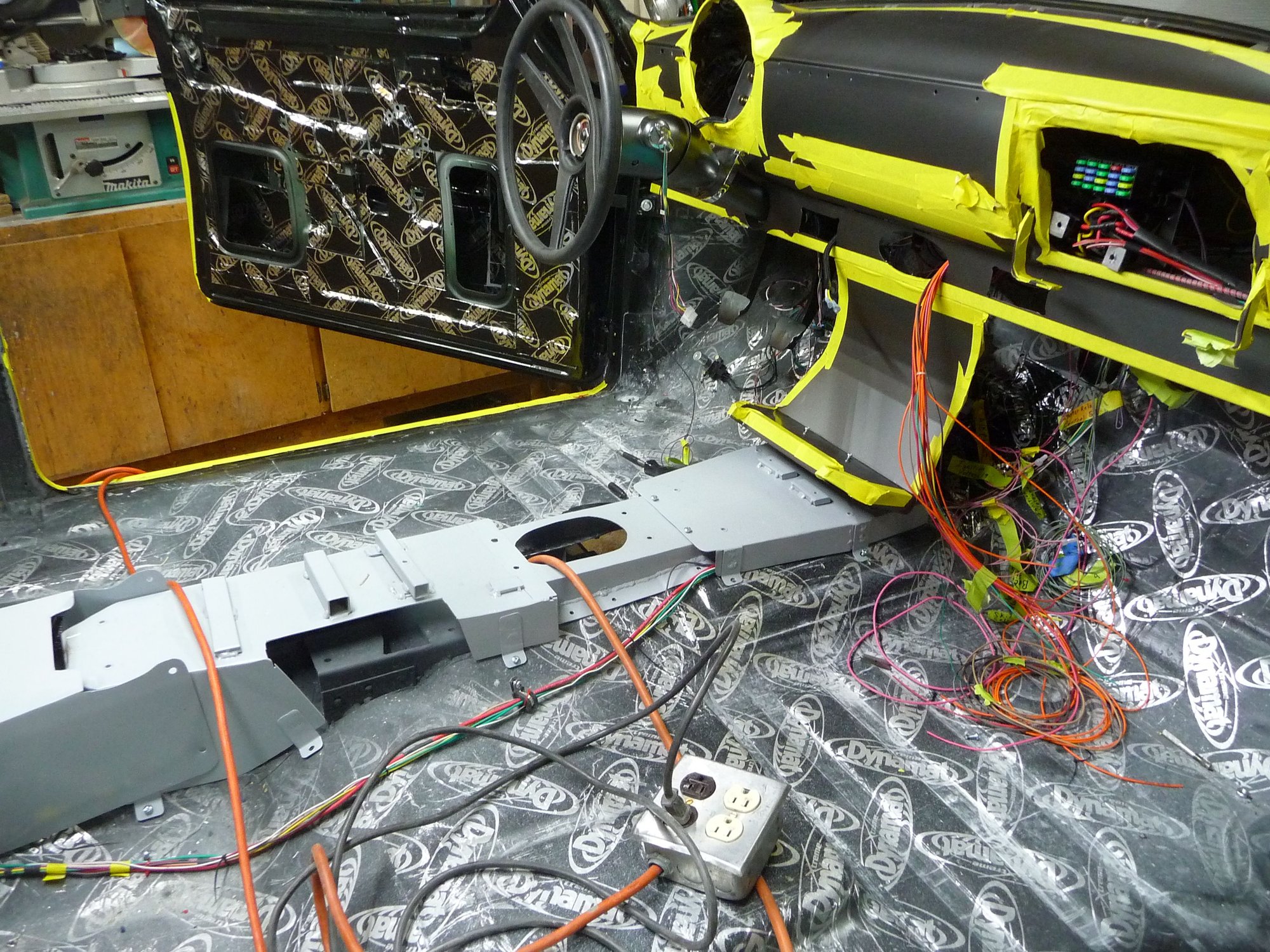

Thanks a bunch but I have 2== for some reason. This is close to be compeatly wired all the lights work turn signals h/l, flashers, brake lights. power window regulators and switches. next is my double din Pioneer stereo. This build is about to grind to a halt because crona19,there are some things that need person to person contact and Im not about to chance it-- I realy don't need this. Scary times stay safe.

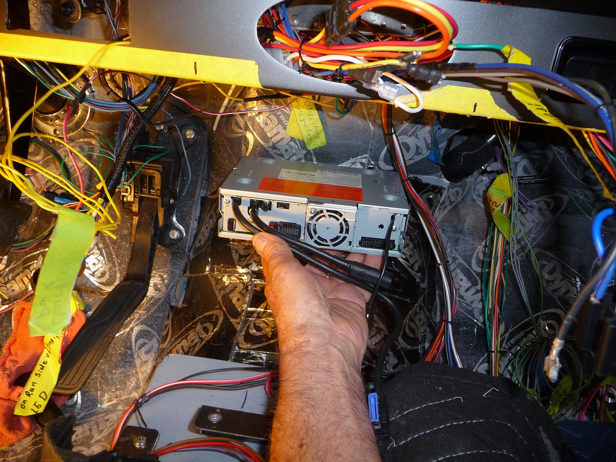

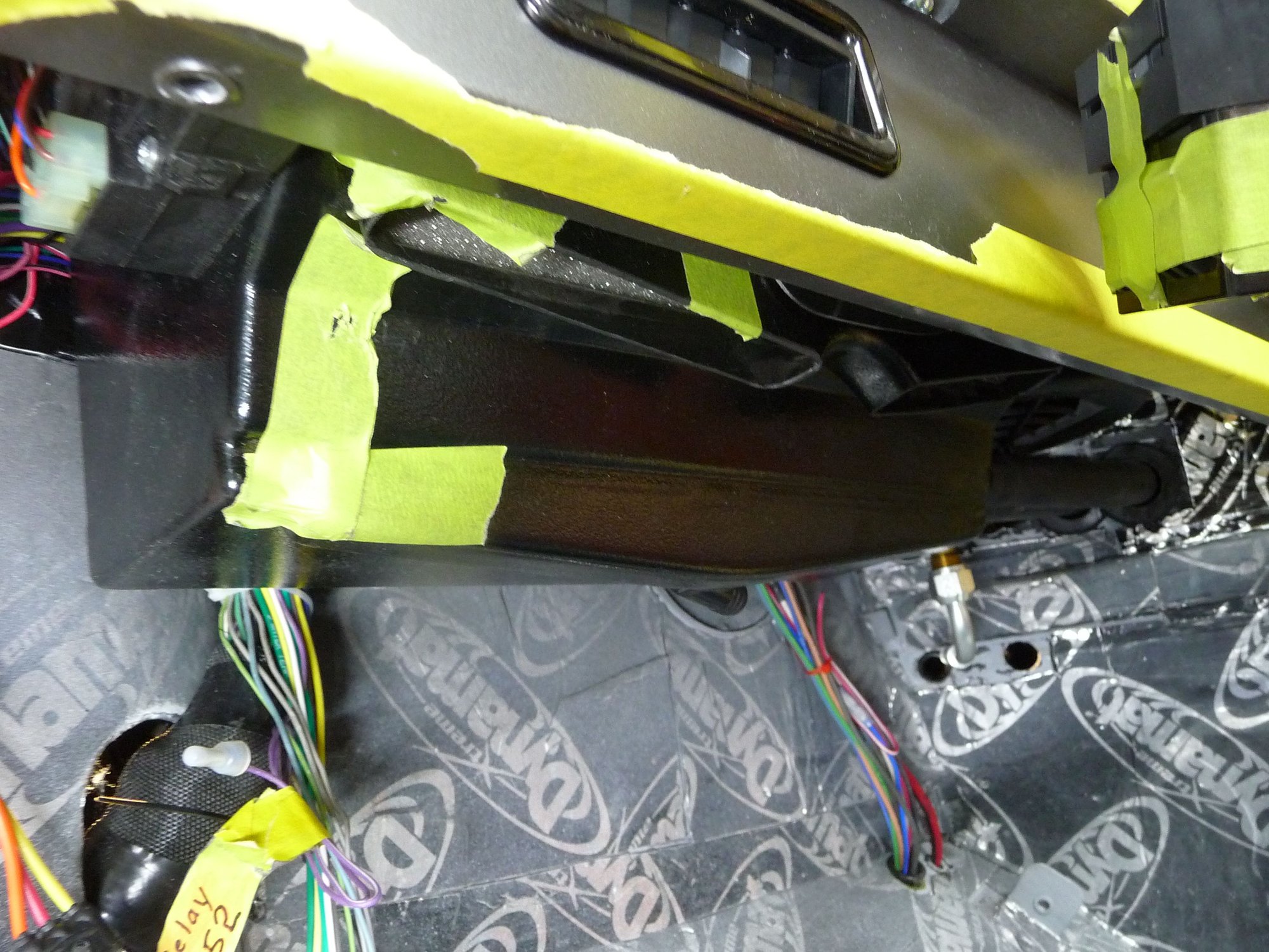

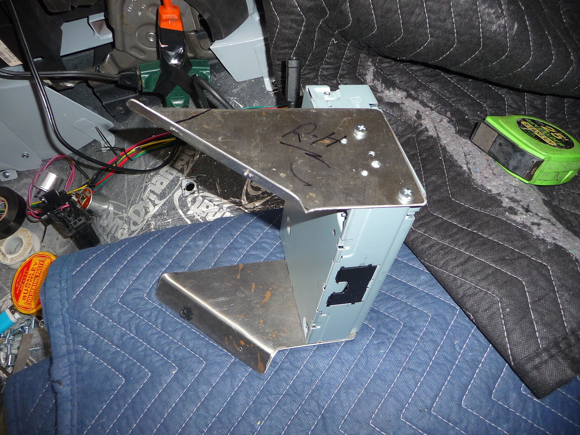

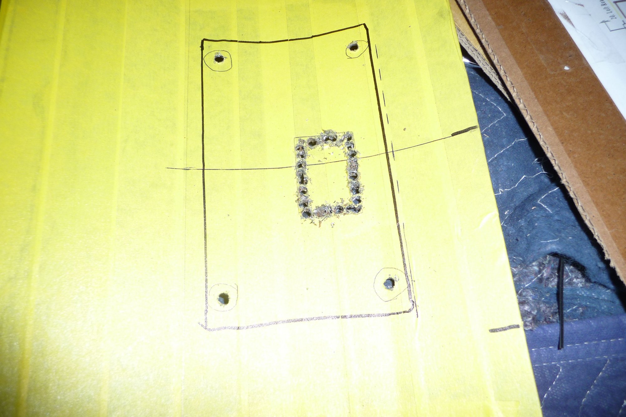

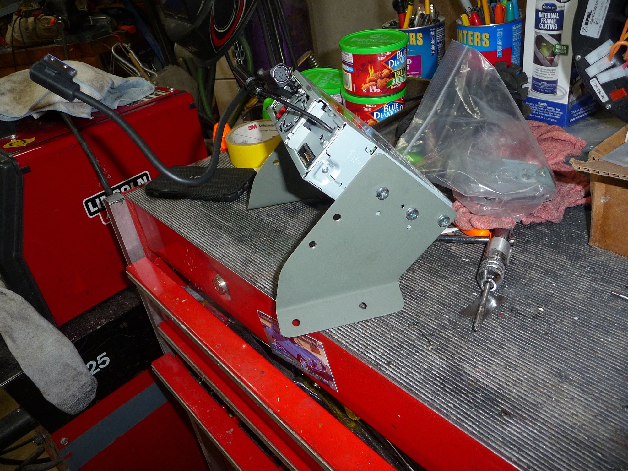

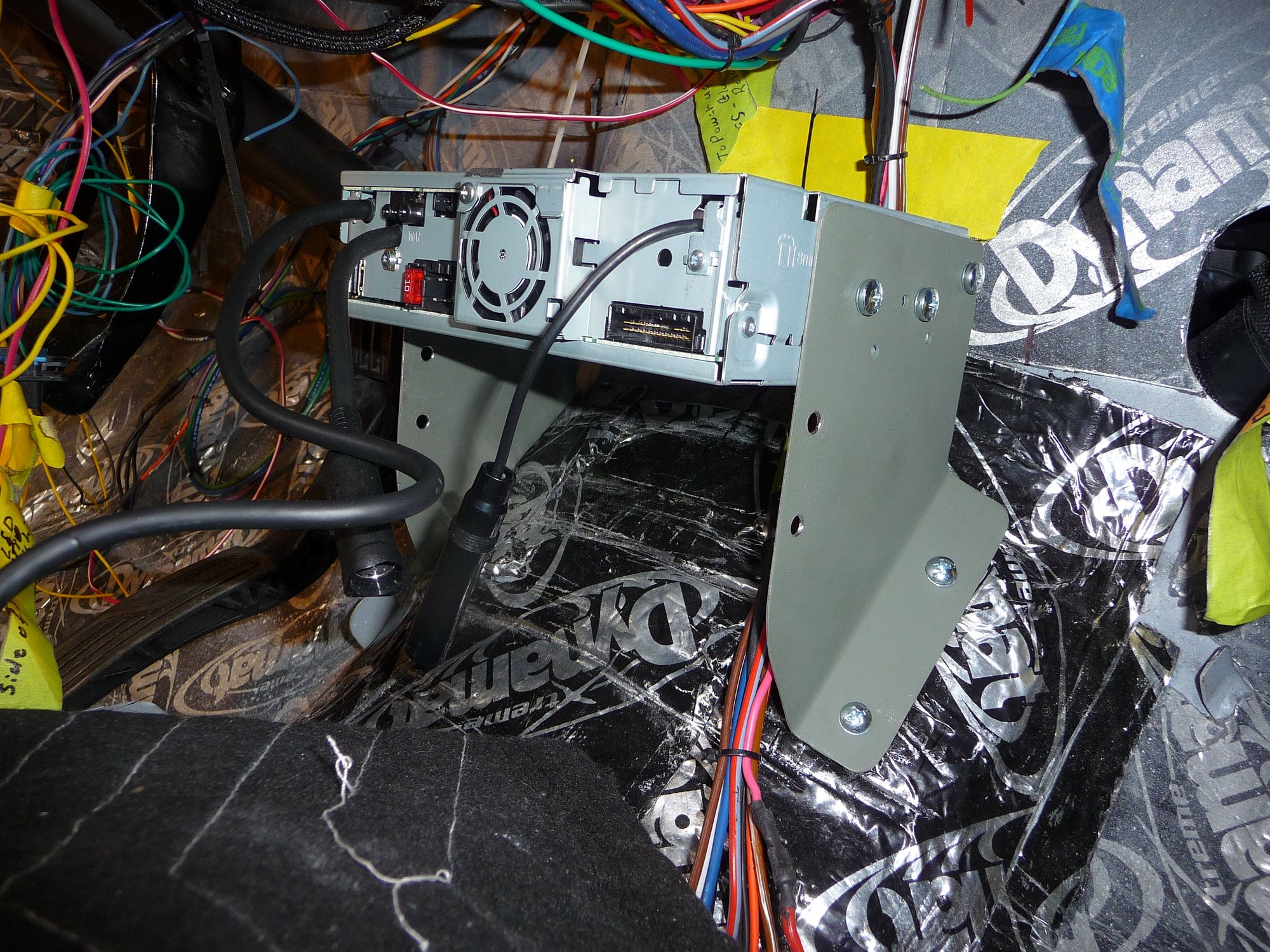

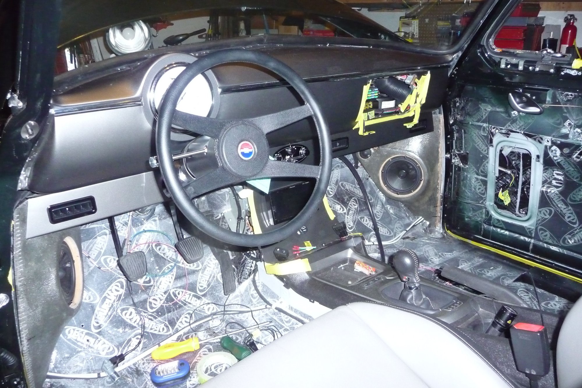

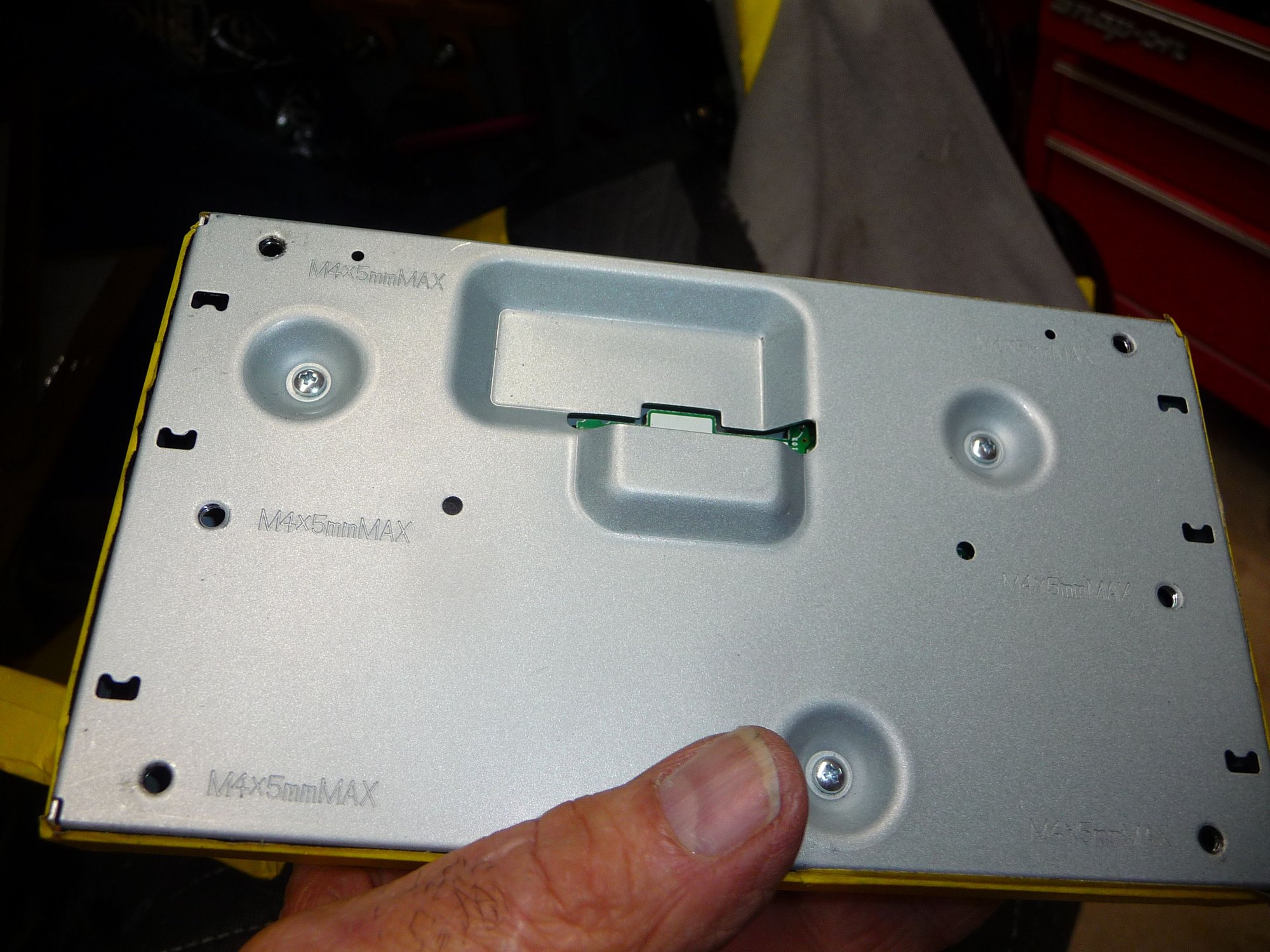

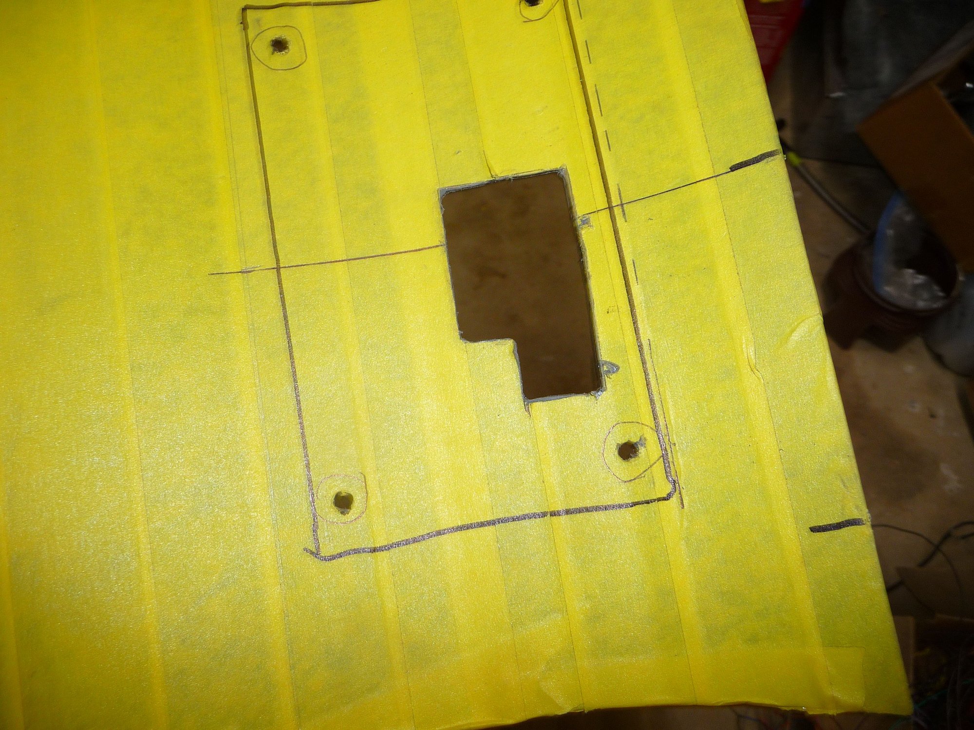

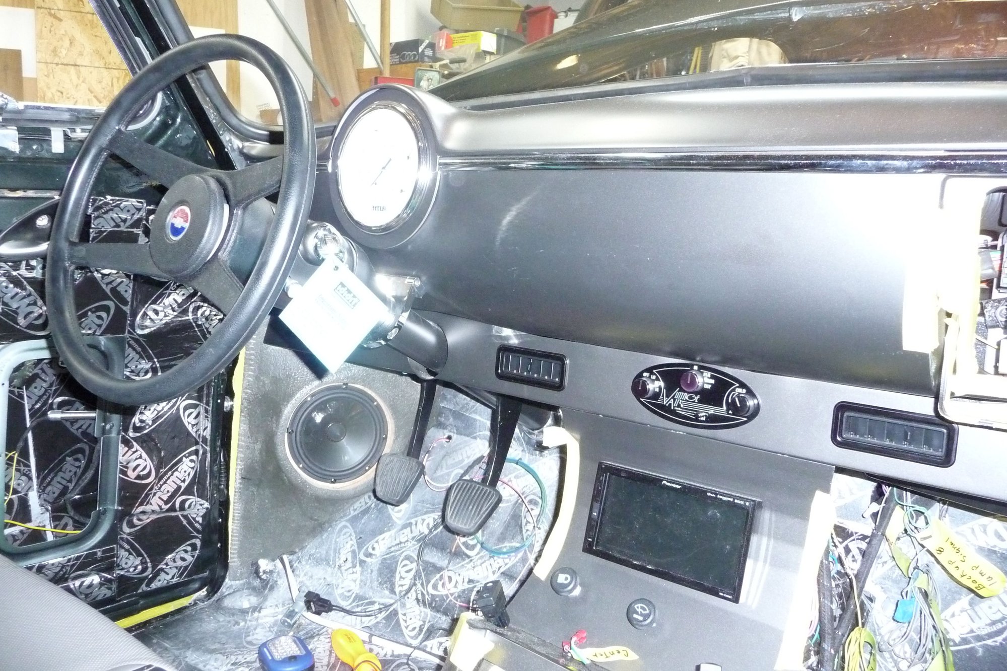

Some pix of my Pioneer DMH-2550 NEX Modular steiro.
Chain drilled hole for monitor
Remote power unit.

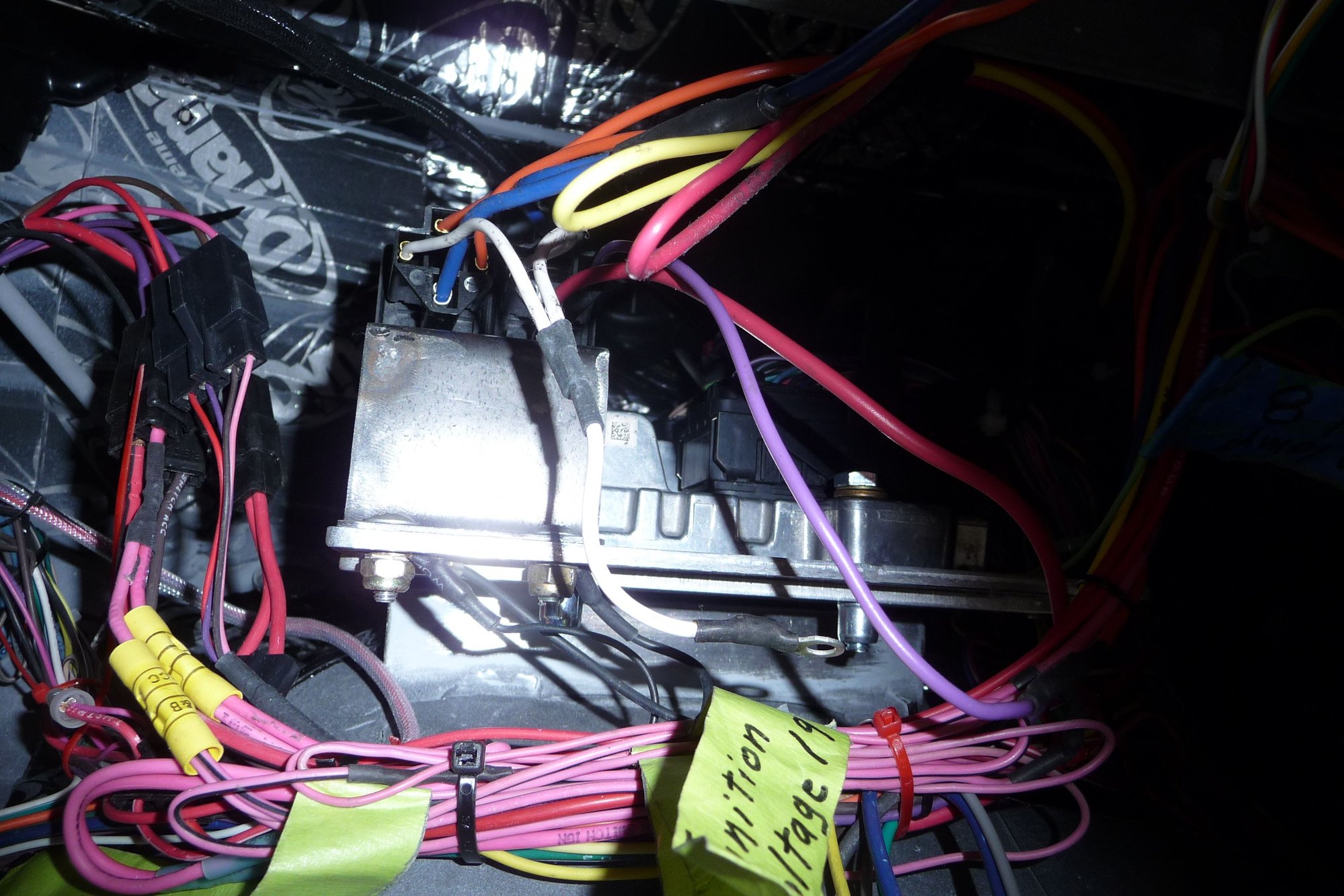

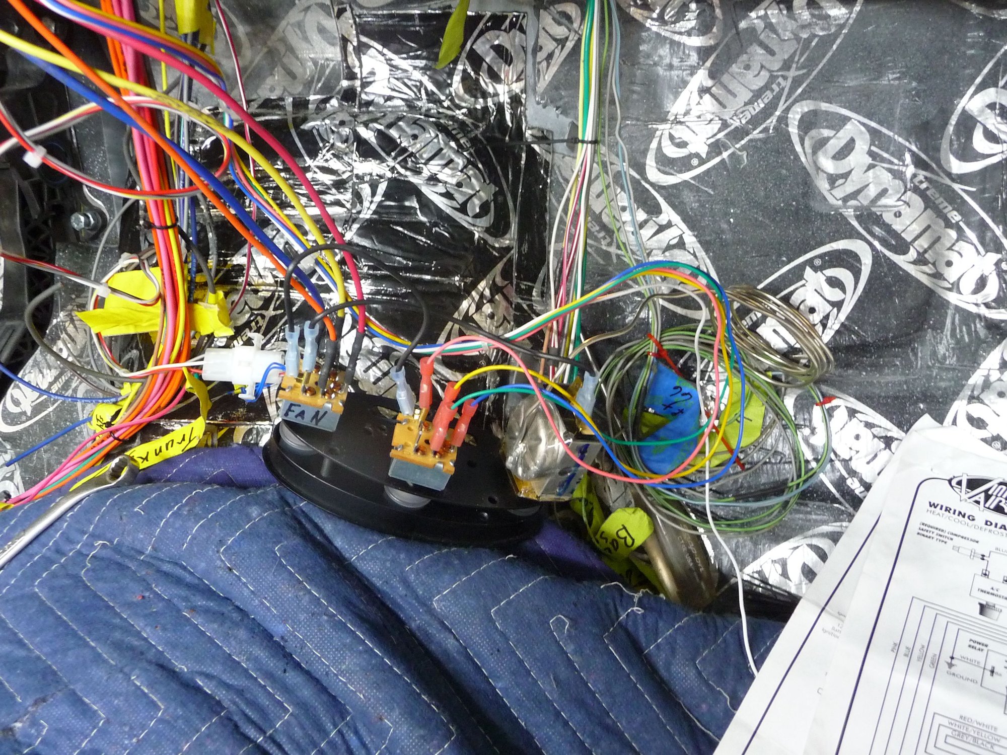

So I have an electrical problem that someone in the forum can solve. the electric system has been totaly rewired --- every thing works just fine------ How ever the Emergency flashers come on but don't FLASH -- flashers are both for LED lights, swapped flashers thinking I had a bad flasher unit either flasher works with the turn signals. Called Ididit thinking that maybe they had seen this problem before-- they hadn't seen this problem was referred to one of their engineers that I talked to for quite a wile with no answer. He and I were thinking about adding a 1500 k resistor to the circuit. Your help will save a lot of time THANKS in advance.

I initially had a problem when I installed my sequential led taillights in my Camaro. I too had installed what was supposed to be a flasher for led lights and they did not work. I ended up getting no load flashers that have a ground wire attached to them and that solved the problem.

Mike THANK YOU for your advice------------------ THIS CURED MY PROBLEM, WITH A NO LOAD GROUNDED LED FLASHER------------- Jegs 19.95$. THANKS again for your advice, saved me a lot of time and trouble.

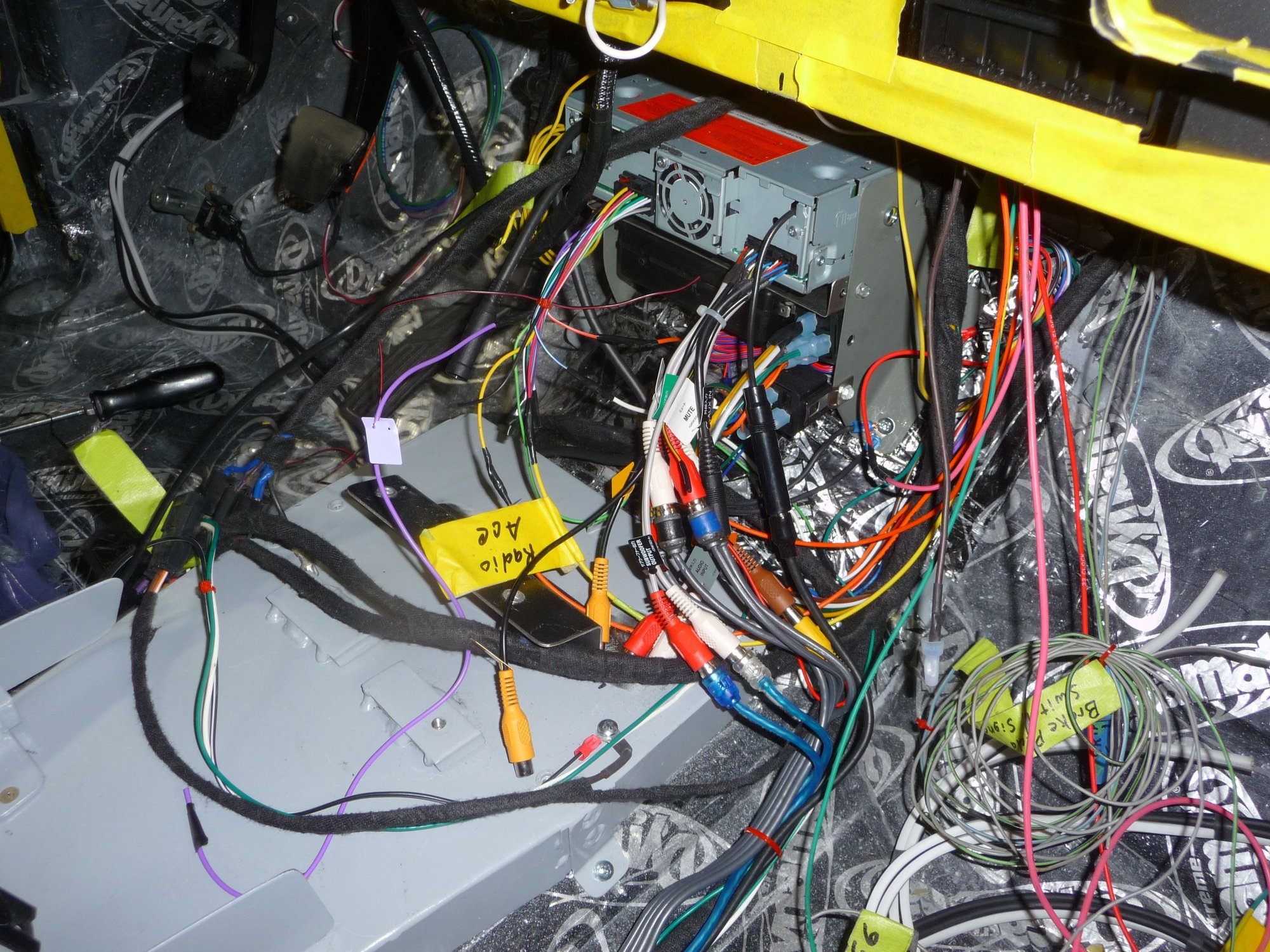

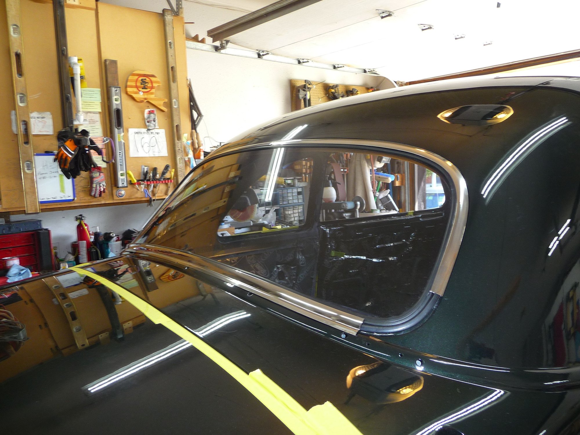

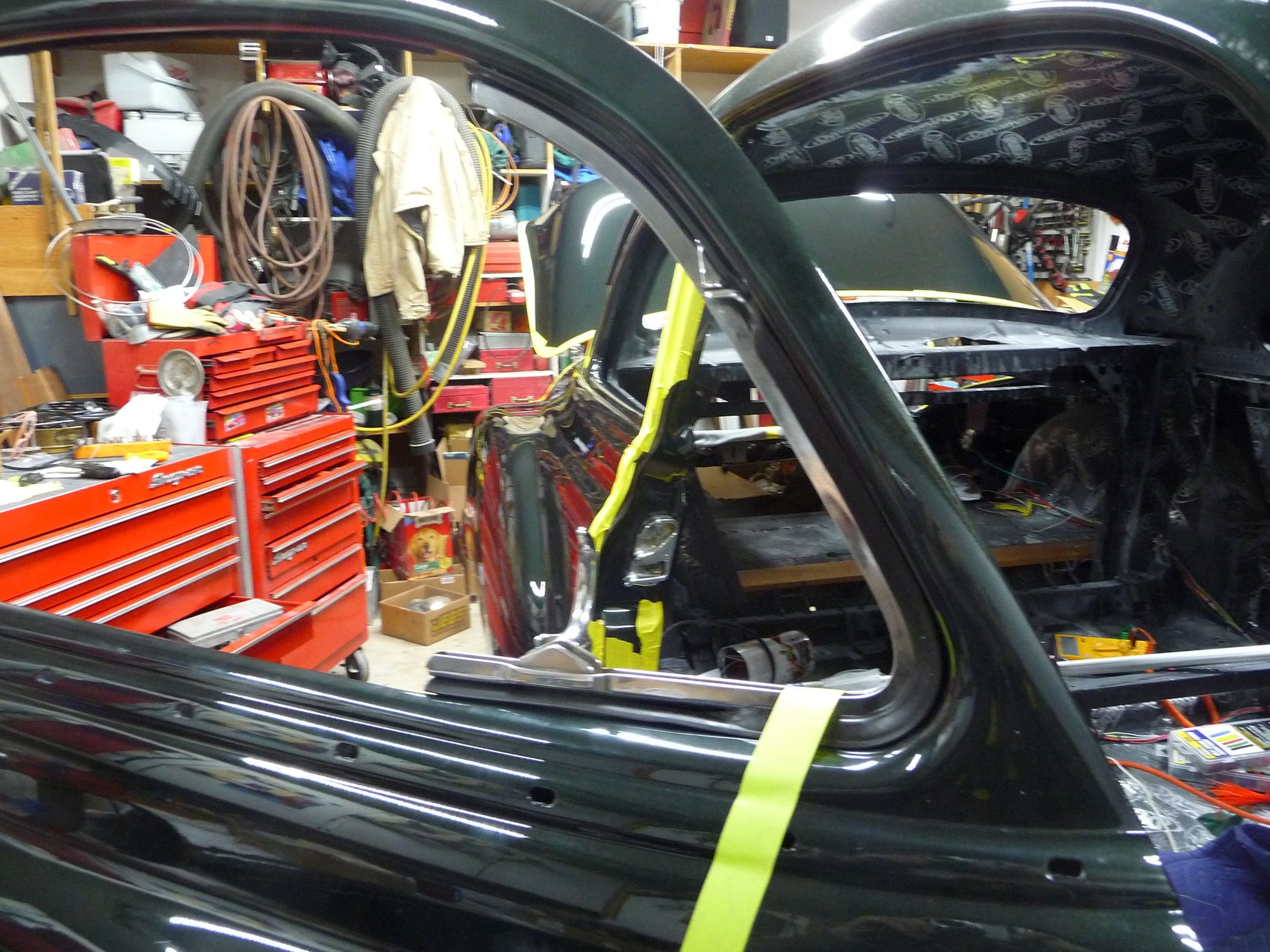

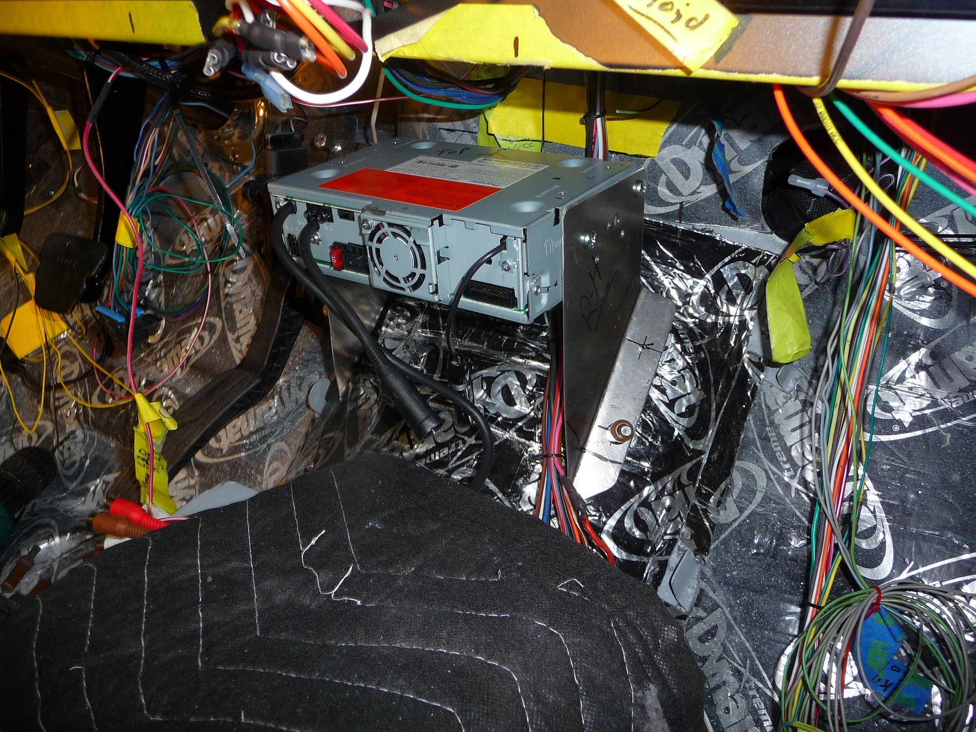

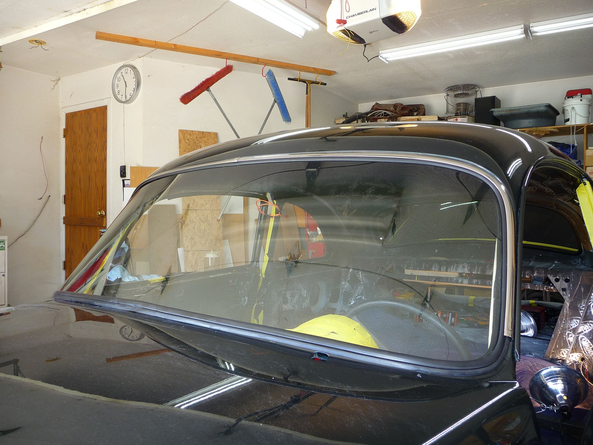

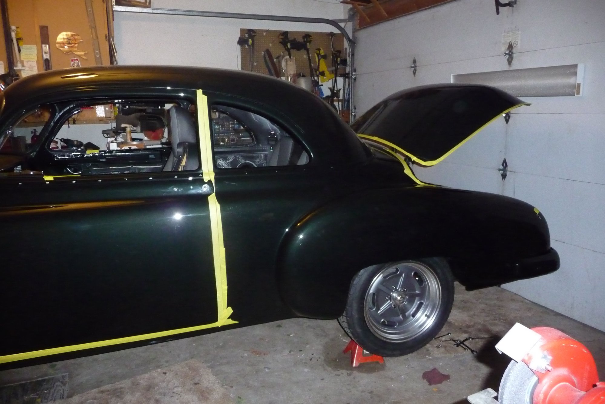

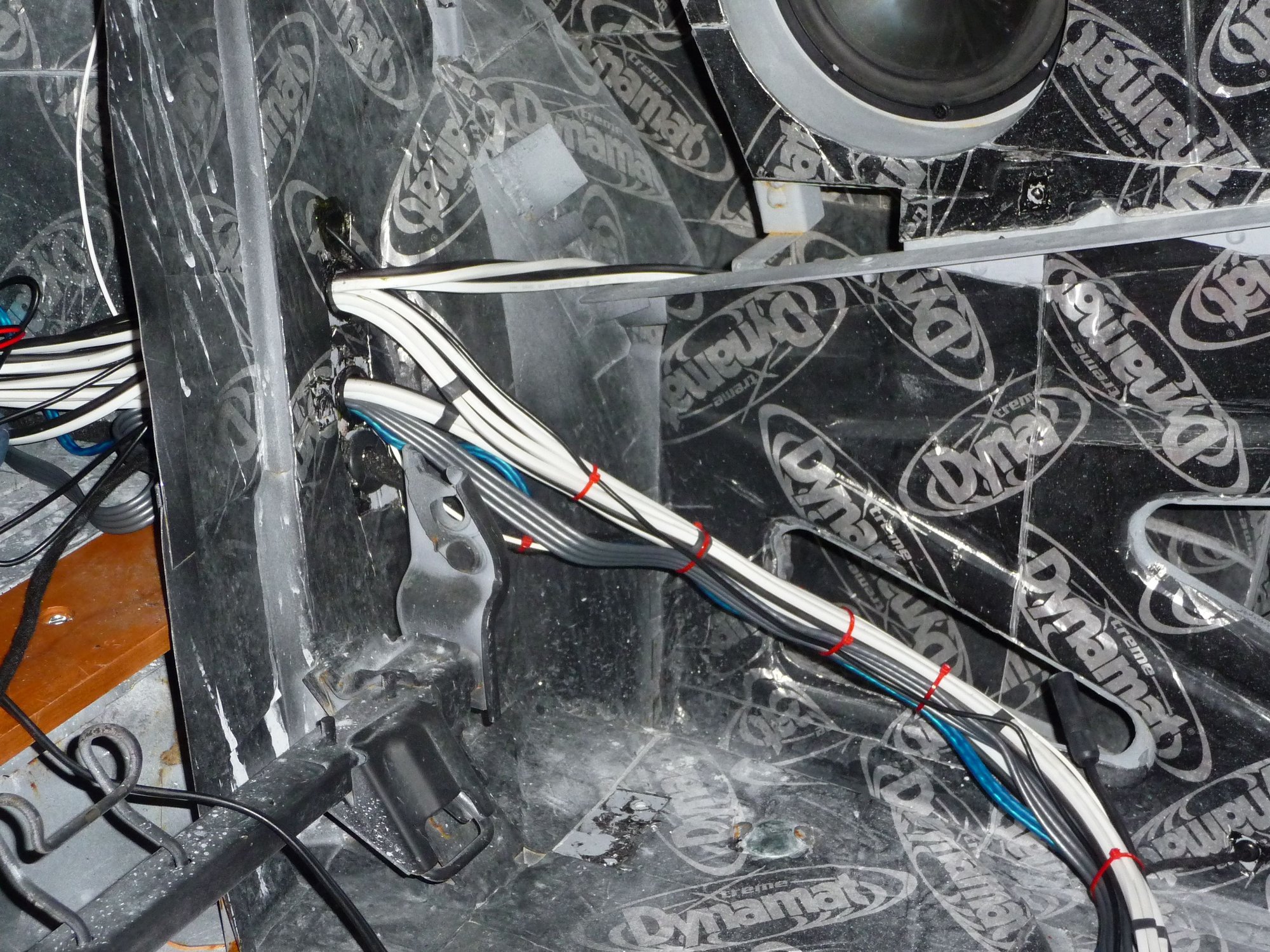

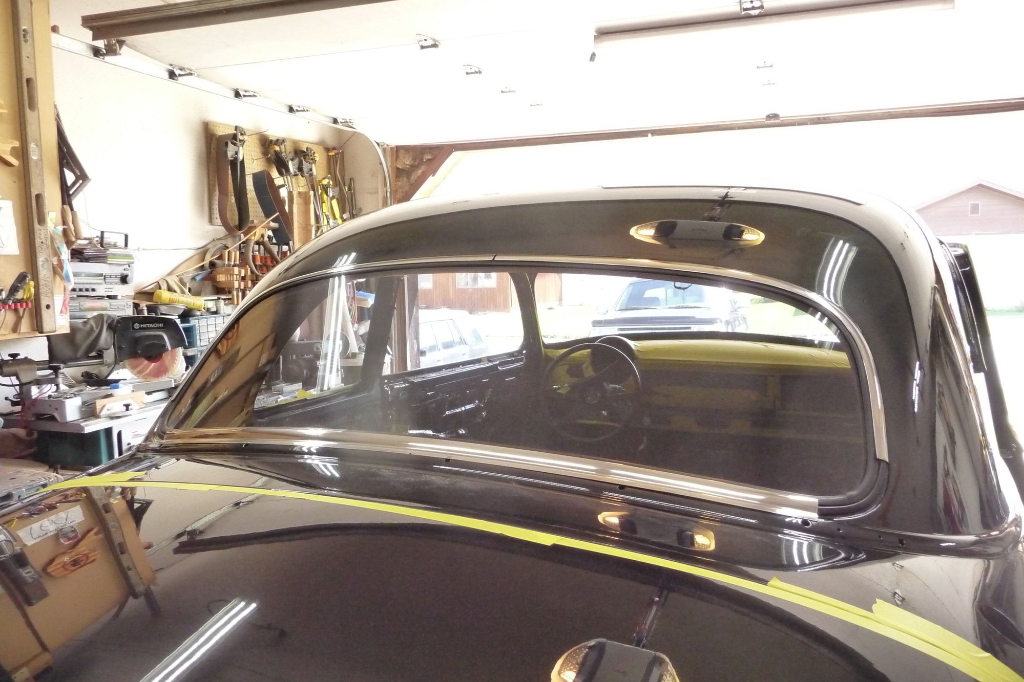

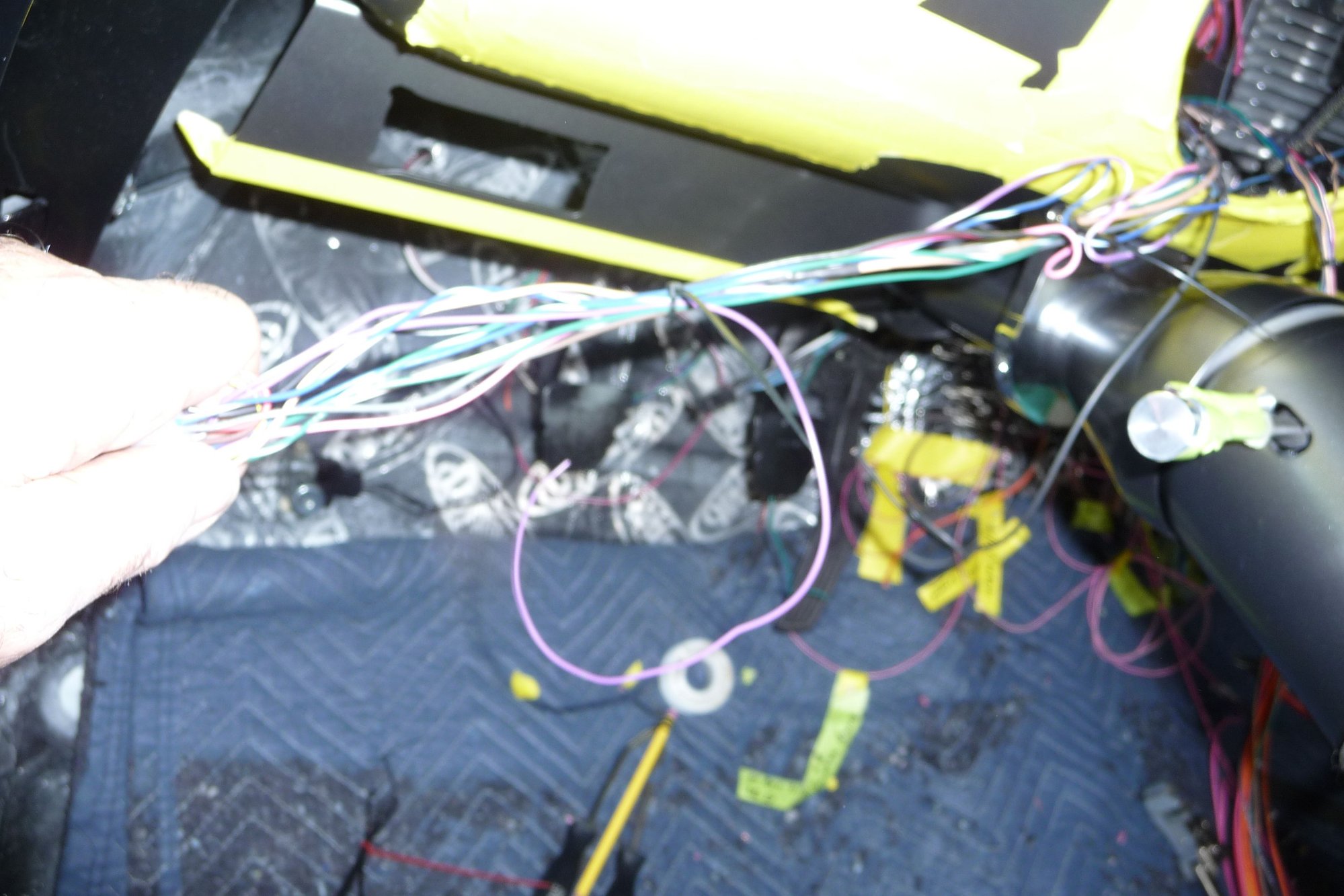

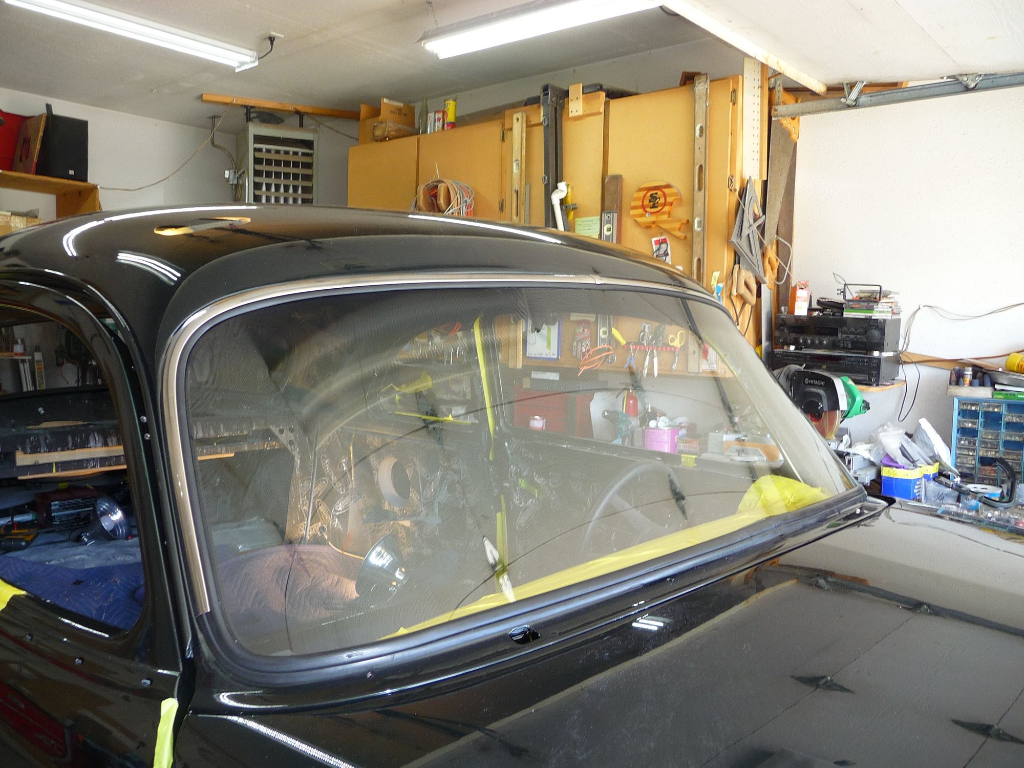

An update on the progress stereo is close to being finished up ft/rear glass in.
windshield is in place
stereo wiring harness

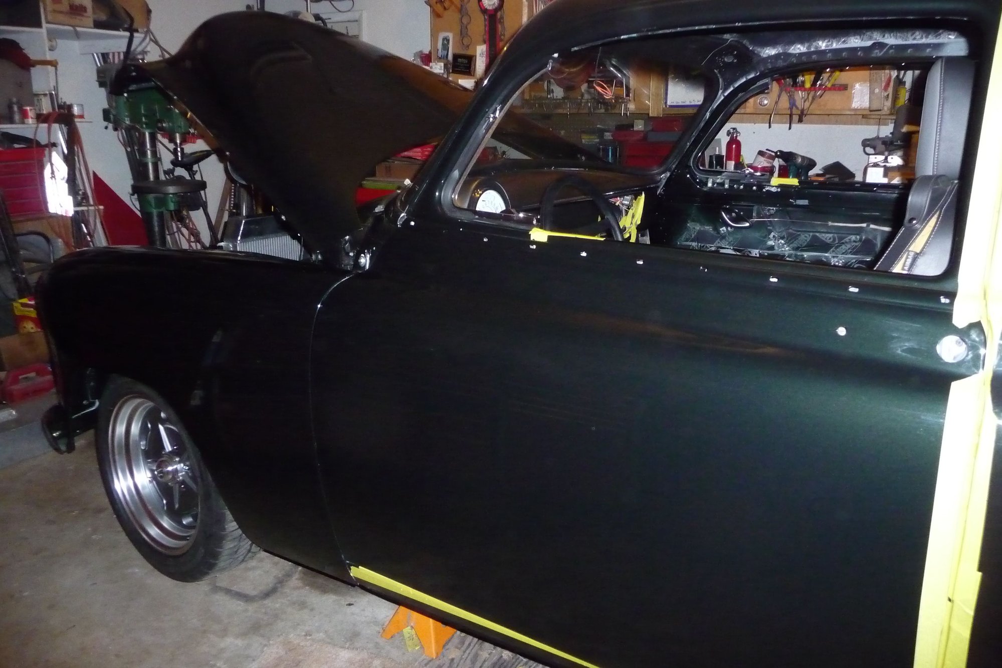

Been a wile since iv'e posted any progress reports, the car is close to being finished, stero is in interiour is in. This will get a final sand and buff to finish up the paint job, coil overs and tempered side glass. The rest of the build will need to wait till after covid 19. Montana has become a hot spot for the virus. so this is going to be on hold for a wile.
