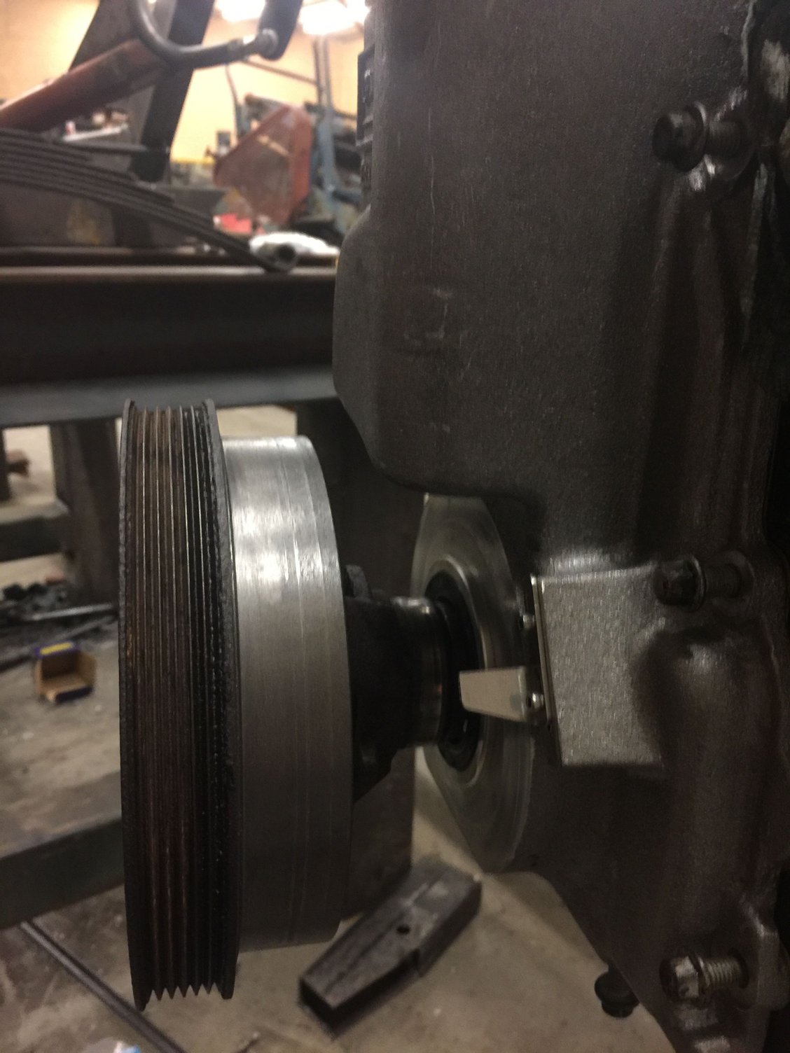

To clarify, I am running the distributor because the car is a 1930 model a coupe that chopp d and channeled and I really want it geared more towards the classic look. It'll even have old style VCs.
I did bite the bullet with the ATI piece just a little bit ago. I still cannot help but think there is another way. That is now a moot point.
My next step will be to make the stock water pump work. No way will I bring myself to spend that kind of money on the wegener "special" pump. I will make the stock pump work some way, somehow! :-)
I will say that it would be nice to see someone post up if they have run something other than the ATI unit.
Last night I machined my original crank pulley down just to see if it would clear the timing/distributor cover and it would by 1/8". I couldn't use it because it was not perfectly concentric. My guess is that before I got the engine it had become out of round. It was noticeable when I chucked it up in the lathe.
[img]cid:555B7CE2-41C8-4481-AD48-8B31011E32FC[/img]
