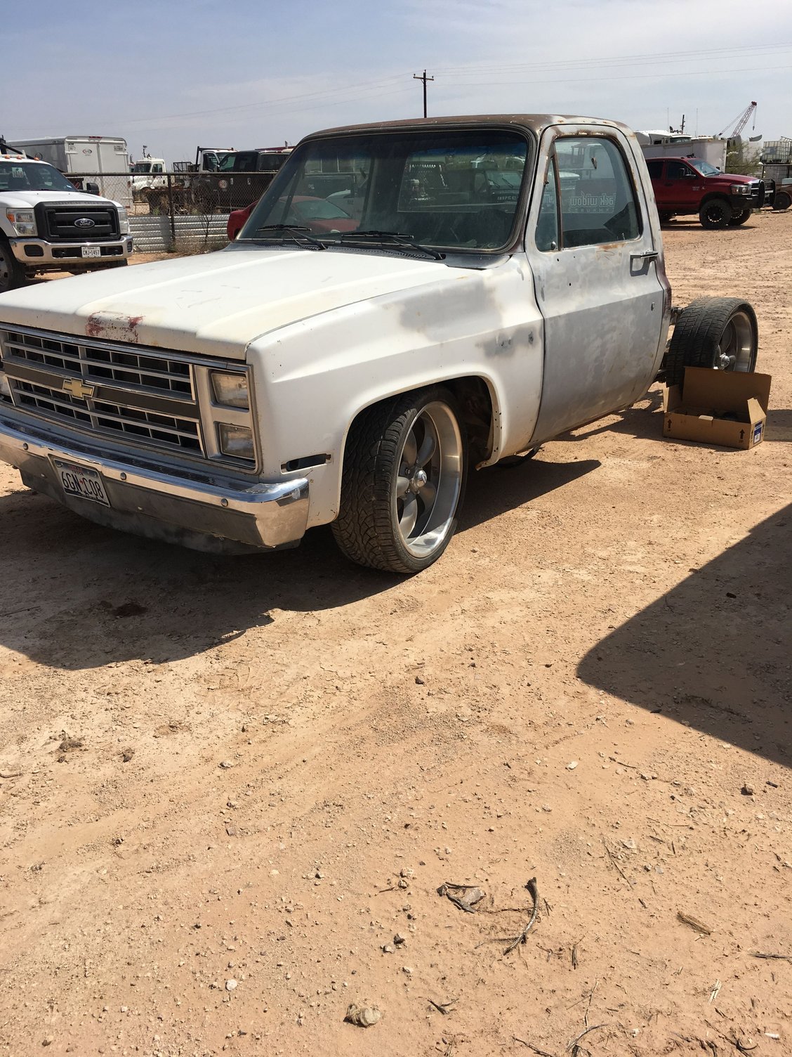

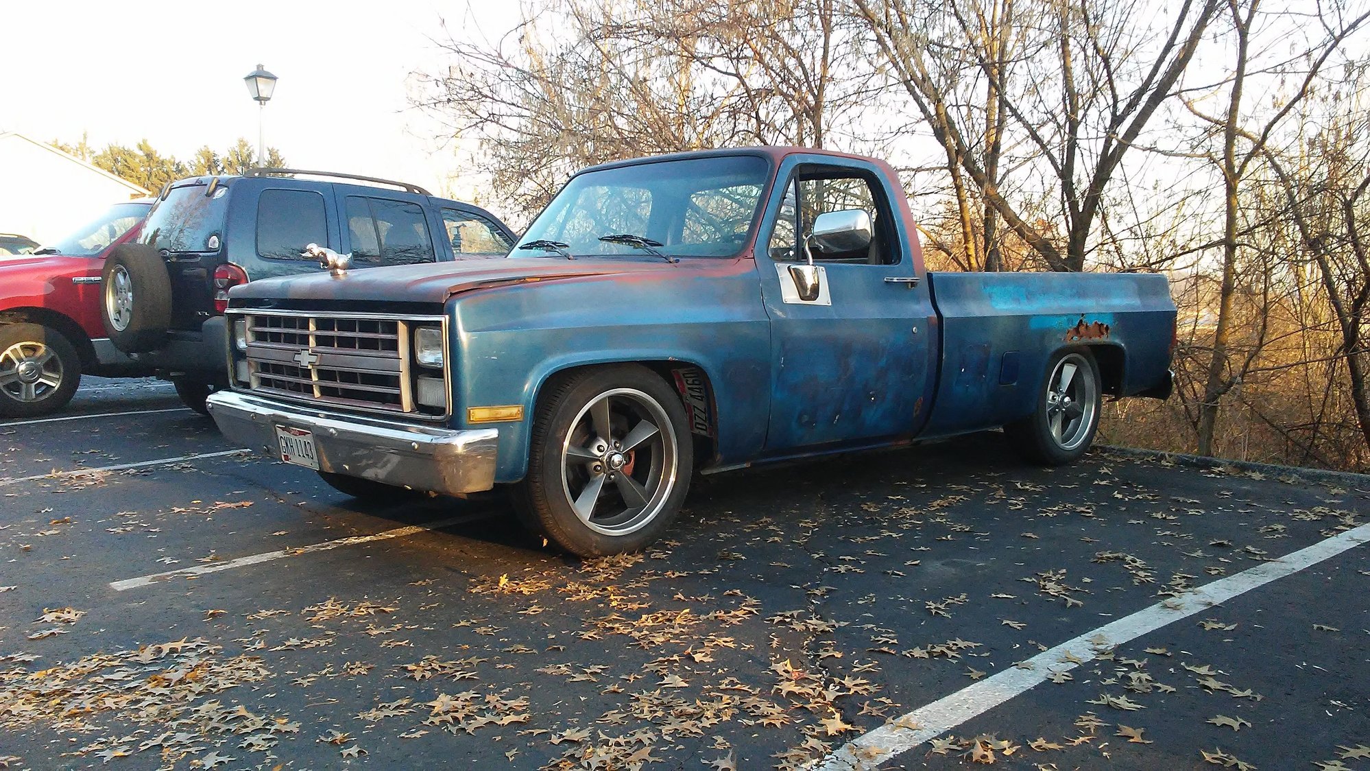

This is my 87 lwb with a lq4 and a 4l80 and a tone of other parts

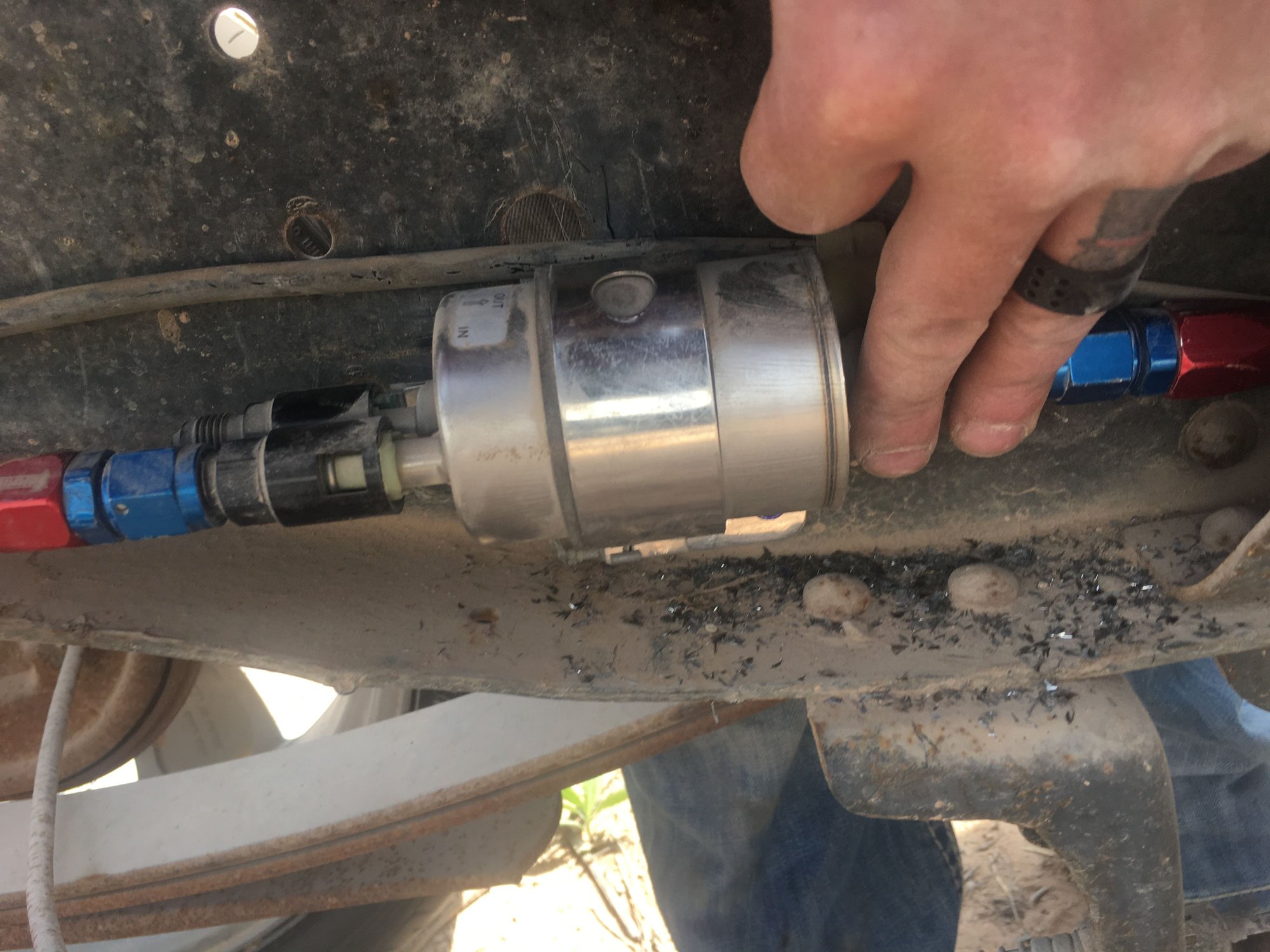

Curious why you went with the Vette filter vs building a return system?

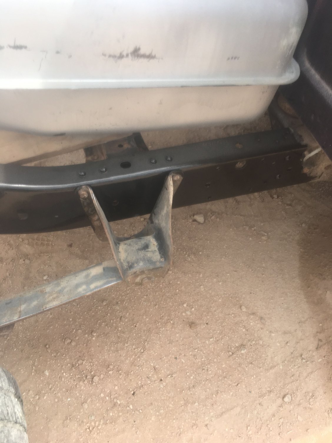

And the tank, a few pics mounted would really help, are you going to run a fuel tray or something to defeat slosh?
Old Dec 16, 2017 | 11:01 AM
Posts: 22,295
Likes: 3,617
The Vette filter/regulator IS a return system. Pressure is regulated close to the tank and the return line is thus VERY short between the regulator and tank. Eliminates a lot of tubing/hose.

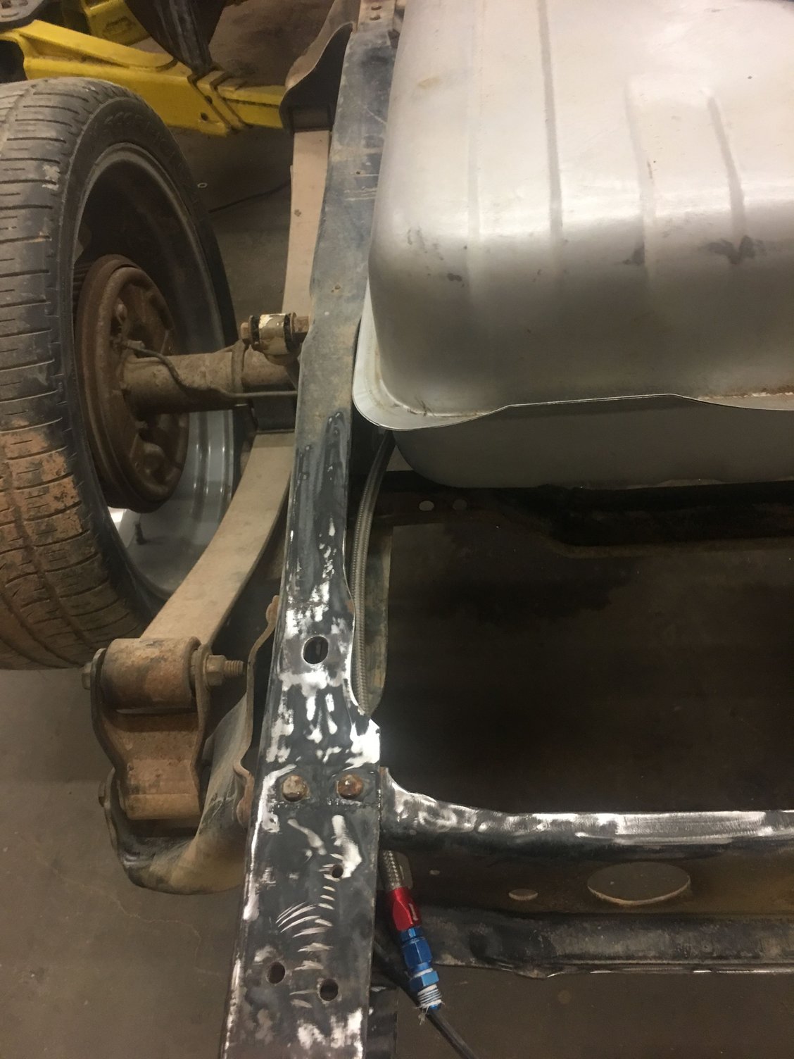

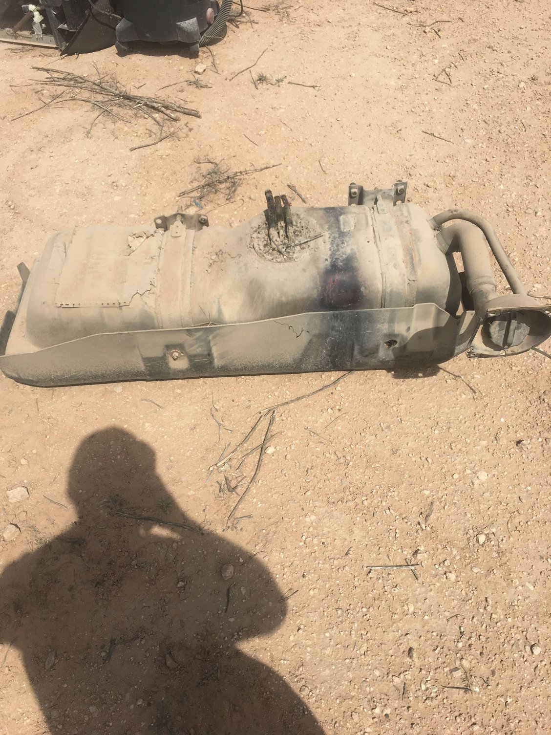

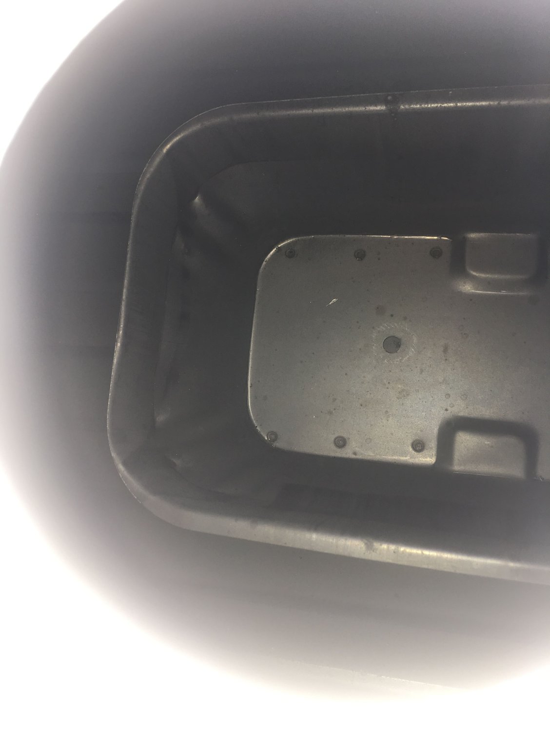

The ‘87+ K5 Blazer/Suburban tanks have an enternal baffle inside. The tank is spectra premium brand, so is the sending unit. The pump is a Walbro 255. Let me see if I can upload a pic of the baffle inside the tank.
Old Dec 22, 2017 | 07:31 PM
lowchevytrucks8503's Avatar
Joined: Jul 2009
Posts: 242
As for the return system, my fuel rails don’t have the return on them. So my feed will run from the sending unit to the Vette filter/regulator. The return line will run back from the Vette filter/regulator back to the sending unit. One feed line will run from the filter/regulator to the fuel rails.
Old Dec 22, 2017 | 07:32 PM
Joined: Jul 2009
Posts: 242
Baffle inside the fuel tank

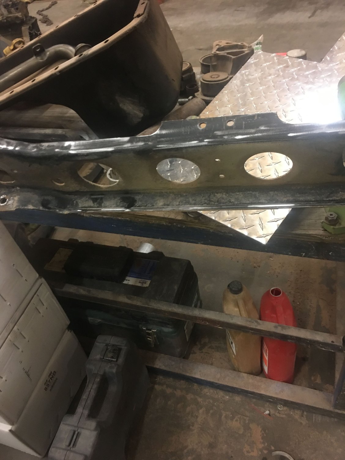

Posts: 242

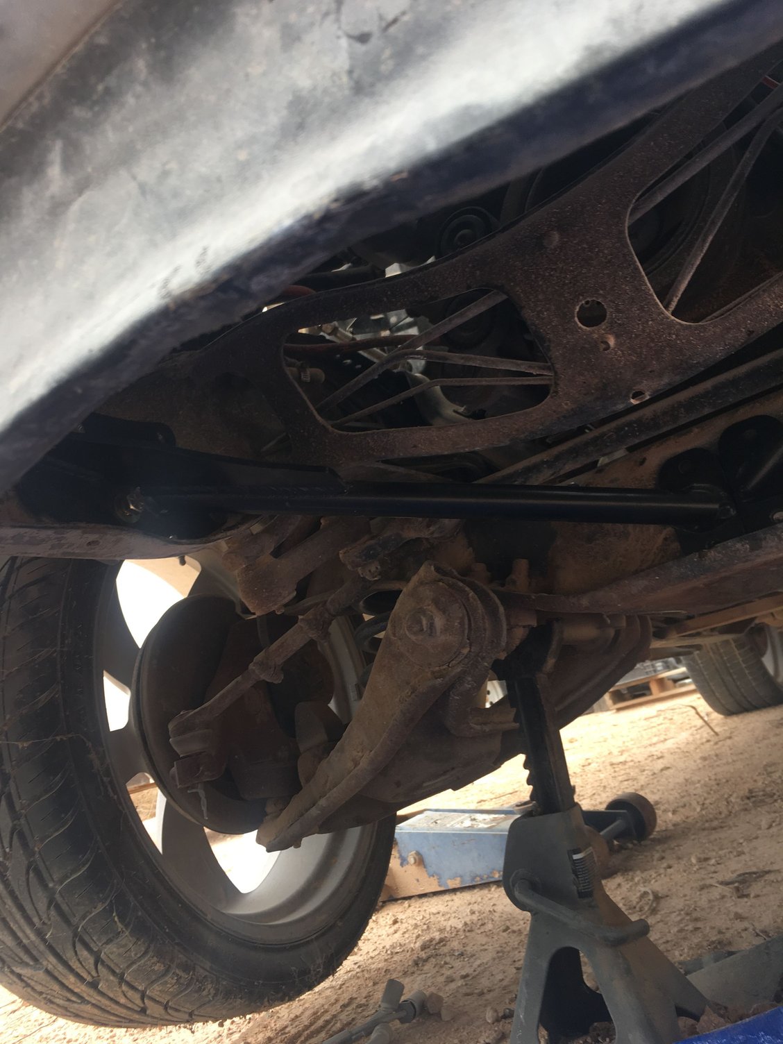

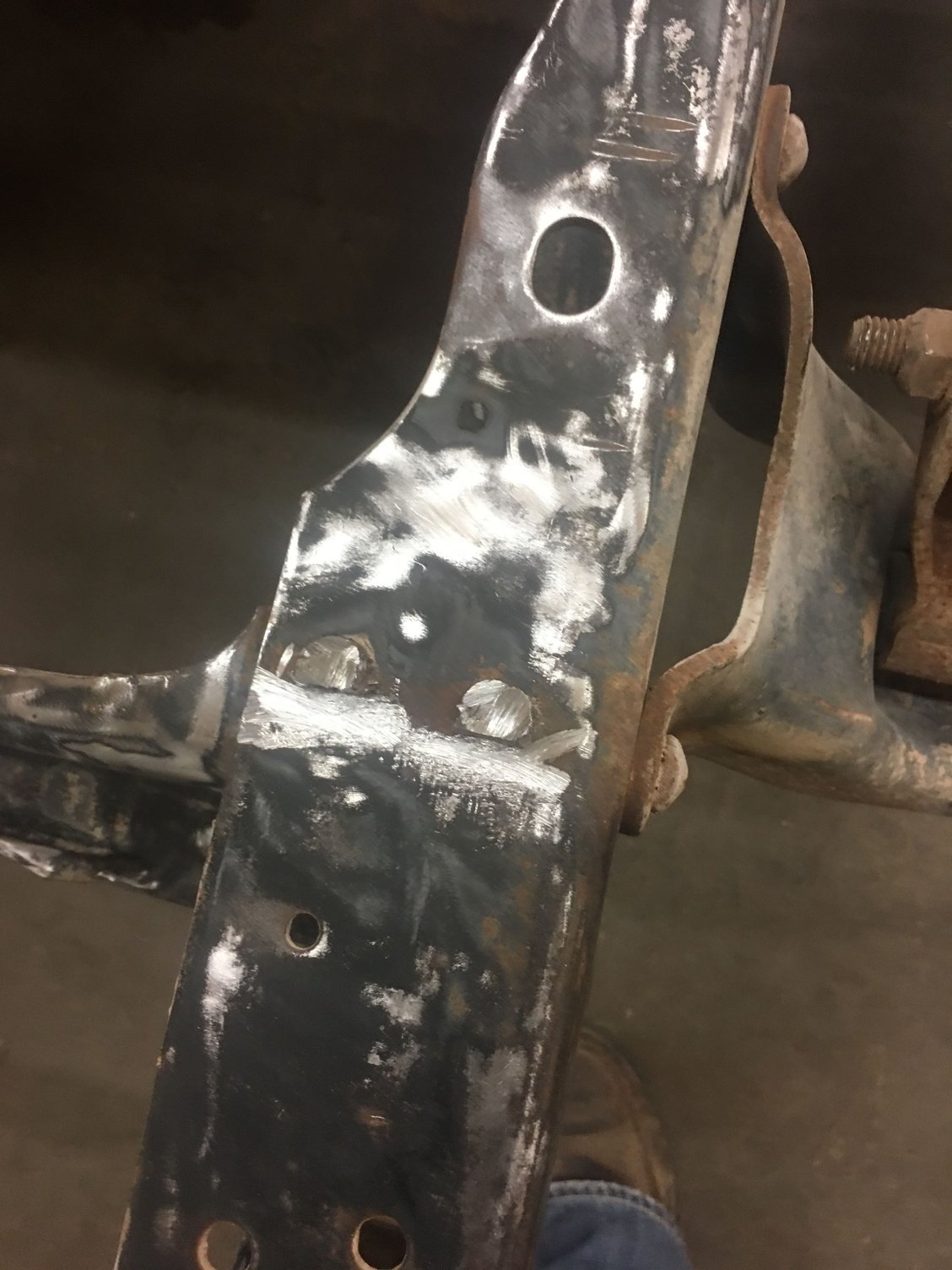

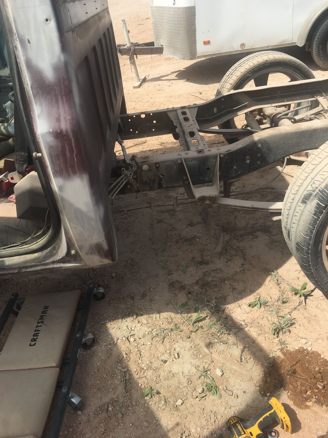

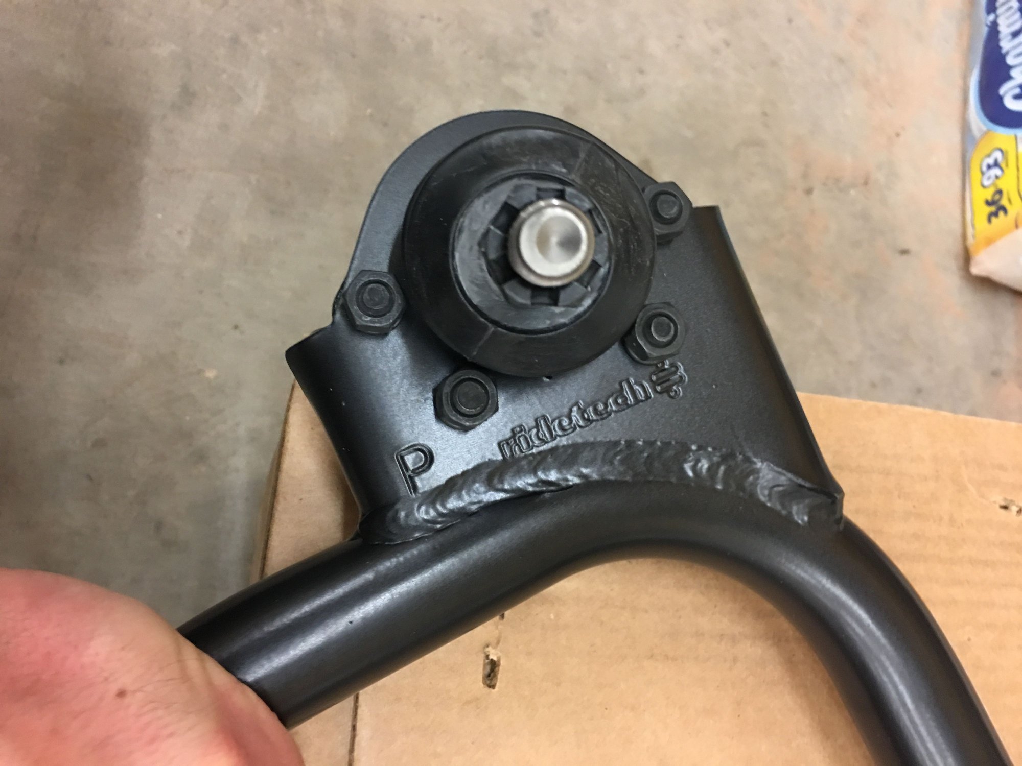

Yesterday I started mounting the Ridetech frame stiffners for the front. Several holes have to be drilled in the frame and 4 in the crossmember.

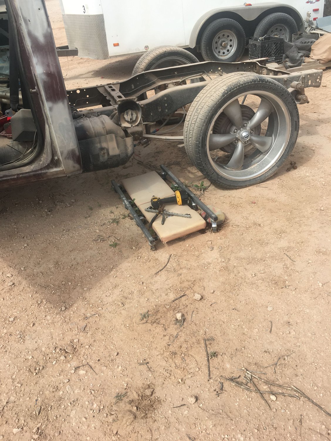

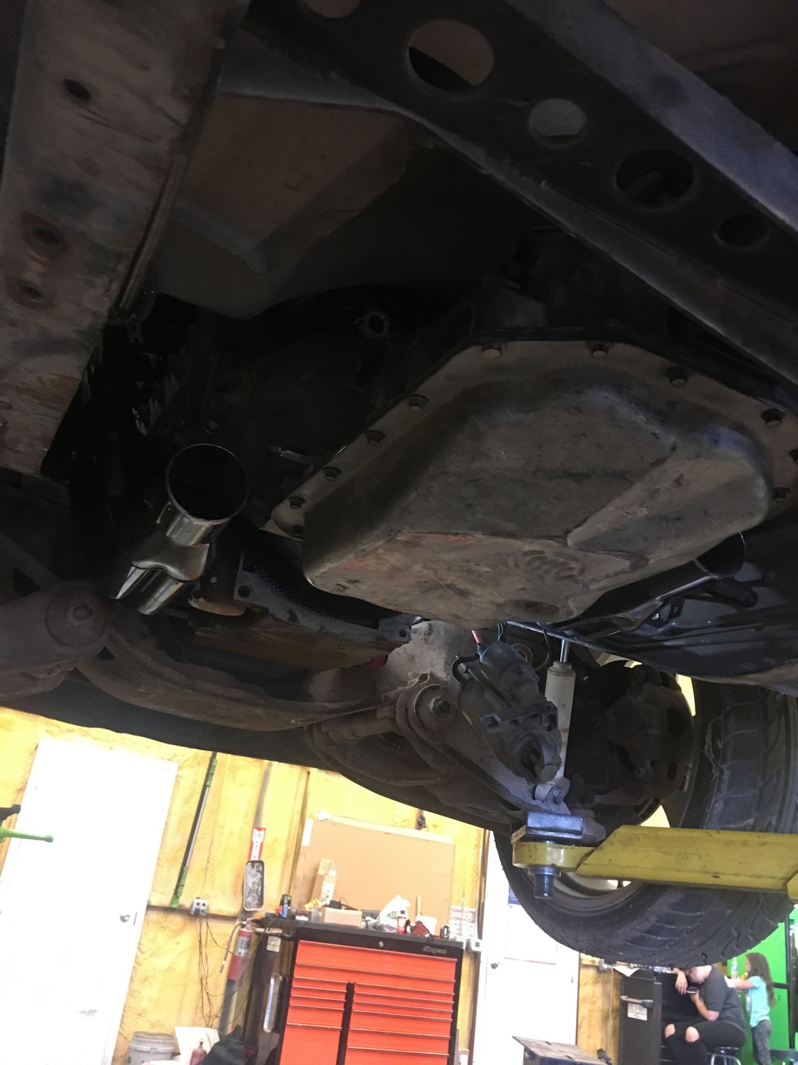

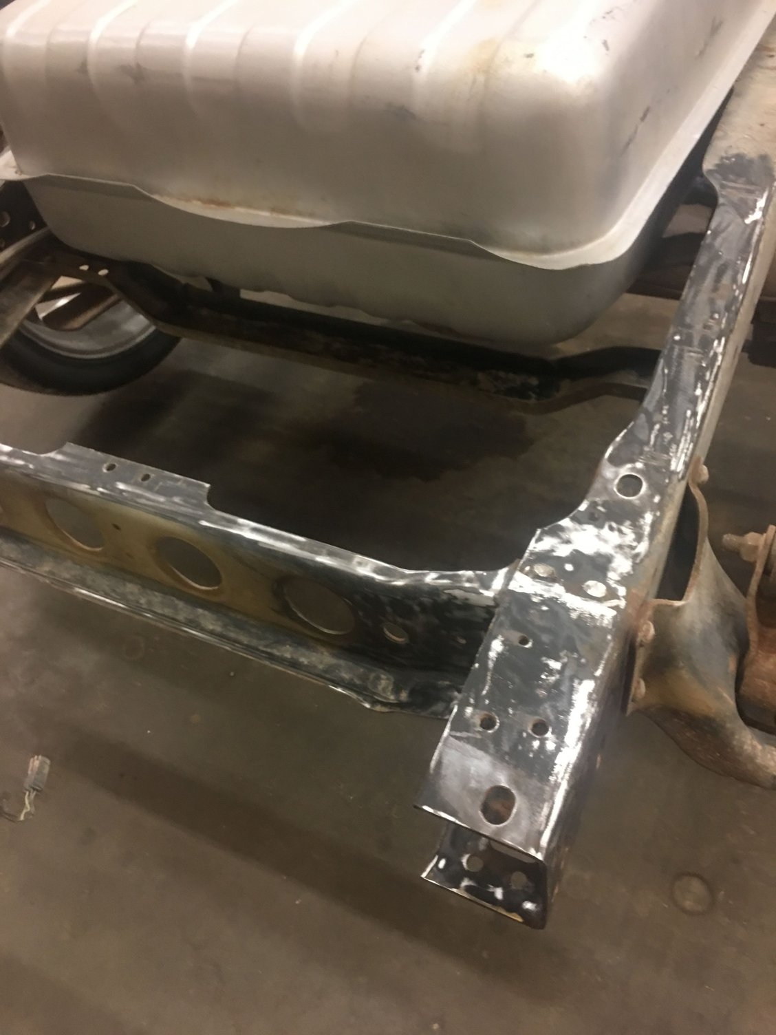

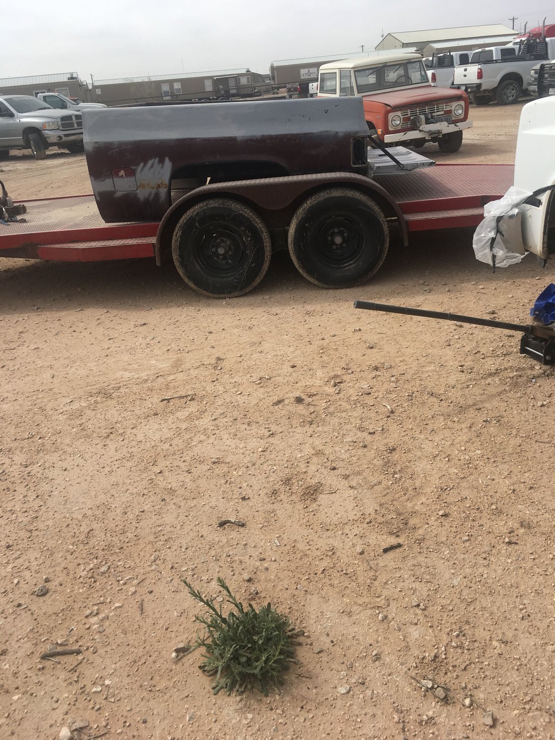

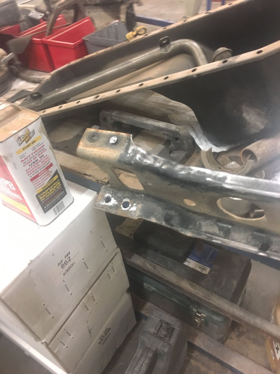

Today I was able to get the bed off and thrown onto my trailer. I took the time to get the old fuel tank out. I drilled a hole in the frame and mounted the fuel filter/regulator. I need to roll it into the shop and use an air chisel to remove rivets on the two rear braces. The one towards the rearend is the spare tire mount. I plan on moving the one towards the rear all the way back. Both braces will be used to mount the blazer/‘burben tank.
I still have to install the 4l80e, Circle D stall, Lokar shifter linkage, Wilwood D52 front calipers, SSBC rotors, Schoenfeld headers, and several other parts I have lying around. I ordered Ridetech Strong Arms and coilovers for the front. I am ready to get everything thrown onto the truck!

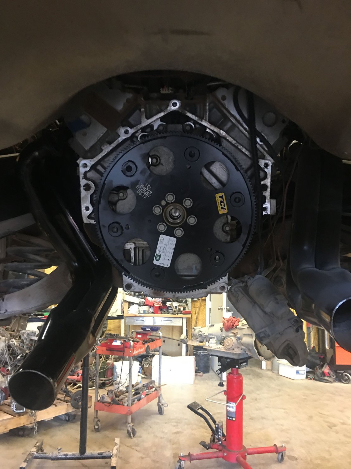

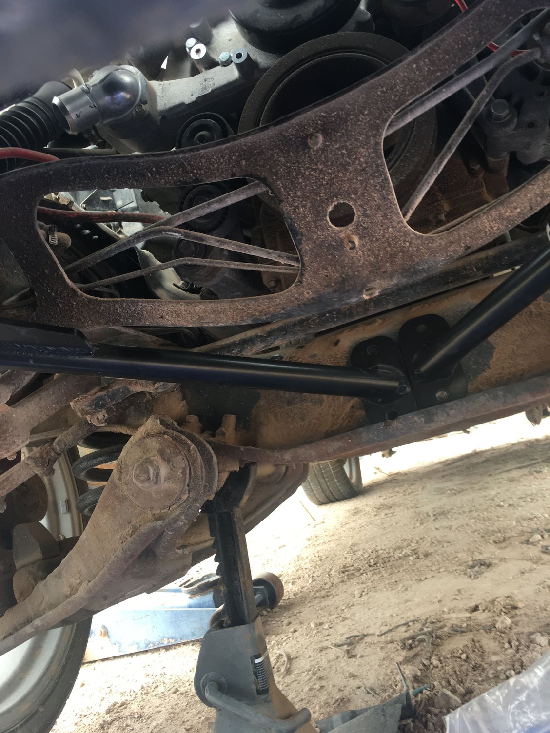

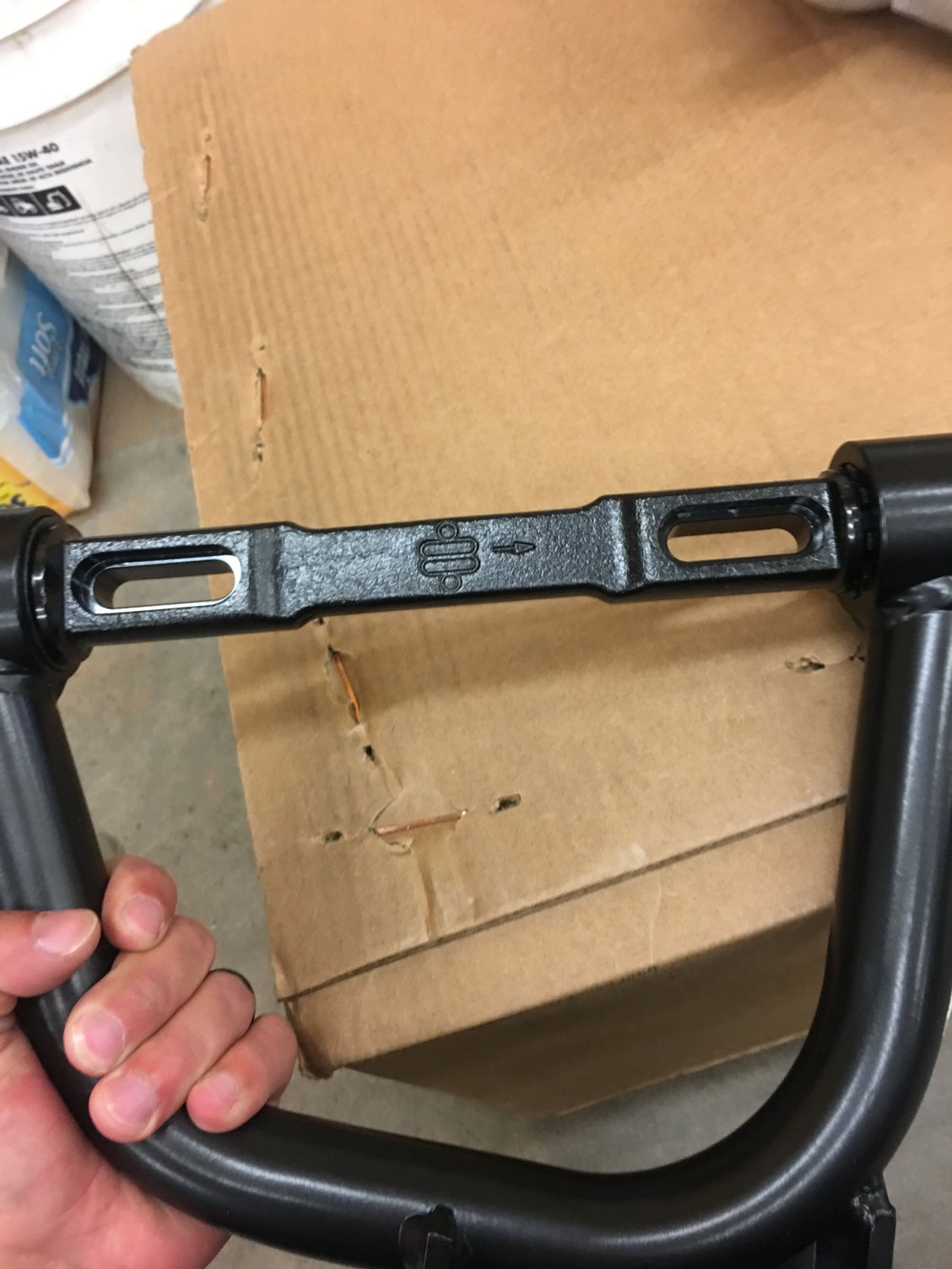

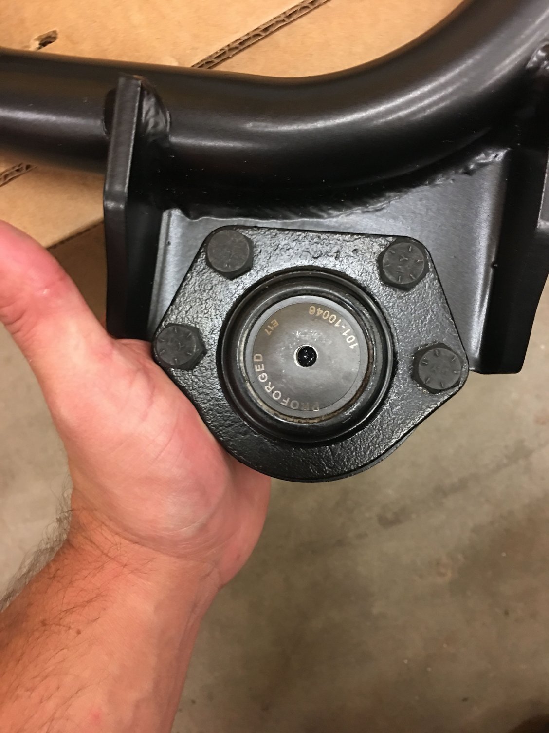

Last night I finally got the StrongArms/Coilover kit from Ridetech. I received their 2.5” drop spindles a few weeks ago to replace the DJM spindles I have currently. The DJM Spindles have 0 miles on them but I wanted to use Ridetechs to go with their kit.

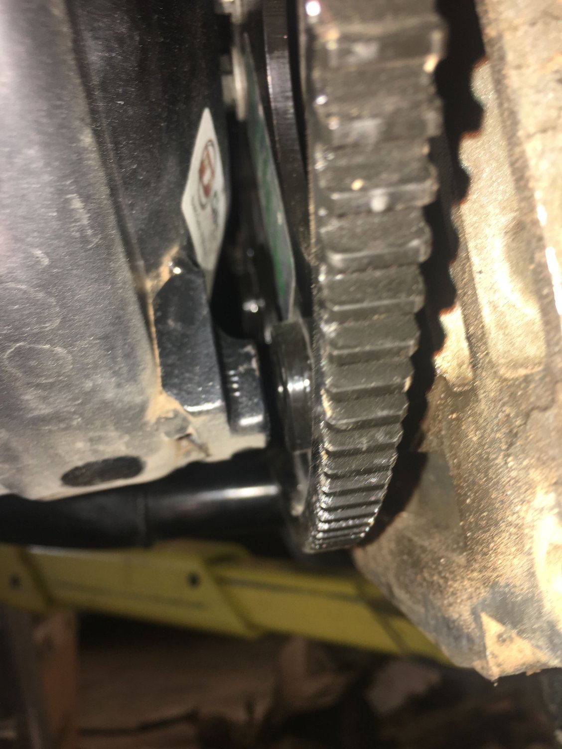

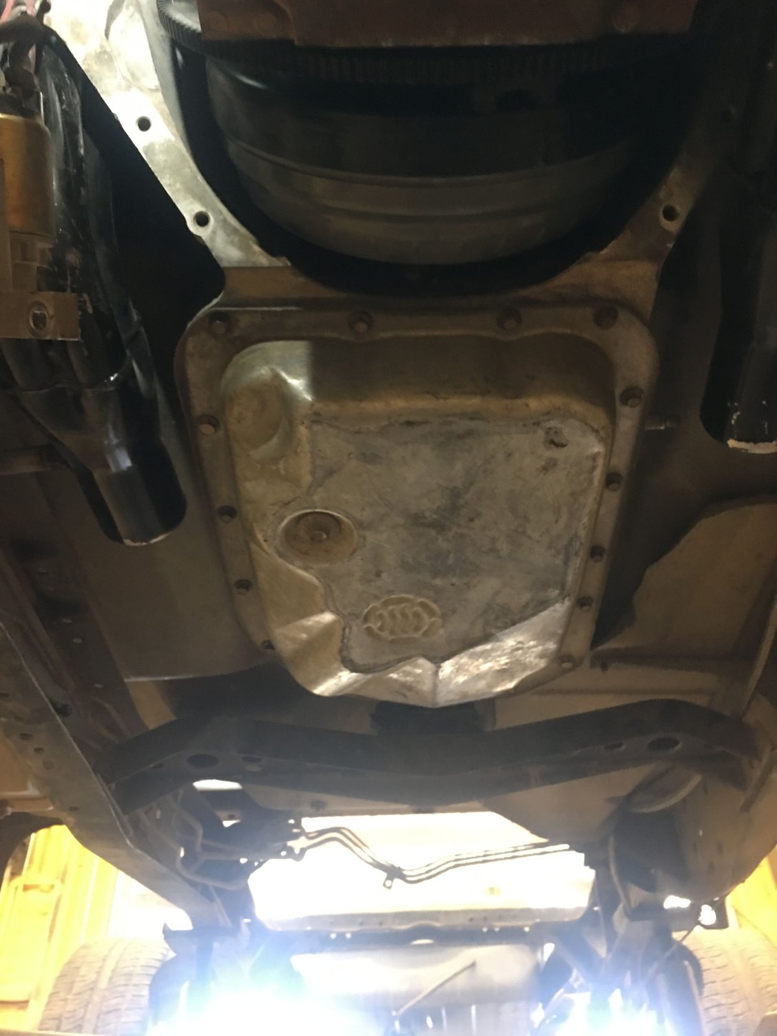

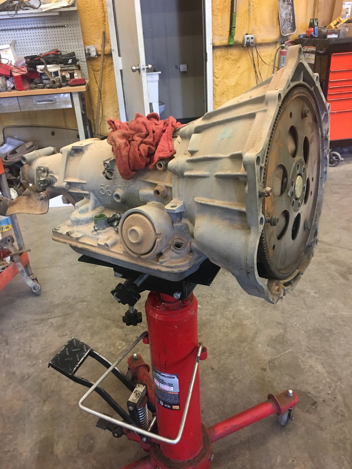

A few weeks ago I got the Shoenfeld headers on. The fitment on the passenger side was fine. Driver side... not so much. Had to grind on the inner frame rail, grind on the clam shell motor mount and beat the crap out of the second primary from the front to clear. These are not good ls swap headers and I don’t recommend them. One could argue that adapter plates could make a difference, but my engine can not go any further back without moving the firewall. If the engine moves forward, the second primary on the header will still not clear the clam shell motor mount unless a bigger notch is cut out a head of time. The only other solution would be to pick the engine up taller but then my 4l80e would hit the cab floor. Don’t buy the 1302LS1 headers from Schoenfeld... easy solution.

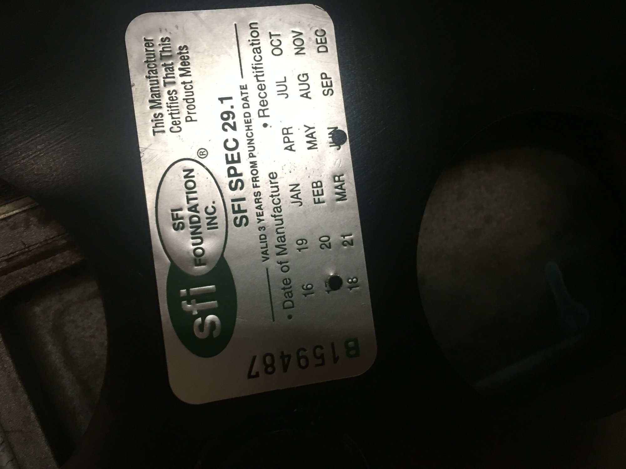

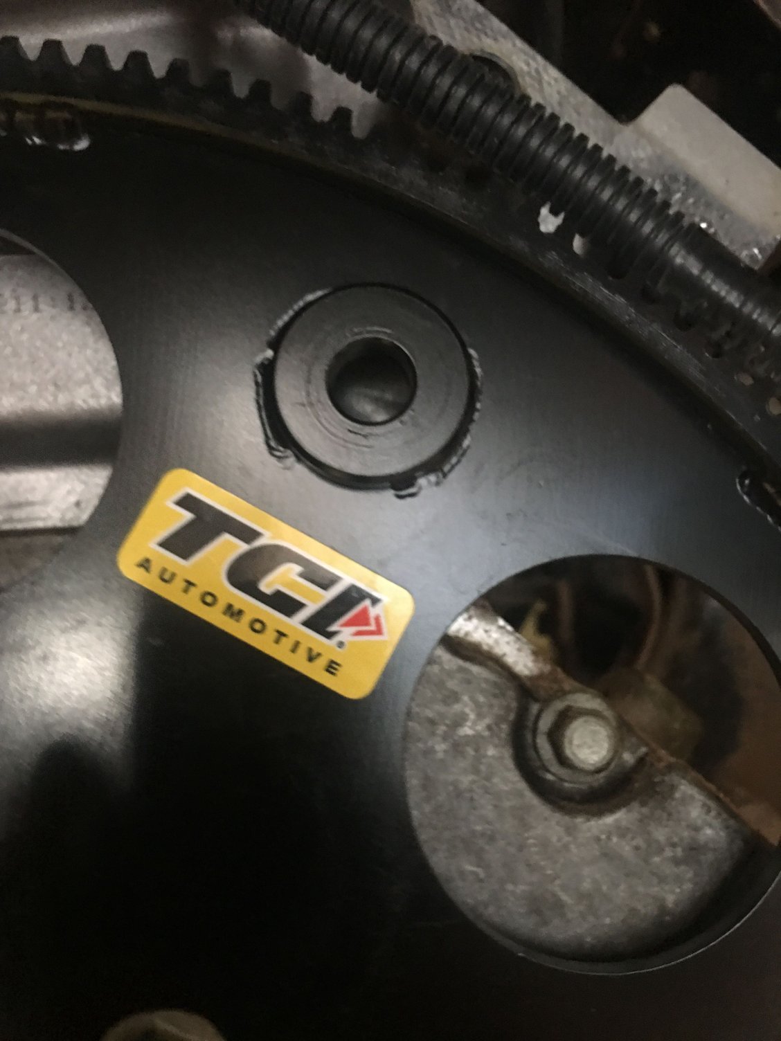

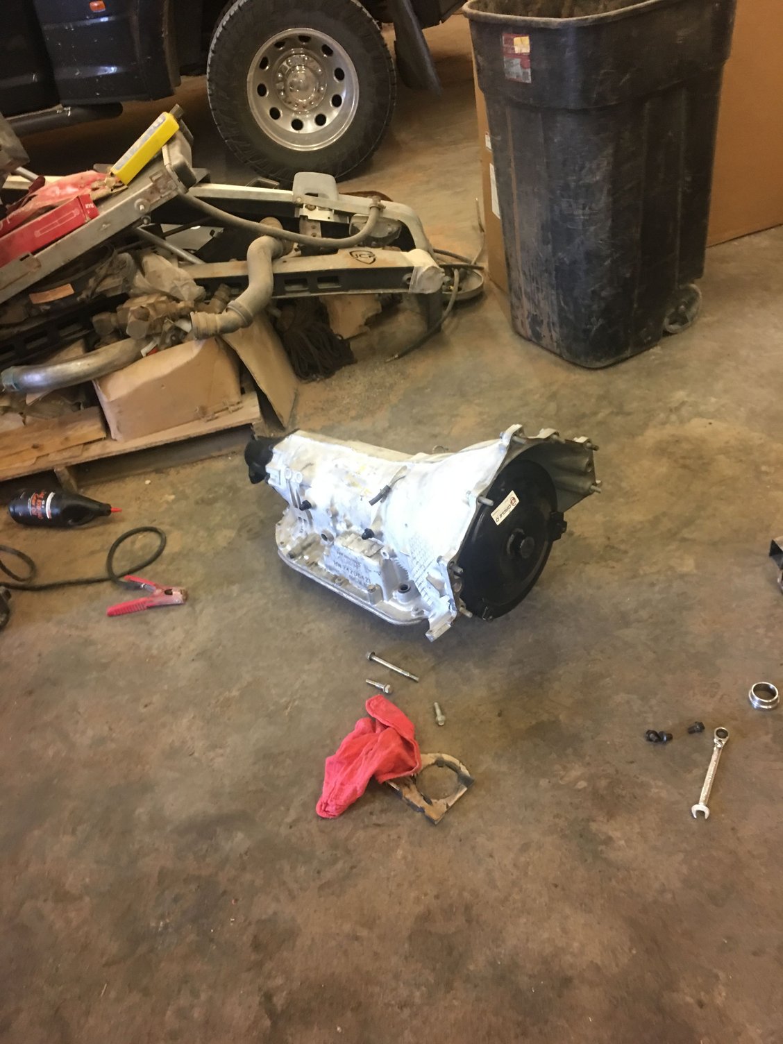

That’s right! I finally pulled the 60e out and got the 80e in! Along with the Circle D stall and TCI Flexplate. I tried using ARP torque convertor bolts but they didn’t fit without the heads of the bolts hitting bolts on the rear main seal cover(if that’s what it’s called). The goofy allen head bolts that came off the 60e wouldn’t work either, so I used the bolts that came with the flexplate from TCI.

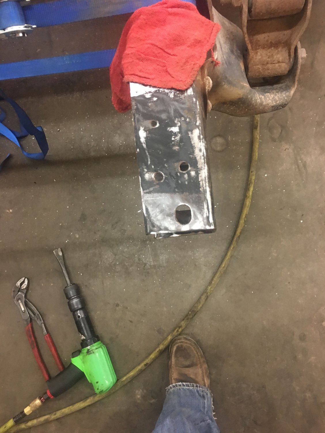

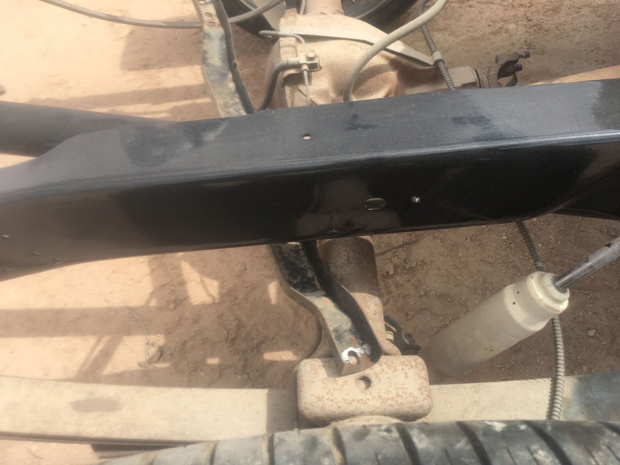

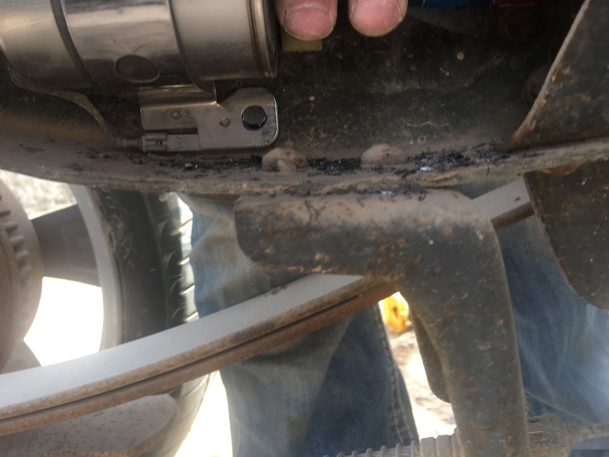

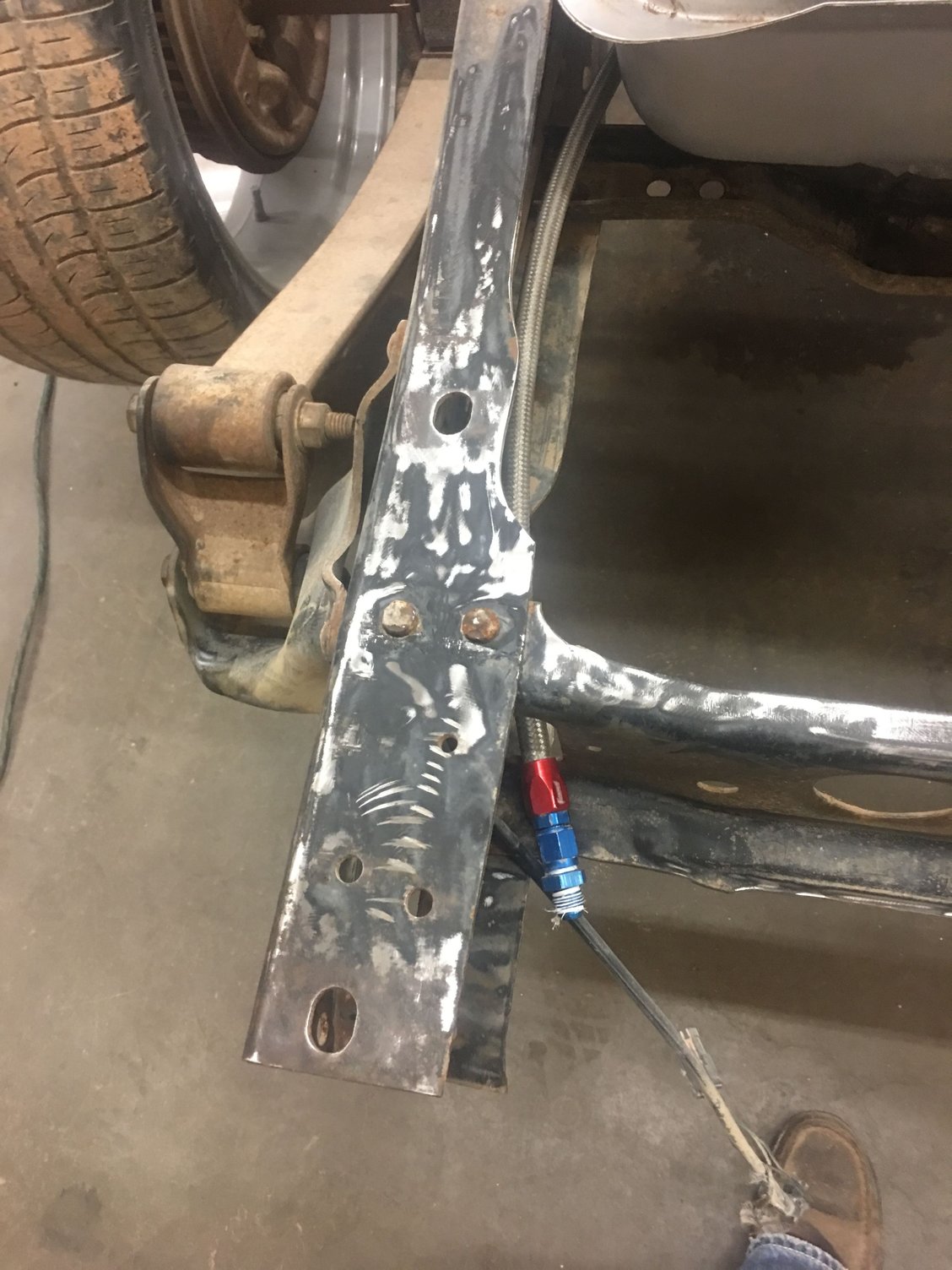

I also took an air hammer to the rivets on the frame rail to move the rear support and spare tire hanger. I have to move both of these in order to mount the K5 Blazer/Suburban fuel tank. I took the time to go ahead and paint as much of the rails as I could with POR15. Still have some more to do but so far it’s turning out great!

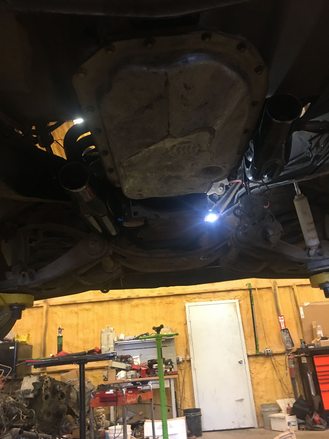

4l80e

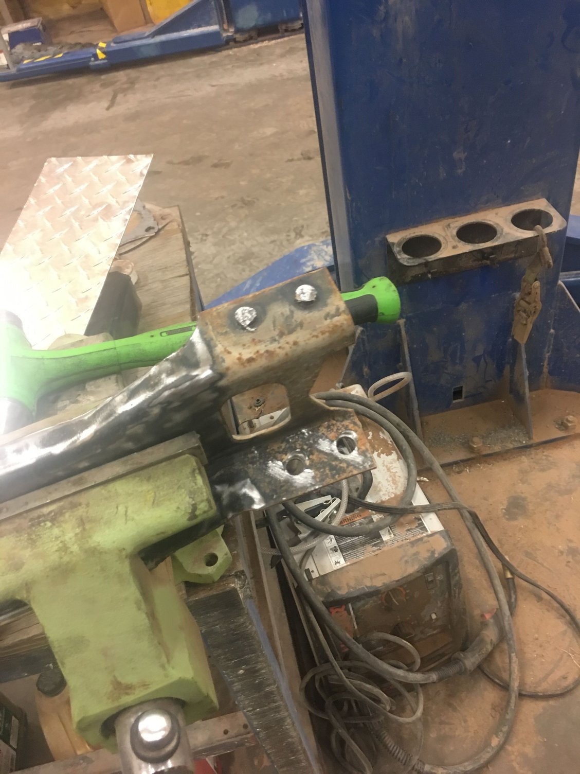

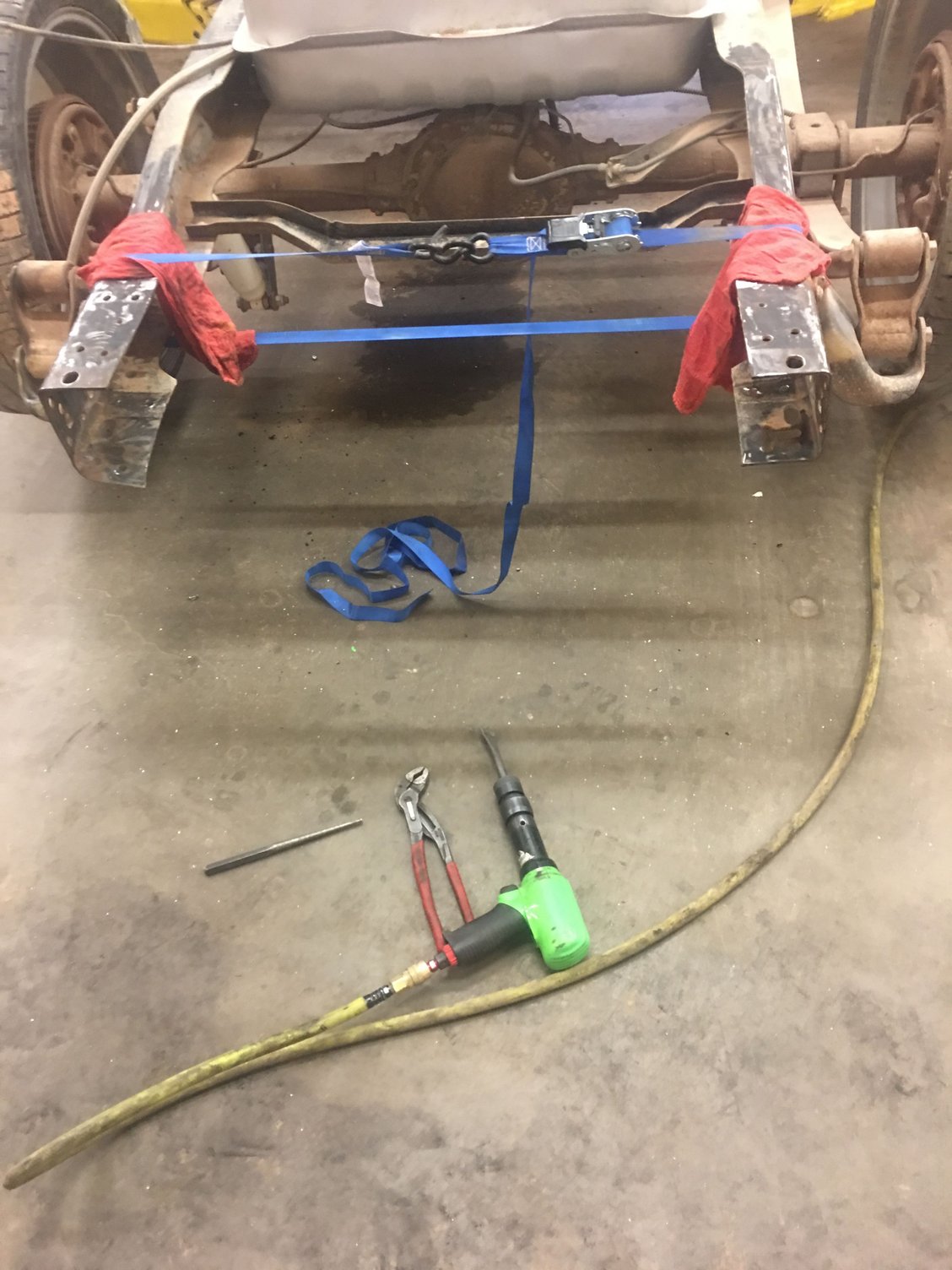

Knocking out rivets on the frame rails

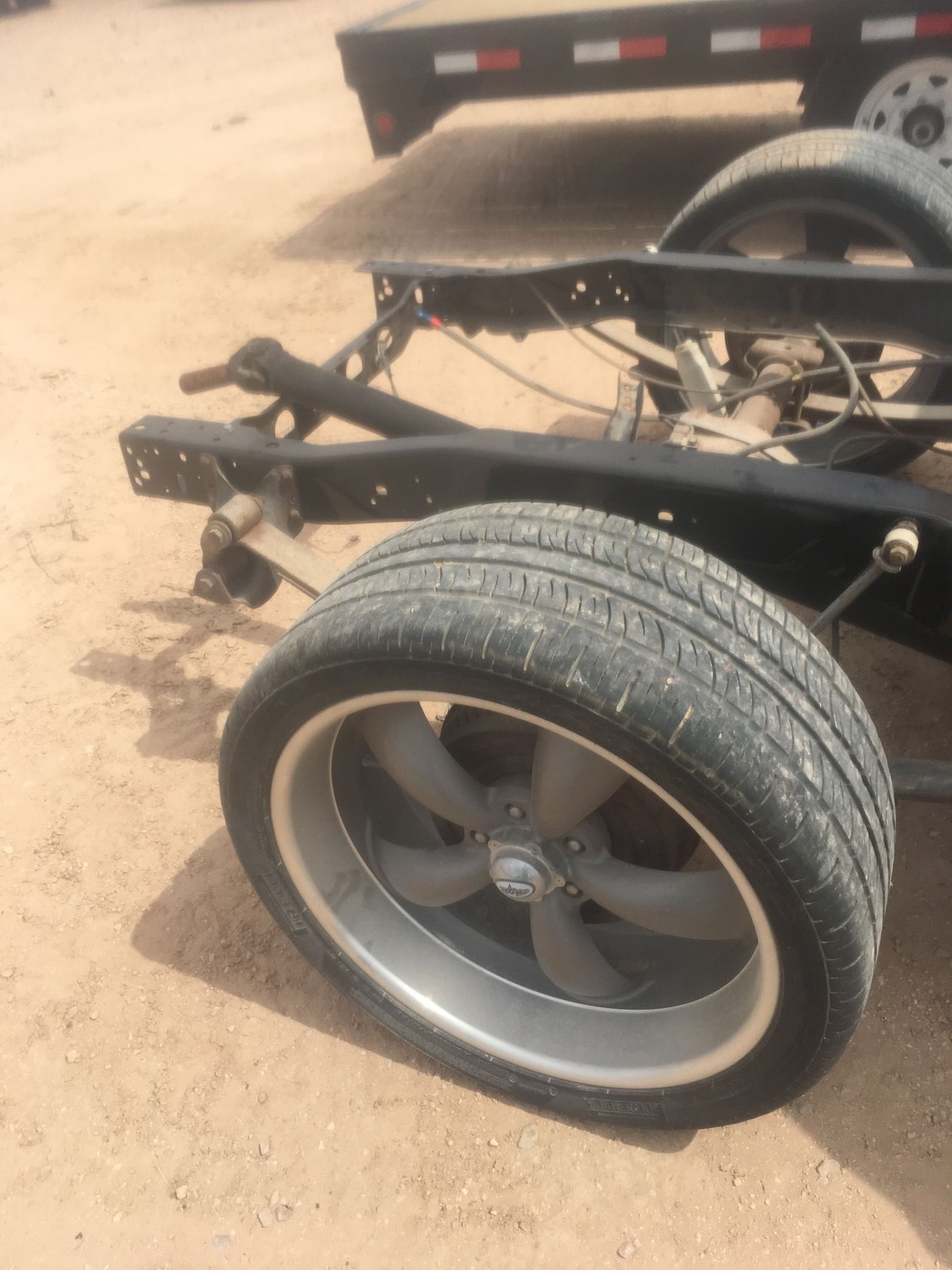

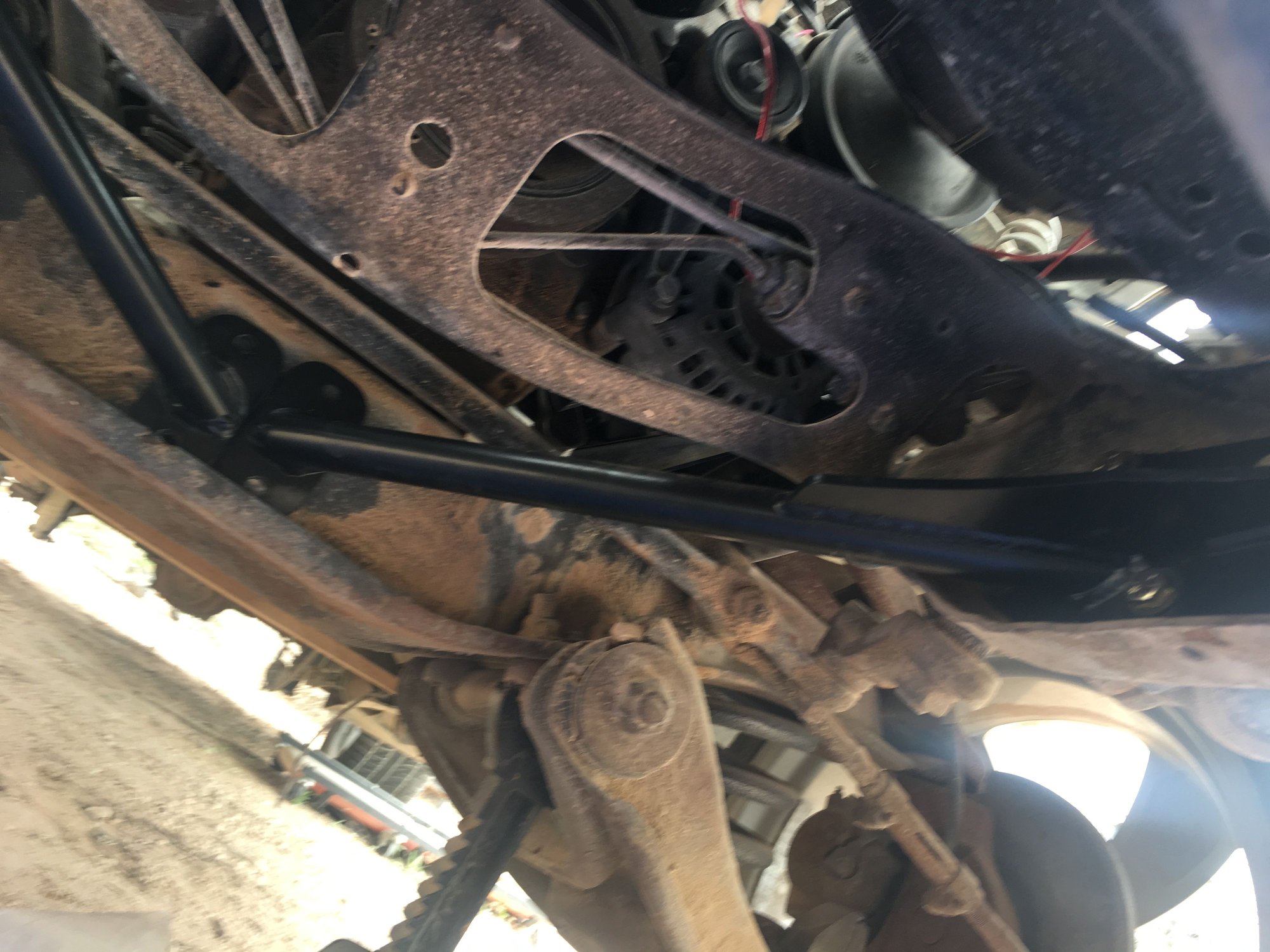

Covering the rails with POR15. The leaf springs, shackles, hangers, and mounts will all go away with the 4link. So I am working around them for now.
