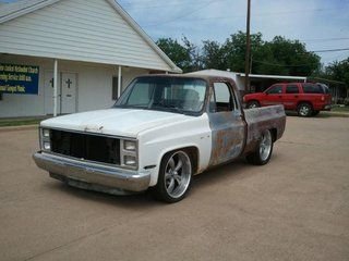

Hello Everyone, I am on several forums but thought I would come over for some maybe different member input considering my truck is LS Swapped. I have this truck for 16 years, need paint in the worst way. But so far the truck as of now has a '98 Fbody ls1/4l60e going to be an 80e real soon. It's not completely swapped and running. I'll try to update what I can remember for the parts list and stuff I used.

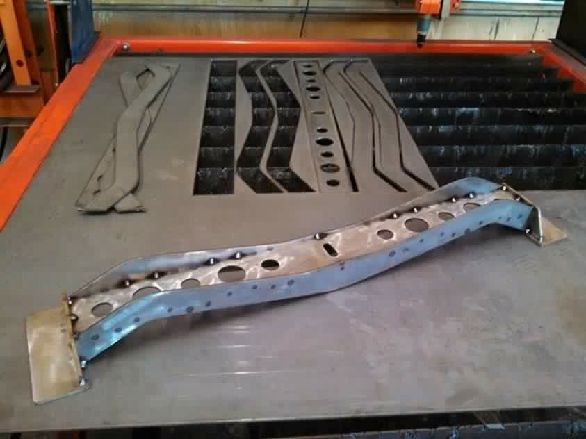

The motormounts and transmission crossmember came from TejasSteelWorks.

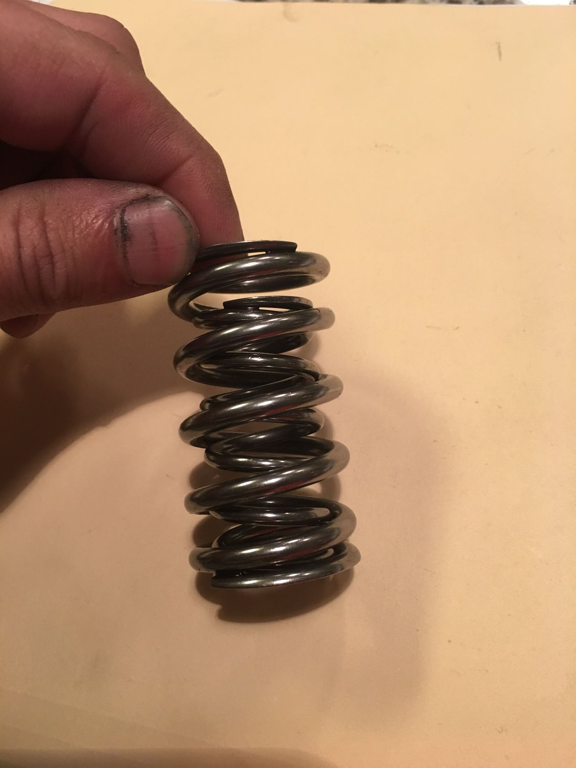

Lunati double valve springs were also installed.

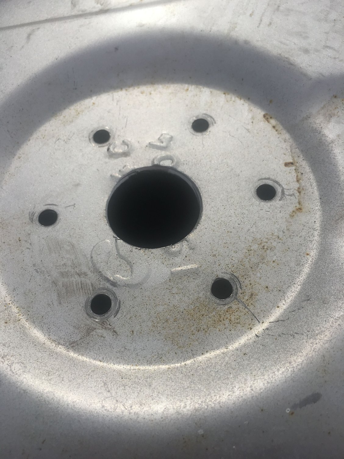

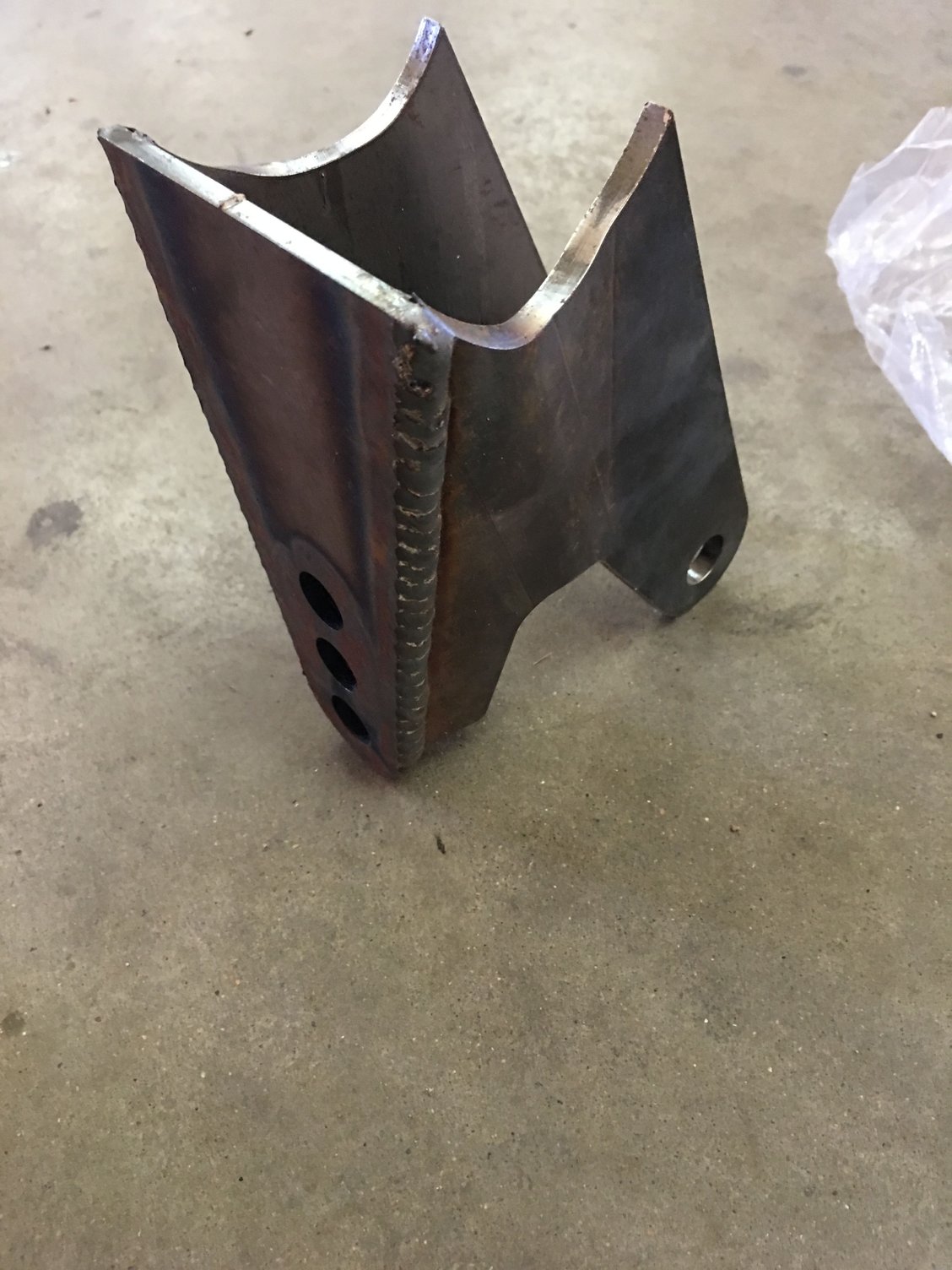

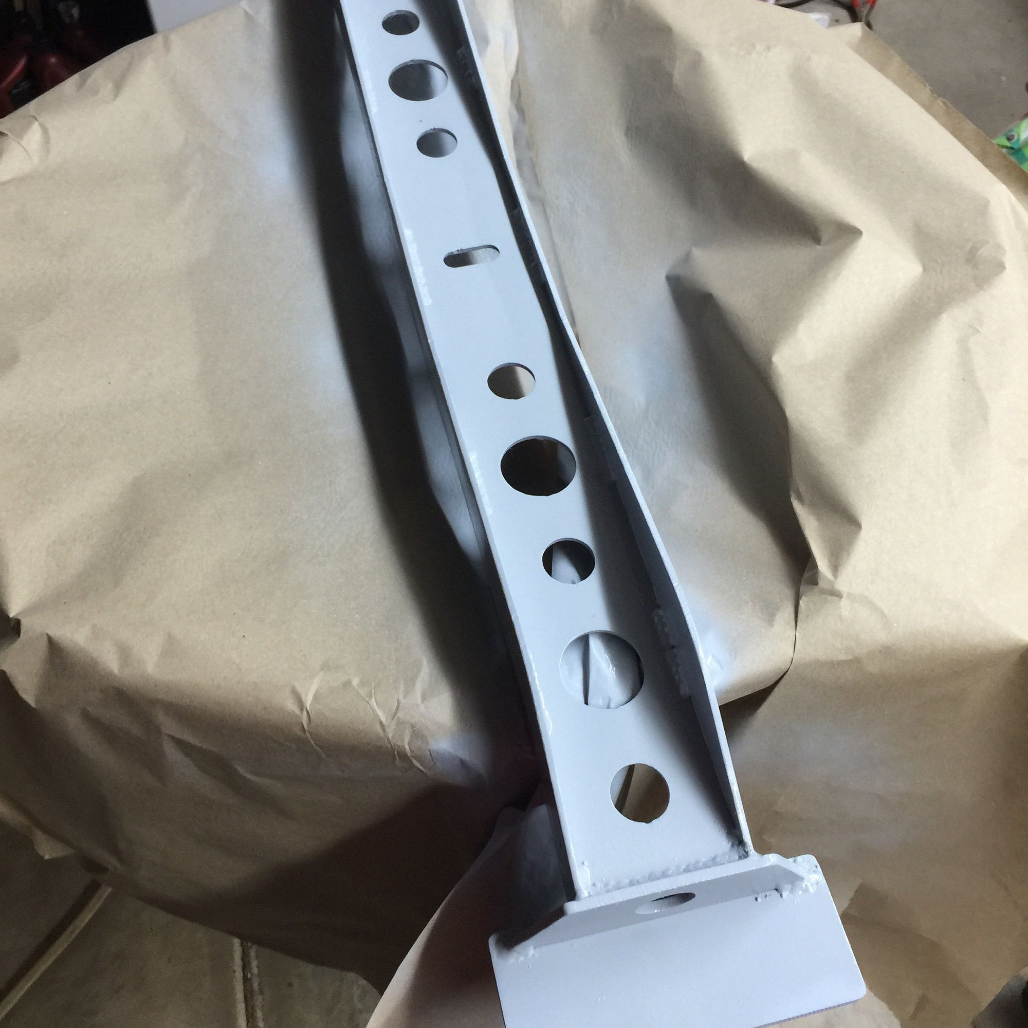

Transmission cross memeber
Transmission cross member

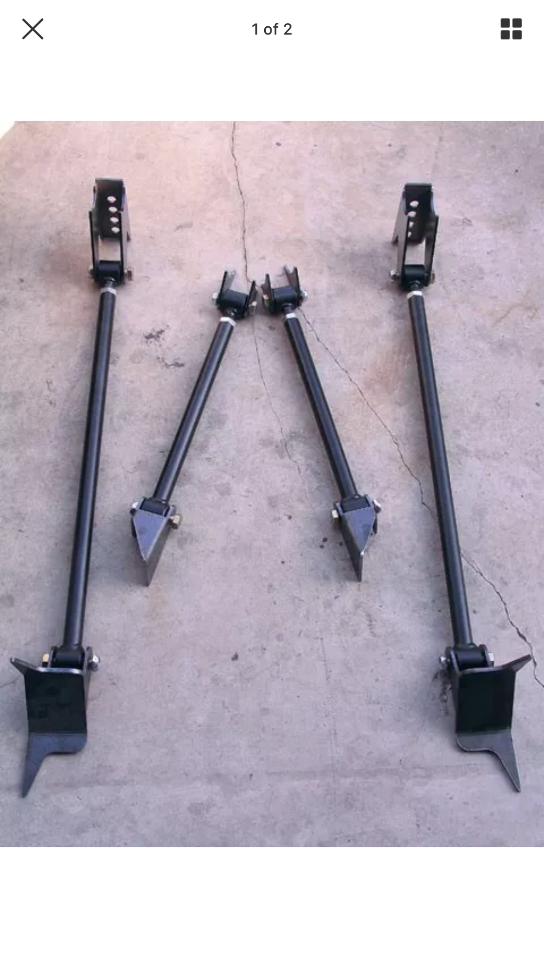

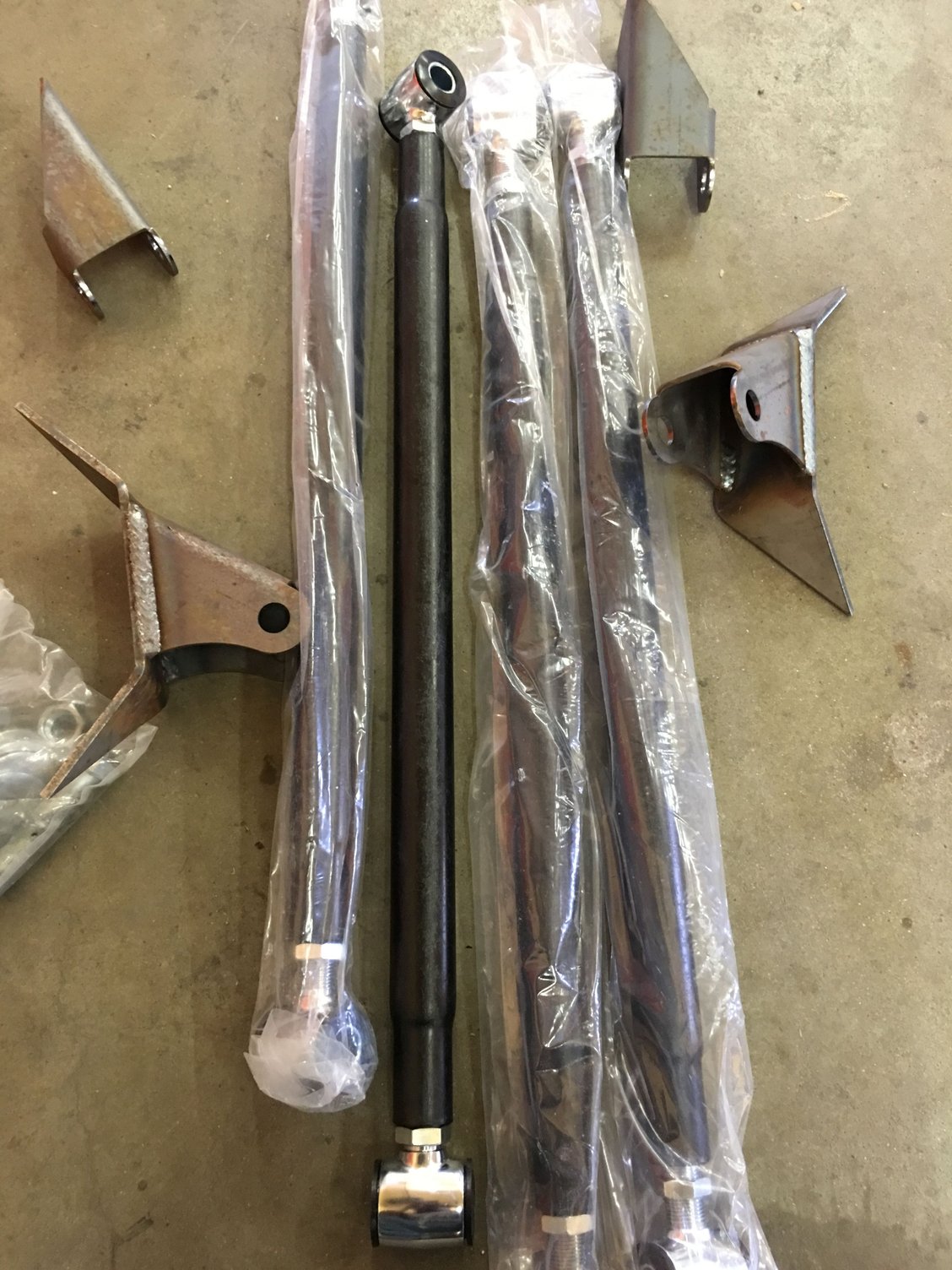

Parallel 4link

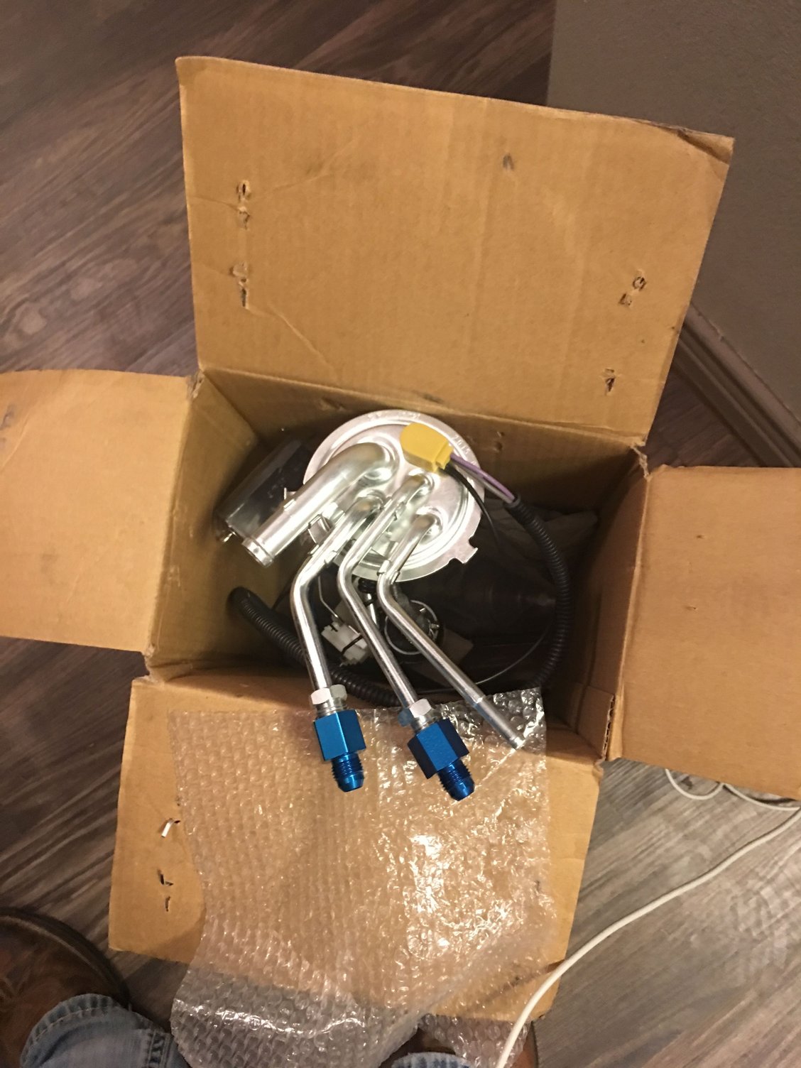

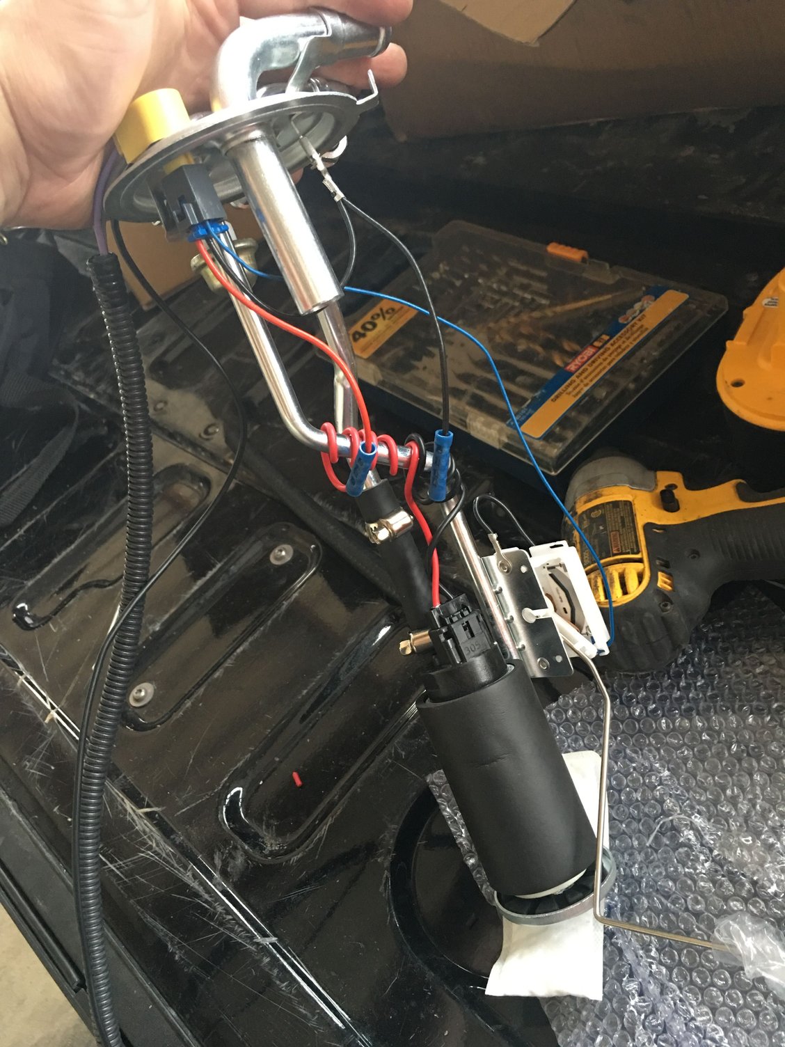

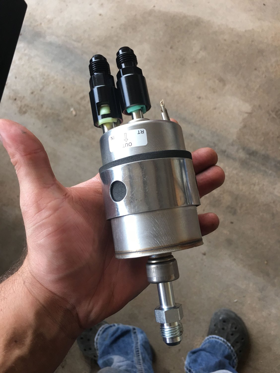

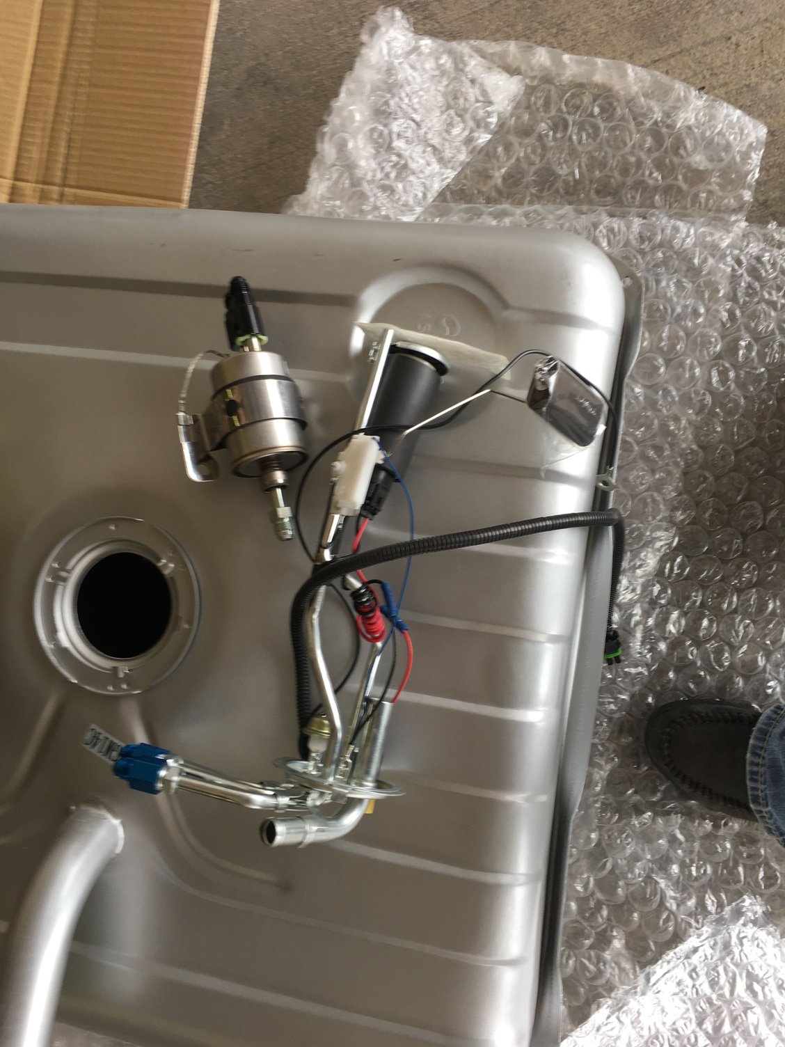

Corvette filter / regulator
Walbro 255
Fittings to sending unit
Metric to -6AN

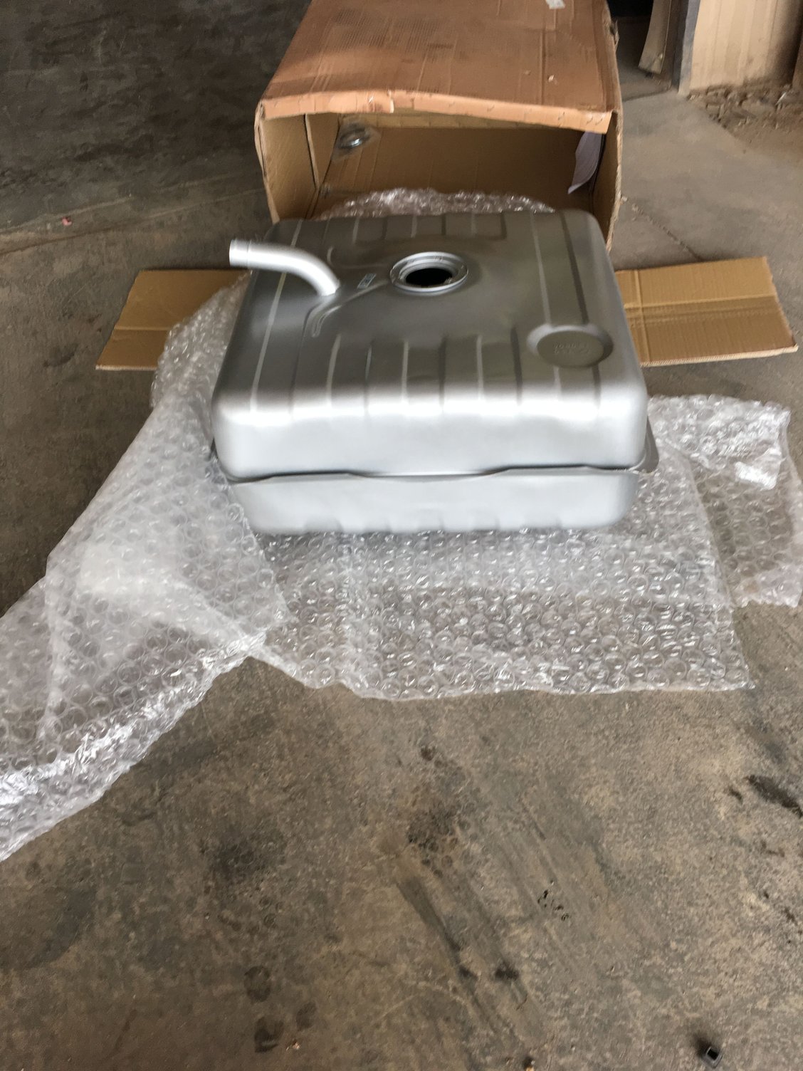

31 gallon k5/suburban tank

also just my .02 but please reconsider using the corvette filter regulator.
everyone I know IRL, including myself that's tried to use them ends up just doing a return set up

I have had good luck with the Vett regulator, on N/A and turbo setups

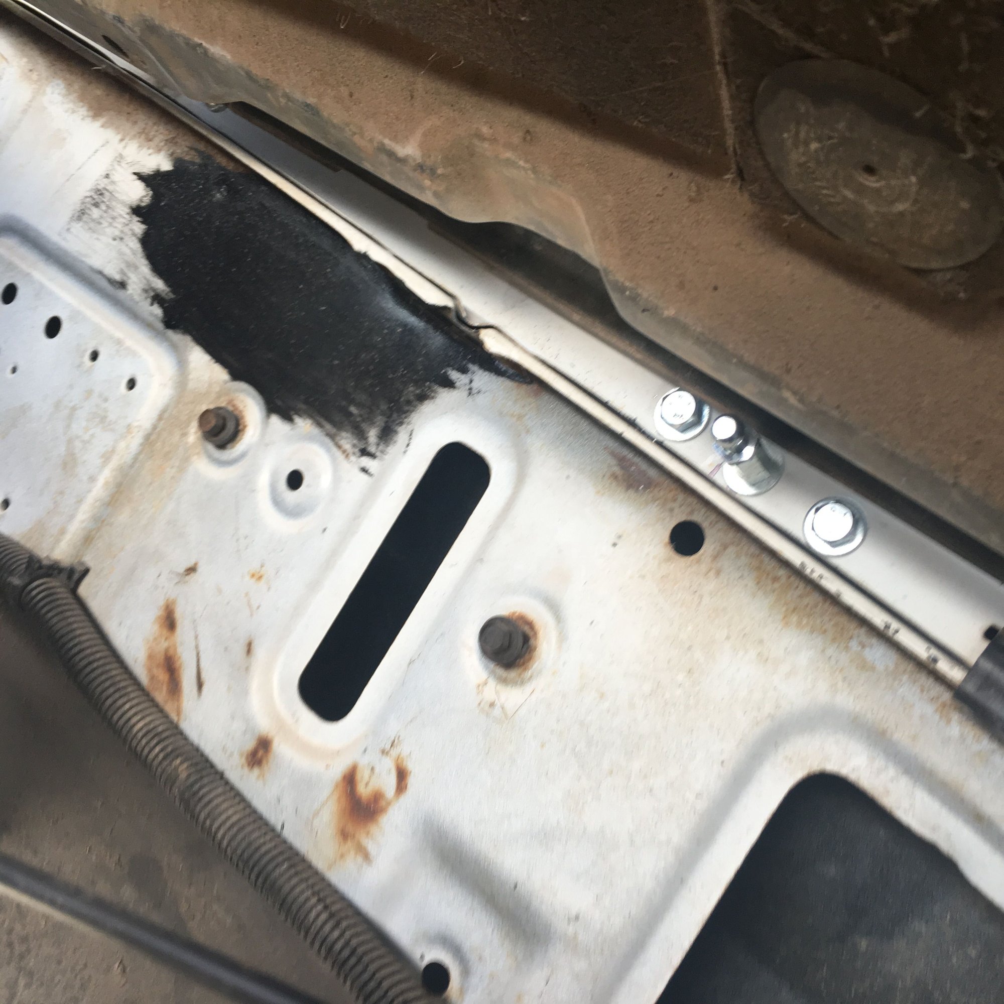

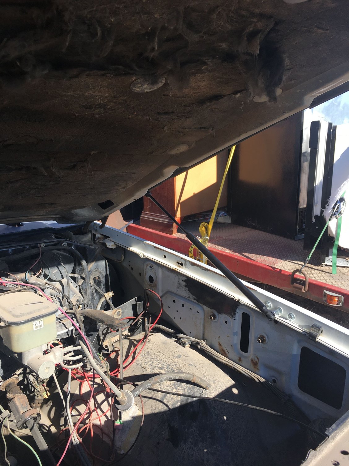

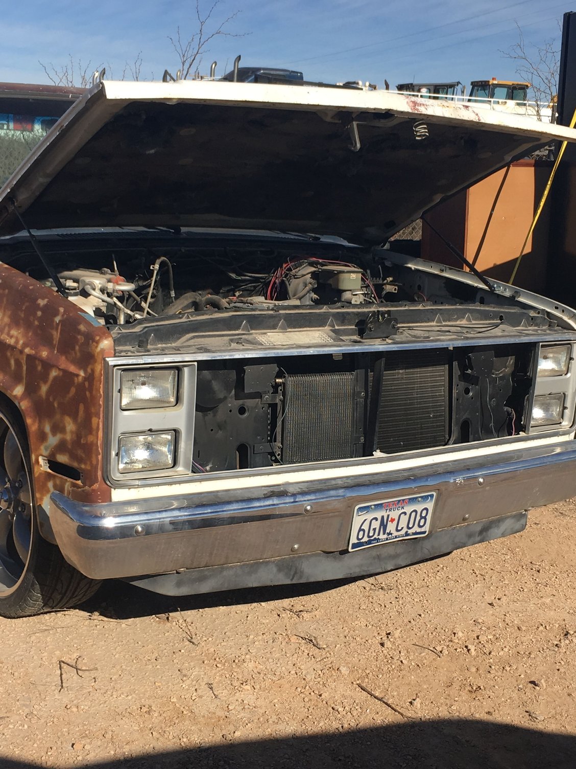

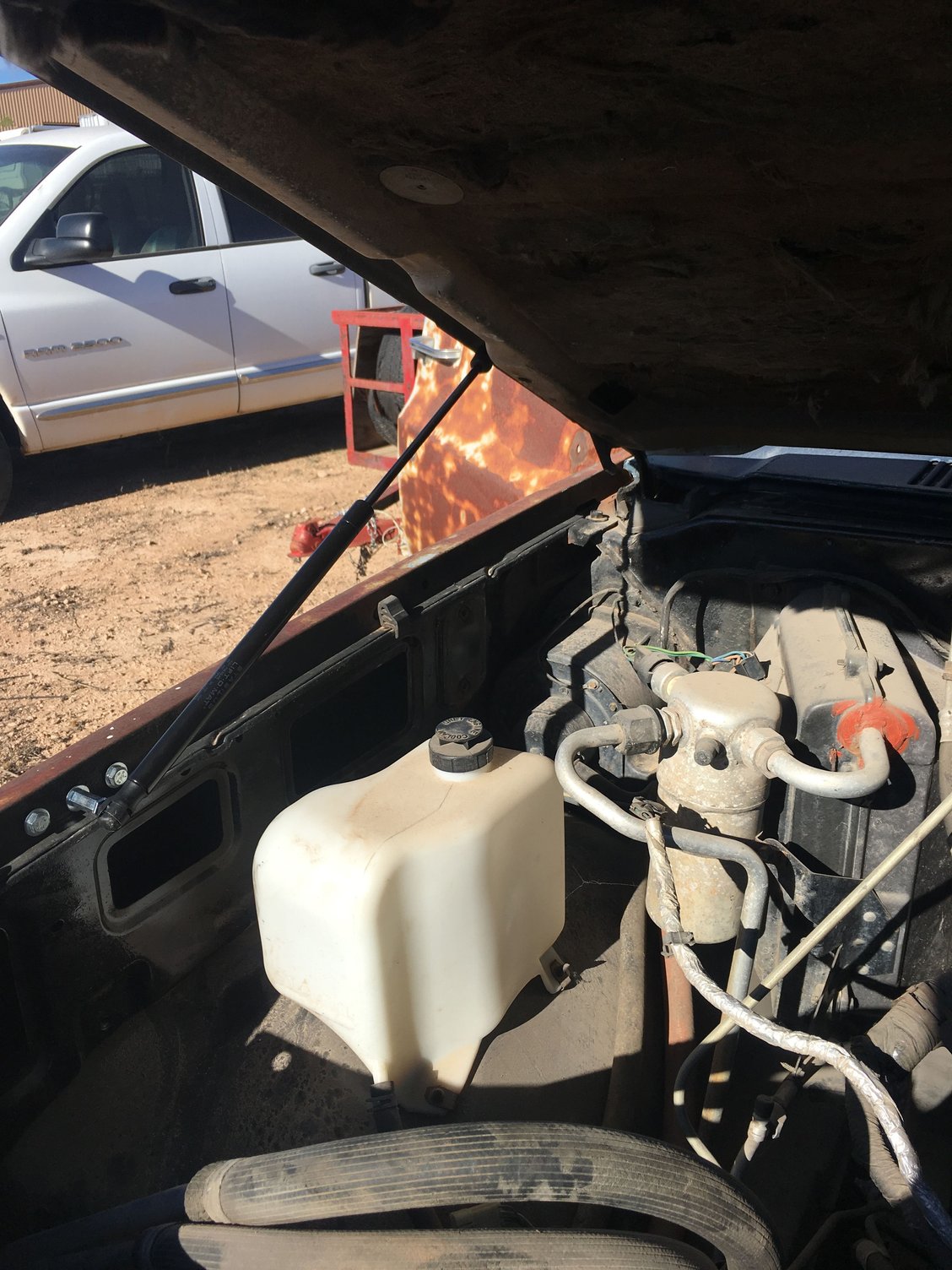

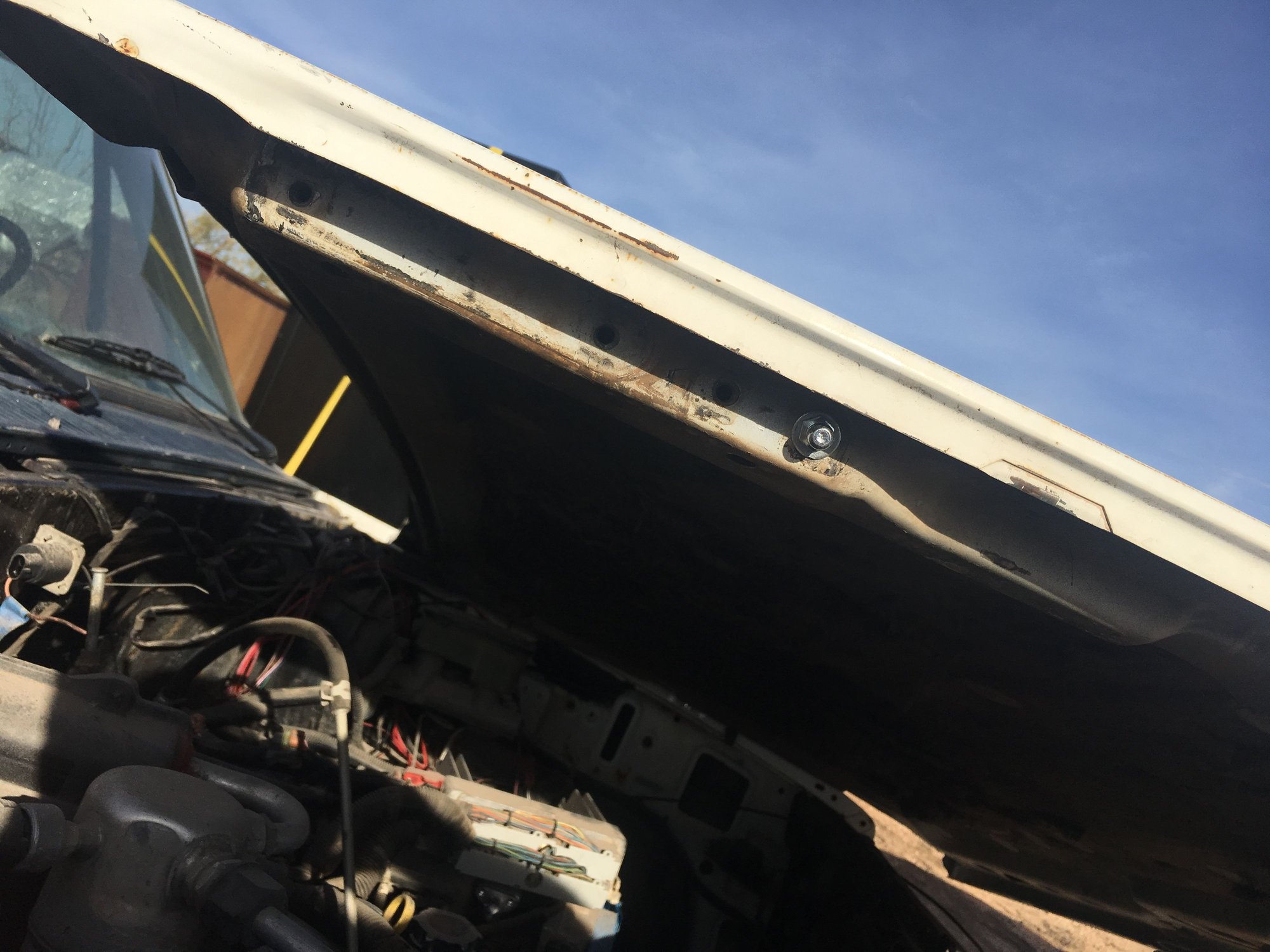

Ditched the spring style hood hinges and installed a set of Wamrodz hood struts!
Right inner fender strut mount
Right strut mount for the hood
left fender strut mount
Thanks for the comments guys. If I change fuel rails in the future, I will buy more fuel line and run a different setup, for now I'm doing N/A, no turbo. Haha Ready to drive it. I have a '66 Chevy II 2 door hardtop I'll be doing a swap on soon so I'm going somewhat simple.

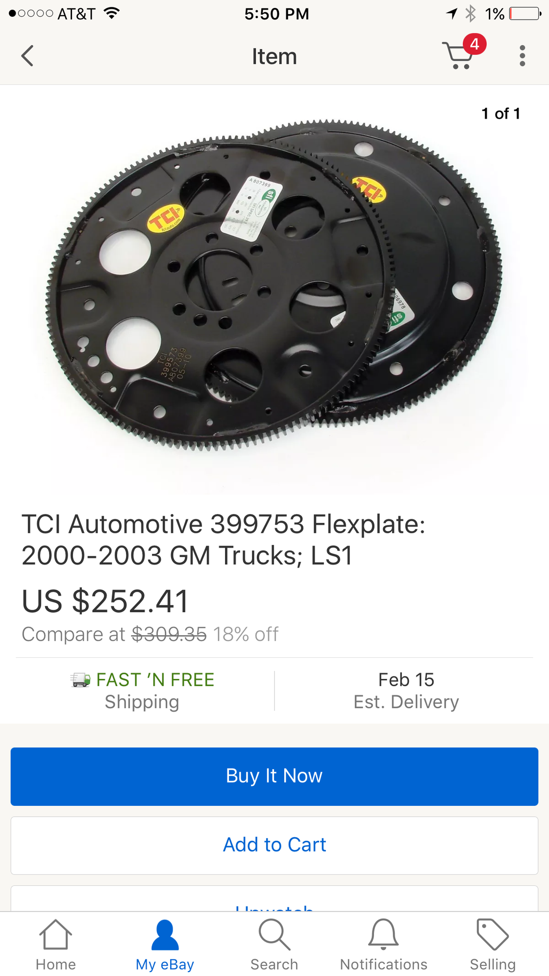

Ordered a flexplate and stall convertor. Ready to do my 80e swap now! Torque convertor is coming from Circle D 4l80e 278mm 3000-3200rpm.

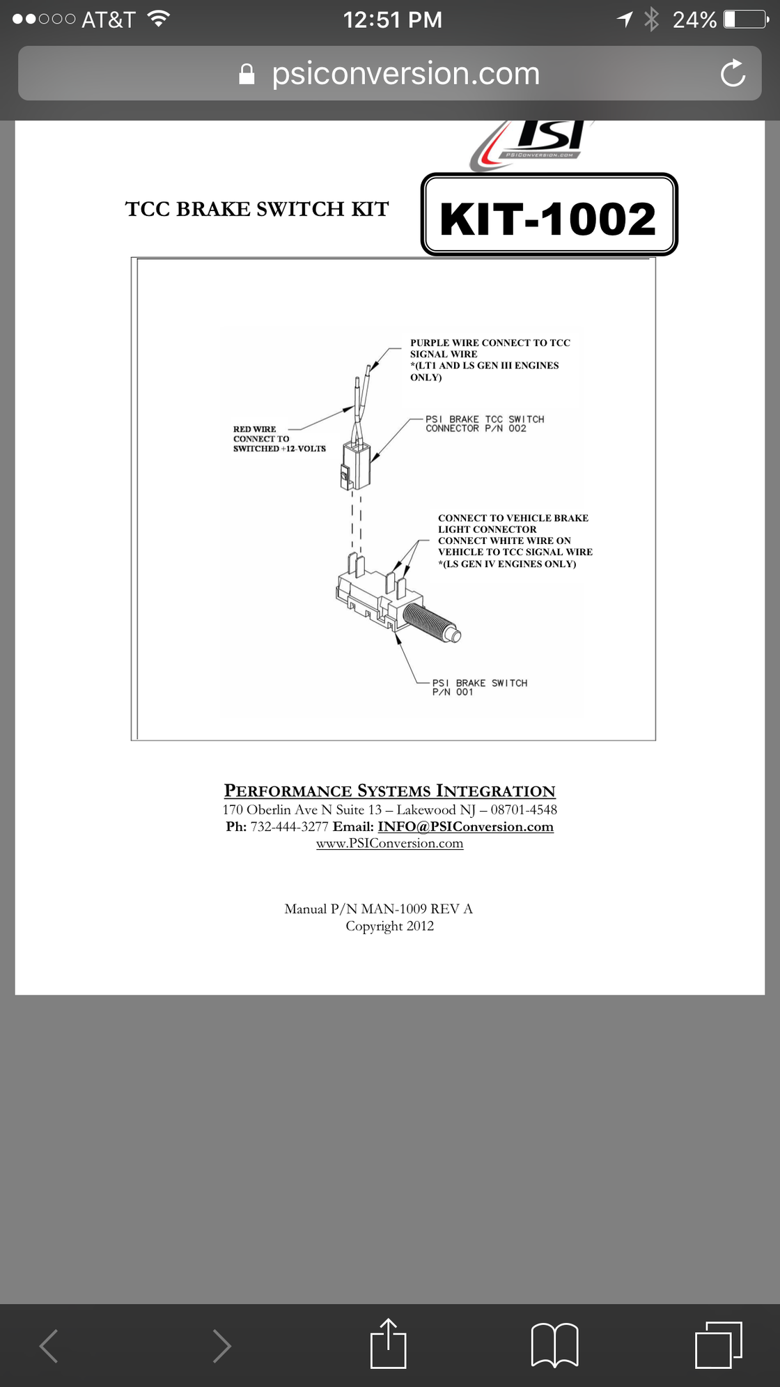

Ordered this today. Since PSIConversion failed to mention it the day I ordered their harness. Nice tech support on that one😡

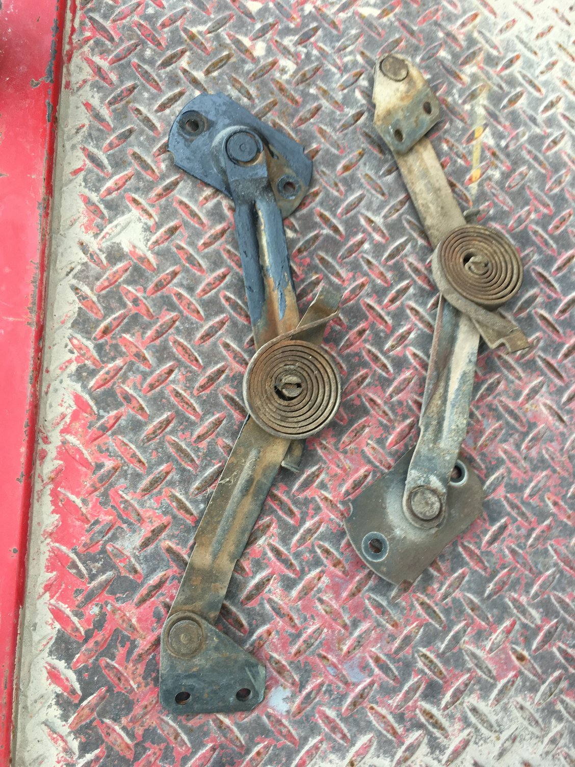

Junk hood hinges

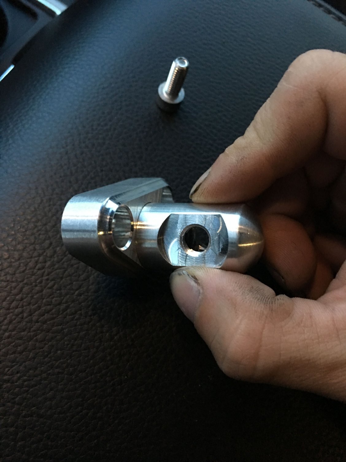

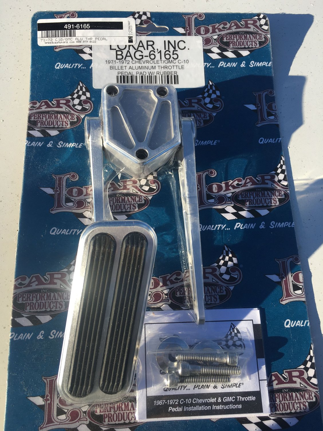

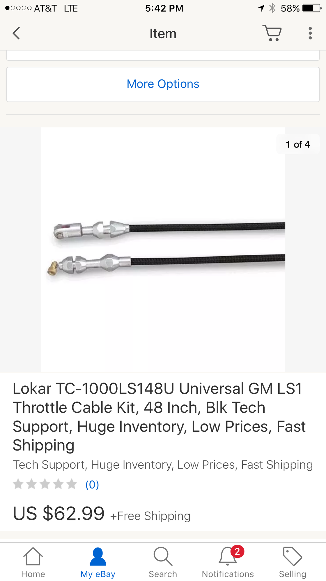

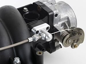

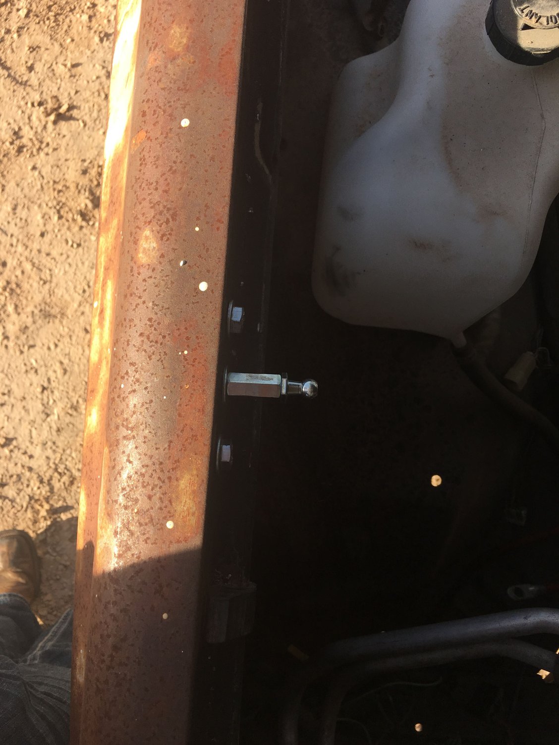

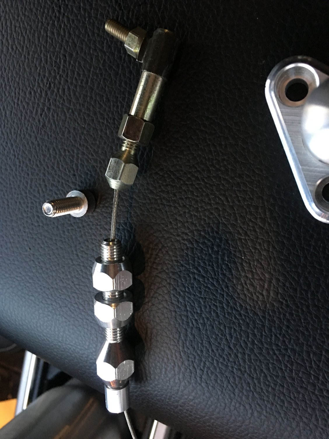

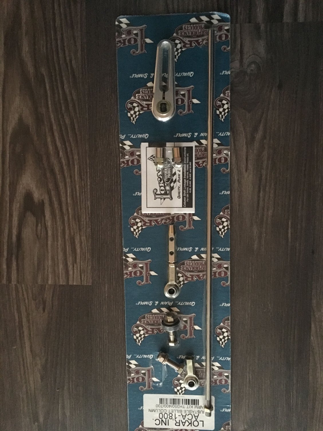

Lokar throttle cable mount
Throttle cable mount part #
Used to pl

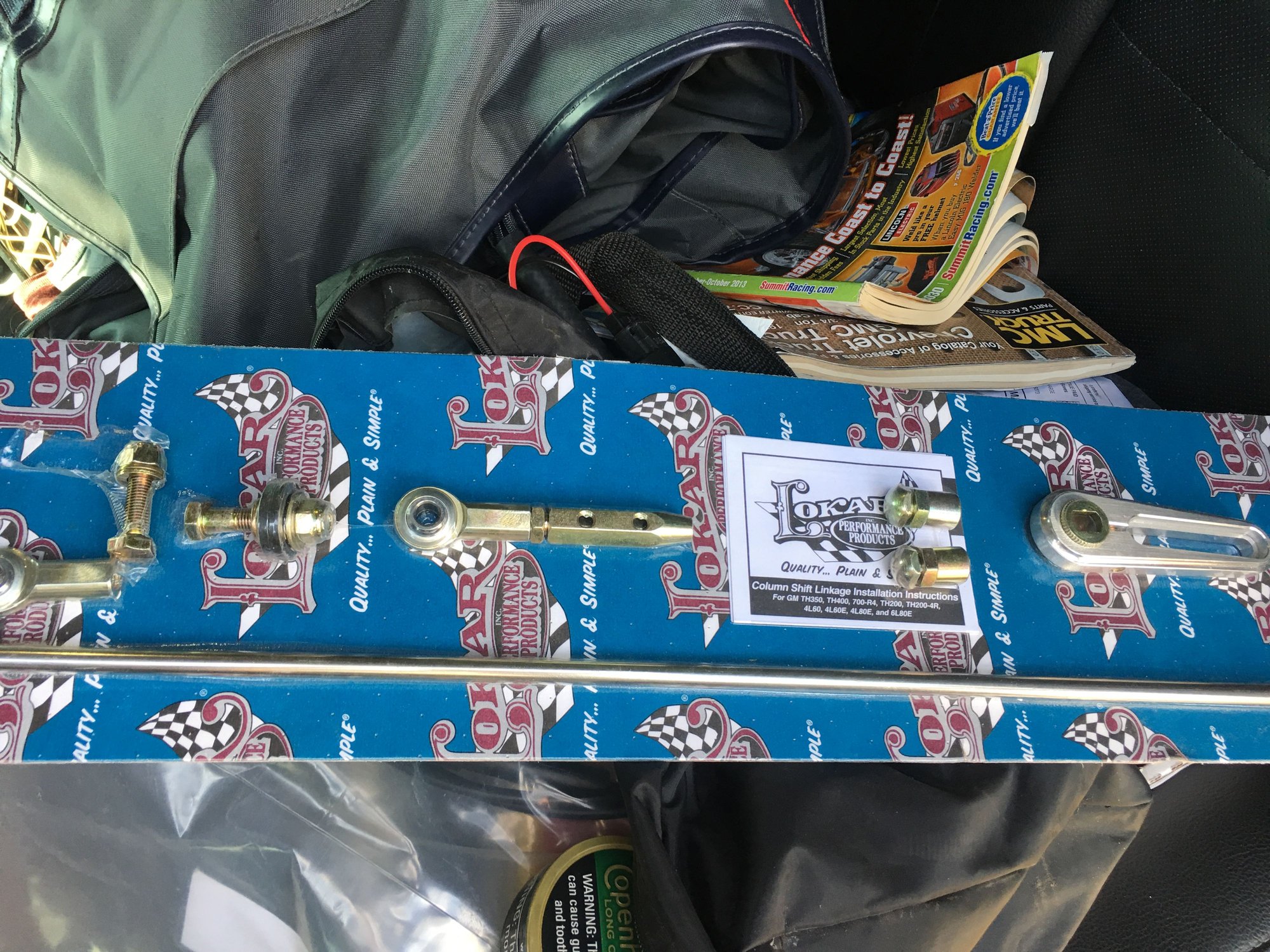

Lokar column shifter linkage
Lokar 48" ls1 throttle cable

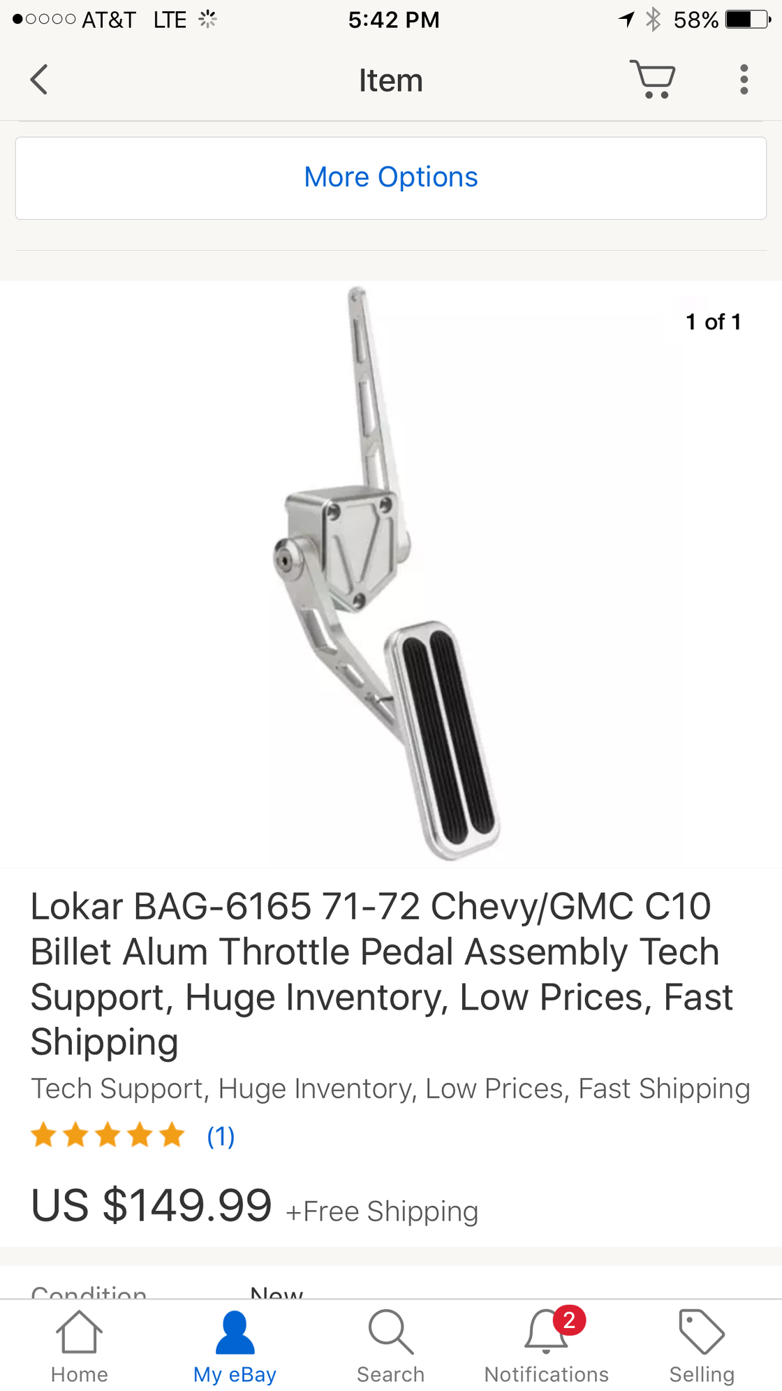

Lokar 71-72 Billet throttle pedal

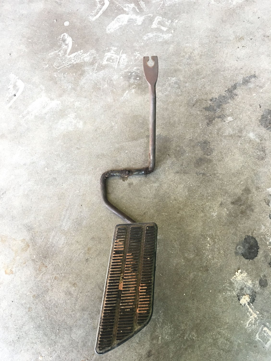

Out with the old
In with the new
Old Feb 11, 2017 | 12:09 AM
lowchevytrucks8503's Avatar
Joined: Jul 2009
Posts: 242
On a side note- I had to go to ebay for the best prices on my Lokar parts.... if anyone at Lokar sees this- I'm gonna want some stock shares and a way to purchase direct for the stuff I'll be putting on my Chevy II haha. Halfway kidding. So far, I have 0 complaints about the stuff I am using from Lokar. The price is up there, but these are solid quality parts. The pedal is to a 71-72 C10. But bolts up in the squarebodies just fine. Was a hard decision between going with the solid black or billet pedal assembly. Don't be shocked if I swap it out later just to see which I like best lol.

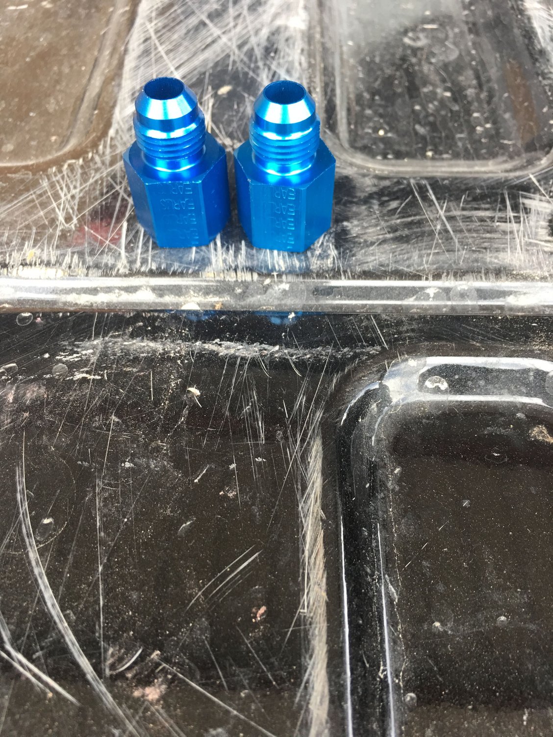

I try to stick with brands that I can order as much from as possible. That being said, the tank and sending unit are spectra premium. Tanks Inc, Boyd's Welding, & Rick's Tanks out of El Paso Texas make some really nice tanks for under the beds of the C10's and many more vehicles. But I went cheap in the $250 range vs $600-$1200. I will have over $500 in -6AN fuel line, the corvette filter/regulator, Walbro 255 fuel pump, Spectra Premium sending unit & fuel tank, and all the fittings in between. The fittings are a mixture of ICTBillet for the pushlock fittings & the two metric to -6AN fittings on the sending unit are from Earl's.

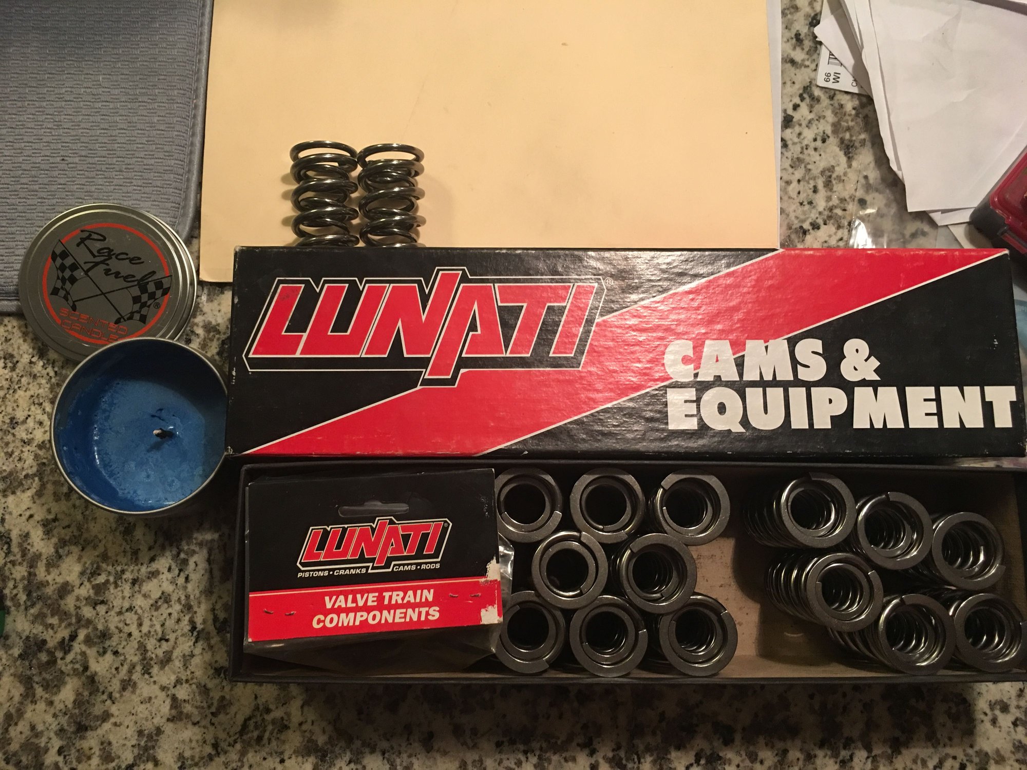

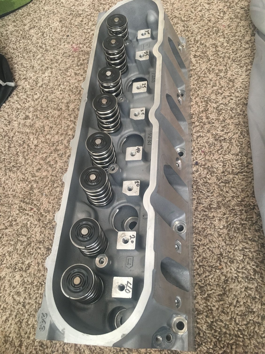

Spent $450 at a local machine shop. The heads were cleaned up, two valves were changed, and he installed my lunati double valve springs that I purchased last year. Seems like I was over charged IMO. Here they are:

Old Feb 17, 2017 | 02:12 AM
Jimbo1367's Avatar
Joined: Jul 2009
Posts: 8,032
Likes: 661
Those heads look really good. Really good. The springs looks at home, LOL. IS this some sort of porting I see?
Honestly, I'm not sure how much porting he did. But they should do well enough on a mostly stock ls1 with a head/cam swap.

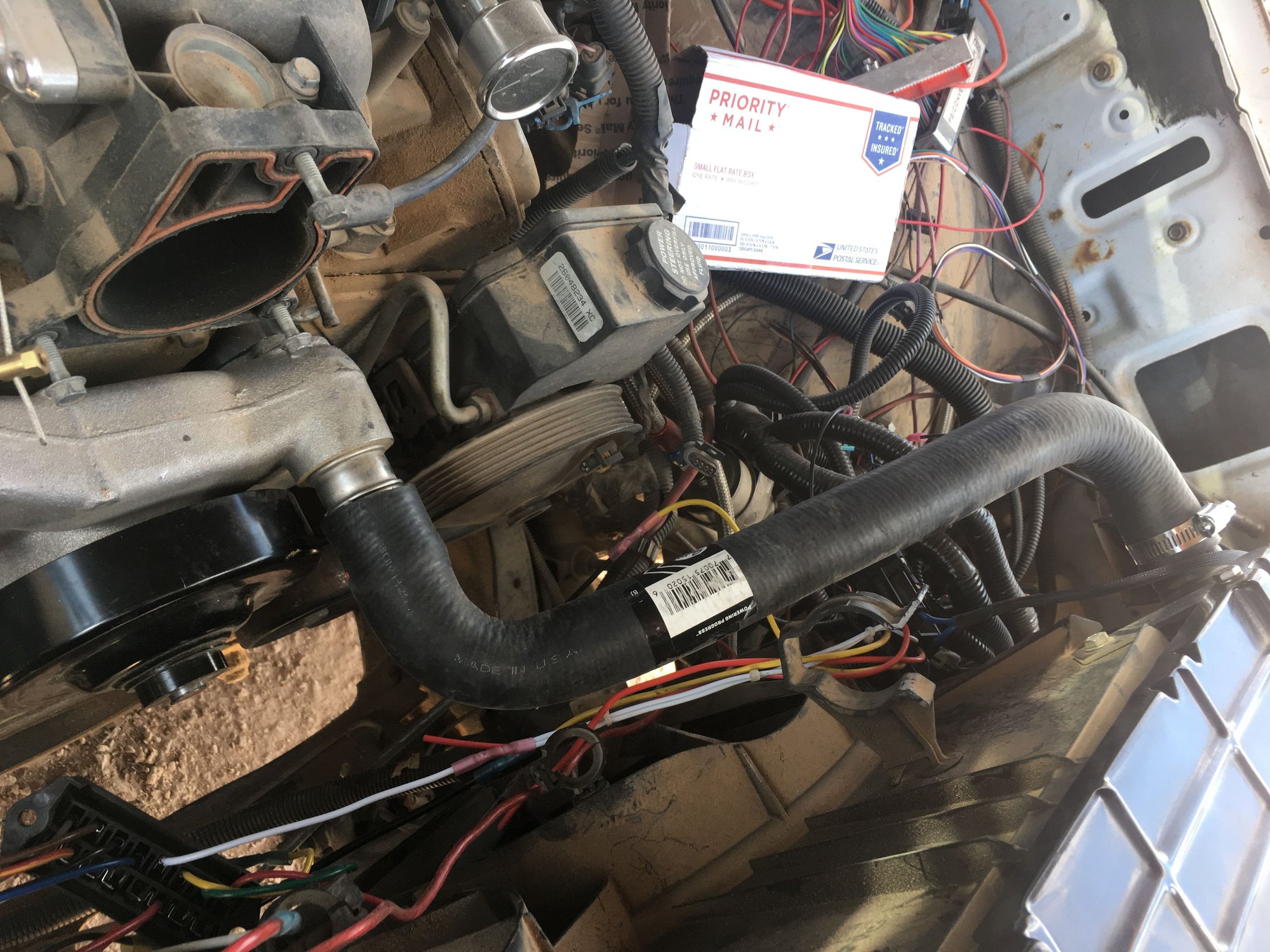

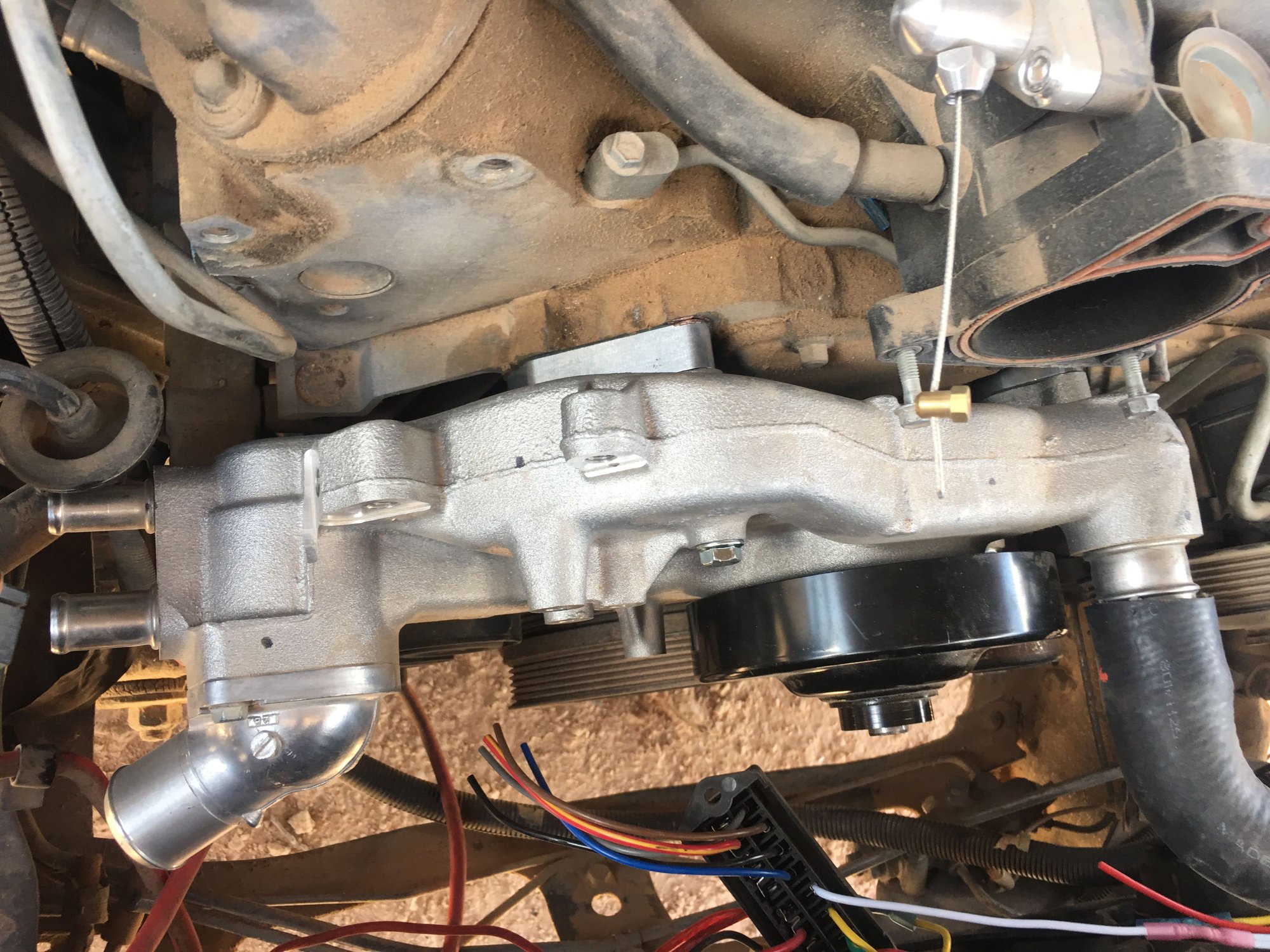

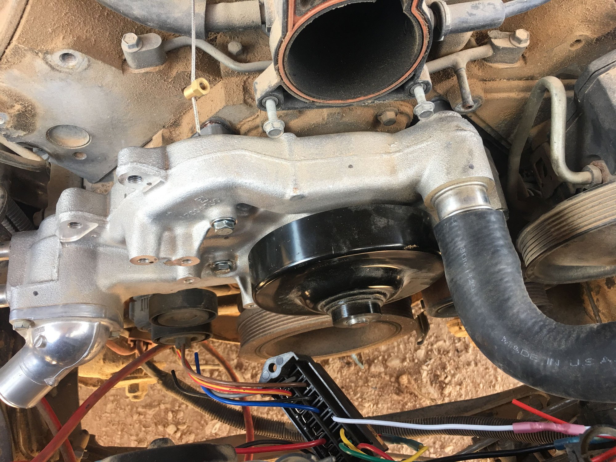

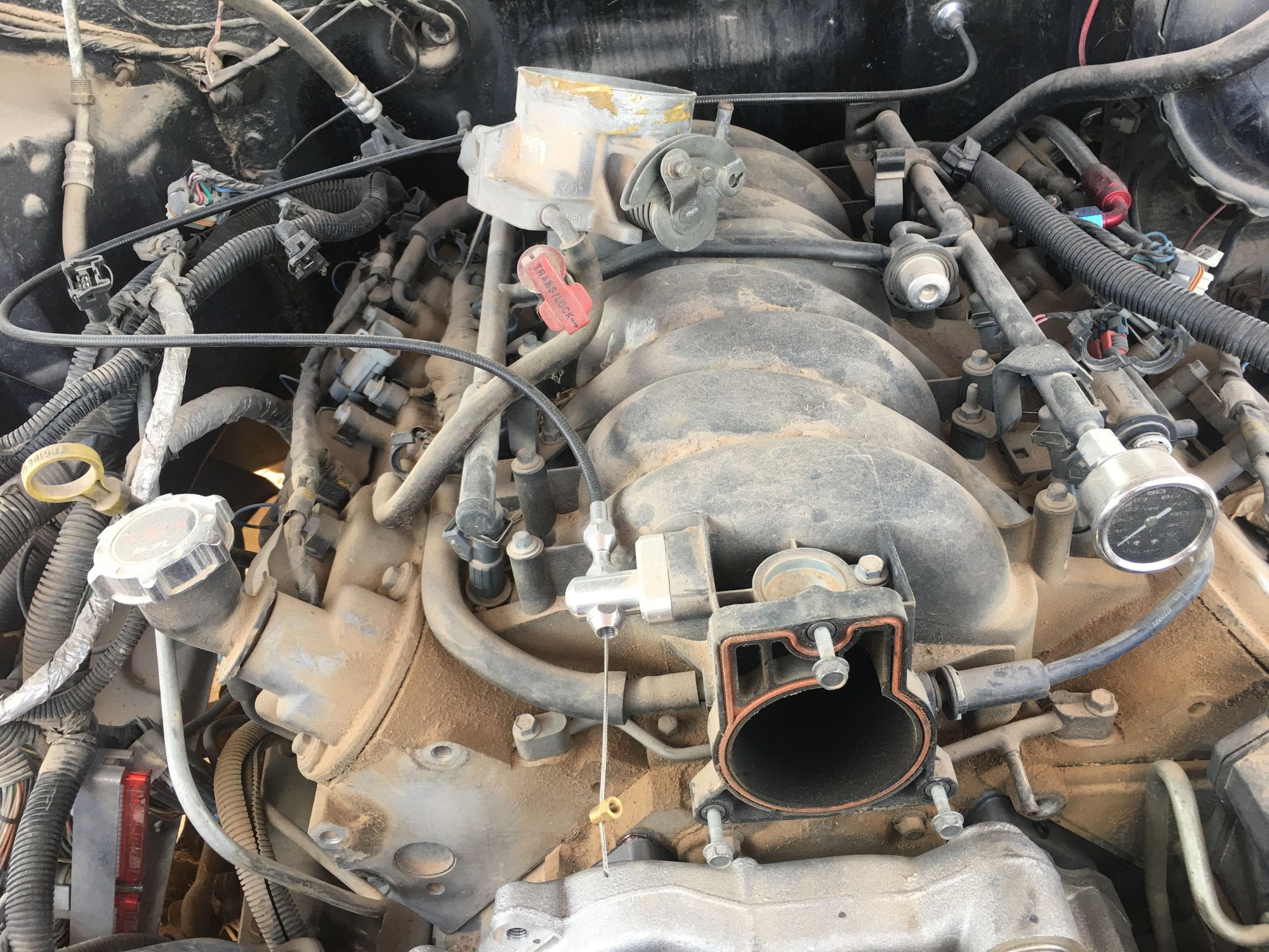

Awhile back I thought about making a different water pump neck so i would not have to have the upper radiator hose go across my efans. So I picked up an LS3 crate motor water pump and it didn't line up with the fbody pulley's of course. So I tried out some 3/4" billet spacers for the water pump. They came from ICTbillet. Here is the installed result.
Please excuse the mess. The hose is from a 2010+ Camaro
still have to finish the wiring and throttle cable.

Please don't use the black AN adapters that have the plastic clips on them (the ones on your Corvette filter/regulator). They will burn your truck to the ground!

I used the other AN style, newer style from Russell on the rail. Not sure if you saw it, but that's why I did. I figure if it has a small leak on the filter, I'll notice since it will be on the frame rail. If it's on the fuel rail tho... I may not notice until it's too late. I know lots of people have used the old style but I was leary of them as well. I will most likely replace those on the filter regulator with the new style from Russell like the one I used on the fuel rail in the next couple of weeks.

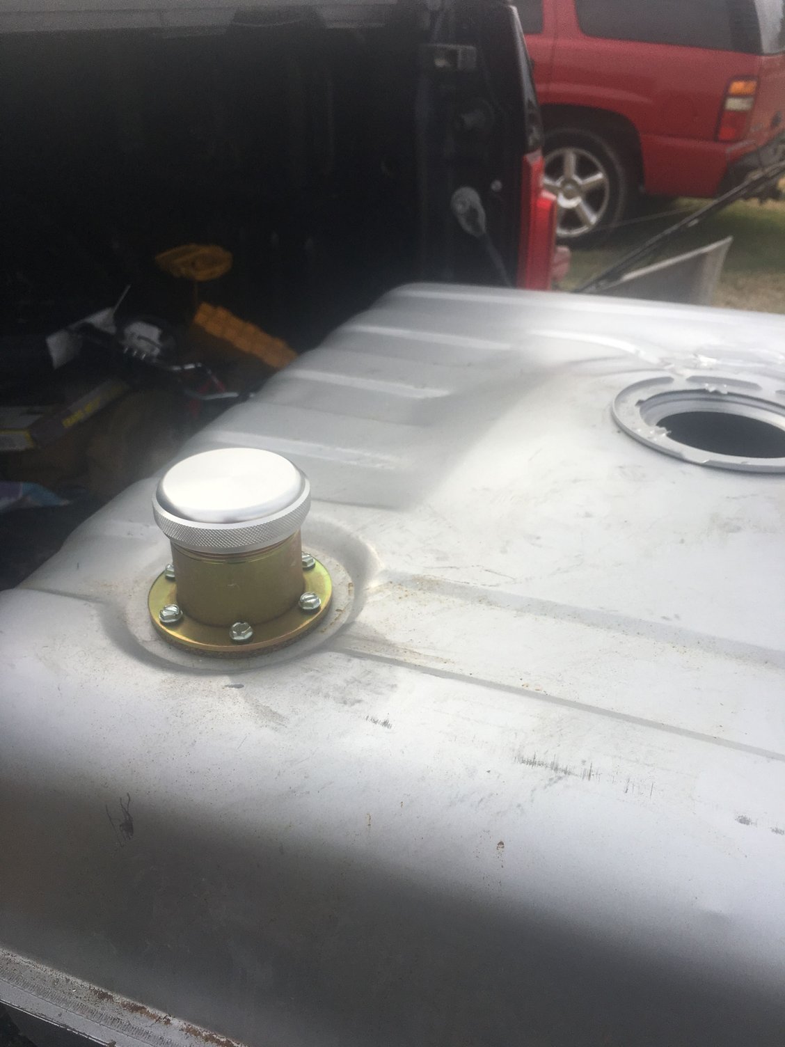

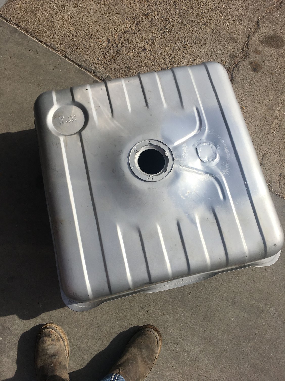

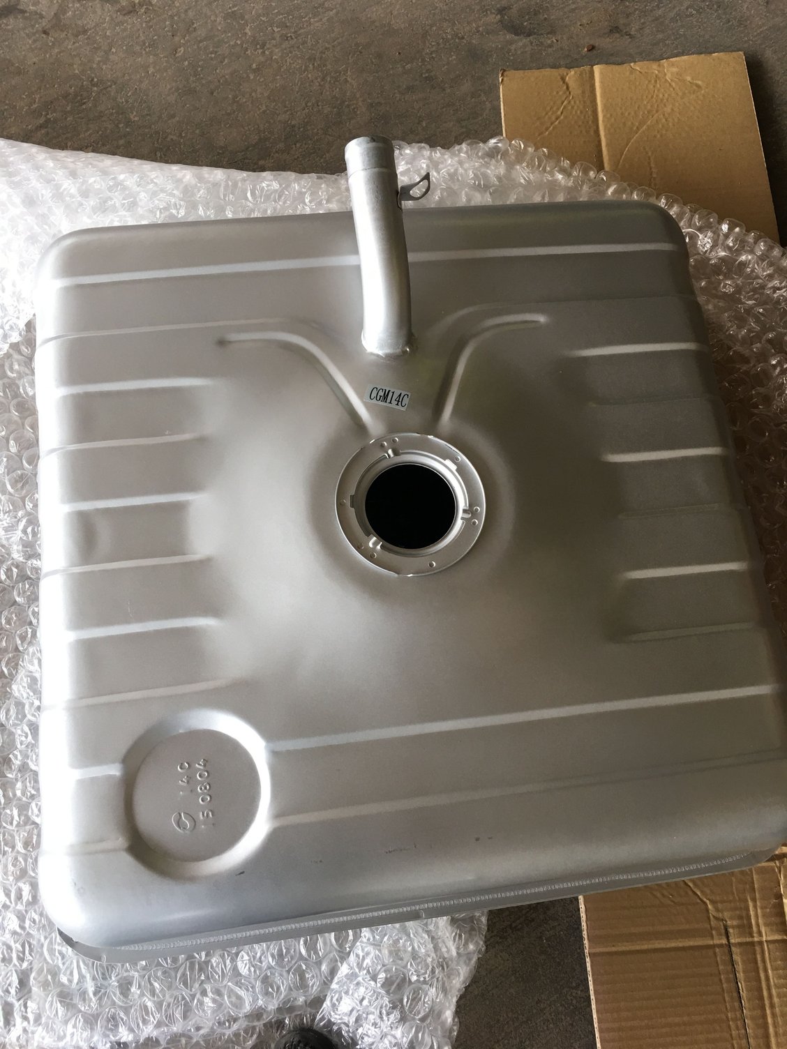

Had the neck cut off the tank and welded up at a radiator shop.
Mounted a filler neck with a billet cap.

What did you use to seal that new filler neck to the tank? If you used a rubber gasket, it WILL leak.......

It came with a cork/rubber gasket, it came as a kit from Tanks,Inc. If it leaks, I’ll do something different. I doubt I ever have it full enough to leak up that high but we’ll see how it does.
