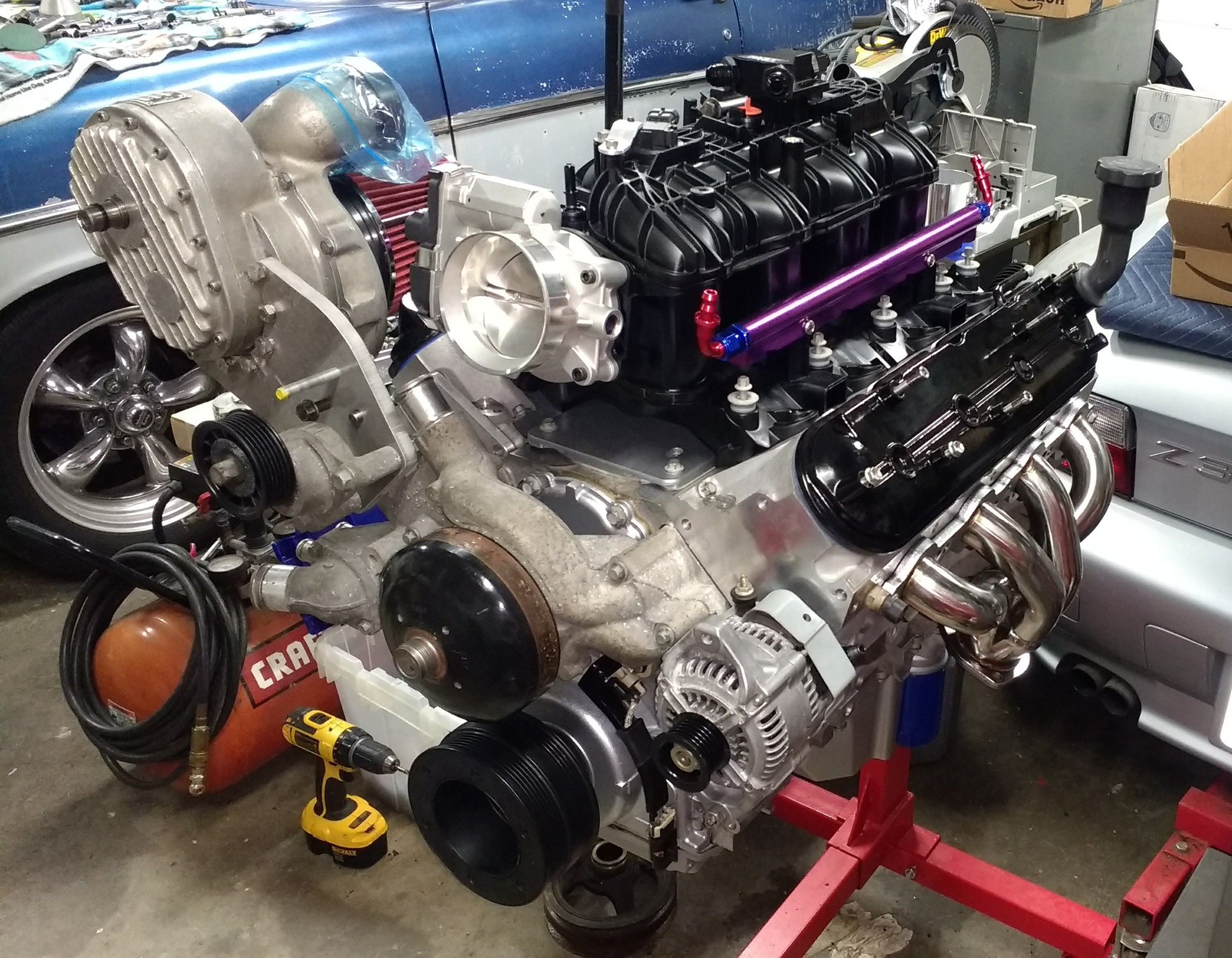

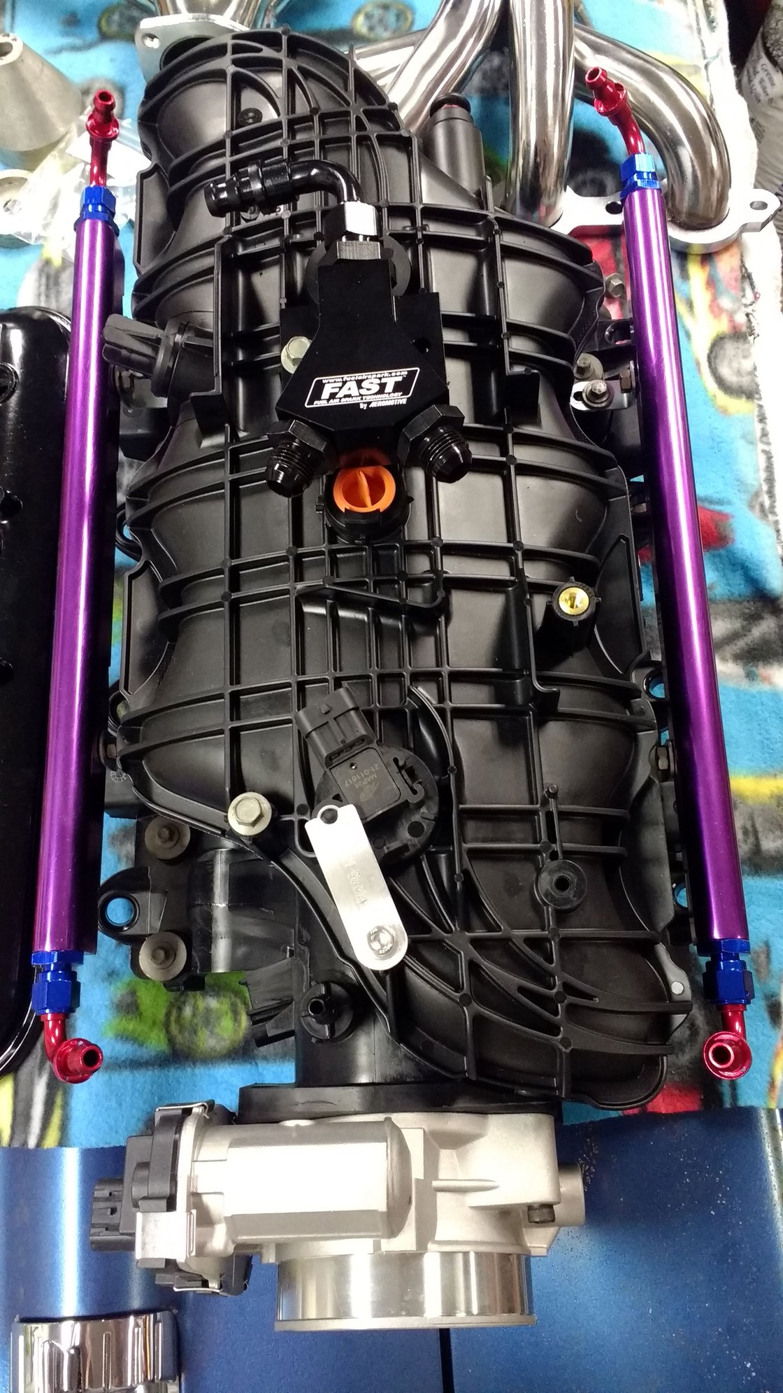

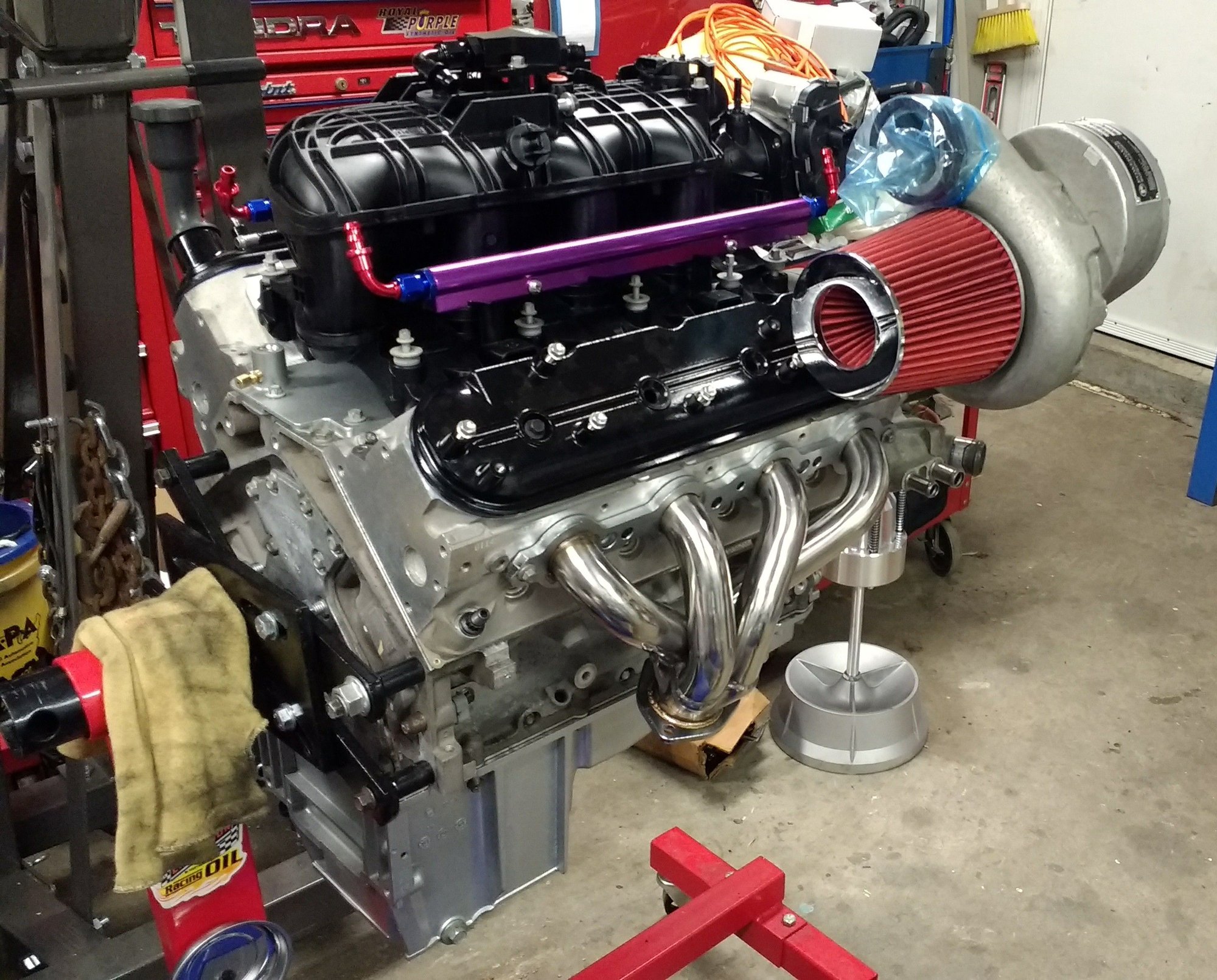

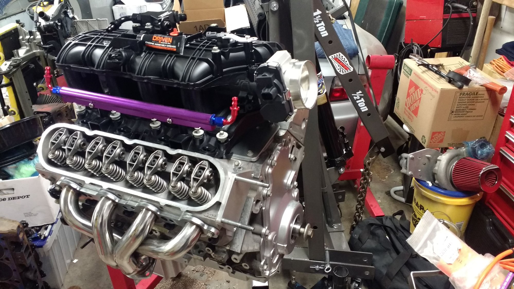

Update with pics. Fuel tank is ready, except for the breather vent.

More...

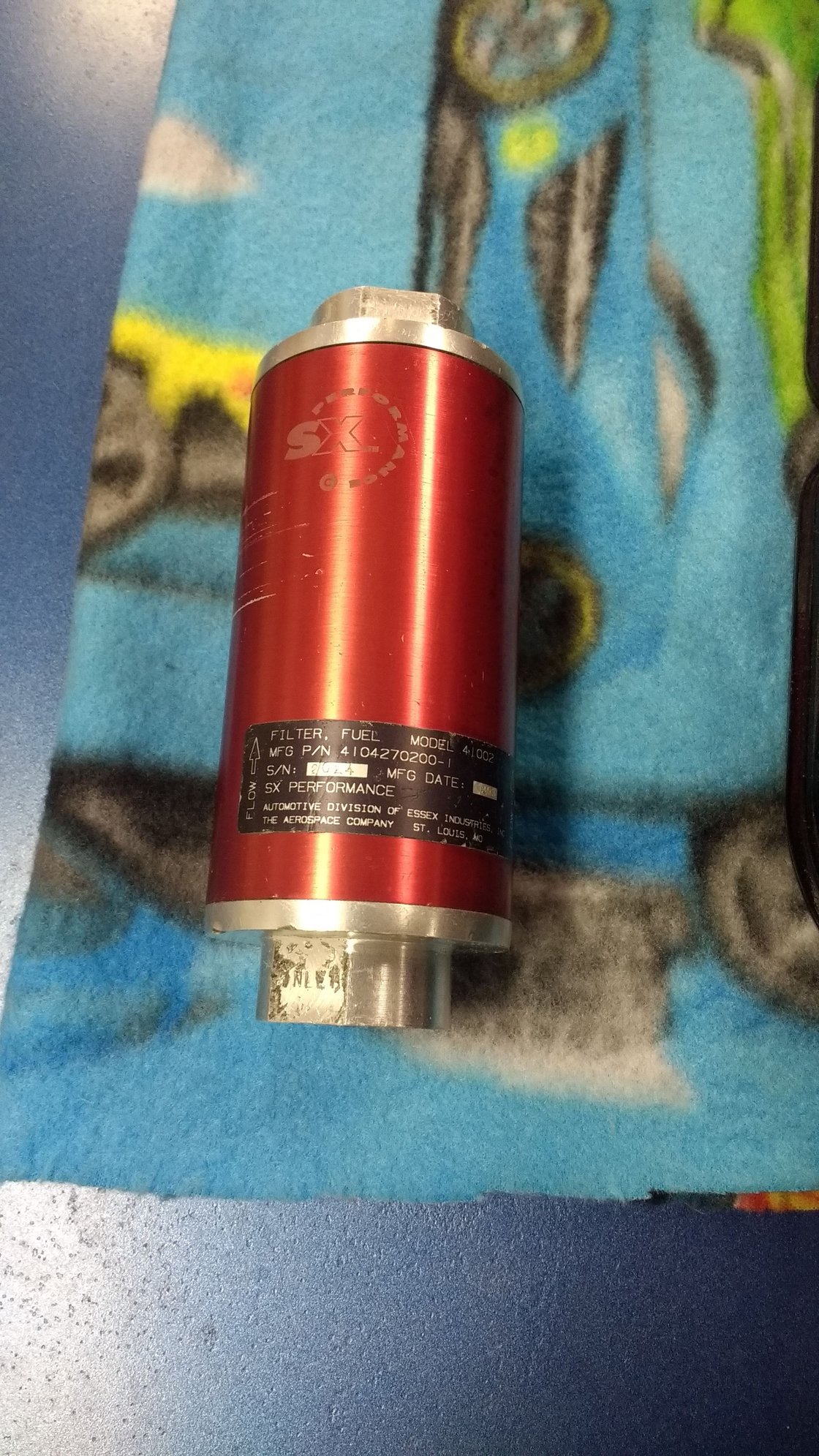

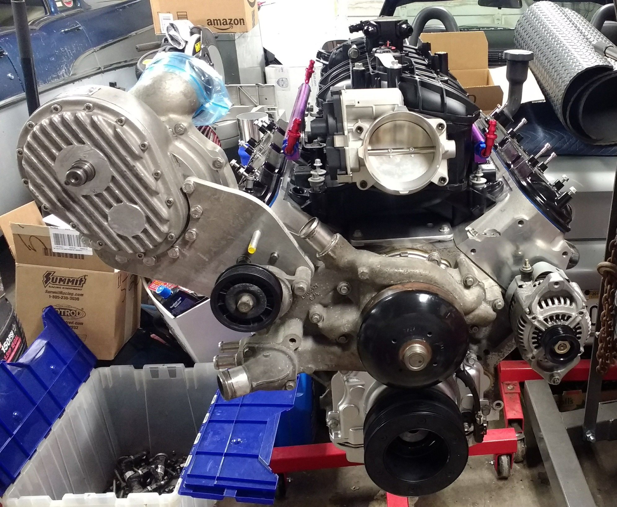

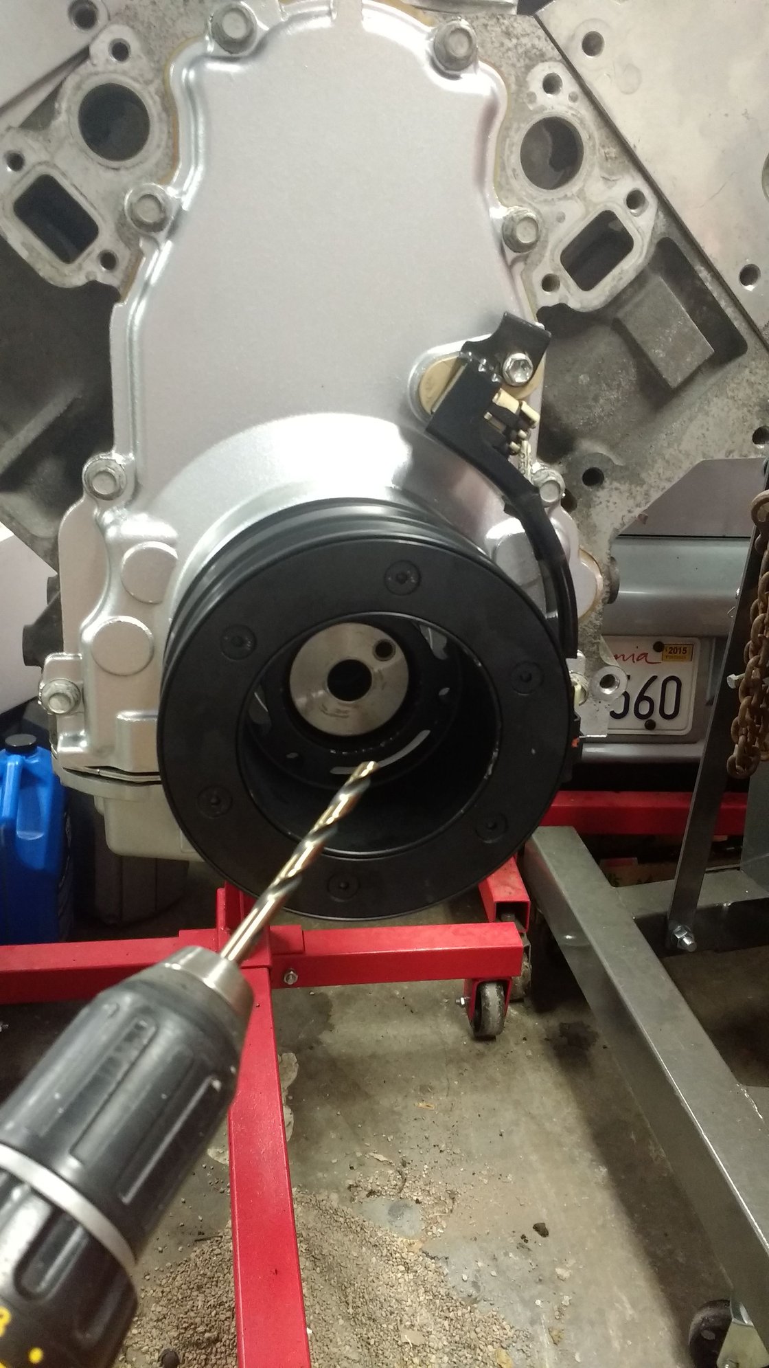

Picked up an SX Performance fuel filter at a local swap meet for $1!!
the underdrive pulley arrived and got installed. I'm about to drill for the pin. I'm working out brackets and spacers for the S/C and the mini alternator. I need to get my fuel rails and injectors installed so I can build the hold down brackets for the rails.
