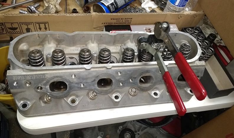

I've got the engine apart and parts have been rolling in so I have some pics to share. I'm using factory parts for much of the build. It's a 2008 LC9 5.3 aluminum block.
I'm only doing minor port cleanup on the 317 heads, but I did have the machine shop mill them .010". I've chosen to use the factory GM LS9 supercharger cam paired with Comp Cams valve springs and GM rockers with a Harland Sharp trunnion upgrade. (bought here)
The block is currently at Mann Speed Specialty getting cleaned up and machine honed. I'm having them press my new cam bearings in while they have it. I'm gonna use Speedmaster head studs because I just can't swallow the near $300 price tag on the ARP stuff. I'm sure ARP is worth $300/set but I'm not exactly made of money. First thing I did when they arrived was inspect the nuts and they all look good. Yee Haw!

I got head number two done and reassembled, then bagged it up until time to bolt it on.
