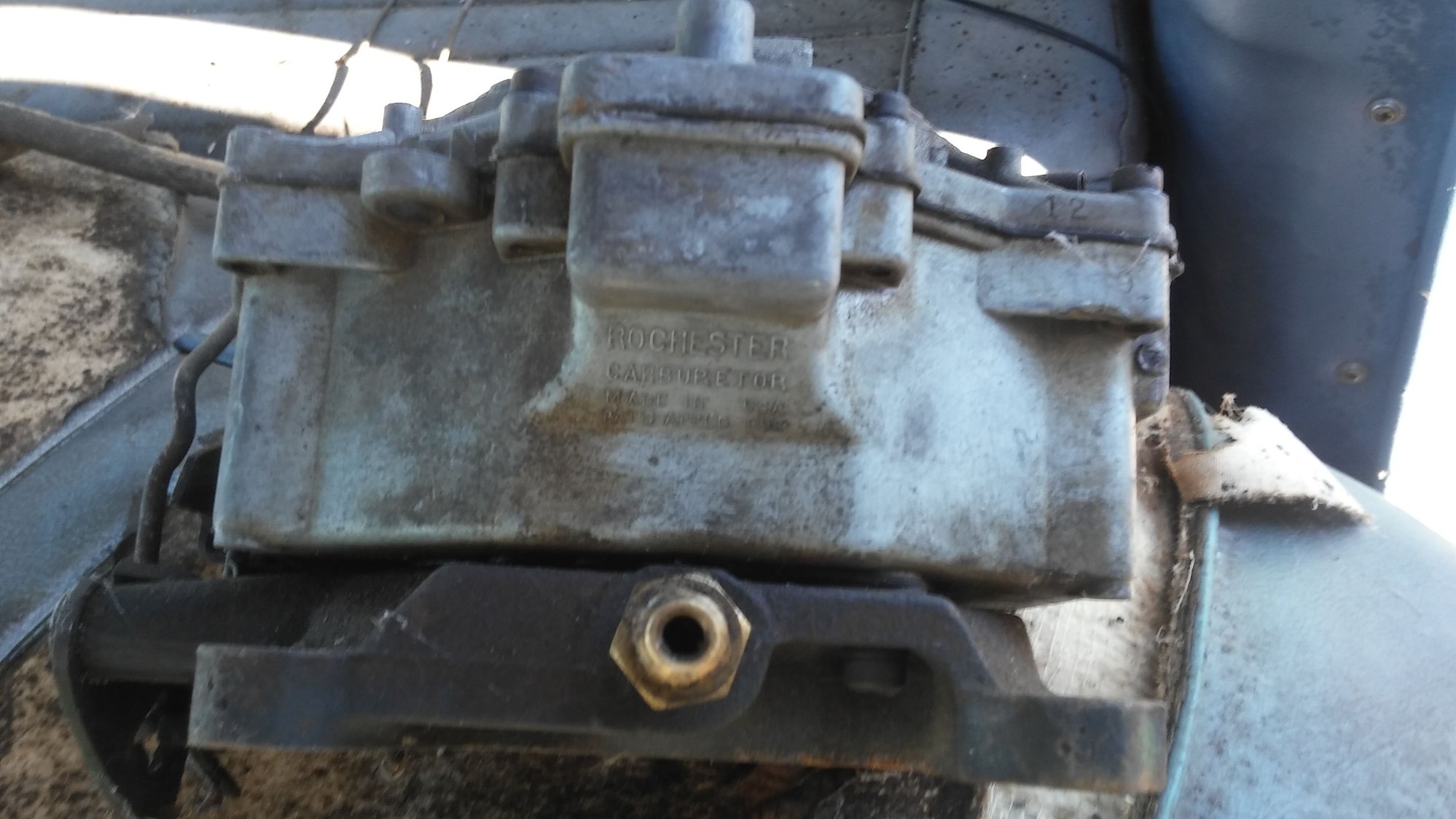

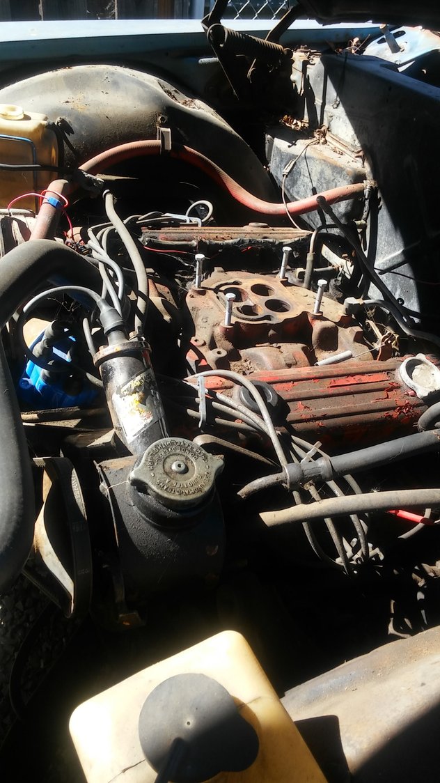

The car was solid for the most parts. It still ran but the carb was shot.
Buick 340 4bbl
