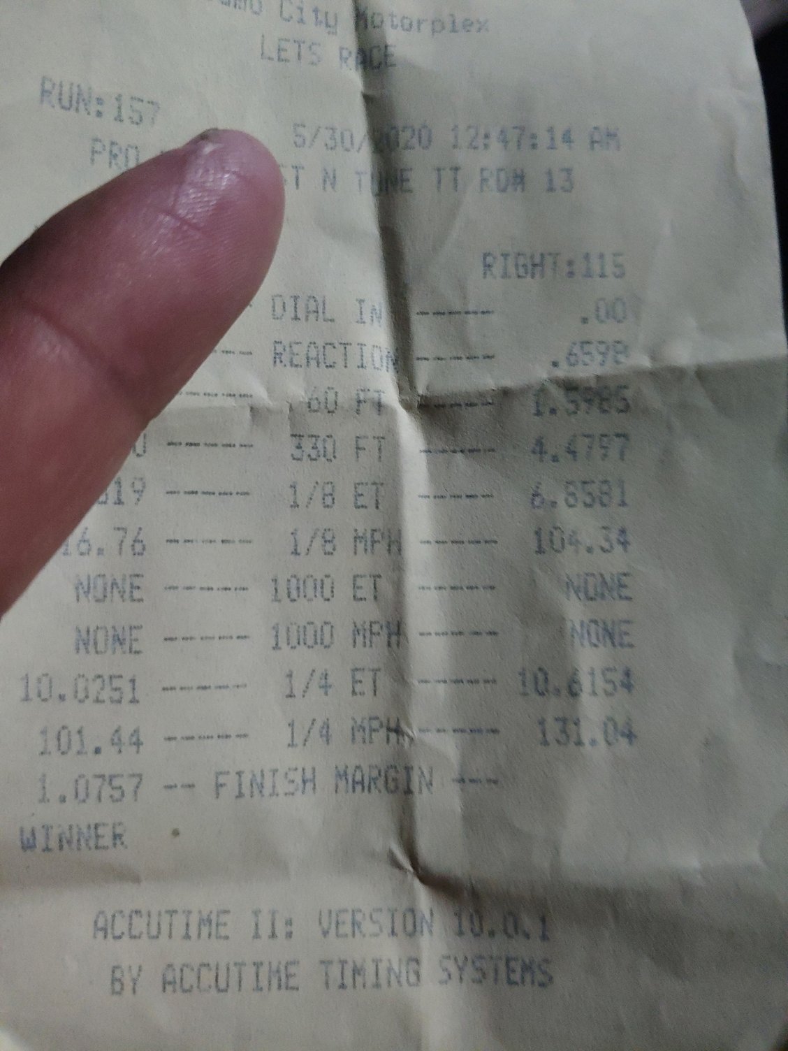

Old May 30, 2020 | 04:41 PM
  #70
fly pantera's Avatar
iTrader: (9)
Joined: Jun 2006
Posts: 623
From: SanMarcos,TX
1st time spraying in 1st gear.went a new best
