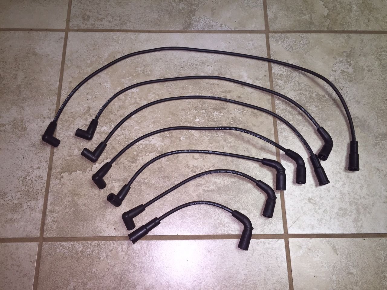

I had the same need, to clear one of my header primaries. Plug wires from a LT1 car will work. I think I bought a set for a 96 Impala SS. They were an assortment of sizes, and included a couple that were 3-4" longer than the 4th gen set.

Heads up, I had to take the header off on the side I used the longer wires on, and they are now popping off of the coils. The coil end is a tight fit, but they seemed to stay on before. Hose clamps or zip ties will probably fix it, but I'm now interested in other solutions.

I fired up my motor for the first time last week, and all is well. The coil plugs are staying on so far. Zip ties should fix it if there's a problem.
The LT1 set I got was all over the place. I don't think any of them were the same length or configuration. Really handy for a hacker. The two I used are about 17" and 18" long, and the rest are between 11" and 36" long (see pic). There are 7 wires in the pic and 2 in my car, so I guess there's a coil wire in there somewhere as well.
