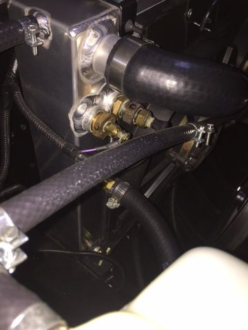

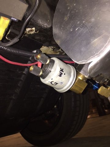

OK - and here are the senders -- 2 in rad, 1 in oil cooler fitting and 1 in the block.

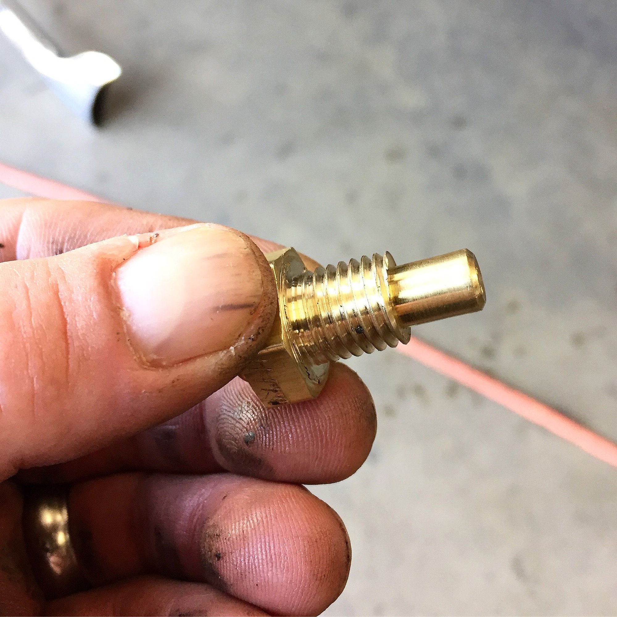

so, I went to my local speedo shop and got the stock temp sweeping gauge replaced with a 68-94 ford unit (very common) and looks exactly the same in the face.

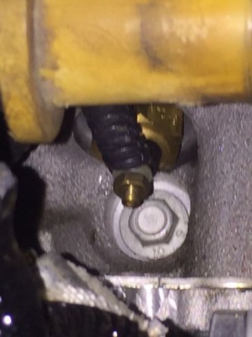

I then bought the appropriate 1/2" sending unit and chucked it up in the lathe, shaved it down and threaded it with a 12-1.5 metric Die. Works beautifully, put it in the pass side head where the plug was. I now have the stock sender for the ECU to read, and the stock gauge to read temp.

Nice work! Just keep in mind, the way water moves through the engine, the ECU sensor picks up coolant temp as it's leaving the engine on it's way to the rad. So the coolant has picked up all the heat it's going to at that point and is likely registering the warmest temps. The same location on the passenger side head (at the rear of the motor?) will likely be a few degrees cooler.
i understand and thank you. The ecu temp sender is in the normal spot. I hooked the gauge sender C/H to get a (ballpark reading) of where I'm at. I'll check actual temperatures and see where My gauges are.
