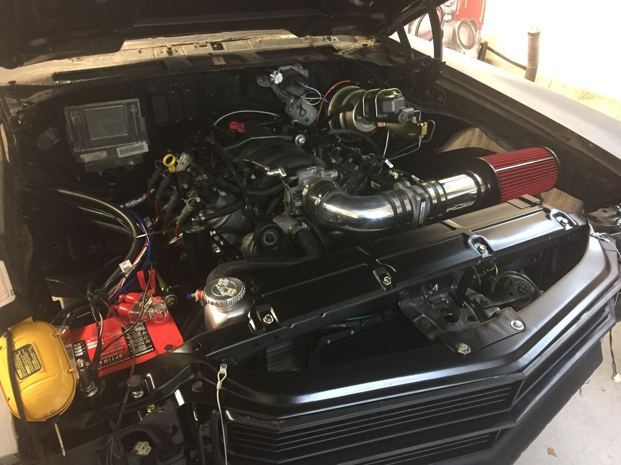

Turned out to be an LS6 block, intake, etc, but with 241 heads and 29k miles on the clock. DBC. Tore her down, installed a Howard's cam, new ported 243 heads, valves, springs and a 165 degree thermostat. Placed on a dyno with a carb and output was 505hp/489trq. Installed a 2800rpm TCI torque converter to match the cam and remarried the trans to the block. Reconfigured the PVC breathing system to include a catch can and keeping the "mist" out of the intake. This is now an LS6. Seems fitting for a 70 Chevelle to have a modern LS6. I'm applying for MDRN LS6 license plates
The Work
Looking closer at the crap body work, I decided to pull the body from the frame. I noticed two soft spots in the frame, so I had a local shop blast, repair and paint the frame. The body had new floors and 1/2 quarters butchered in but since there's no VIN and this car isn't anything special....I will deal with what's there for now. This is being built as a driver. The LS and 4L60E were installed perfectly using motor and trans mounts, as well as the oil pan, from Muscle Rods. No modifications to make anywhere, great fit.

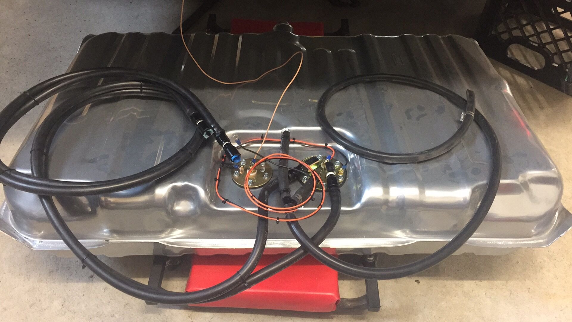

New body bushings and the body on. Tanks Inc EFI fuel tank with gauge sender and fuel pump installed. Rather than modify the existing LS wiring harness, I purchased a new one from Current Performance. I chose them because they tied their harness into the new American Auto Wire harness I needed. The installation was pretty straight forward on everything and looks great. Vintage Air direct fit complete heating and cooling system installed. This was a bitch of a job. Vintage Air needs to find an easier way to mount the unit under the dash.

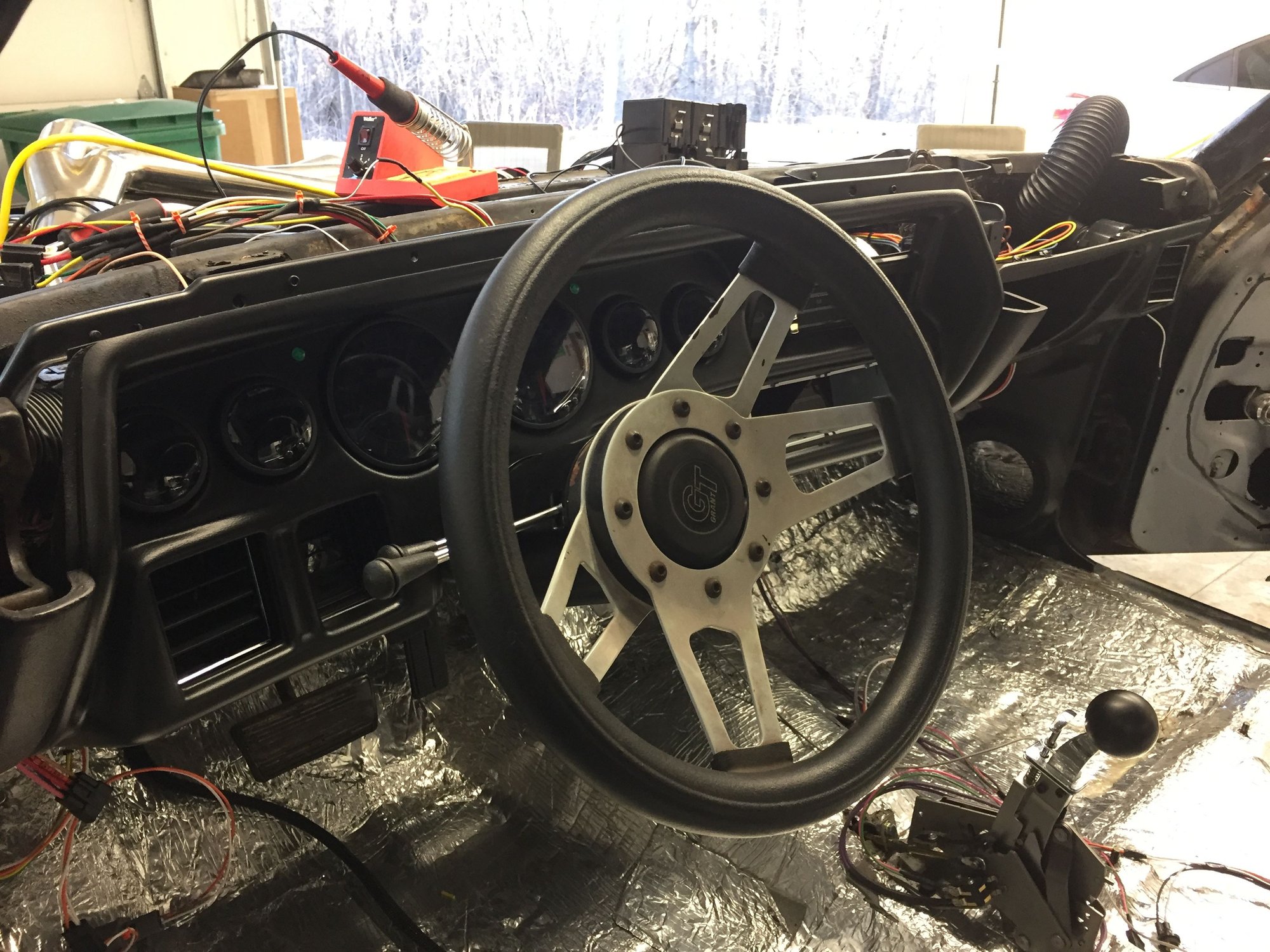

New Glow Shift gauges mounted into a Covan style dash insert looks pretty good after using undercoating to mist the insert so the texture was close to the original dash. Spending a little time on the fit really paid off as everyone who's seen it says you can't tell unless you know Chevelle's didn't come with that dash configuration. USB chargers in the glove box installed as well.
Sound barrier installed. Changed the steering column from non-tilt column shift to tilt floor shift and found a way to get a B&M Mega-shifter installed into a factory console without looking like a hack-job. Pics will come once the final assembly is complete, but the mock-up looks great! A little beating on the floor and the short arm option from B&M sets the height. A little creativity to blend the boot to the console cover finishes it off. New headliner, carpet and a great find on a rebuilt rear seats start the interior rebuild. I will be going with new TMI Sport buckets vs stock, they fit better.

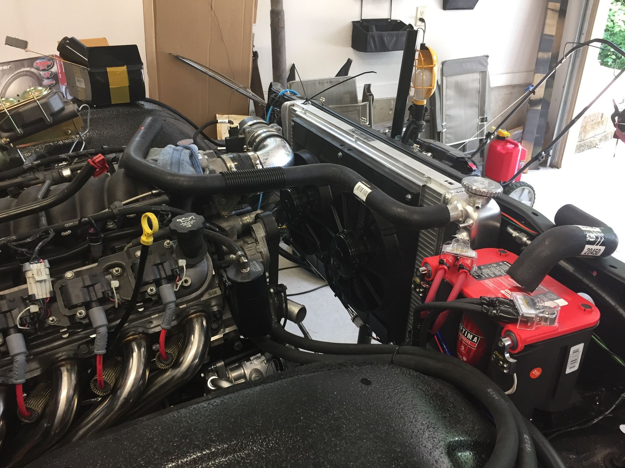

Dual Pass radiator with trans cooler installed from Muscle Rods (Dewitts). 2 core with 2 electric fans (4 core rubber mounts). One of the toughest parts to get here has been the hoses. The Muscle Rods motor mounts set the engine back almost 2", so using hoses others have used was a wild goose chase. O'Riely Auto Parts MBH 207795 is your upper and Gates 22437 for your lower and you'll breath easy. It's like they were made for this configuration, trimmed 1" off the bottom (thermostat side).

Tanks Inc EFI system.

Incorrect hoses, the 20450 lower and 22358 upper did not work as I read they would. My guess is the motor placement.
Dash in, fold up Pioneer touch screen connected as well.

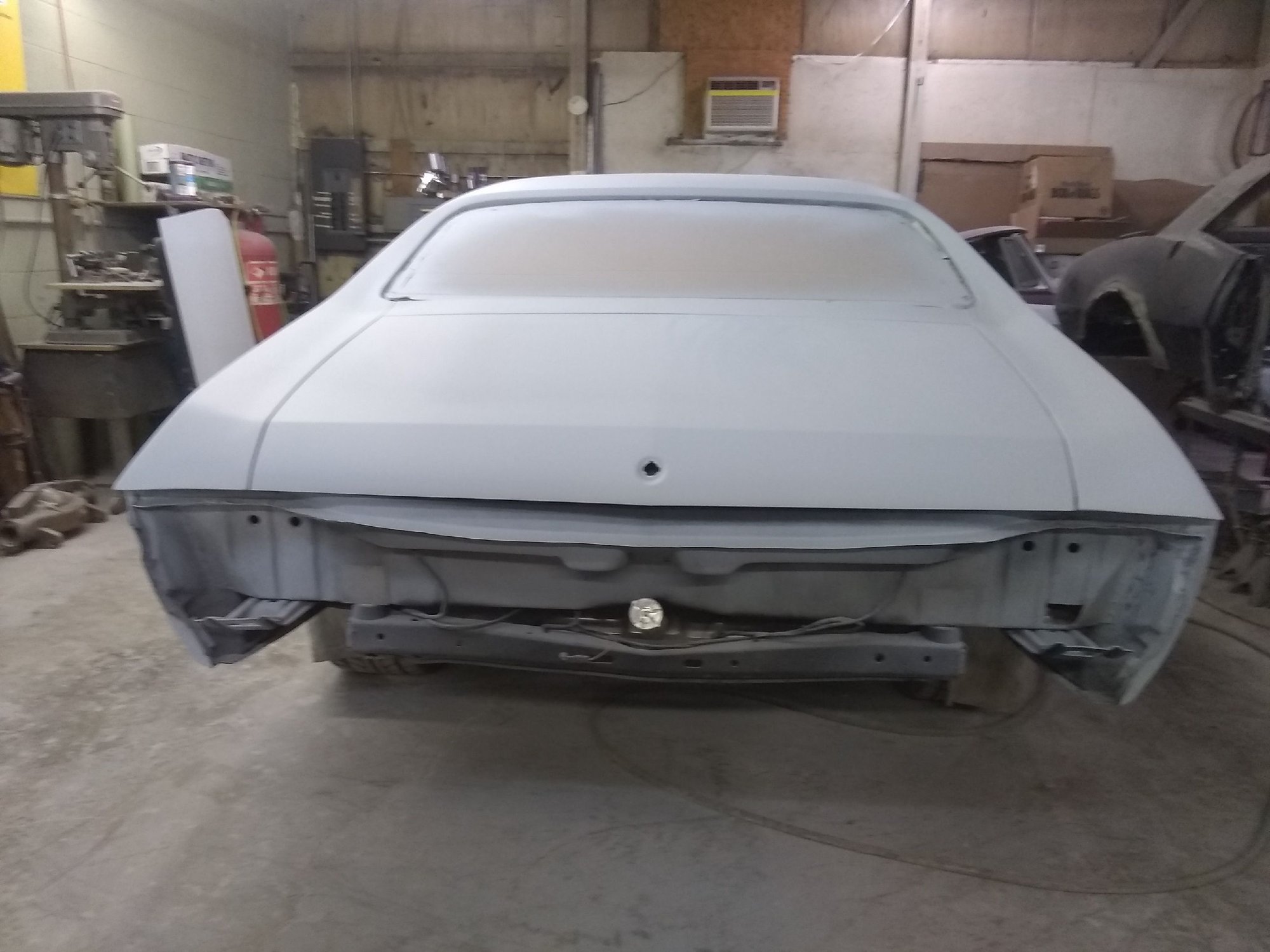

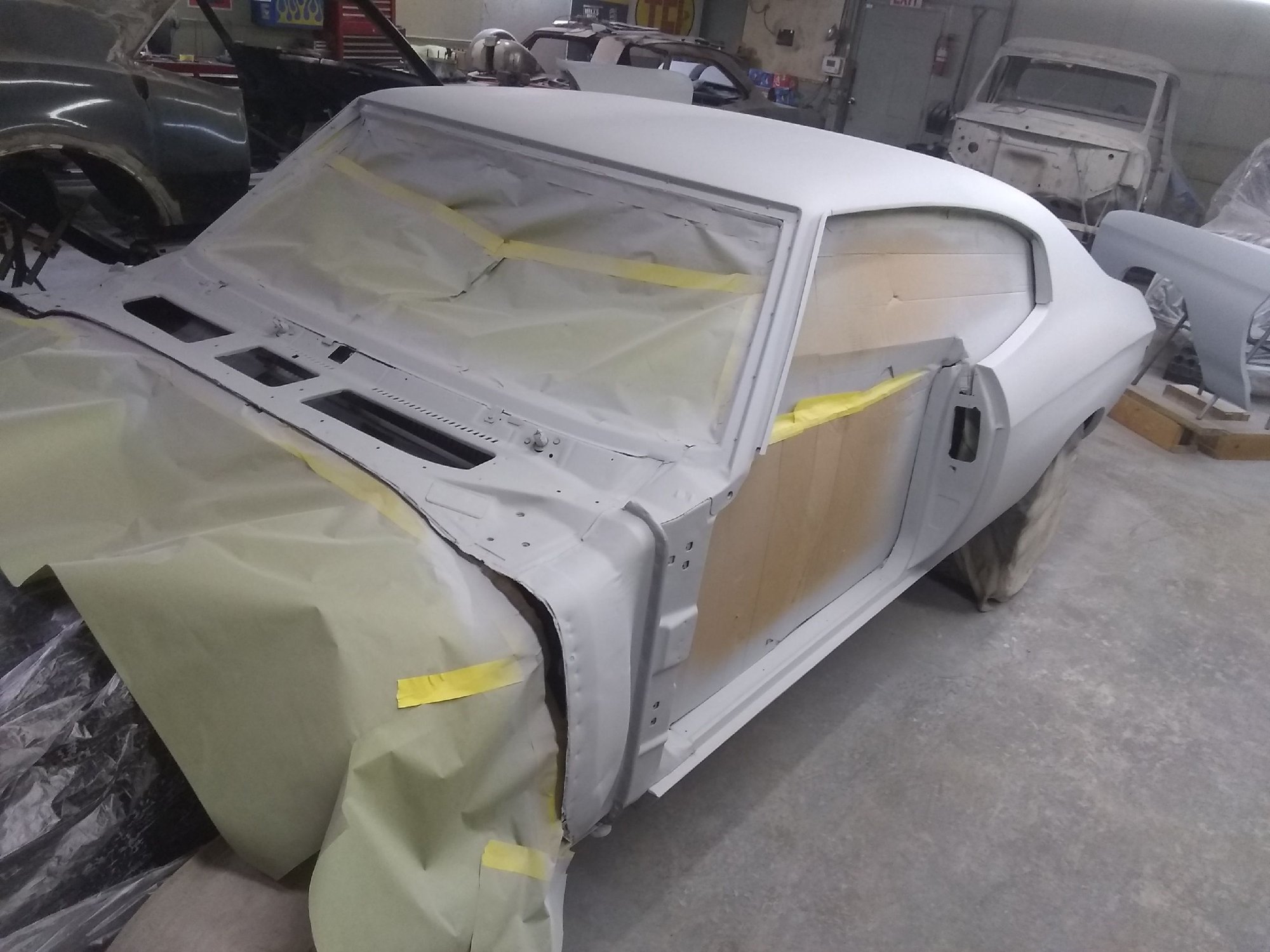

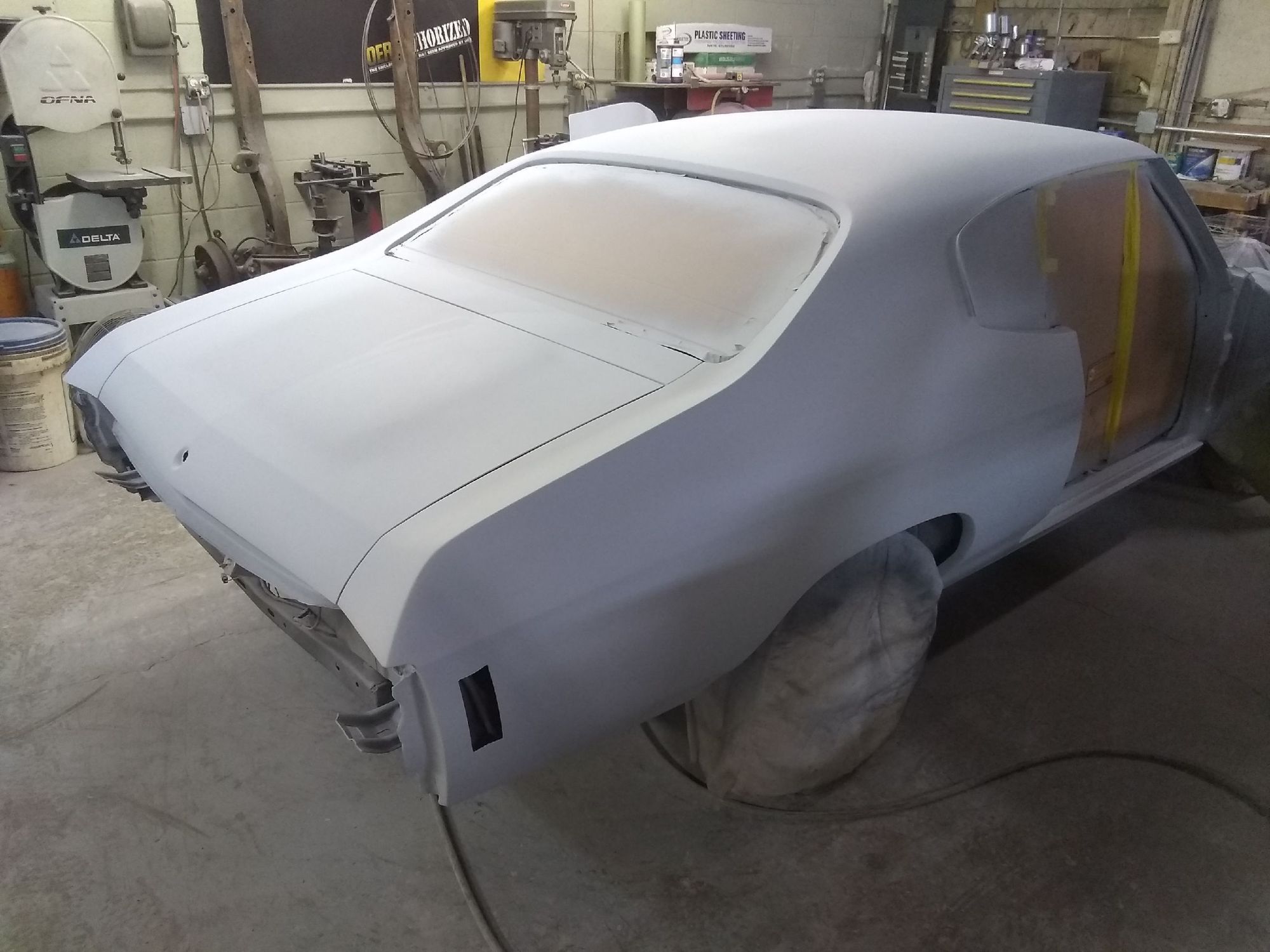

Old Jun 30, 2019 | 10:11 AM
Wes_70ss's Avatar
Joined: Sep 2014
Posts: 24

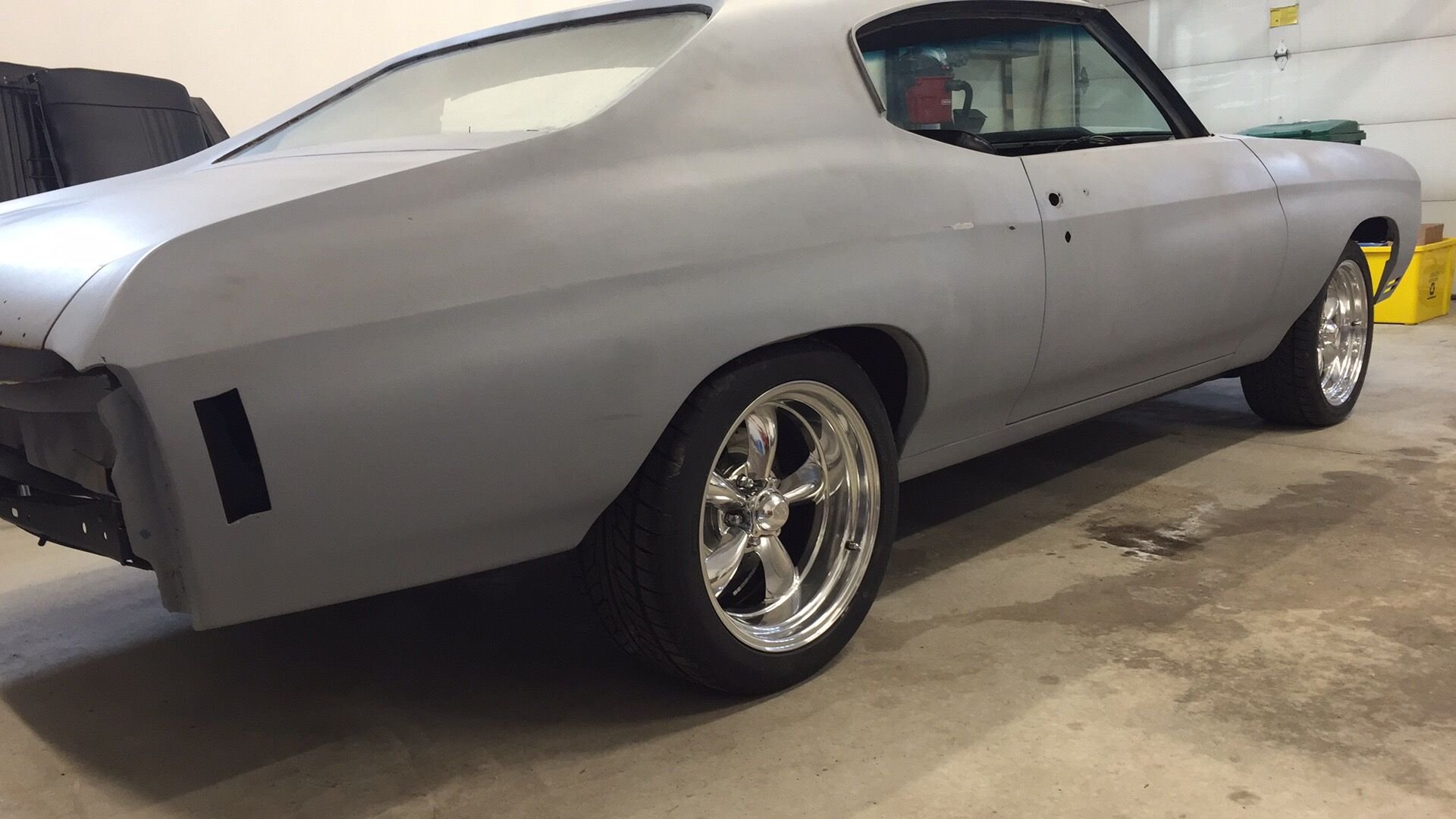

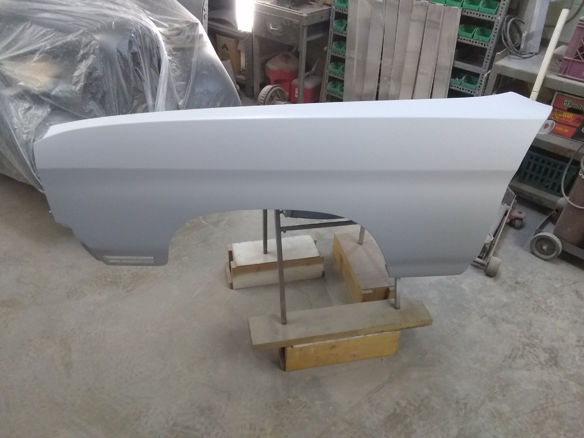

Sorry for going dark. This project has been stalled out. I have her at the body shop now. It was stripped down to bare metal, found lots of crap body work so that was fixed, body lines and gaps are now present and the final sanding before paint is being done. Should be in paint in a few weeks!
