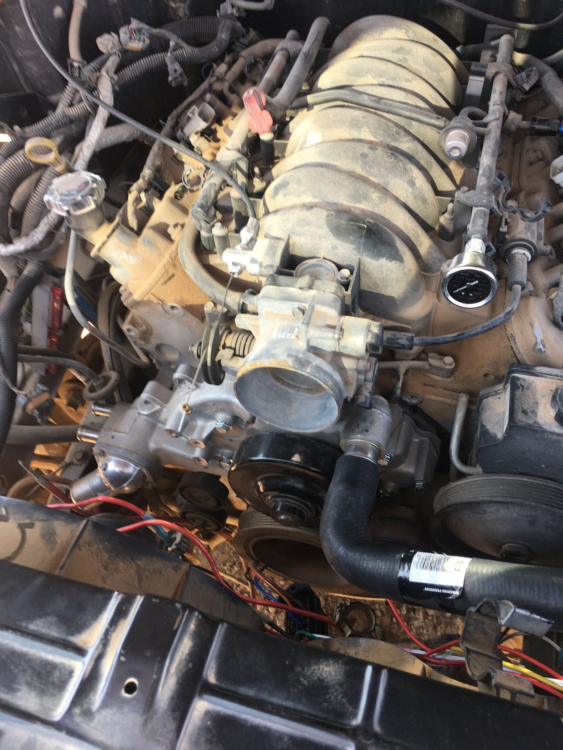

Large radiator 98-02 Efans
Larger radiator 98-02 efans
Ls3 water pump
Upper radiator hose '10+ Camaro
3/4" spacers lined the water pump pulley up with the ls1 crank pulley. If running the truck accessories/crank, the ls3 water pump pulley lines up perfect.
I am using the larger squarebody radiator, I believe it was found in the diesels. I had it rebuilt years ago. It uses the one metal piece on the top to hold the radiator to the core support. I also used 98-02 Fbody efans.
I pulled the LS1 fbody water pump off and used 3/4" water pump spacers from ICTbillet with a '10+ Camaro water pump. This made for a much shorter top hose running to the top driverside of the radiator, the hose is from a '10+ Camaro as well.
I paid $100 for the water pump, $30 or so for the spacers, $25 or so for the belt, $100 for the efans. $20 or so for the two relays and wiring them up. I think I have maybe $100 in the radiator but I'd have to look back and see.
Excuse the mess, West texas is dirty and blows crap all over everything.

I think my radiator is the same as this one! If you guys look at the crate ls3 water pump and '10+ Camaro upper radiator hose I used, it shows that I used 3/4" spacers to make the pulleys line up. But the '10+ Camaro pump lines up with the truck accessories perfectly. So if you don't want the hose running across the radiator/fan shroud, this is an option.
