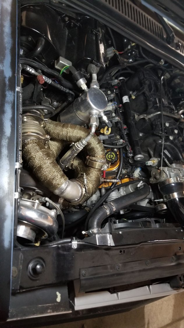

Just an update, after beating on the truck for a summer, the cooling system is a success. Im glad I went as large as humanly possible, with a stalled 4l80e, 5.3 with turbo, air to air intercooler and air conditioning, the setup creates an absurd amount of heat.
With 160 degree thermostat the engine will hang around 210 or so with a heat soak and rolling ac. trans stays good a cool with aftermarket cooler and fan mounted under drivers side floorpan in conjunction with rad cooler.
Truck has inner fender wells too.

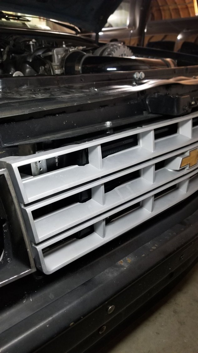

I also noticed you had to hack up the radiator support and no longer have the factory latch, I wanted to keep the clean factory look. Does the grille still fit?

Factory latch still just cut down and yes, i have a grill in the truck still. Ill grab some pics
