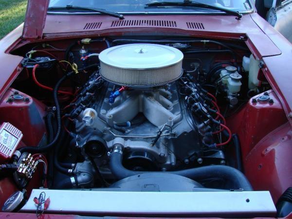

Hi, I thought I would start this thread to go along as I work on my 280z.
I got a '78 280z project from a previous owner. He swapped in a LM7 and a TH350. He also converted it to a carb. The car ended up being pretty rust-free which is what mostly convinced me to take it on. This is my first foray into the LS world.

Yup, it has a 3.545 in the R200 out back so it kind of winds out around 65mph. I spent the summer just enjoying it, the PO was really nice and super talented, but the Holley is messed up somehow, I am suspecting too much carb (750cfm) and perhaps a blown power valve it seems to load up at long idles. Plus I have a hole in the hood which I personally think messes up the classic Z lines.

A 750 is an alright size carb for that motor. Make some different mounts and it will fit under the stock hood as well. Mine is pretty spot on with a TKO 5 speed and the same 3.54 R200 rear.
Do you have any idea where the PO got those mounts? Motor looks pretty high up and forward, almost like a Hooker or Scarab style mounts. There is a pretty good selection of Z car LS mounts that would get the motor down and back.

I'm not sure where the PO got the mounts, knowing his fabrication skill there's a chance he just fabricated them himself. Any leads for a good quality set of motor mounts? I was thinking John's.

IDK I made my mounts some years ago. A lot of new stuff has come out since then. John's appears to be a good unit and you can get long tube headers for that set up. Hard to go wrong there. But there are a couple of other options as well. I don't think any of them will mount a carb under the stock hood. Pretty much need to slam the motor for that to happen. But with FI you are golden.
