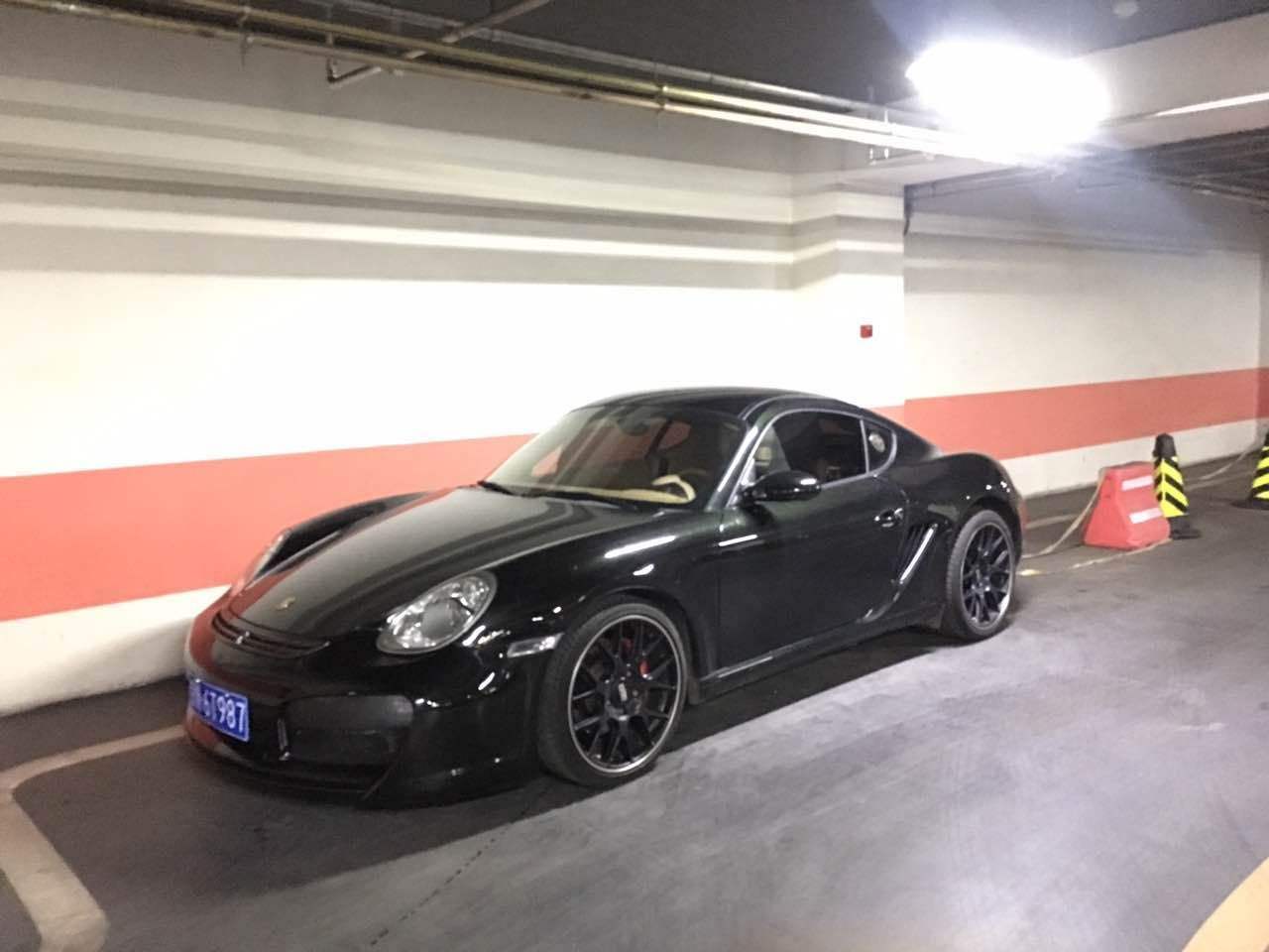

My Cayman S 987.1 (current car)
after cayman engine blow
so i want to do a LS swap, i miss the easy reliability on my C6 so much
