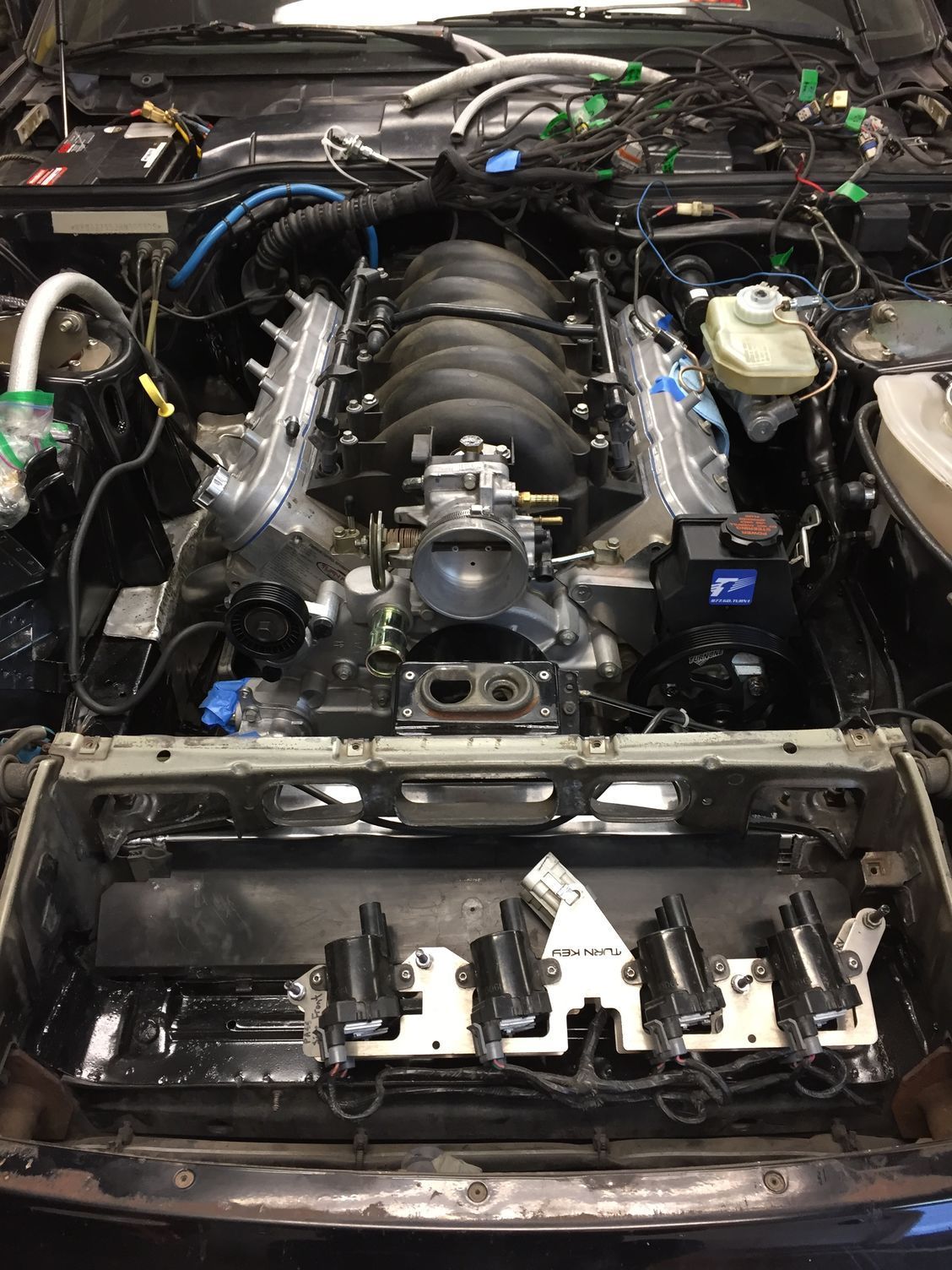

does anyone make ls plug wires longer than 42 inches?

happen to know how long your wires are? My drivers side coils are under my radiator area.
longest is roughy 52 inches, shortest around 45.
