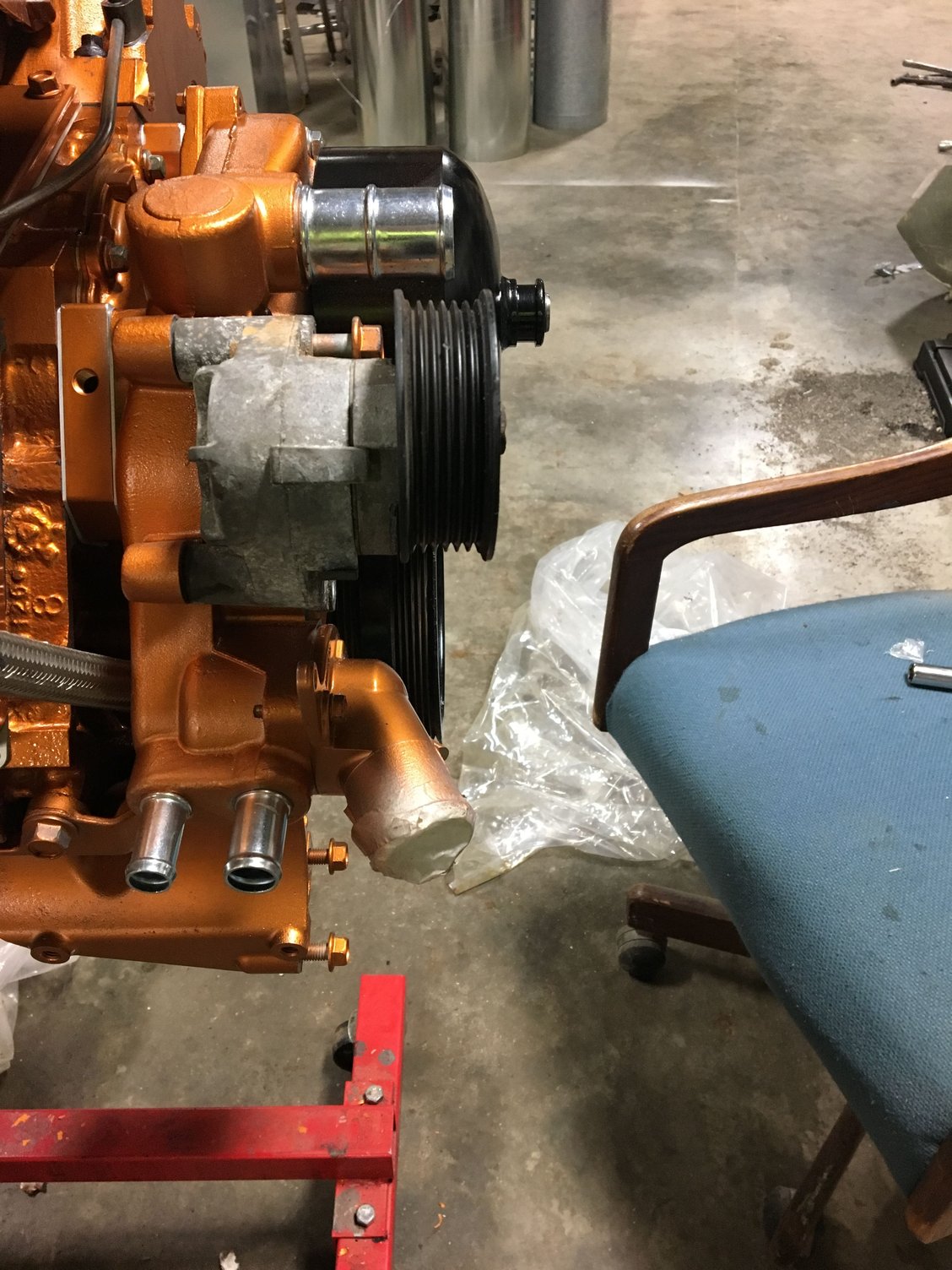

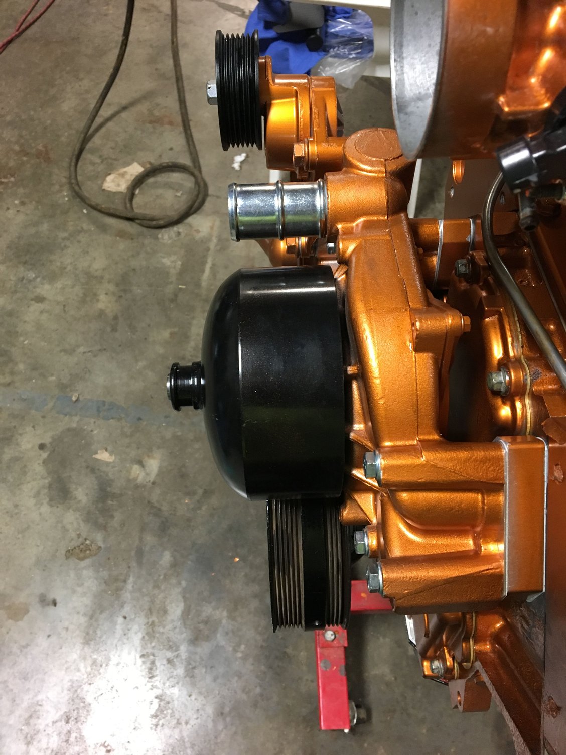

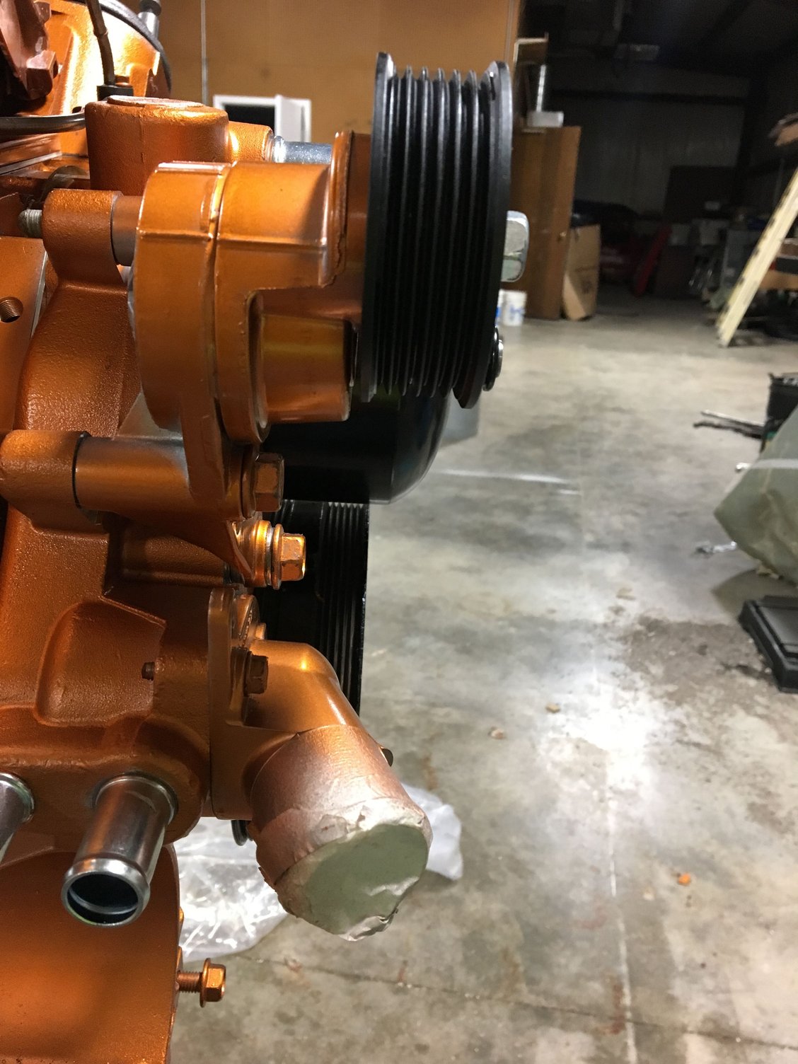

Finished installing the heads, little more work to do prettying up the intake, but I got to mount the water pump and I'm assuming I don't need the spacer kit? I installed it with and the tensioner pulley sticks out way further than the balancer. So then I thought maybe it was the new tensioner pulley i bought and tried the old stock one...same thing....sticks out way to far? Actually would have been real nice to use the spacers as it would allow me (I think) to route the turbo oil return line behind the water pump. Can anyone tell me if I need to just get rid of the spacers or do something else entirely?

Originally Posted by ss.slp.ls1
You'll need to use a spacer kit with the Fbody LS1 pump you posted. Here is the spacer kit:

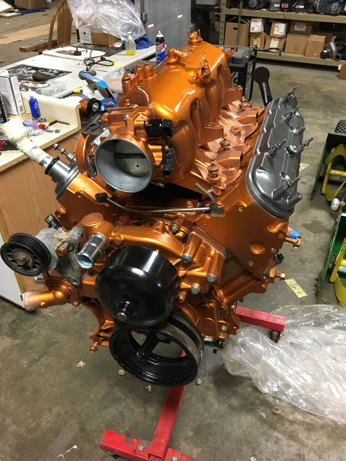

from the front

Are you using a belt tensioner designed for a LS1 Fbody or one designed for the truck?
Old Jun 12, 2018 | 06:23 PM
Slowguy1's Avatar
Joined: Apr 2018
Posts: 51
So I need the f body tensioner and it’ll fit? That would be great. Those tensioners in the pics are both Truck tensioners. Sorry. I don’t know they’d be different.
Yeah, you'll need the one for an Fbody.
