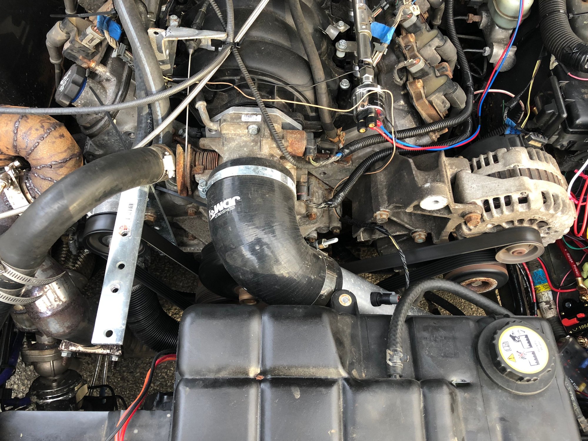

Would you mind, sometime, sending a pic or two of your accessory placement? I'd be very interested to see how it's all situated.

My original intentions were to just do a cammed lq4 n/a and do a turbo after. Once I started building it I thought to myself "if this things goes good n/a I'll never put a turbo on it" not to mention the old life gets in the way things that happen. I'm glad I did it when I built the car I'm really happy with the way it turned out. I'll grab a few pics of my accessory drive but I only have an alternator hooked up. I wanted A/C but once it started coming together I realized there just wasn't room without some serious changes from what I had planned. I'm also running electric power steering now which I just got finished up last weekend. Works good so far.

Not a great pic but this is about as basic as an accessory system gets. The alternator bracket is the original truck one cut in half, rolled sideways and the bolt holes elongated. Stock truck alternator and pulleys just moved around a bit. I had to put another smooth idler under the alternator because it was catching the corner of my bolt and tossing the belt. The metal bracket was for my old ps reservoir and I haven't removed it yet.
