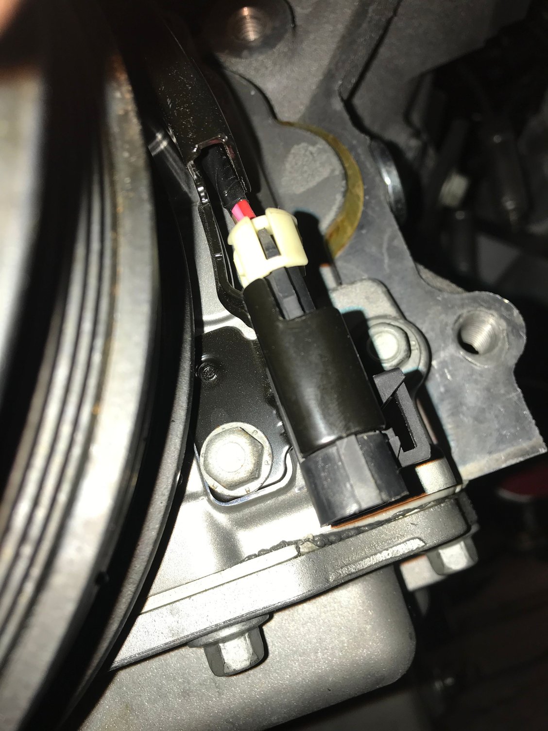

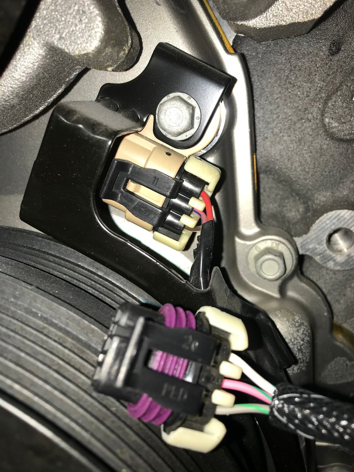

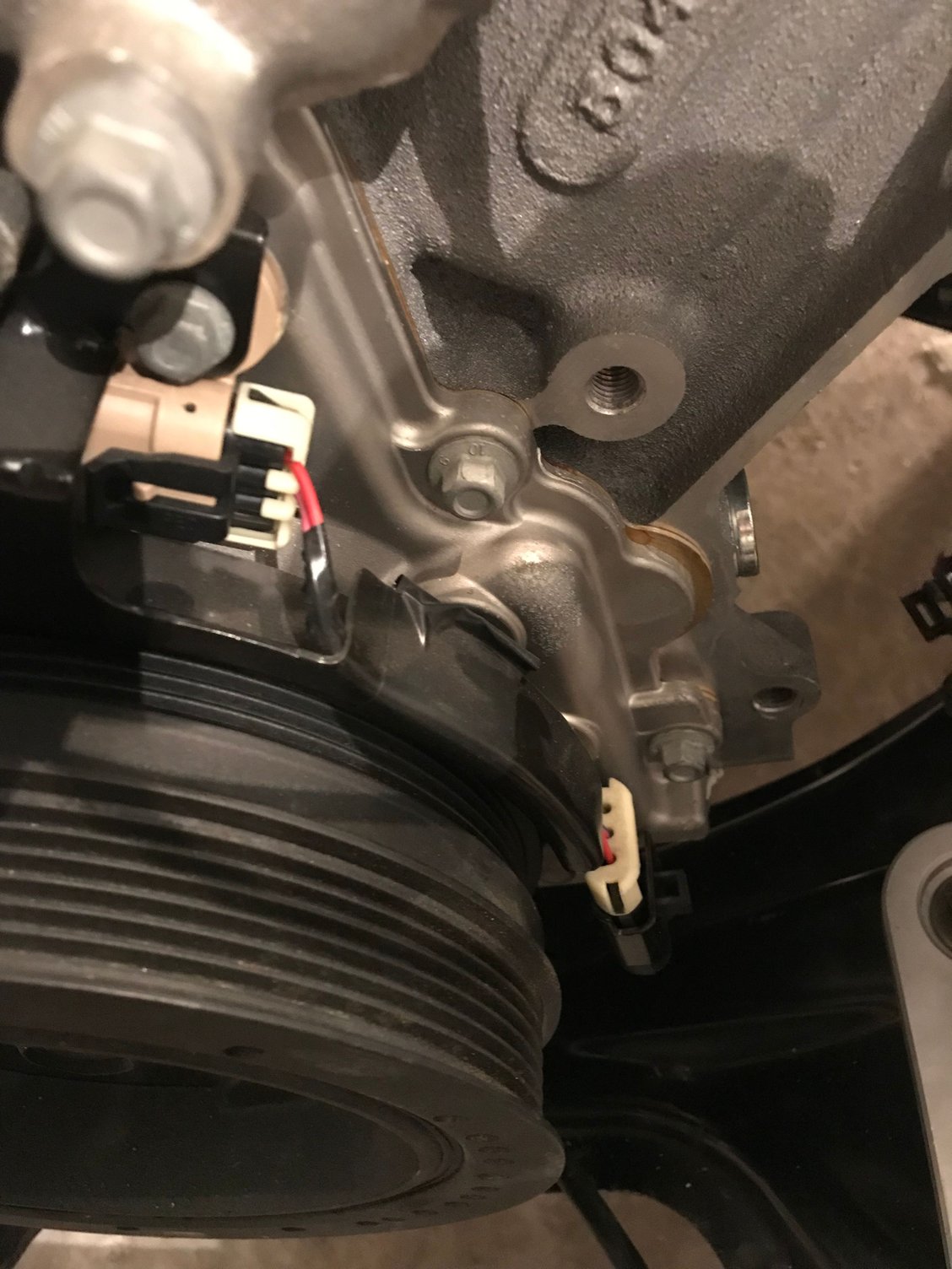

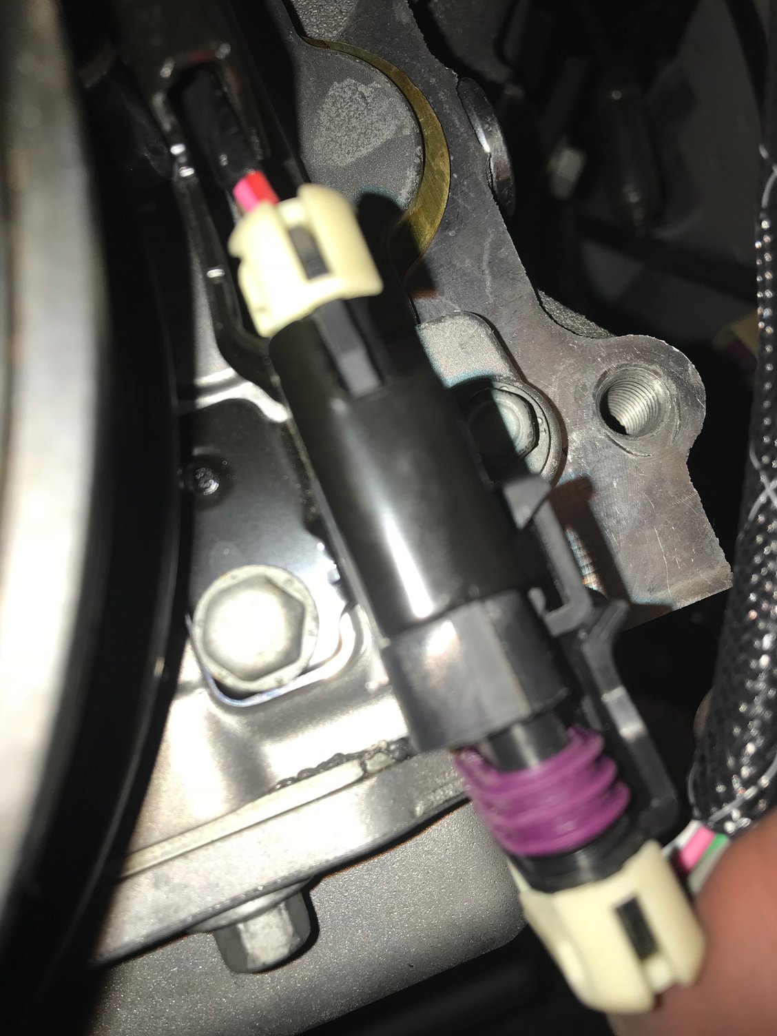

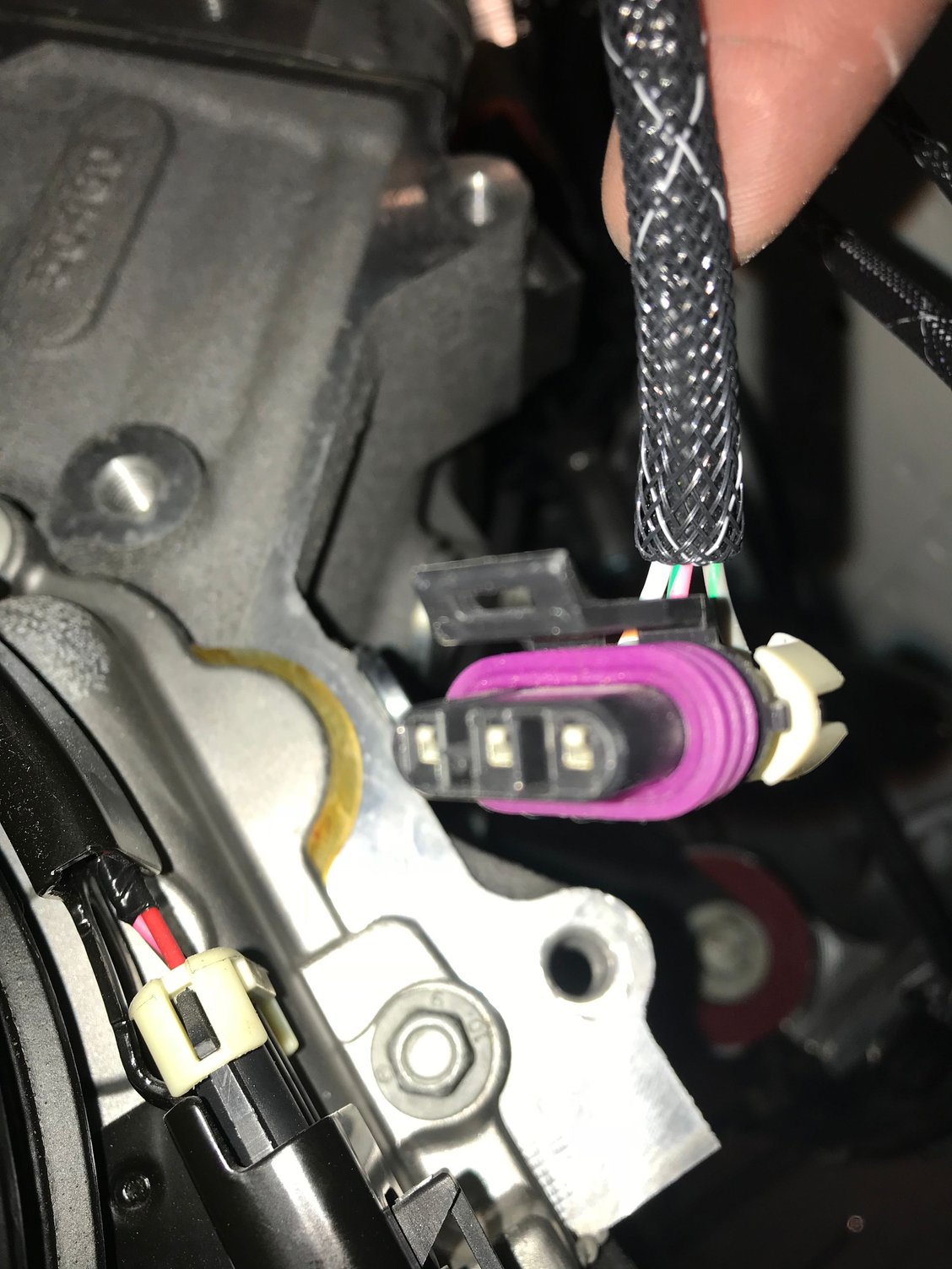

These connectors seem compatible and orientated to each other as far as pins and male female shape. But the connector on the engine seems to have been molded with a block to the clip.

Nvm. Sorry for all the questions guys. I think I just bypass this pigtail and go straight to the sensor.

You got it - I had the same question when mating up my PSI harness to a new crate LS3. Remove the factory bracket/pigtail and go straight to sensor. And, as I recall (my memory is crap) - the crank sensor is above the starter in the back; I think this one is the cam position sensor?
