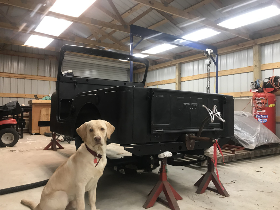

One of my goals regarding this build is to make everything modular and easily replacible. Seeing that we are using a 63 year old chassis, I wanted to be able to swap everything over to a new one should I hurt/crack the original one. That being said, I got the engine situated today, so tomorrow I can hopefully cnc some engine plates that will bolt to the chassis.
Once again, Murph showed up to give his approval.

Looks like Murph DOES approve! lol

I think he is ready for a ride.

Agreed. I can’t keep him out of my way anytime we tinker in the shop. He just always has to be involved.

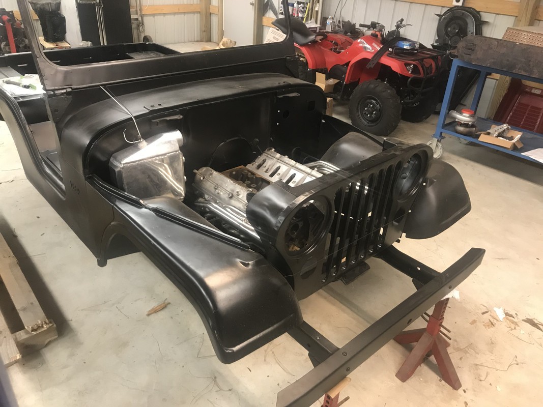

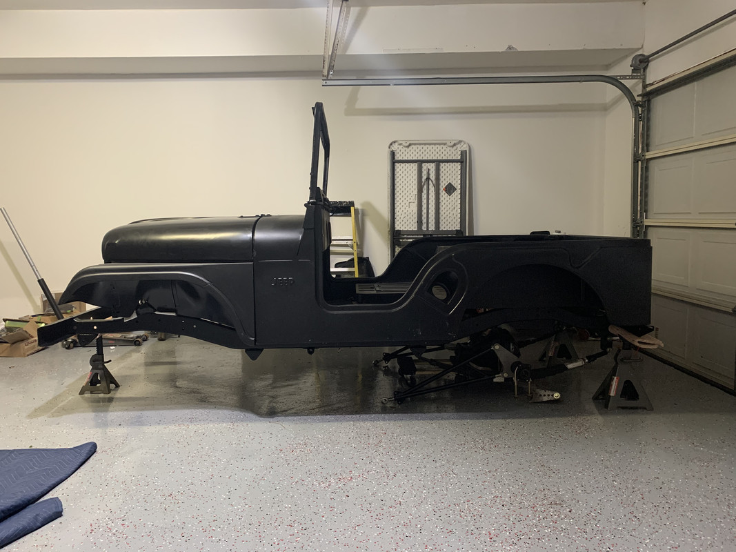

Finally off for the semester and had a little time to tinker with the jeep. Started mocking up the panels and it looks like I am going to have some minor fitment issues with the grill. Now I'm just waiting on the th400 to show so I can fab up a cross member and get the drivetrain settled in. We decided to run twins with an air to water setup. Aside from having to shorten the headers, it looks like everything should fit quite nicely.

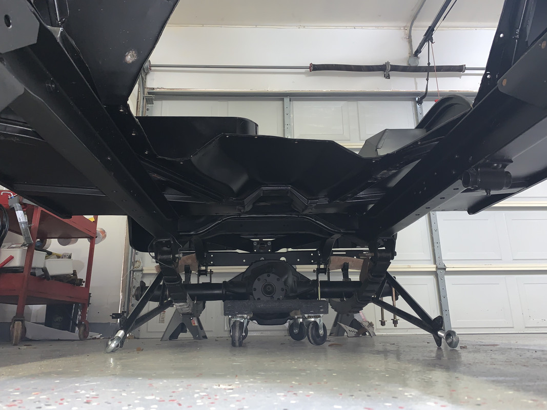

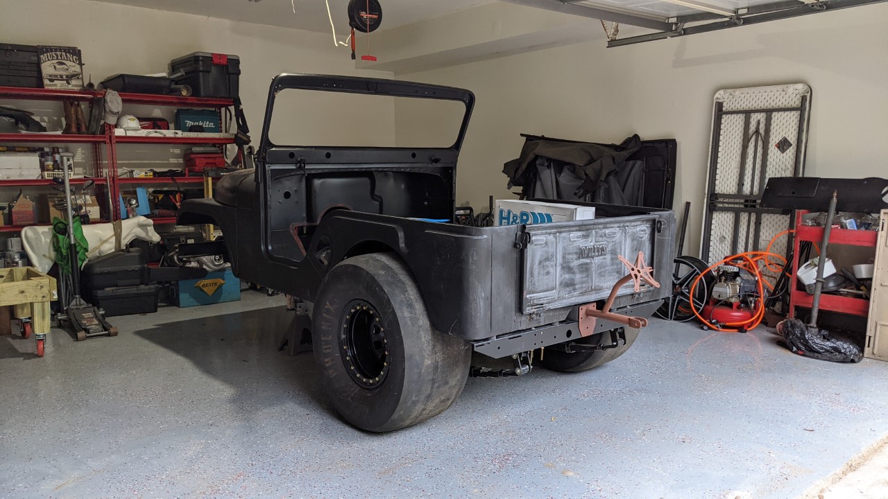

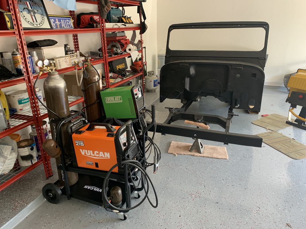

Work has slowly resumed. Due to this who corona virus I've been around the house a lot more with a fair bit of time to myself. Today I got around to locating the rear and and planning out the drop brackets for the ladder bars. Hopefully next week will offer a lot more progress. The goal is to finally have myself wired for 220 so I can burn some mounts together and get the engine settled in, as well as also coat the belly of the tub and finally mount it to the chassis for good. Unsurprisingly, Ive already had some issues with fitment on the front clip, but that's something that'll be addressed at a later time. On the plus side, after puling the dash and tunnel there appears to be plenty of real estate to work with.

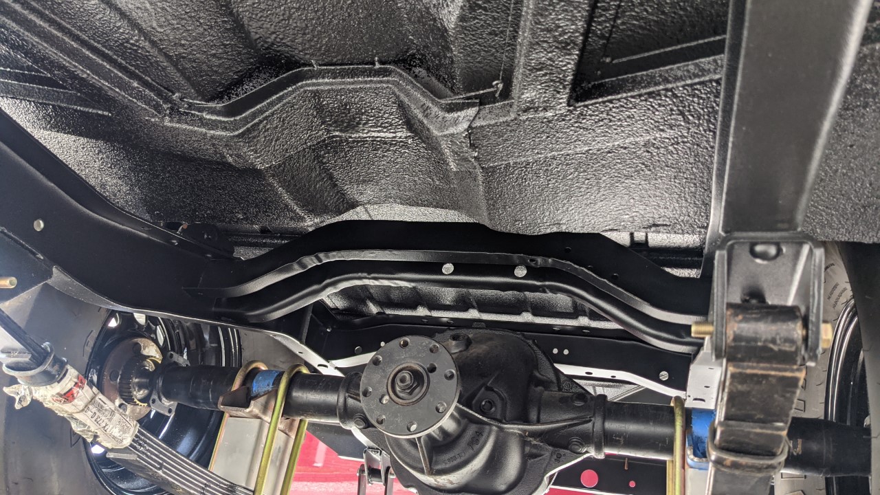

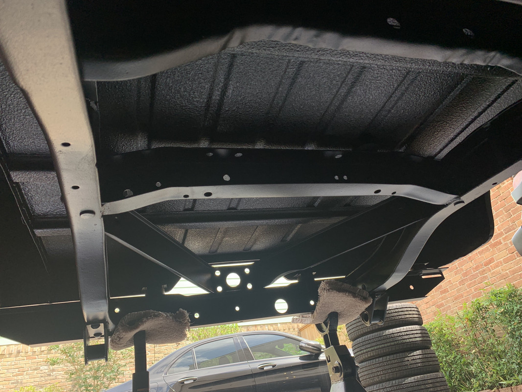

Bottom of the tub has finally been Raptor-Lined, and she's mounted to the chassis!

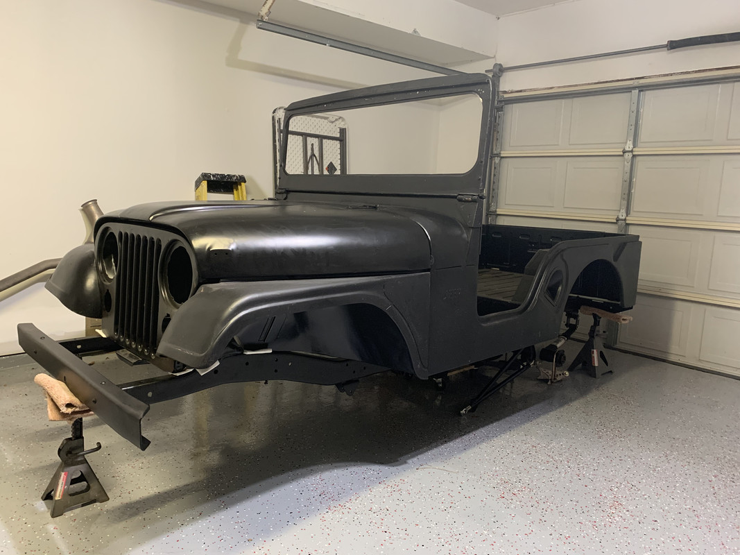

Old Jun 4, 2020 | 09:39 AM
  #36
c4 monster's Avatar
Posts: 29

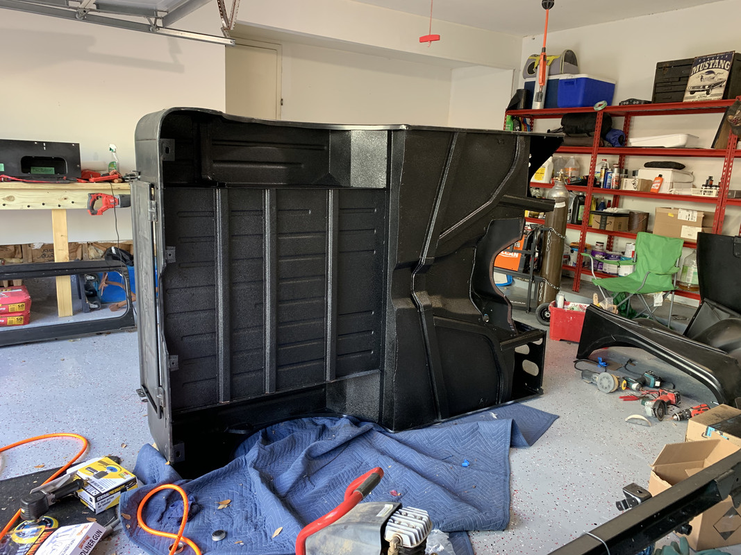

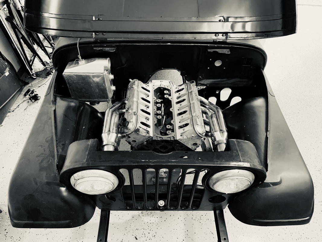

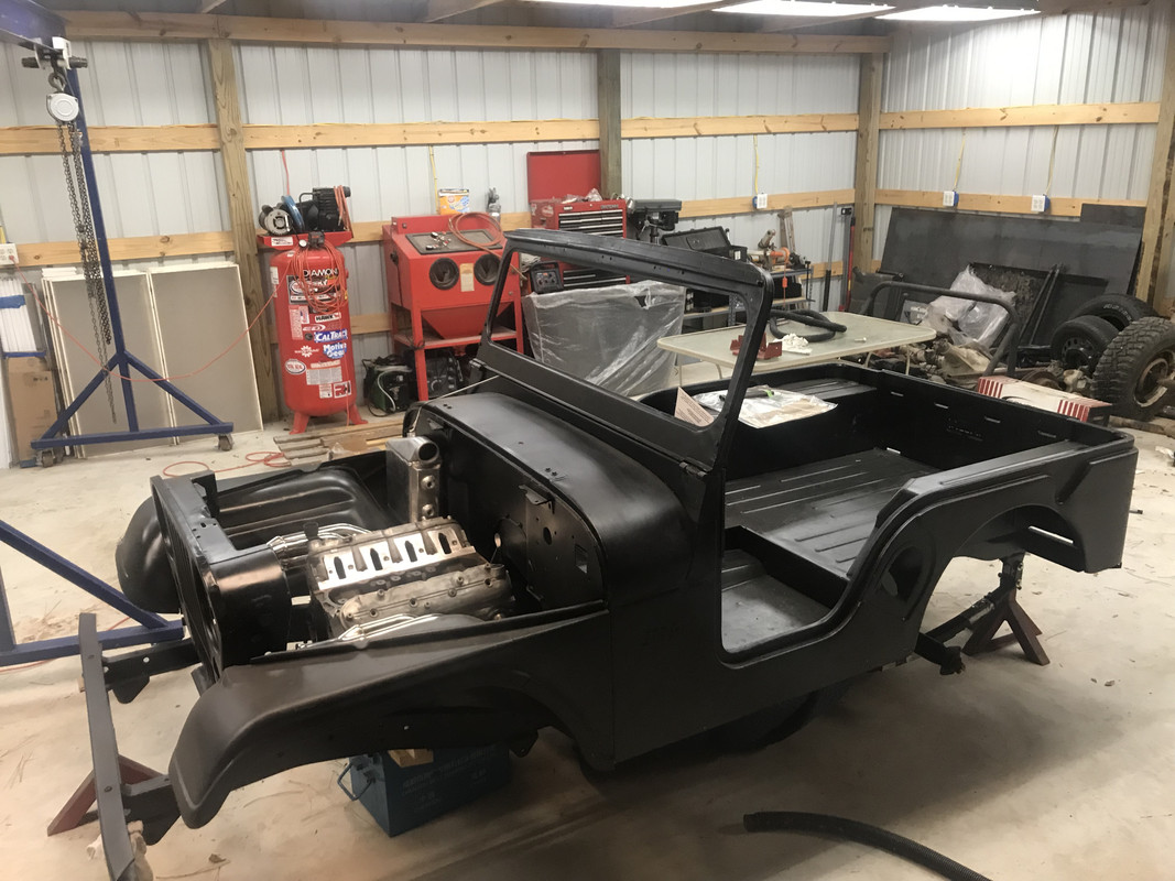

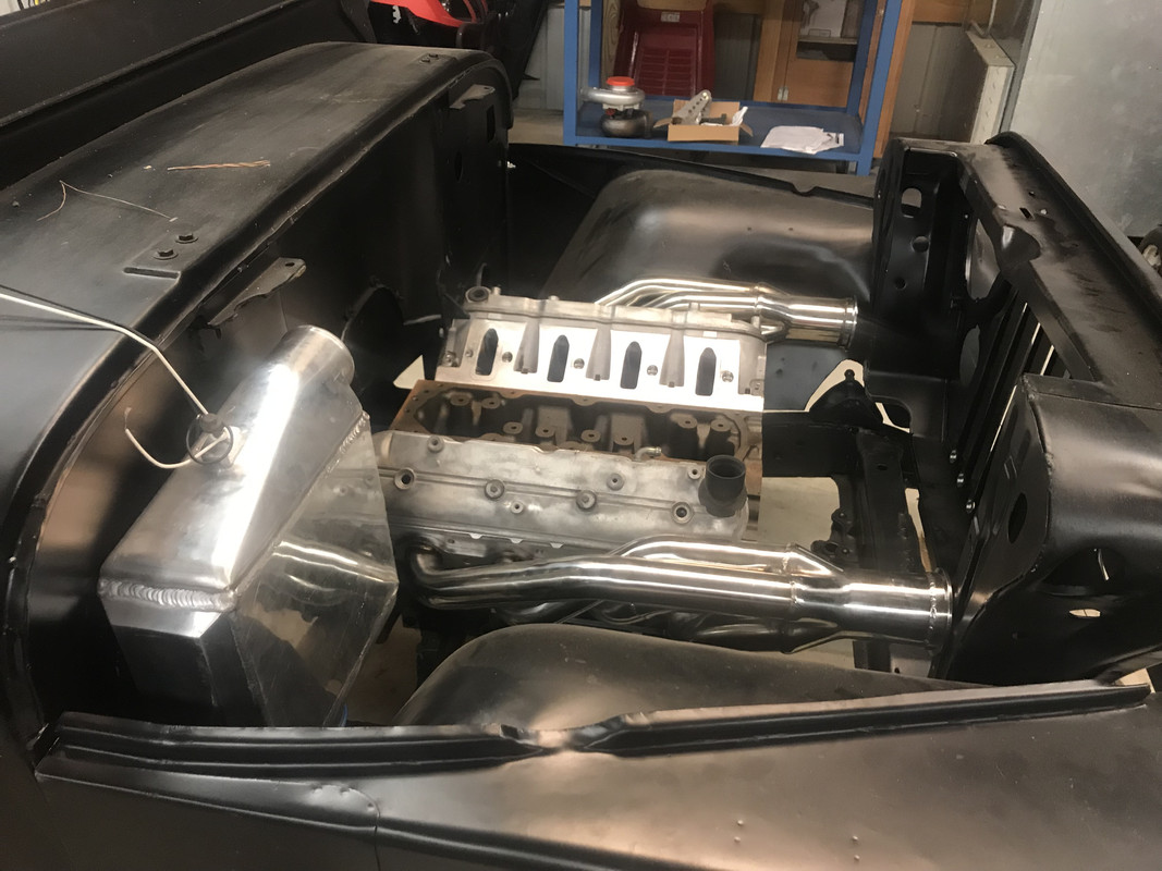

Mock up has finally begun. Need to drop the engine about another 1" to clear the firewall with the bell housing, but aside this it looks like everything will fit nicely. Ignore the crooked headlights, they are just resting in place lol

On a separate note, I'm also open to ideas regarding radiator location. The turbos will be positioned just inside the grill (between the headlights), so this area will be fairly tight. Any horizontal mounting radiators with an aid dam?
Old Jun 4, 2020 | 10:53 AM
  #38
LSswap's Avatar
Joined: Nov 2014
Posts: 1,308
Likes: 660
Oh, got my attention again. Is that intake manifold going in backwards? If so nice thinking out of the box.
So twin turbos high pressure outlets to a Y and a single cooler? or do they make twin water to air coolers?
Maybe even snorkel or twin snorkel the air intake above the hood.
With the engine and turbos up front, looks like the back will be pretty light.
Carry On!!
Old Jun 4, 2020 | 11:48 AM
  #39
c4 monster's Avatar
Posts: 29
Carry On!!
We will be running a single plane intake with a 90 degree elbow facing the firewall, running straight to the air-water cooler mounted on the firewall. It'll likely be a bit heavy on the front end, but ill be mounting the water box and fuel cell in the back of the tub to help compensate some. The turbos will plumb to a single Y and run back to the air-water along the passenger side rail.

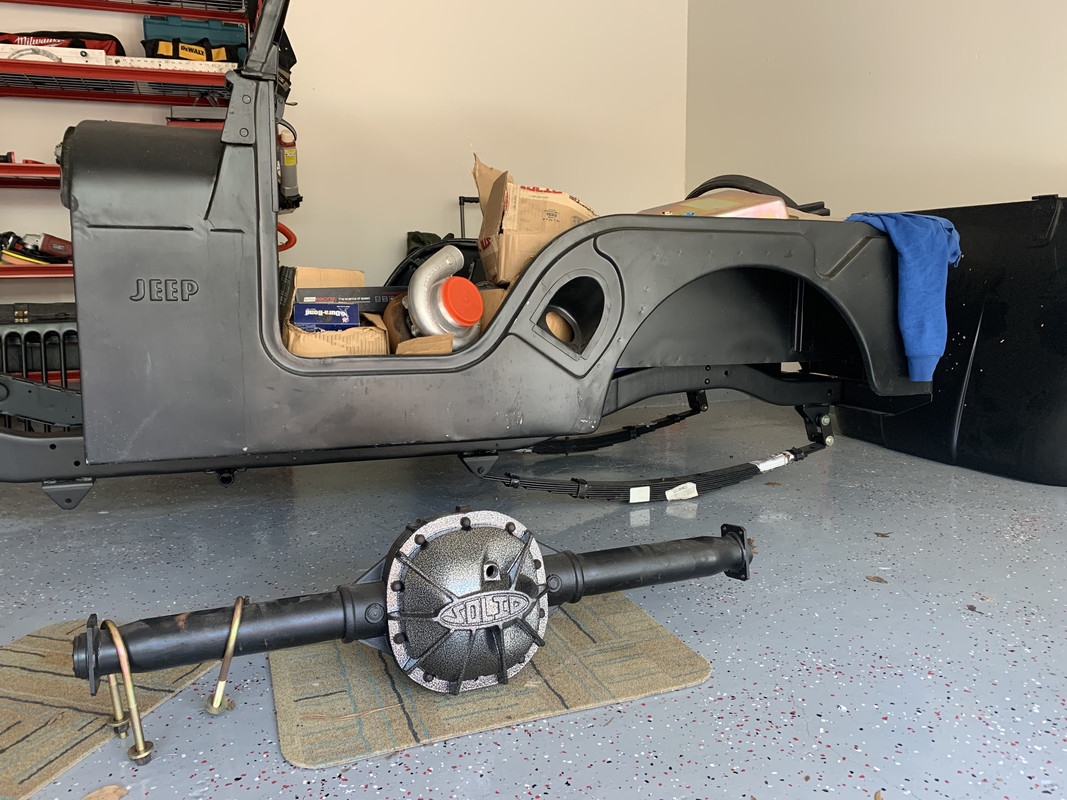

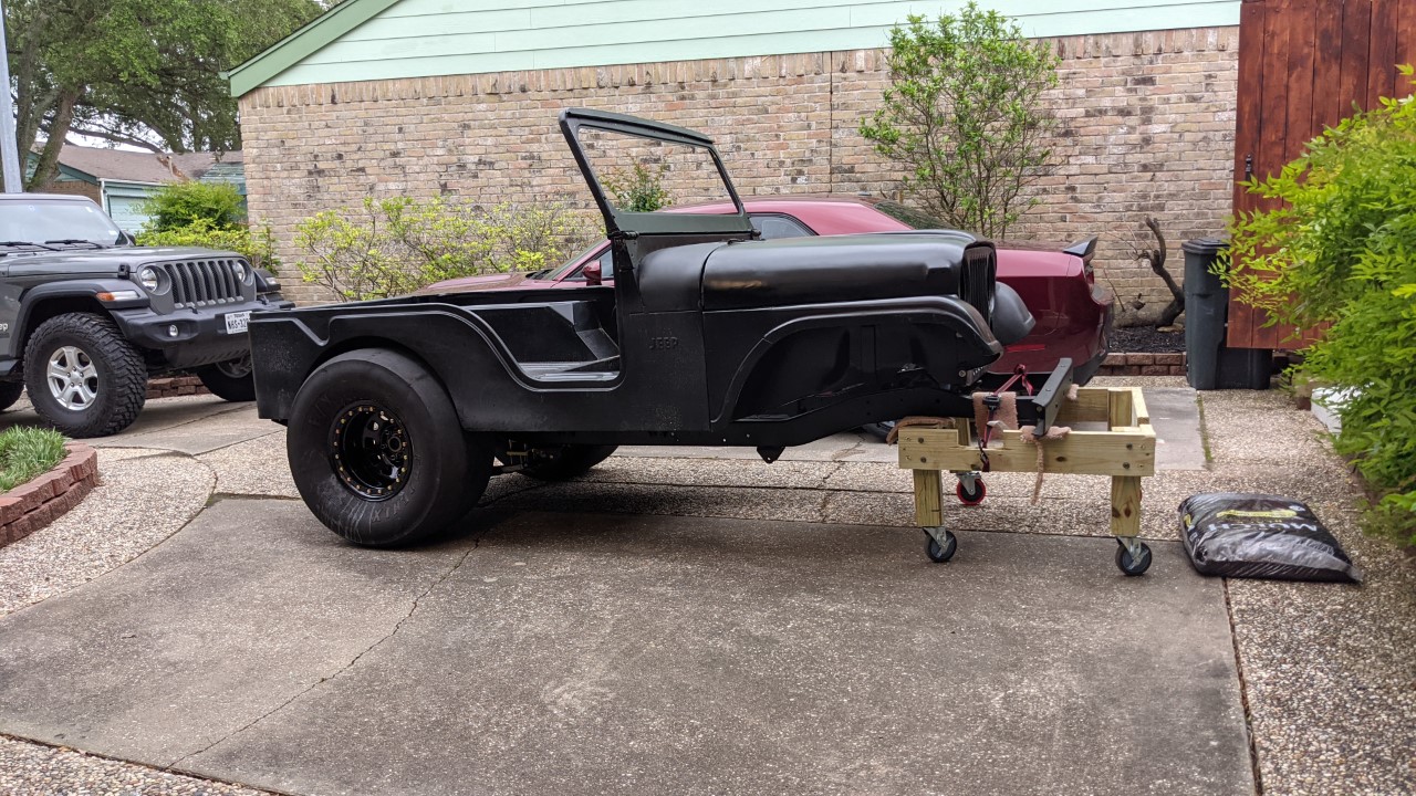

Recently finished my graduate studies, so its back to work on this thing. Have a front end on the way and hope to have it sitting as a roller soon. Rear is going to need lots of attention, but I finally got the axle located about where it needs to be. Fingers crossed that it will be in primer by the end of June.
