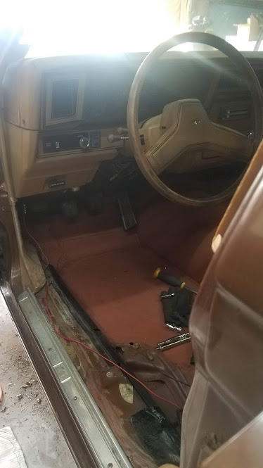

Interior starting to come back together. Hopefully my steering isn't too jacked up. wheel didn't lock when i pulled the column, so hopefully i got it back centered and didn't pull any wires while it was out.
Then, fresh floors looking good, gotta cut a big hole in them. Hopefully i measured corrected. if not, out comes the plasma.
