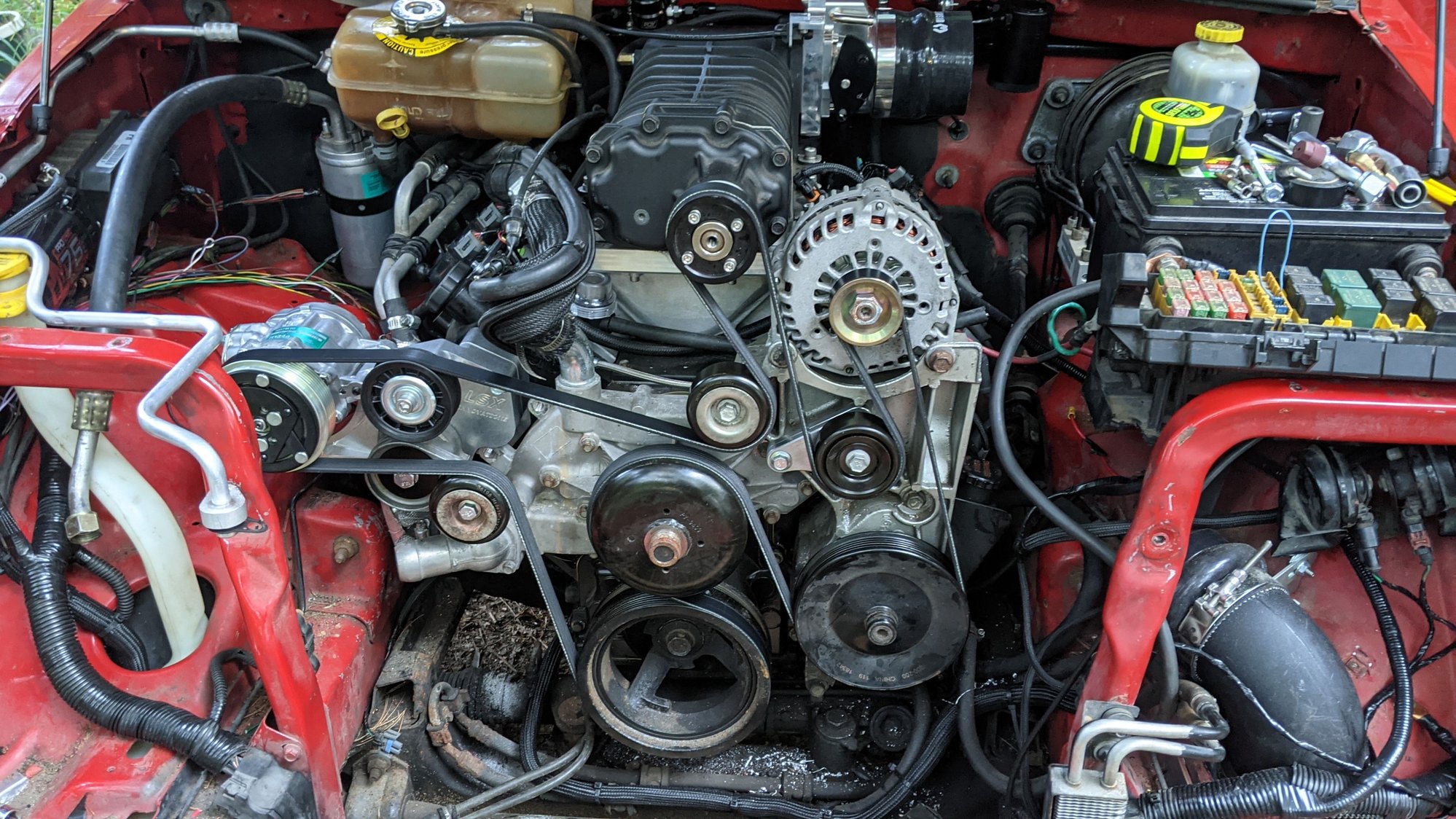

I've still got a big pile of engine upgrades I need to get on it but one of the things that has kept me from doing them was the tuning aspect and the amount of time it would have required......so I've decided to go a different way and have been working on something big for the last couple of weeks. Unfortunately due to covid-19 my normal circuit board build house has been out of stock on pretty much everything I need to build a "new" module and even just getting blank PCB's from them is taking 2-3 times longer then normal so I'm having to use a handful of separate boards and wire them together for the time being but I've just about got all the decoding sorted out now and have a new program written.......

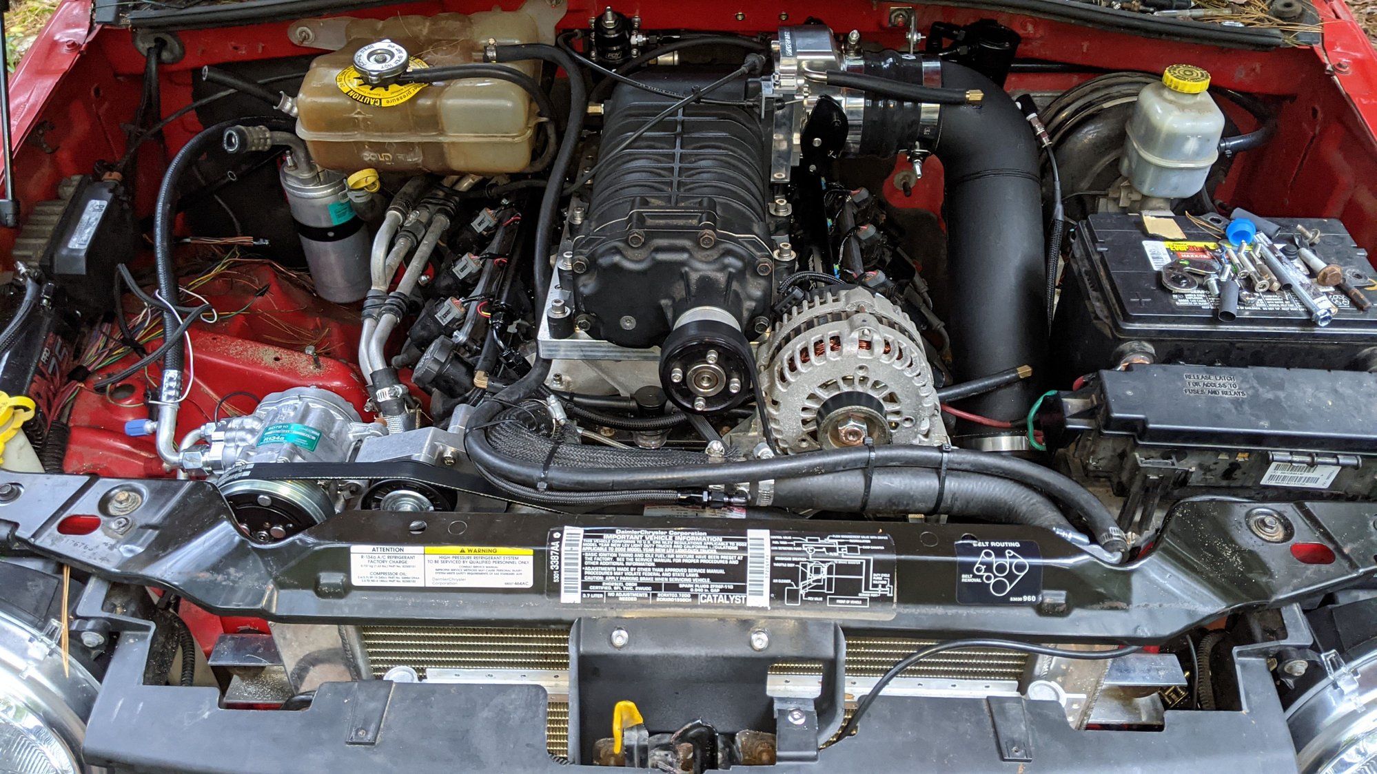

I was doing this right before the weather here got bad last fall and was only able to get it partially tuned but it's a little faster then it was
The blower is off a 2013 Ford GT500 mated to a Holley low ram intake.
When I started tuning it things were set pretty conservative and I don't think it's been much past 5500 RPM yet.....but at 5500 RPM and 70% throttle it's making a little under 0 pounds of boost. With the pulley combination I'm running at full throttle it should be making a little under 15 pounds of boost by 6700. It's currently not intercooled so I was just spraying a lot of meth and the weather was already getting pretty cool last year so it really made any kind of serious tuning pointless. The IAT's would have been pretty unrealistic for "summer" driving. This is still running though manifolds....so if you know anything about blowers then you can imagine what a set of headers and a high lift cam will do for this
I didn't make it to the local drag stip before they had closed last year so all I have to go on are some pulls with Draggy. The 60 foot is 2.3 seconds, now that might sound pretty weak but that's a traction issue and not a power issue lol. Anything over 50% throttle under around 35-40 MPH and it just blows the back tires off it. I've only done a couple of 1/4 mile pulls and had the throttle mechnacilly limited to max out at like 76%..... with a VERY soft take off....as in under 1/2 throttle until around 40mph and it ran 13.1 seconds @113mph. With headers and 3 inch exhaust....possible a new cam(currently running an ASA cam) I'm hopeful I'll get this into the 11's without much trouble once I get things dialed in this year.
