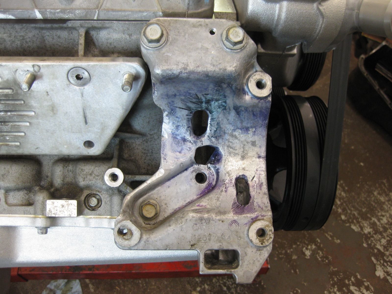

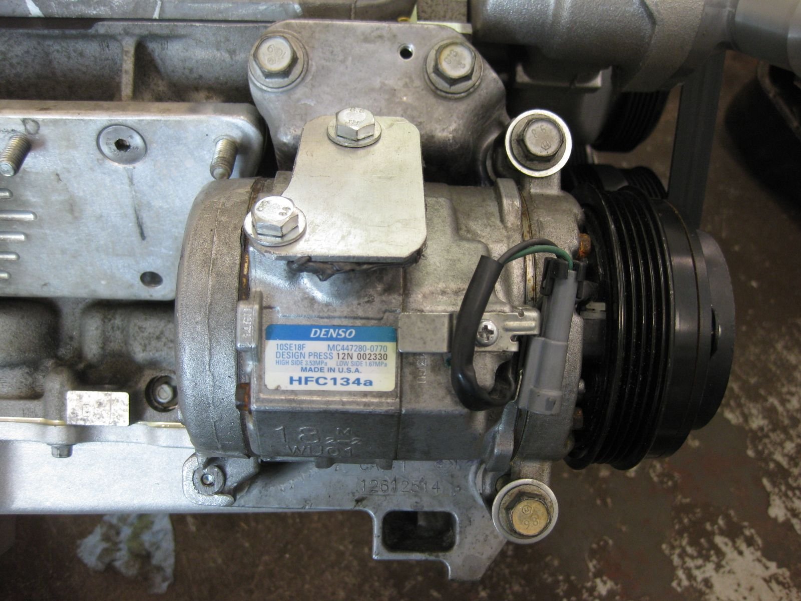

So here is a trick for this....... IF you buy a cadillac CTSV (1st gen) a/c compressor bracket and grind the **** out of it, you can use that to mount the truck compressor, on Corvette spacing. I seen someone on here do it and sell it. I copied his setup. Mine is mounted, so pics from mine is useless. I can see if I can find his pics somewhere for you, but its really, very straight forward. I also, used a friends laser belt alignment tool, and it lines up PERFECT, not close, PERFECT!

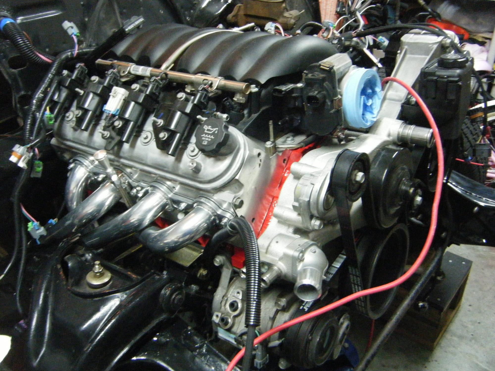

Alan Groves makes a low mount A/C bracket with Corvette spacing. I used one on mine - pic below during mock-up/engine swap.

Originally Posted by Michael Yount
Alan Groves makes a low mount A/C bracket with Corvette spacing. I used one on mine ...
It seems the OP is seeking a low dollar solution that will allow him to use the truck compressor he already has.
The Alan Groves bracket would require using a Sanden 508 compressor, unless I'm missing something?
I saw someone on here do it and sell it. I copied his setup. Mine is mounted, so pics from mine is useless. I can see if I can find his pics somewhere for you, but its really, very straight forward. I also, used a friends laser belt alignment tool, and it lines up PERFECT, not close, PERFECT!
